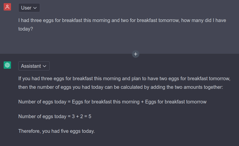

Someone needs to teach AI to say "I don't know"
It just made up a formula and told me it could calculate DI from frequency vs source size...
exactly
I've lost up from down since AI just lied to me. I don't know how to calculate it yet. SPL, and Directivity, affect the distance, the direct field extends, on axis, away from the source, so I need to incorporate an neutral FR in the picture. And then there's the possibility that nothing I just said is true.Why is that "false"?

It didn't take much to elicit this response from it..Someone needs to teach AI to say "I don't know"![]()
