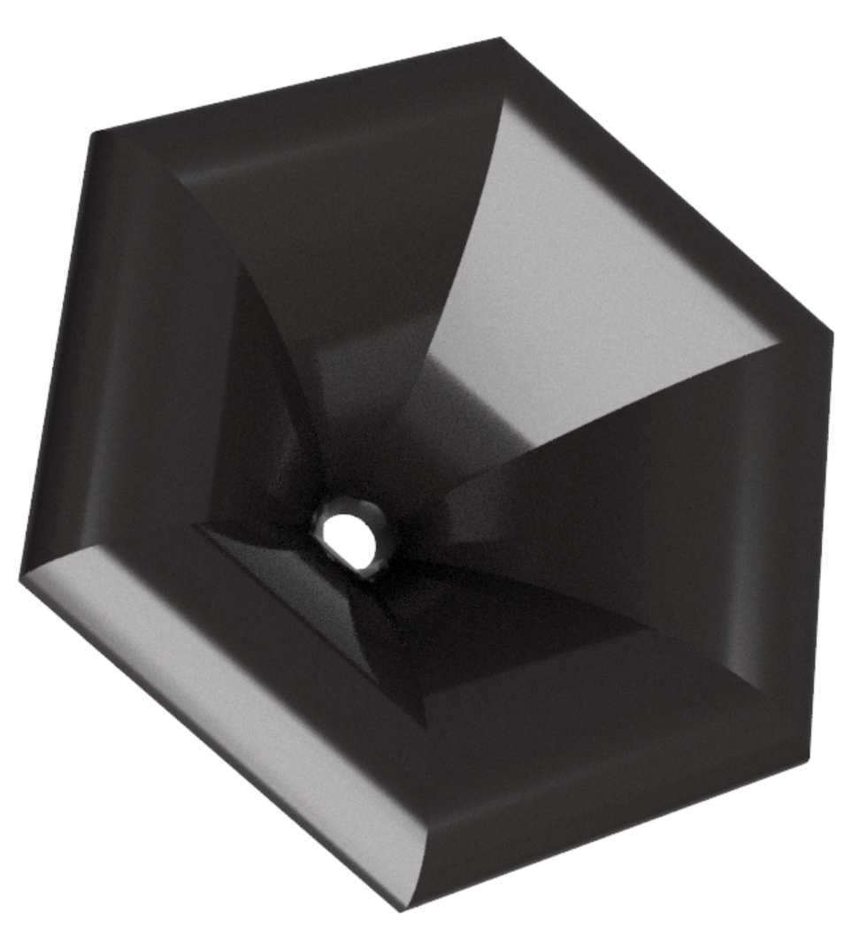

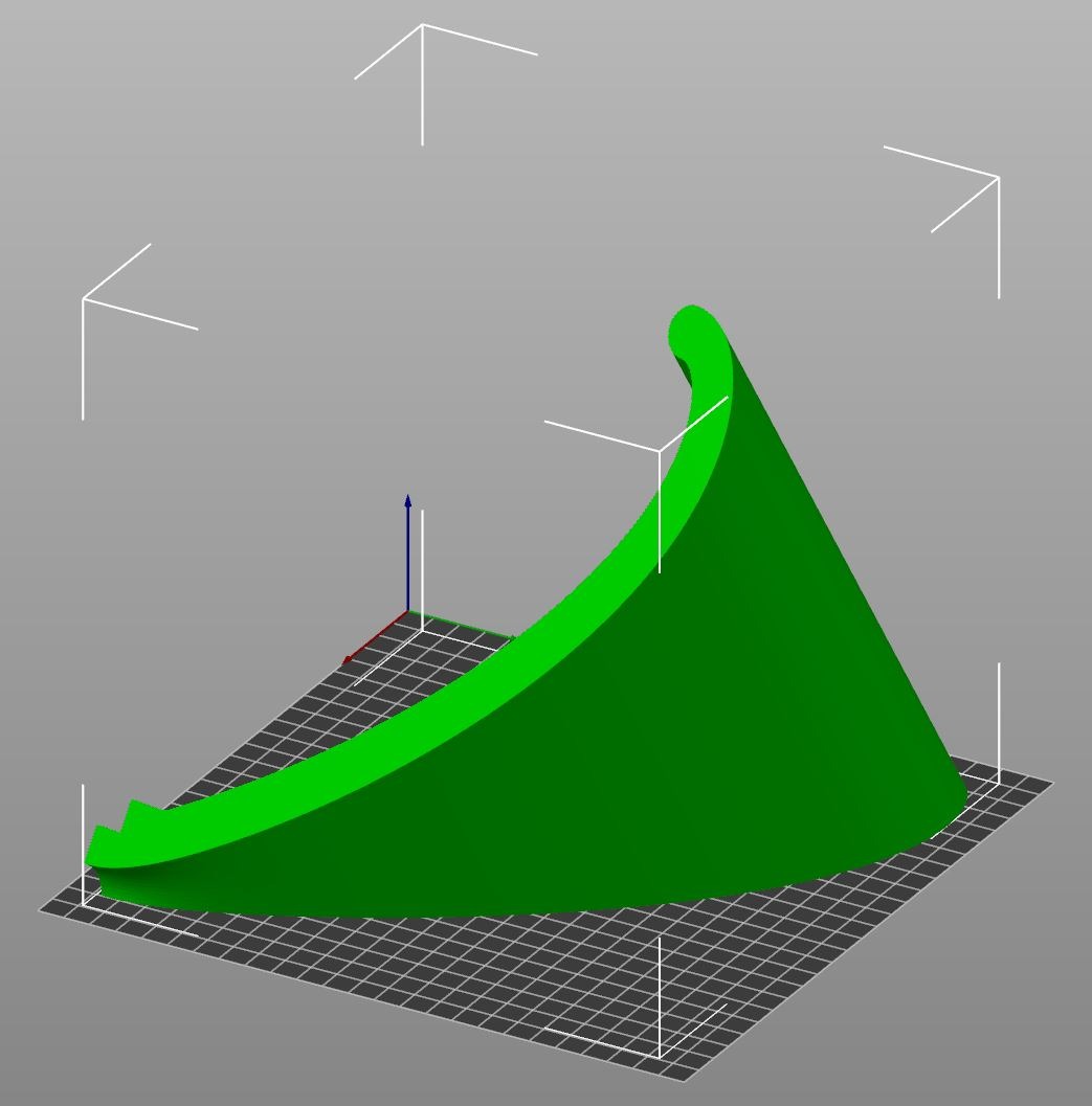

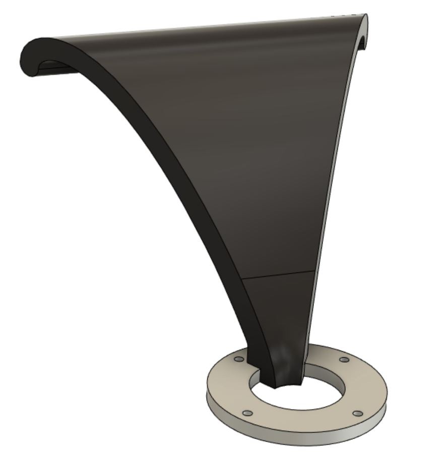

ATHEX 460-36, a petal model for casting (or 3D printing).
STL file: https://at-horns.eu/img/athex/ATHEX-460-36-CAST.stl
The nice thing about the polygonal shape are the joints that don't have to be perfect as in a round shape (where every imperfection is immediately obvious).
- This has a 1.4" throat, for drivers that are not suitable for a "reduced" throat (like Faital HF1440 etc.)
Of course feel free to improve it, this is only the core of it (it's licensed under CC BY-NC-SA 4.0).
