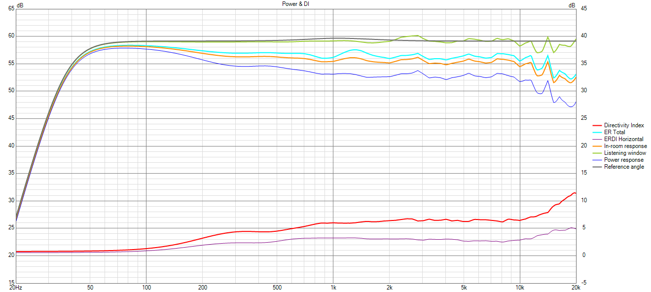

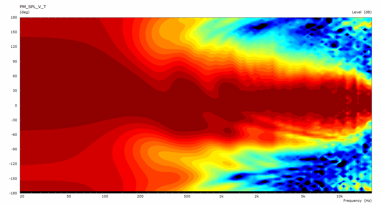

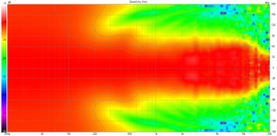

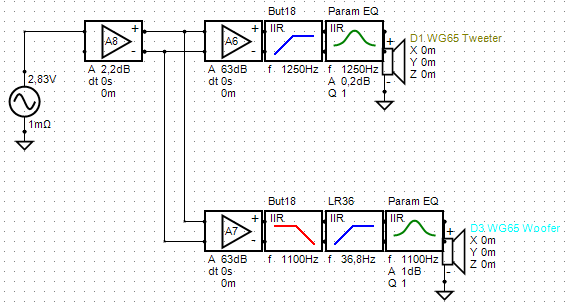

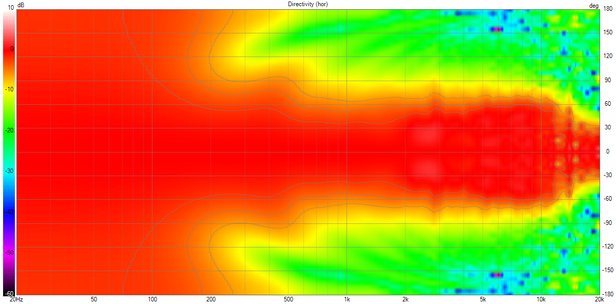

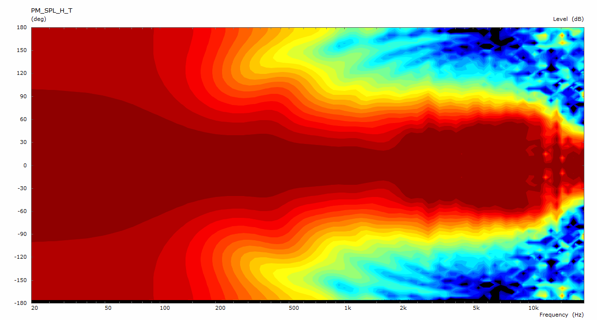

After my discovery that a narrow baffle means some issues, I did new simulation experiments for a 2-profile waveguide in a relatively simple bevelled enclosure.
- c. 40 cm width, simple 5 cm bevel edge:
- 65 degree horizontal radiation pattern:
- vertical +- 50 degree:
- what vCad shows:
- the crossover for this:
- 10 inch woofer spaced at 1.2 lambda
- results in 75 cm height, 23 cm depth for acceptable volume:
- what vCad shows:

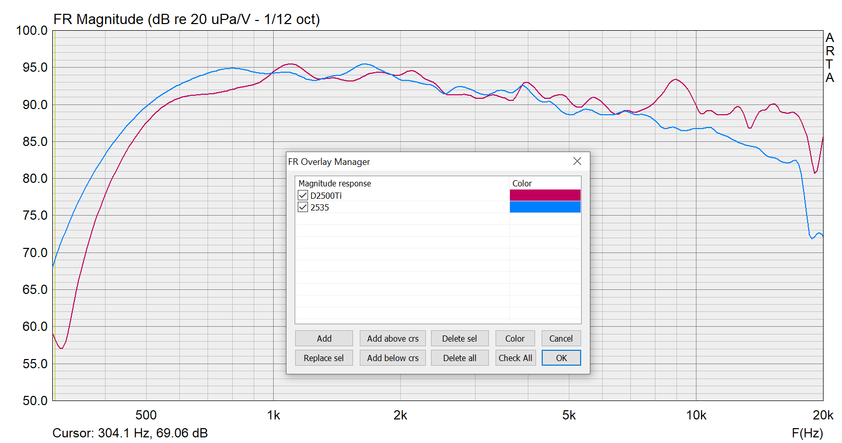

Continuing with the extended ATHEX 460-36, I quickly measured Selenium D2500Ti-Nd, a small 1" driver:
(Again, a pretty wide exit angle driver, not a good match. I only wonder what would change if made smooth all the way from the phase plug.)
Direct comparison with the Peerless 2535R00-08 (all else equal):
Mabat, is it possilbe to include the phase trace?
It gives an indication of how low they can be crossed.

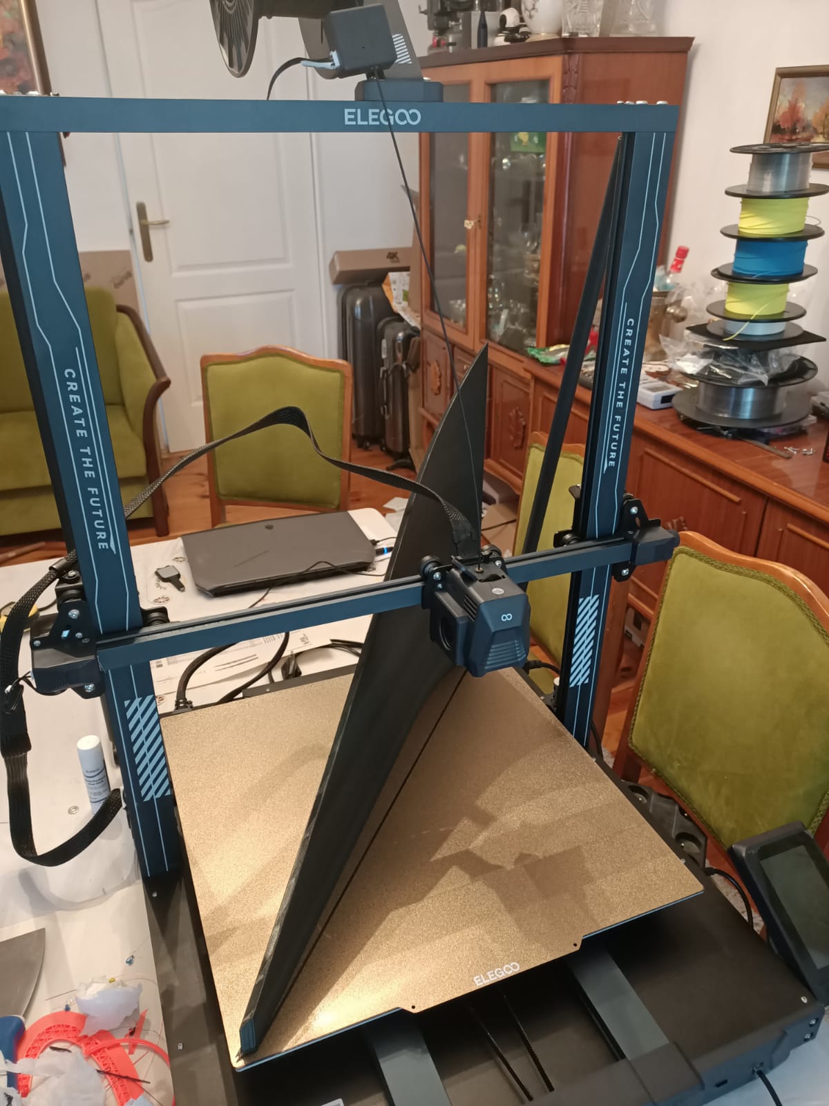

Athex could benefit of Jan Herich's method - Chisel slicer. I have sent him parametric curve from IGES export of Klipsch K402 horn and he generated gcode that was printed versy fast and very nice - 1 perimeter + sawtooth infill.
https://www.spacedelta3d.com/

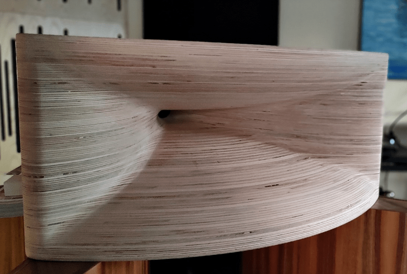

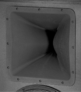

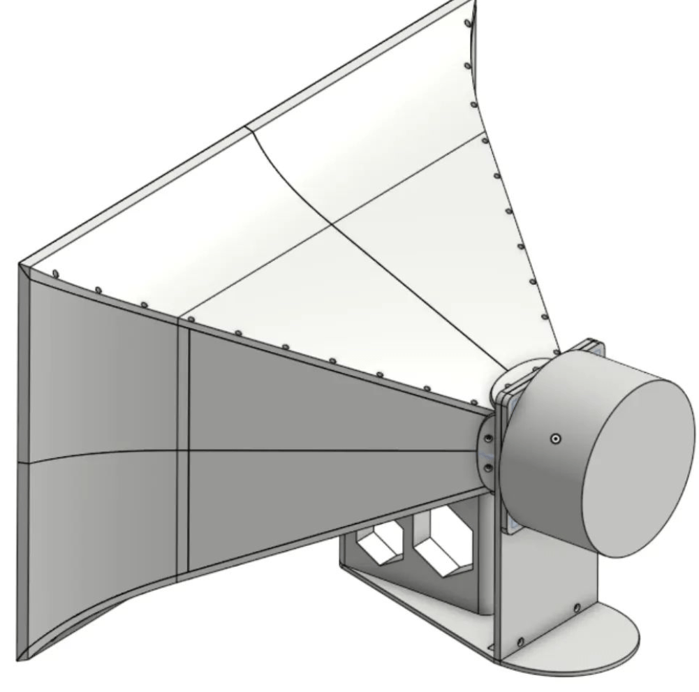

Ever since the loading tube has arrived, I am thinking about the role of diffraction slots in asymmetrical, baffle-mounted waveguides. Seemingly, we currently don't care about reflections too much around here anymore.
I am asking for experiences in practical design approaches in ath. Is it possible with the 2-profile setup to have the vertical profile only start later? Like with the waveguide of the Strass MF-2.1, which probably uses the old JBL 2380 https://www.diyaudio.com/community/threads/jbl2380a-myth-busting.268577/
And with a full-fledged 3D approach, has someone achieved similar to the GGNTKT M1 waveguide?
In my understanding, these waveguides, by using a slot feature, insert a shallower profile in a deeper profile, with different degrees of sophistication. But they do the same as the big old radial waveguides as the one @pelanj recently made from wood: https://www.diyaudio.com/community/...orns-picture-heavy-thread.402587/post-7435409
The length of the horizontal walls are increased. Just that they do not protrude, because the slot allows a shallower profile to be inserted into the deeper. The GGNTKT M1 waveguide uses the same recipe that was presented with the PT waveguides by JBL: On the horizontal plane, the profile is "pinched" somewhere behind the throat:
The distance/depth from the throat, together with the pinch, allows the horizontal profile to begin open only later in the waveguide, and hence follow a wider coverage angle, while still terminating flat with the baffle. This is a good solution to achieve pattern control for the narrower, vertical angle, while still allowing a wide radiation pattern for the horizontal.

Acoustic results are what counts, you would need to compare those. The "loading tube", as suggested, has no effect on radiation pattern.
That's not true, I wouldn't use it if the results weren't good. Perhaps there are still things hidden below the surface of a frequency response curve (like they may be hidden every time), but nothing so far suggests so. The "loading tube" doesn't really make a diffraction slot.Seemingly, we currently don't care about reflections too much around here anymore.
Yes, you can create as many independent sections as you like, which, in effect, can provide such feature.I am asking for experiences in practical design approaches in ath. Is it possible with the 2-profile setup to have the vertical profile only start later?
It never seemed to work very well though, at least for what I tried.
Yeah, that was a tongue-in-cheek remark. And the HOMs ...
Anyway, results count, maybe there is a difference between a tubular extension and two parallel walls, a diffraction slot. But maybe not.
Interesting, I should try it. I think for my case the 3D approach should be superior, because the horizontal walls are not covered as deep into the waveguide, but I would like to see what it does.
For the 3D approach I have no idea how to make the slots at the side pinch into the throat profile, which the PT and the GGNTKT waveguides have in common. But maybe someone has an idea.
