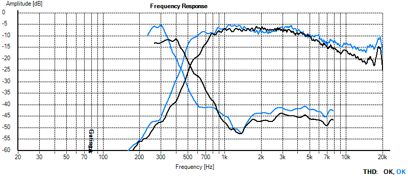

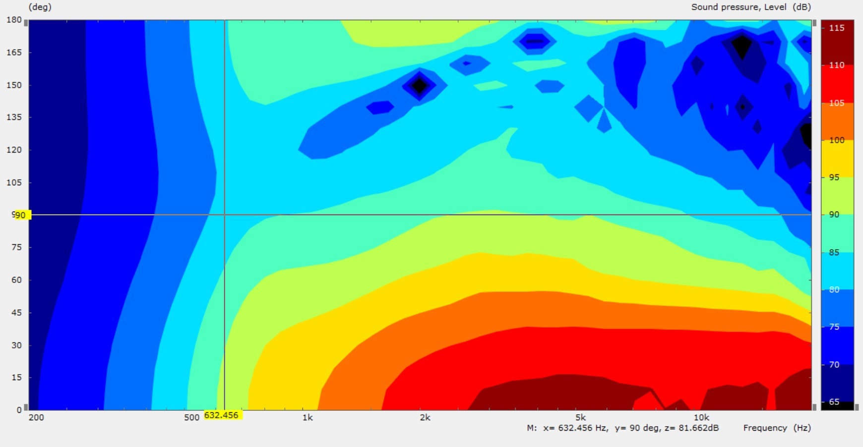

Here is a comarison of BMS 4550 on two horns of relatively same size
Now the numbers here are all relative, but it's clear that the exponential horn is usable lower.
Another thing to notice is the HF boost since the exponential horn also beams..
Blue trace is somewhat exponential
Black trace is somewhat OS
Yes, that's a good example. Using 'somewhat exponential', you can easily get e.g. from 800-900 to 500-600 Hz but at the cost of increased beaming. Now try to use an extension tube, as it should provide about the same LF extension but without any loss of pattern control.

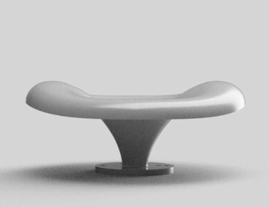

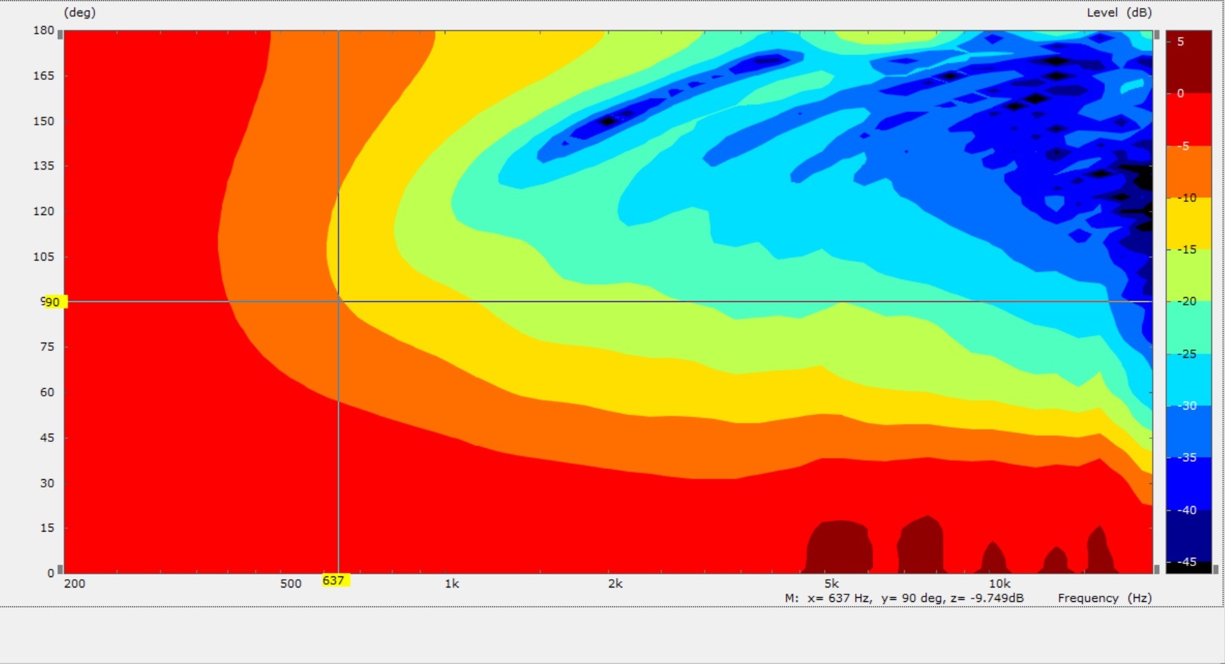

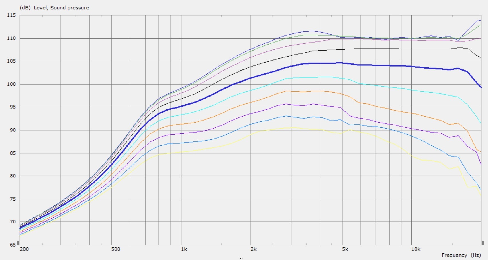

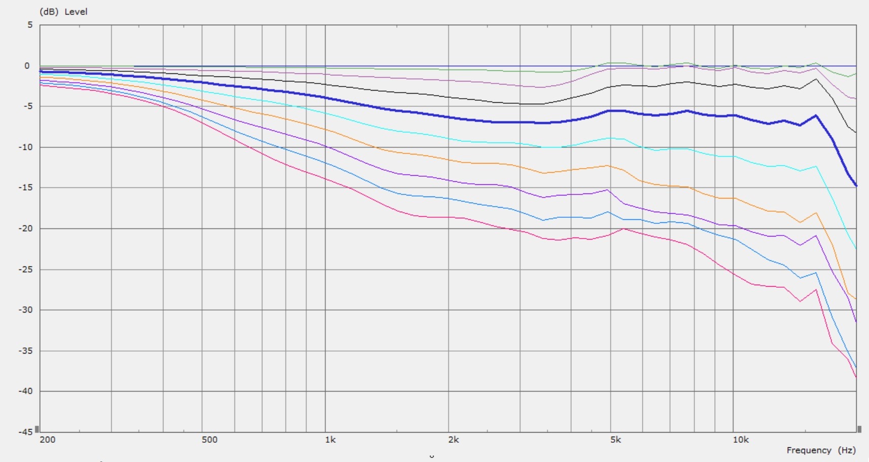

I finally figured out how to get AKABAK running with an elliptic round over profile. The results below are have 10 deg increments from 0-90. Thanks for the unbelievable resource of information Marcel and giving an amazing reference point to copy! Look like I've got a workable scheme to start fabricating

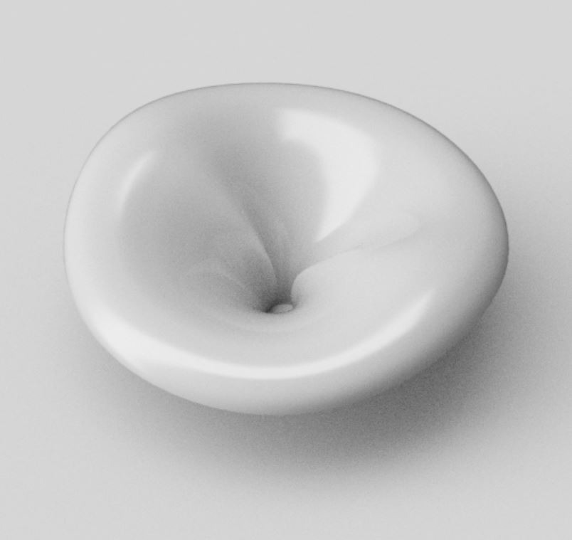

For those willing to print it and try, here's a modified ST260. This outer shape is actually the direct result of the formulas used. I have also a version with a truly round (flat) mouth but this performs better so I left it as it is.

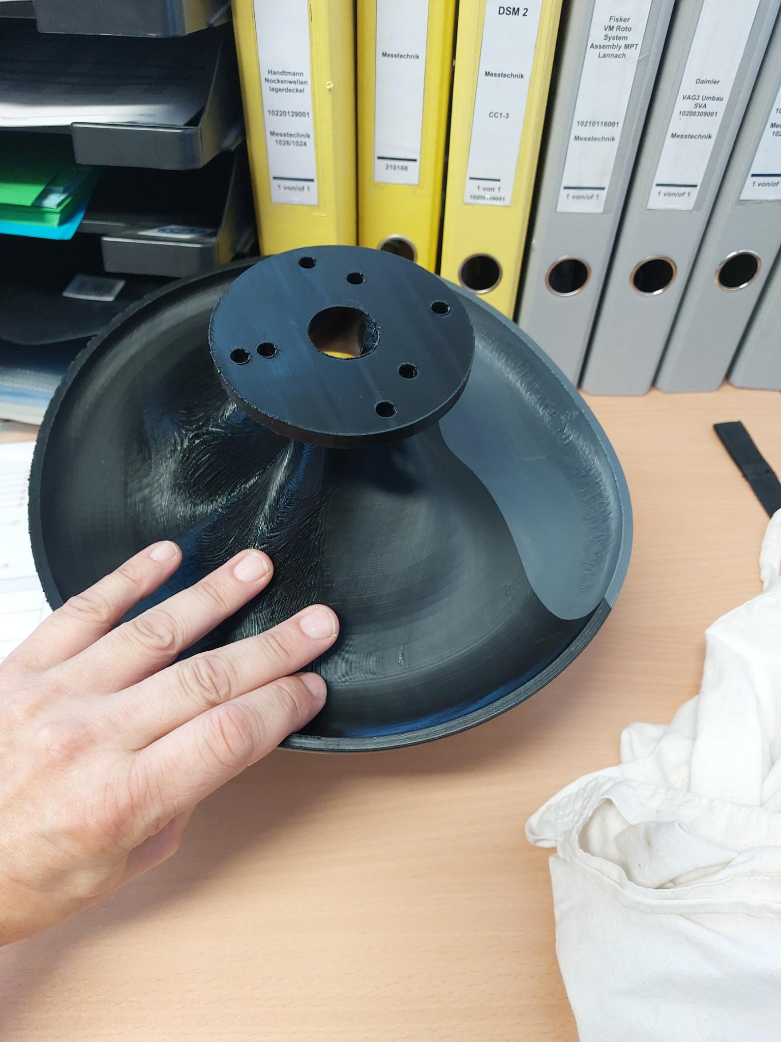

The first Horn is ready
Thank you for this nice work
