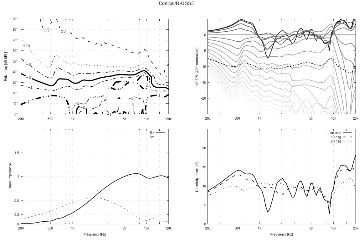

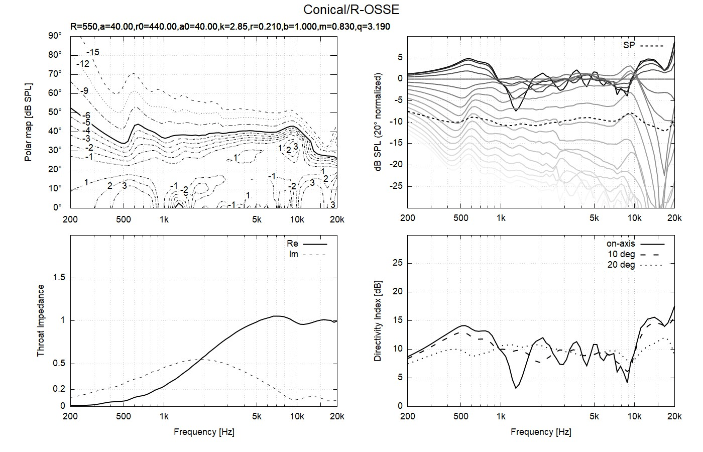

I managed to run the simulation, many thanks to @mabat . However I am getting some surprising results. This is what the conical waveguide looks like in ABEC:
That looks exactly as I intended. What surprised me were the results:
Is this to be expected from this type of horn? Especially the dip and peak below and above 1 kHz on axis. The configuration is attached.

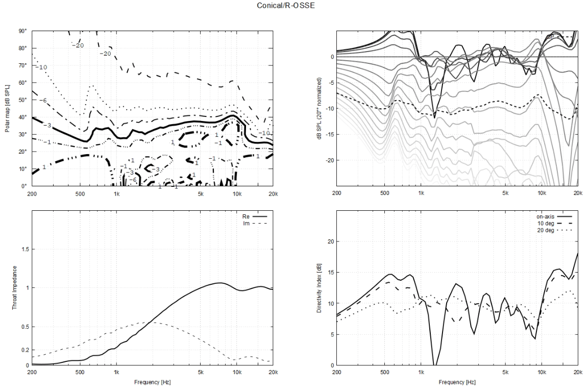

I checked another simulation I made before this one, that one had the roundover smaller and specified with wrong parameters. The above used parameters found via Desmos for the desired roundover shape. Anyway, the result is this:
With a dip and peak even worse. Does this mean that I am more or less on track and by modifying the roundover (making it larger, probably
I can improve the situation further?

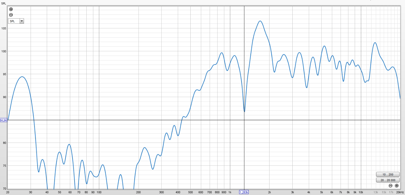

This is a FDW gated on axis measurement with reflections in room - of the horn without any roundover - do I see coorectly the pattern there as well?

Yeah looks about right, edge diffraction. Form periodicity of the interference you can directly calculate where it happens, how big of a delay there is after direct sound when another sound comes after.
If you want to get rid of the interference altogether, the waveguide curve must be smooth from where it starts to expand all the way around basically avoiding any abrupt changes in curvature. Any "discontinuity", or change in the curve, could send diffraction related backwave, which is basically secondary sound source that emits backwards where the sound came from (simplified) with opposing polarity and limited bandwidth. With such device you've got about maximal diffraction backwave happening at the mouth edge.
The thing is, the simulation uses ideal sound source, and thus the frequency response could be absolutely smooth with no wiggle whatsoever. Any wiggle you see is result of some interference, basically precense of at least one extra sound source, perhaps a reflection or diffraction related backwave that emits when sound bends (diffracts) around a corner.
It's impossible to get rid of wiggle altogether, so all you need to do is relieve it enough so that you don't find it audibly disturbing.

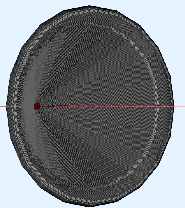

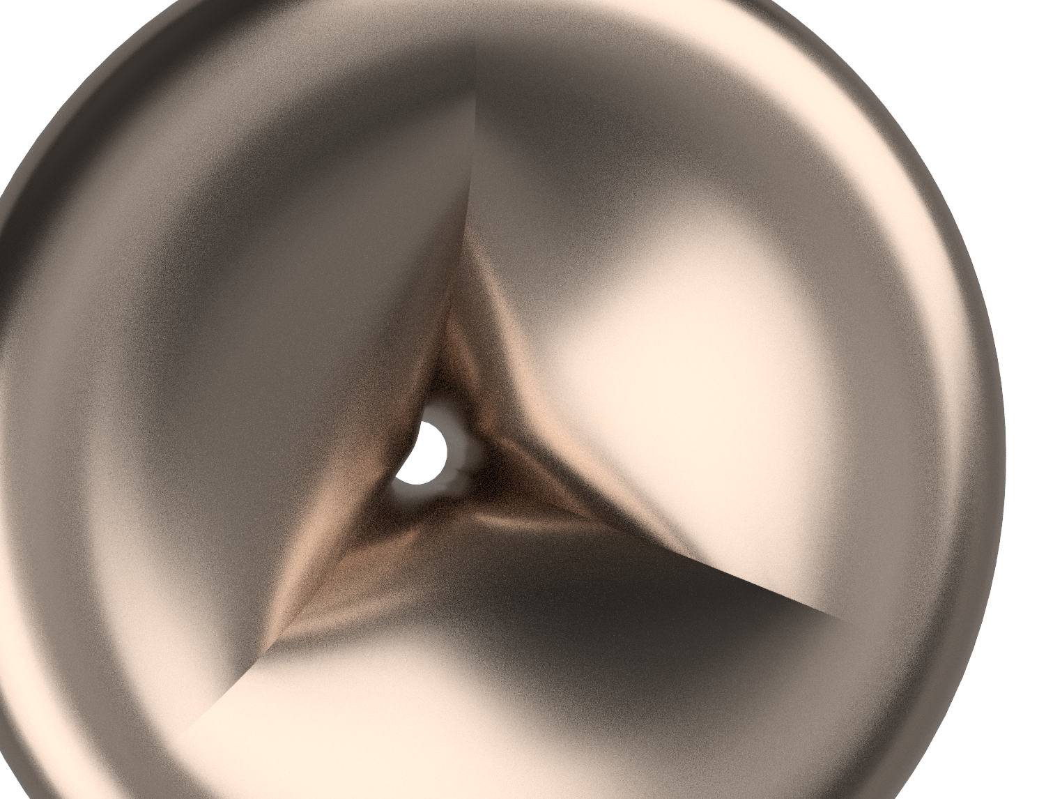

For this construction, I can get smooth transitions both on the throat side and the mouth side as well - albeit with a long flat conical part - it actually only needs to be long enough to fit the drivers.
Maybe it would be possible to use a three part construction (throat adapter - round to octagon, 8 sided conical middle part and octagon to round mouth made from eight parts) to mimic what mabat does with a 3D printer. It could be easier than CNC a fully round horn from slices and then fitting drivers on the outside.
Not really - I would have thought opposite - a finer mesh would be better? The dip is almost exactly where predicted, below the driver rolls off, so the peak is not that visible. I think I see some in the mids - and when going off axis, I see similar irregularities as in the simulation. I need to do better measurements some day.

The middle part of the R-OSSE horn is pretty flattish - if there is no other way, the middle part petals could be machined to be slightly curved on the inside while keeping the outside flat to be able to mount the MF and LF drivers easily. I need ca 45 cm of flat surface on the outside, the rest can be whatever.
