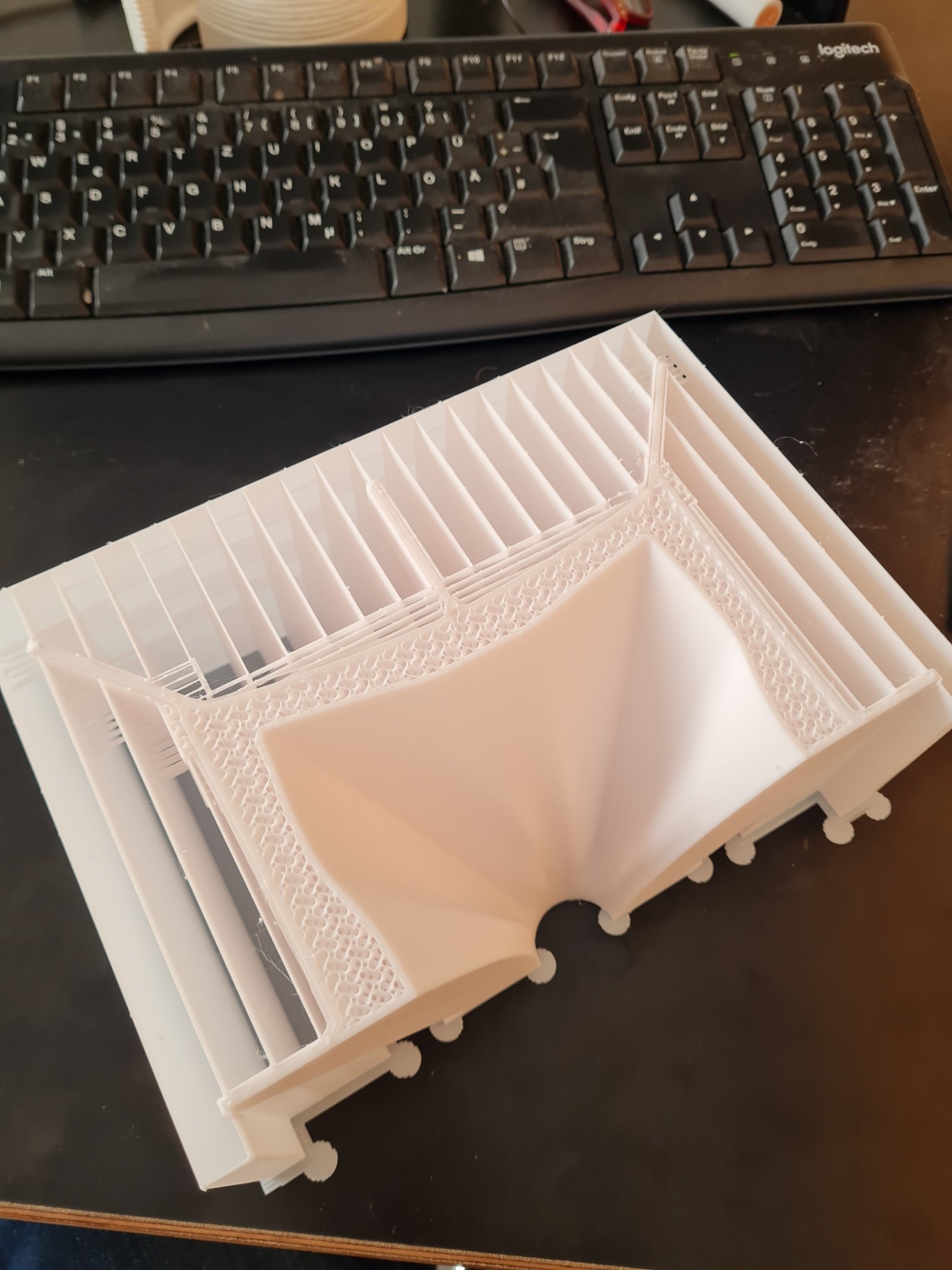

Printing ABS Style with reduced cooling basically immediately runs into problems the moment cooling is being reduced.
I guess its mostly the material being used (Sunlu PLA+) is impossible to deal with this kind of geometry.
Sunlu Meta PLA looks promising to me, as it is printed at already 20° less. Cooling should be less of an issue.
In general i may benefit from designing an improved cooling assembly for my printhead...
Rxdroid, I would also be interested to know how this turned out.Hello Marcel, printing the ATH300EX/S, I have the ATH280EX-MK2 to print, but I am trying this one, on Monday I finished the adapter, I have given 5 layers to the walls and a 5% fill without botton layers to be able to pour some type of epoxy resin with charge of some low density filler (microballoon) I will update.

The printing was quite good (PLA). I had no success with filling the light epoxy, too dense to fit between the internal infill (5%) then, although I used slow-drying epoxy, the mixture heated up and somewhat deformed the profile of the horn, nothing that cannot be fixed, but I have to find another successful formula. We continue investigating....Rxdroid, I would also be interested to know how this turned out.

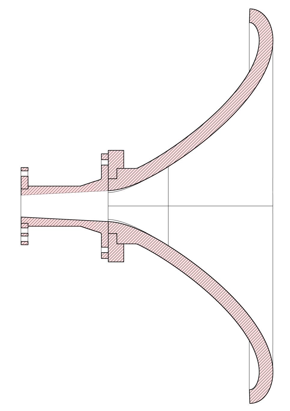

mabat, thank you for your reply in post 14,430. Based on that I'll use your R-OSSE formula. I really like your ATHEX idea to make printing on a small printer easier not to mention enabling 6 beveled boards to make a hexagonal enclosure.
While the other ATHEX zip files I looked at had STEP files in the zip, the 460-25-7.2 (which I assume best fits a DE250) has only the ASC and not the STEP file. Could you add the STEP file or tell us the R-OSSE parameters to make our own? (I assume the R-OSSE profile is along the corners). My mesher will transition from the round throat to a flat so I only need a single profile though I have considered programming in your segmentation formulas. Again many thanks for your contributions even if you decide you need to keep that stuff proprietary.

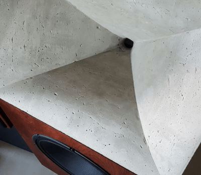

For myself my plan is to 3D print an envelope of the ATHEX above the straight transition line and make multiple petals from that mold in latex concrete which doesn't have rocks, just sand along with the binder. Have you ever tapped concrete? There is zero ringing and the stiffness (Youngs Modulus) is reasonably high. It cracks easily in tension and has moderate shrinkage, so I'll post how that turns out. At worst maybe I'll end up printing an envelope per petal and use the envelope as the tension member. Latex Concrete is less than 1/10 the cost of filament or epoxy.

Actually, I'm making a big concrete horn: https://www.diyaudio.com/community/...-design-the-easy-way-ath4.338806/post-7468717Have you ever tapped concrete? There is zero ringing and the stiffness (Youngs Modulus) is reasonably high.
I was able to make only the first one last year, I want to finish them this spring or summer.
It's not as dead acoustically as I imagined (it still rings somewhat), but otherwise I like it pretty much, it's nice to work with.

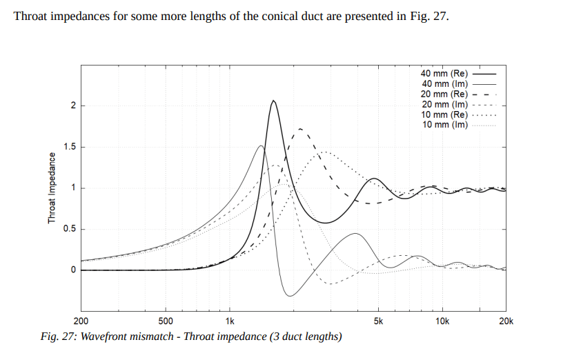

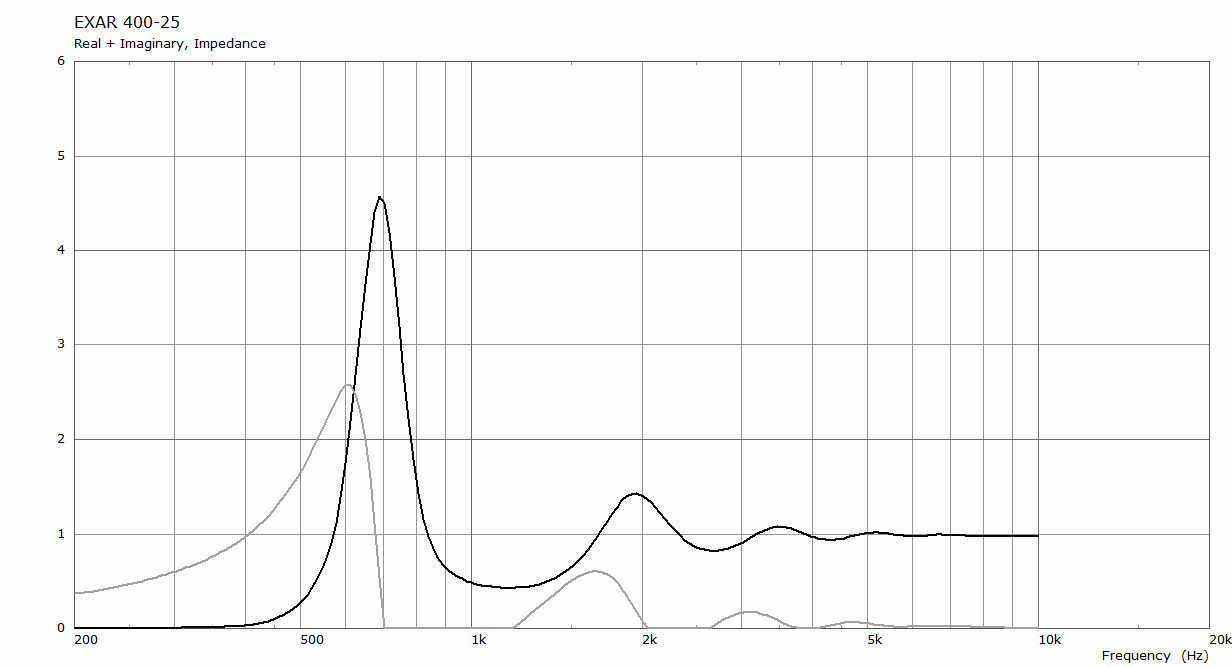

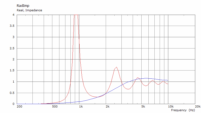

I'm still trying to figure out what's actually happening in an extended-throat horn.
This is the throat impedance of such a device -
The real part is more than an order of magnitude higher around 700 Hz than for a "regular" waveguide.
How does this work? Is there a way to understand this intuitively?
This has been known for a long time, but I mean getting more of a "feel" for what's happening is more physical sense.
I believe some time visualization would be helpful, unfortunately that's out of capabilities of my tools at the moment.
Moreover, impedance is a steady-state concept, as far as I know. Probably not very telling in this regard.
Something is obviously resonating. It's just not clear to me what is in resonance and with what.
