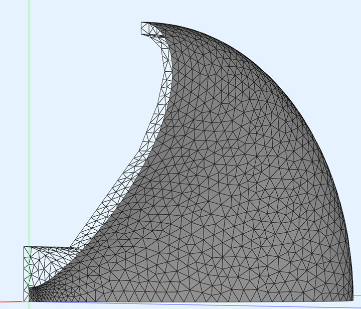

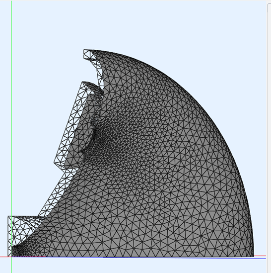

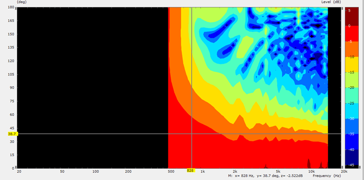

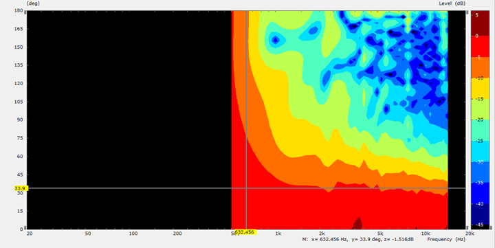

I don't see those results as bad. It's a wiggle of a couple of decibels.Finally got around to getting my own models & whatnot running in the new AKABAK. I've been really curious what the predicted impact of having a hole in the waveguide for MEH style horns actually is. Generated the profile in Ath4 so I could compare the my solidworks -> gmsh -> akabak workflow and make sure I wasn't messing anything up. Results dont look pretty to me (unsurprisingly) and I think it really solidifies how much better an approach like what genelec is taking could be. Maybe some interesting information for some.

And you can probably clean it up with some clever positioning and hole shape.
yeah not sure to be honest, my gut as a mixing engineer says you can't just add & remove a few db here and there like that and not hear it if paying attention.
really curious what @gedlee or mbat would intuit looking at the responses, possibely even worse at high SPL's
I don't know
Somehow I still don't quite like the idea of making holes to waveguides, but there are two very different questions related: Is it the best what we can do? I still have my doubts. But is it good enough to bring a lot of pleasure listening music? Absolutely, I have no doubts about it, if you like it, go for it.
I agree, it might be maskable etc, and maybe with careful hole placement, it could be minimised. but its only going to 'smear' the result.
to me, it probably makes more sense to try integrating the driver into the waveguide, a-la genelec or this martin speaker, this one is full range. but if you limit the low end like the genelec, you should be able to the the excursion below 1mm, allowing you to have a smooth interface with the horn. I'll put up some tests with that in soon. but using the axial mode, it seems you can displace the surfaces by that much and not do too much to the response at all.

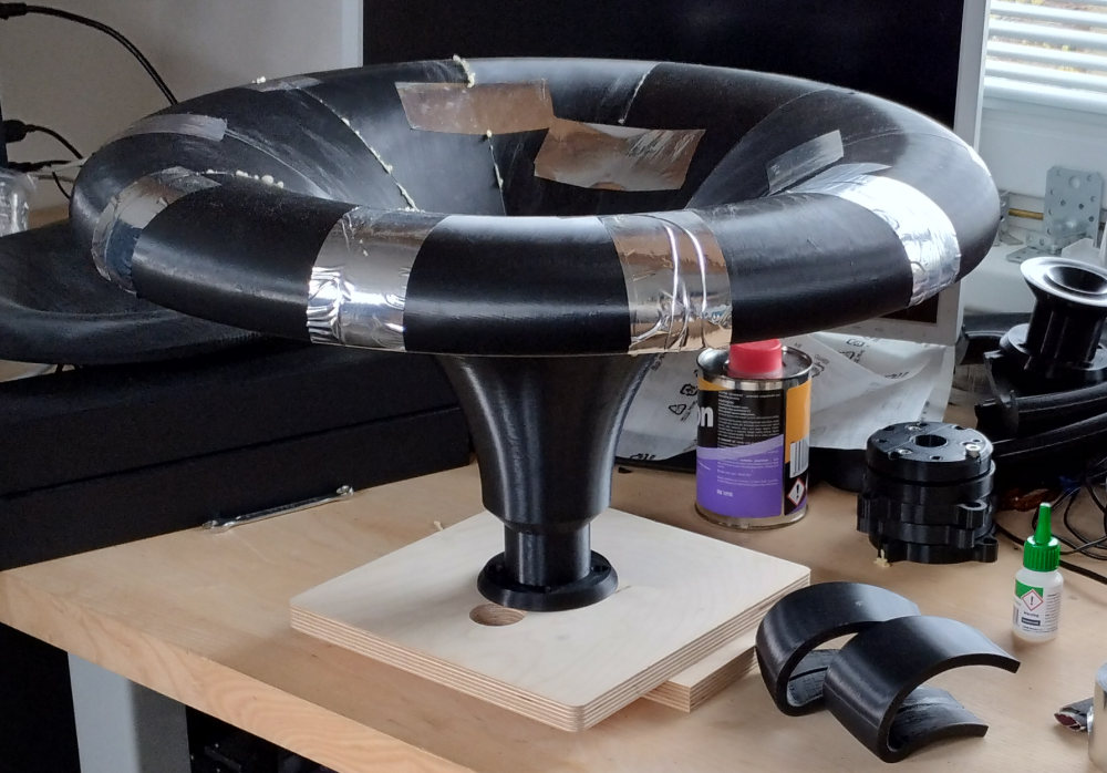

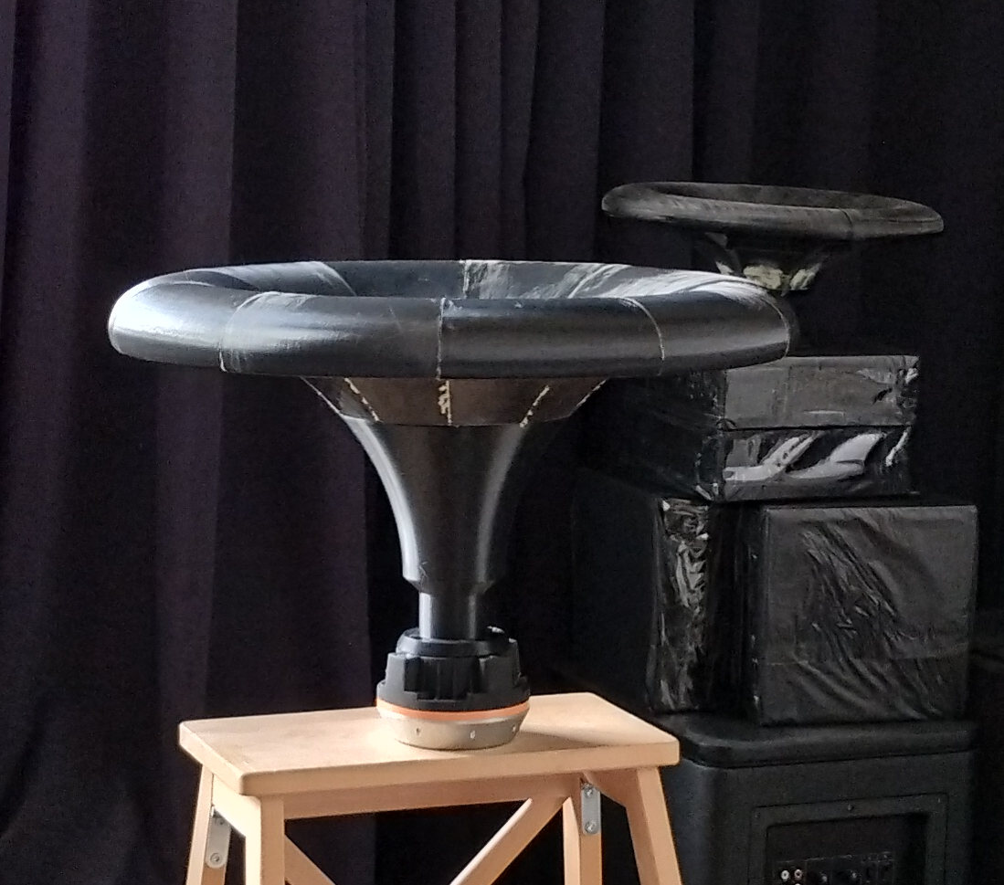

It weights 1135 g, 550 mm mouth diameter - I made this one very light.
I haven't tested the center of gravity yet but I guess it will be somewhere near the mounting point with a driver attached.
(The gap between the base and the petals is intentional. One of many lessons learned.)
