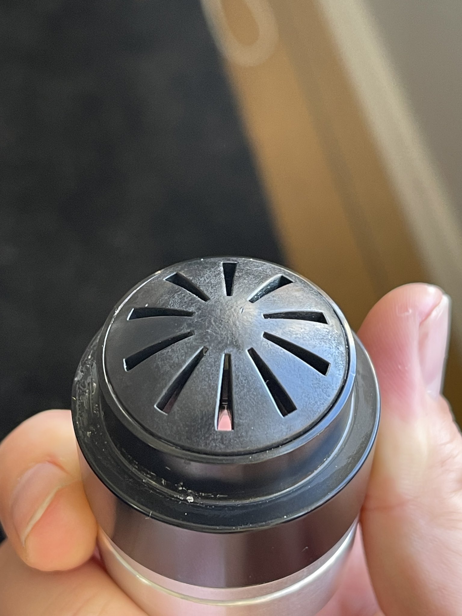

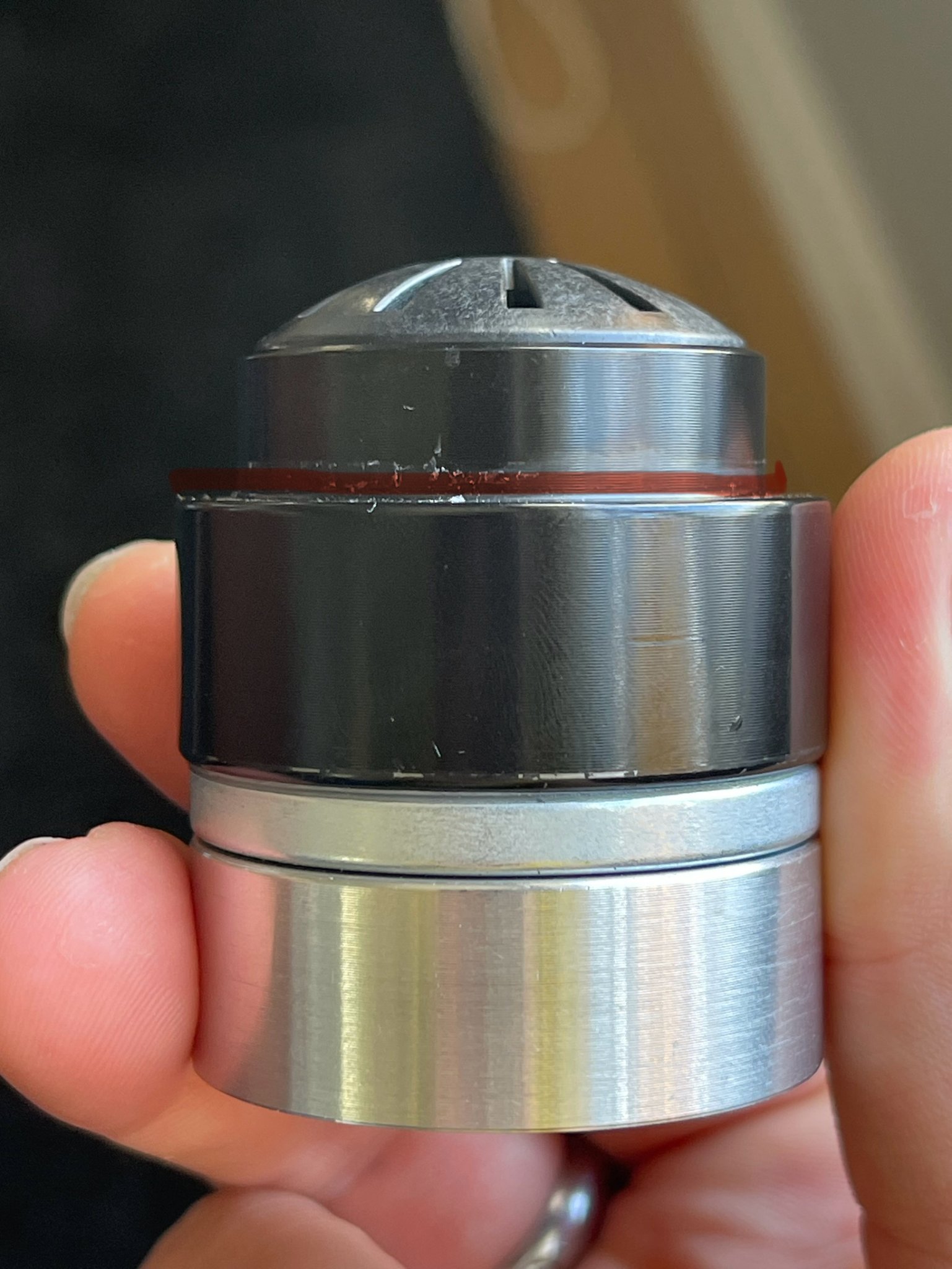

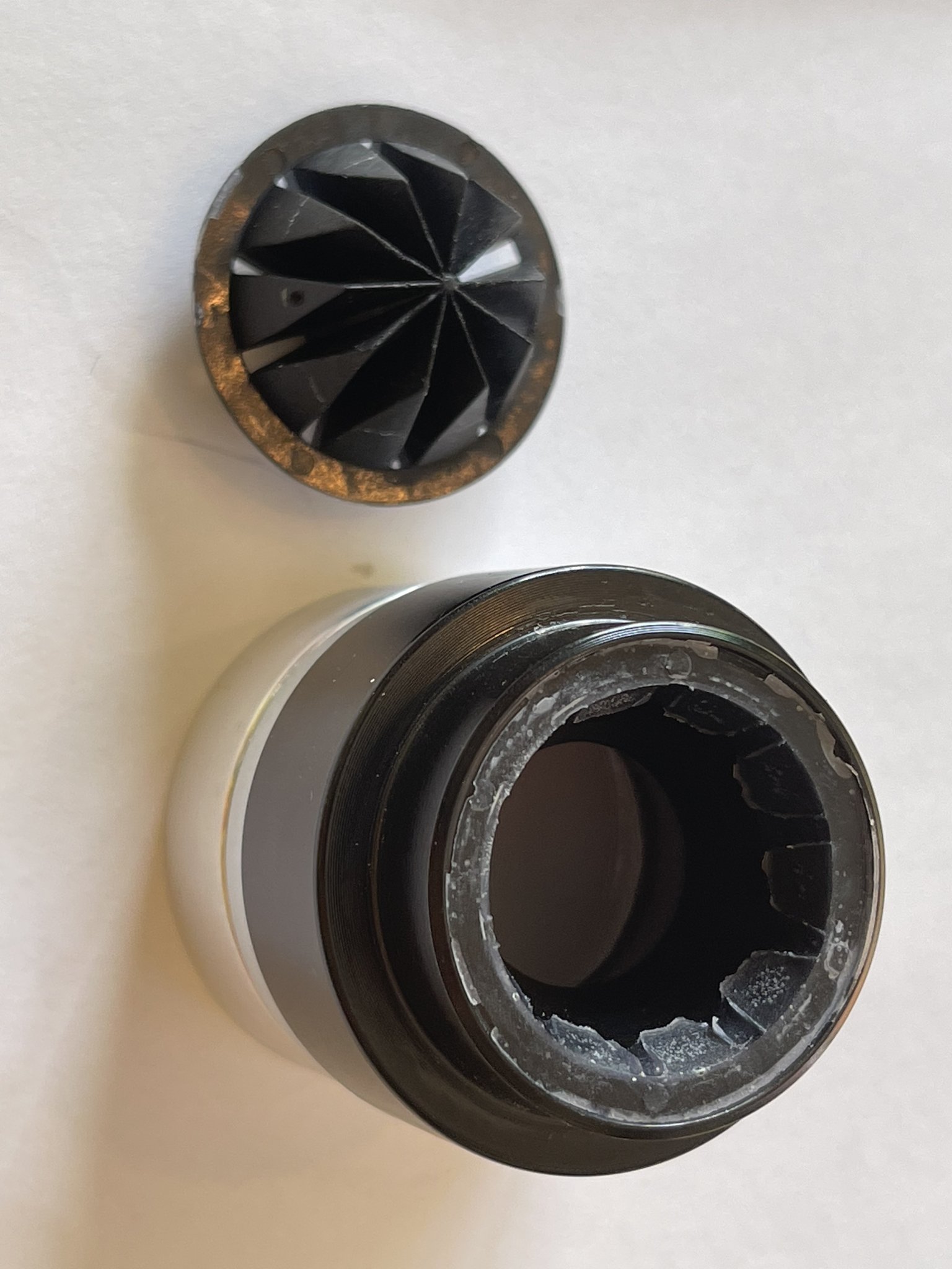

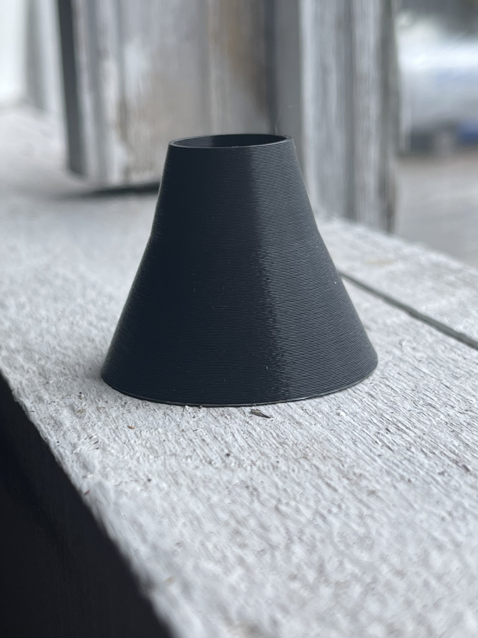

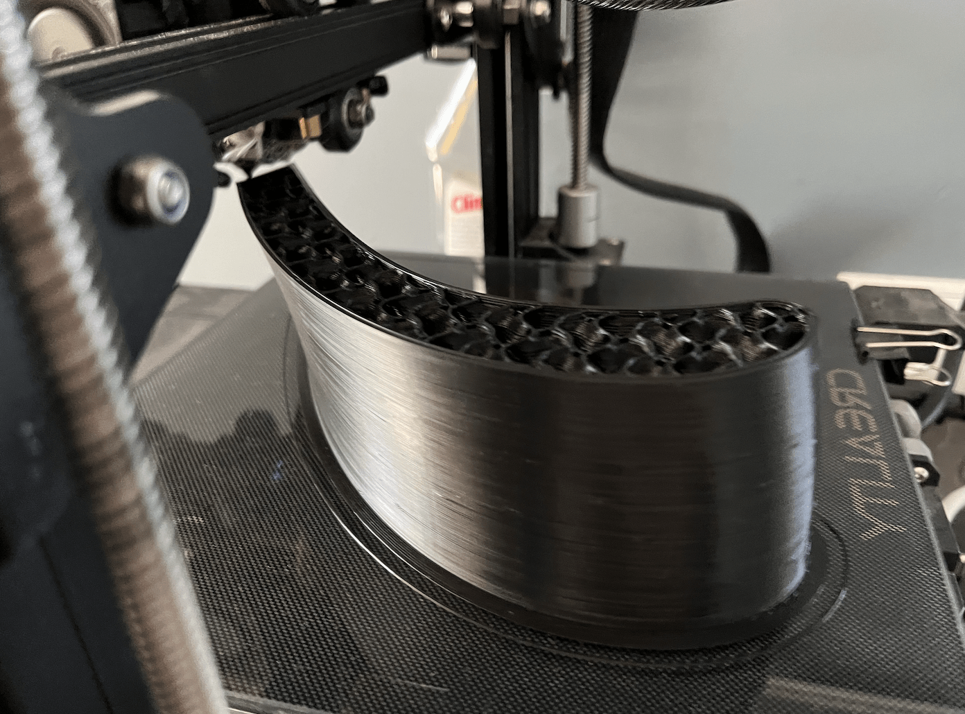

Sure is, I managed to get good measurements of the throat of the redcatt coaxial by knocking it of its glue joint so v2 as I showed in the image is printing right now. With a nicer fitting against the metal.
This test print of the surfaces that will touch fits really nice.

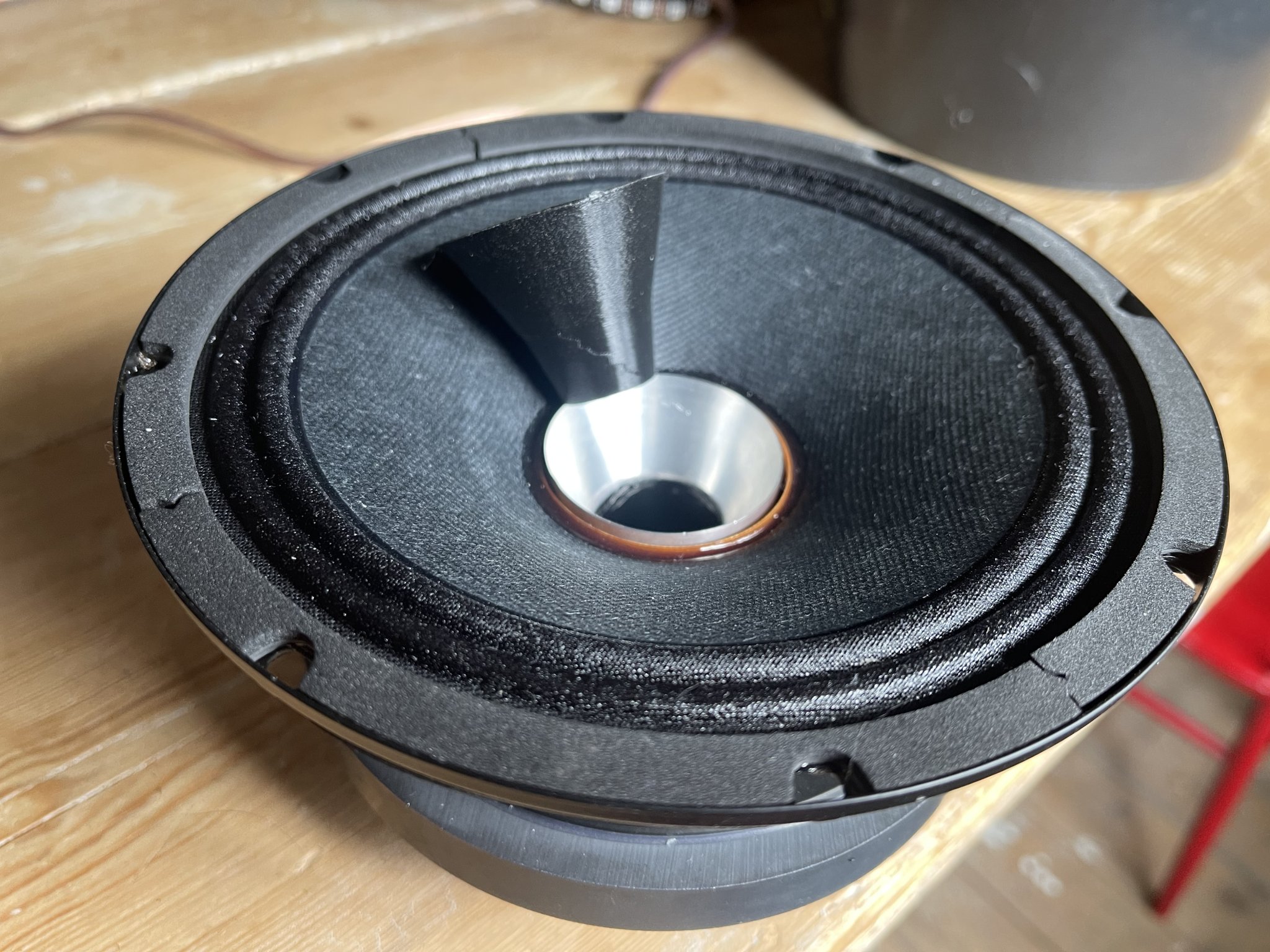

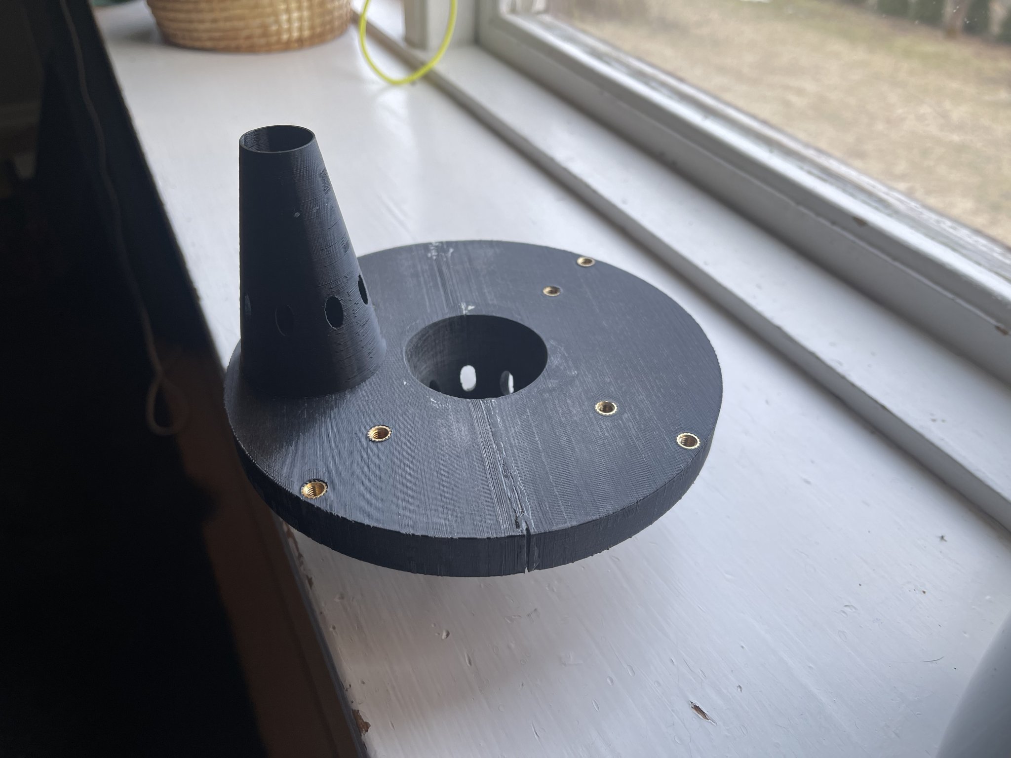

A big tip for co-entrant style multiple-entry horns;
The holes will f*ck up the hf response badly because of all the internal reflections.
This can be solved for a very large part by covering the mid-holes with an acoustic mesh (like a gore acoustic vent https://www.gore.com/products/gore-acoustic-vents-industrial-applications) with just about the right acoustic resistance (use the lumped part of abec to test this) to be "open" for the mid frequencies while being "closed " for the HF.
The membrane should be reactive, not resistive (meaning not porous)
hint; even a bit of painters masking tape could work..

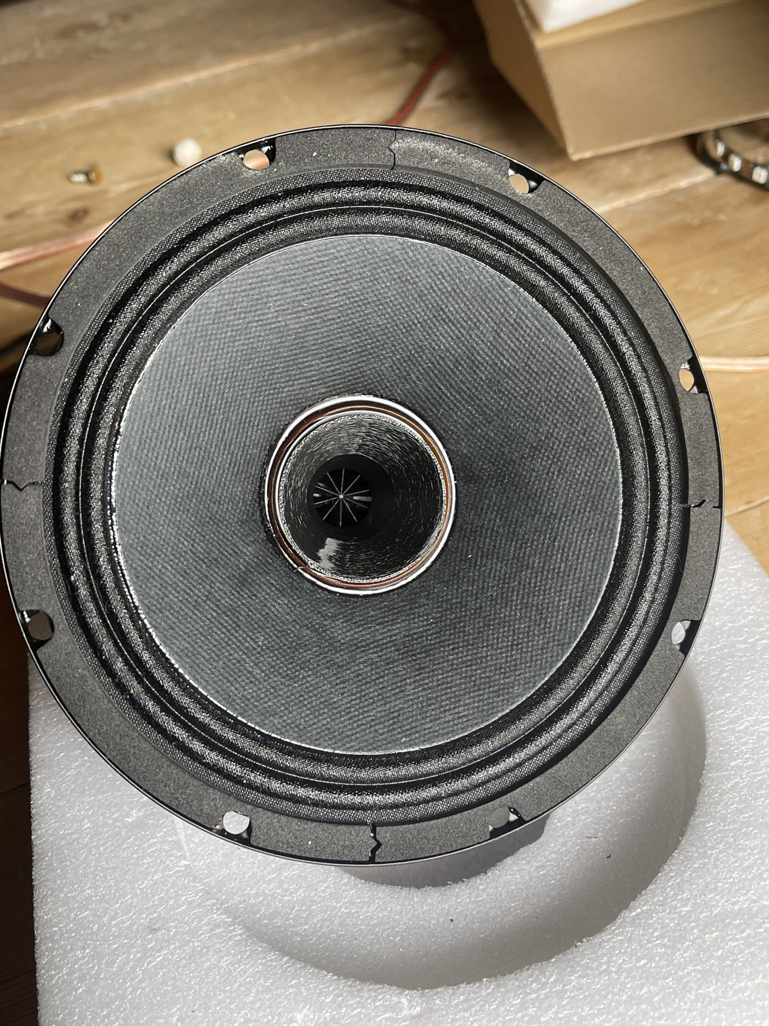

Absolutely true in what you say. I have tried using open cell foam from phase plug of the tweeter and up to the ports and I plan to try going beyond the ports as well.
But you gave me an idea. I will print a thin insert like the one in the photo but without any opening to see the effect with and without the midrange insertion ports in real life.

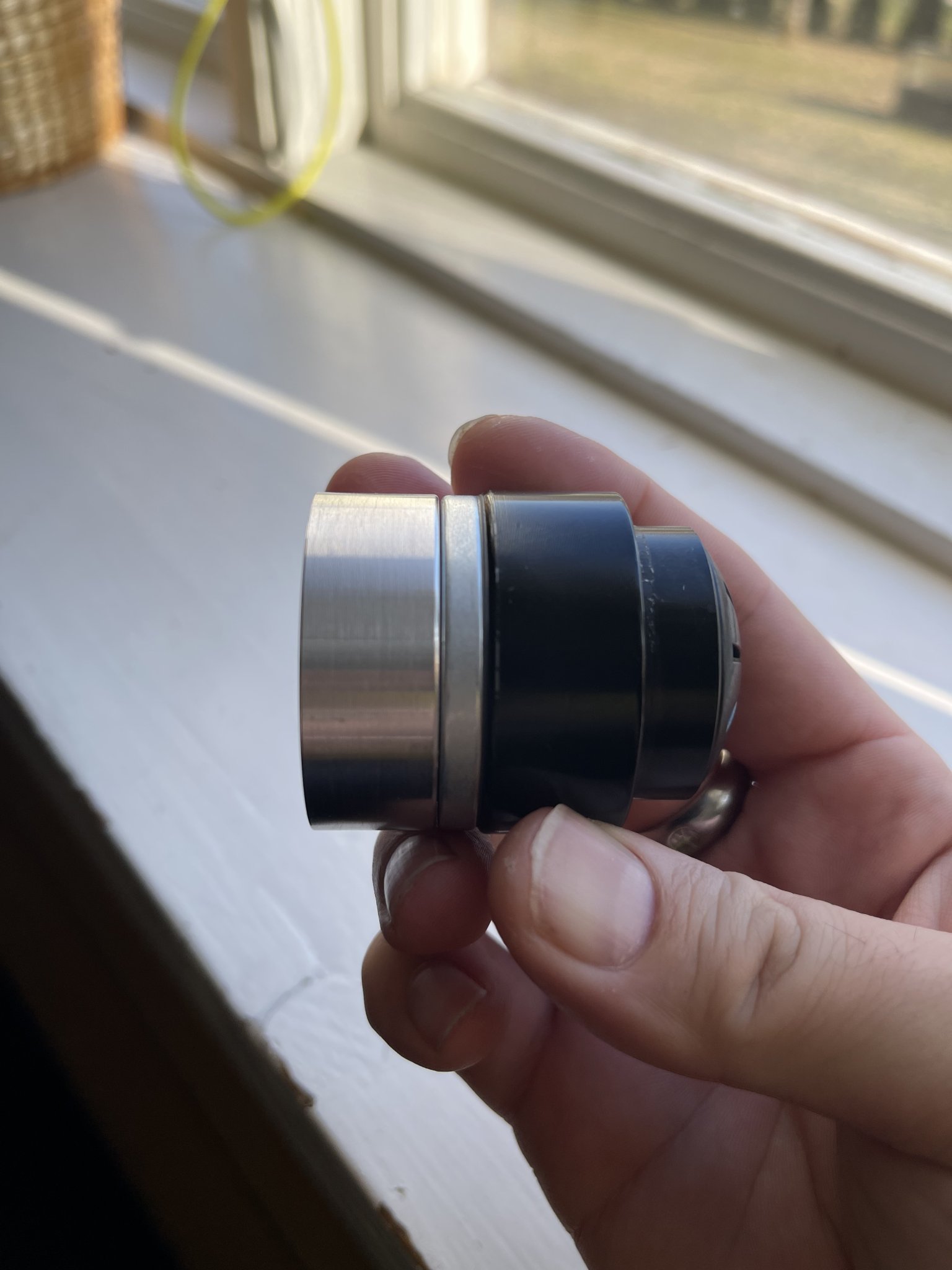

Maybe you can even try to remove the aluminum piece in your driver, as it should have no effect on the magnetic field.

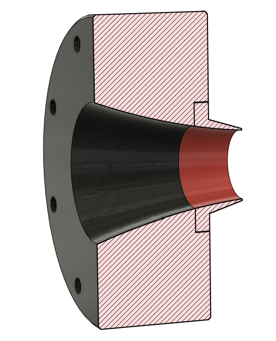

Greetings all,
can the documentation for printing provided by @mabat be used for (accurate) determination of dimensions?
The reason for my question is having a driver with unusual - threaded - mount (RCA 1428B), and as such I would have to design and print my own adapter. Consequently, I would need the dimension associated with the horn flange, including the initial angle and diameter of the input.
Kindest regards,
M
Joined 2004
I think there's no reason why you couldn't simply trace the contours of the STLs, as most CAD products probably have an STL import function. The STLs themselves are as accurate as it gets.
My recommendation would be to start with a suitable existing adapter and only modify the mounting, preserving the air path, if possible. They are all optimized and deviating from that can lead to a degraded result. Or, you can provide a drawing of the driver and I can try to make an adapter for that specific case - this is the whole idea after all.
I think I can add .DXF contour files and the associated drawings to the packages.
