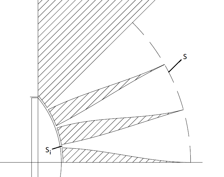

I think, that all depends on the frequency range in the question. If we considering a frequency range below the first cavity mode, then the radial pressure distribution p(r) in the chamber is constant in every point of the chamber. Then the volume velocity Q can be calculated just as ratio p/Zai, where Zai is acoustic impedance of the i-th slot (rho*c/Sd). However, in a frequency range above the first cavity mode the pressure distribution p(r) is not constant, thus, the volume velocity will be also dependent on the radius. Actually, p(r) is strongly dependent on a shape of the compression chamber (above the first cavity mode). If you want to optimize the driver, i.e. the phase plug, at the higher frequencies, first you need is to find the modes shape function of the chamber. For simple compression chamber shapes it can be done analytically. However, for complex shapes numerical solution is only available. But it is only one part of the problem. Another problem is coupling of acoustical modes of compression chamber with mechanical modes of the diaphragm. Thus, if you want to get best performance of the driver at higher frequencies you should to optimize both shape of compression chamber and shape of the diaphragm. All that was considered by Jack Oclee-Brown in his phd thesis
... (rho*c/Sd)...
*here Sd means area of the slot (not diaphragm) !
Thanks Dmitrij, that was the part I wasn't sure about. For one slot only, I could imagine it would work like that, but was not sure of what happens if more slots are added. Good.If we considering a frequency range below the first cavity mode, then the radial pressure distribution p(r) in the chamber is constant in every point of the chamber. Then the volume velocity Q can be calculated just as ratio p/Zai, where Zai is acoustic impedance of the i-th slot (rho*c/Sd). ...

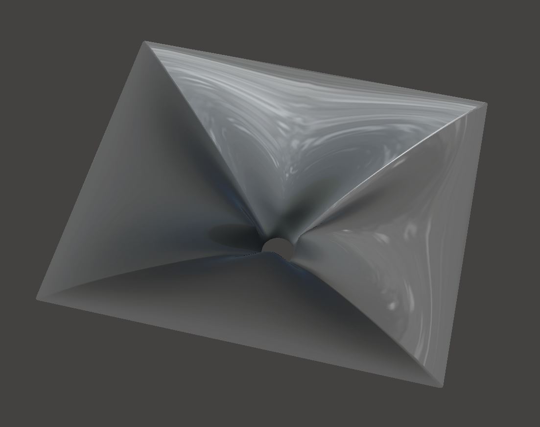

- For convenience, attached is the script file for a "JBL like" waveguide for the version 4.5.
There are maybe fifteen parameters affecting the shape - mix them as you wish (I didn't run BEM for this one).
I'd say that this particular piece makes a nice overview of possibilities of the tool as almost all the basic features are there. The exact opposite would be an OS waveguide.
In fact, based on the simulations (presented before), it appears that actually quite good results regarding the radiation pattern could be achieved by using just the dome/cap connected directly to a conical waveguide, i.e. without any phase plug. But of course you loose efficiency that way, there's no compression. Excursion would be higher and I'm not sure a common compression driver could hande that without excesive distortion. The frequency response alone could be smoother than with a phase plug though.Makes sense to me a circular cap in the throat of a horn has a wider dispersion than a piston.

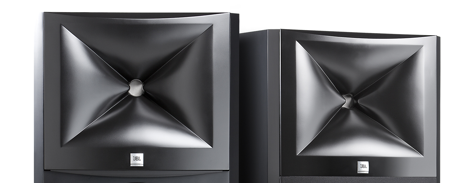

Your JBL (M2?) WG clone is similar to the original, however, there are some subtle but essential differences in the throat area.
The vertical trenches in the original are more pronounced and rather sharp edged.
The horizontal "knuckles" are partly covering the entrance.
The M2 WG is clearly a modern variation on the classic diffraction slot.
The more I think about phase plugs the more I realize I probably don't understand even the most basic principles. After reading Dr. Geddes' patent I still wonder what is actually the sufficient and what the necessary part. However I'm lucky enough that I can ask you here.
What I understand:
It is desirable to have a uniform volume velocity across the surface "S" (see the drawing attached).
What I don't understand:
Is the volume velocity at the entrance of each particular slot "Si" dependent not only on its (projected) area but also on its actual radial position and the respective positions of the other slots?

As someone else pointed out, as long as the wavelengths are longer than the dimensions there will be a constant force/ pressure at each opening. But our situation is even simpler.
That's because our chamber is very very wide and very very short. This means that only radial resonance are an issue. This is precisely what Smith studied way back when. He analyzed the possible resonances across the chamber by assuming a flat space. Then he found the best places for the channels to avoid these modes.
The problem is that these modes need to be excited to be of concern, and they are not excited by a uniform piston to any great extent, so they aren't an issue - as long as the diaphragm has a uniform vibration. But when it doesn't, then this aspect makes the acoustic resonances irrelevant because the mechanical ones will dominate (except in the rare instance when the modes match, which is almost impossible.) IMO this makes Smith's approach not very useful. And, in fact, his own data are not at all conclusive that his approach was any advantage at all.
What I proposed to do was to have a phase plug that would allow me to control the volume velocity (VV) contour at the phase plugs exit. This is because it is know (it's in my book so at least I know it) that one does not want to excite an OS waveguide with a perfectly flat wavefront, but instead one that has a gradual change in VV. This will suppress the first HOM if done correctly. The second HOM can also be suppressed but with a much more elaborate calculation.
So in my mind it is the ability to control the phase plug exits VV contour that is desired and not the approach of Smith, which has not been shown to be effective.
