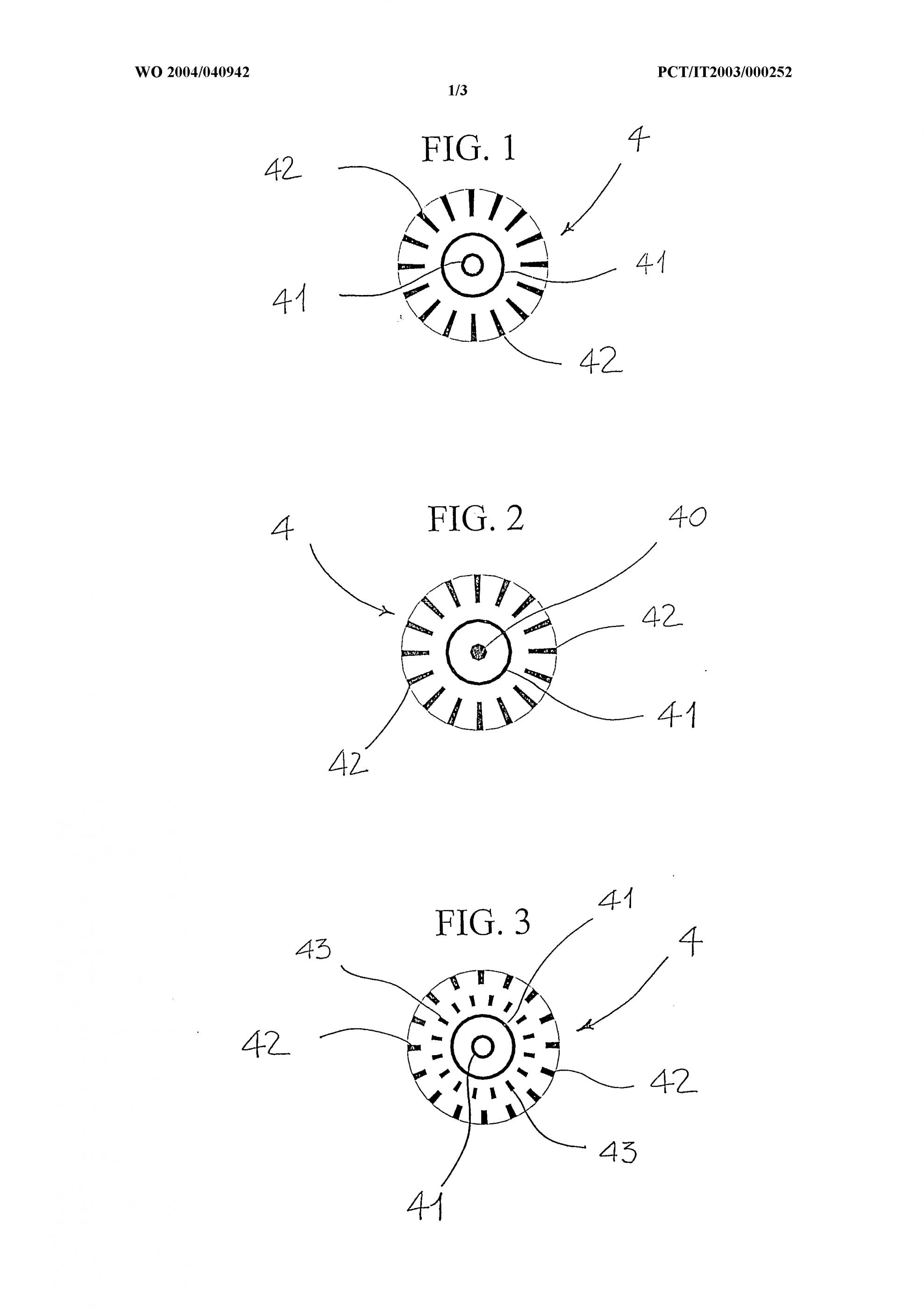

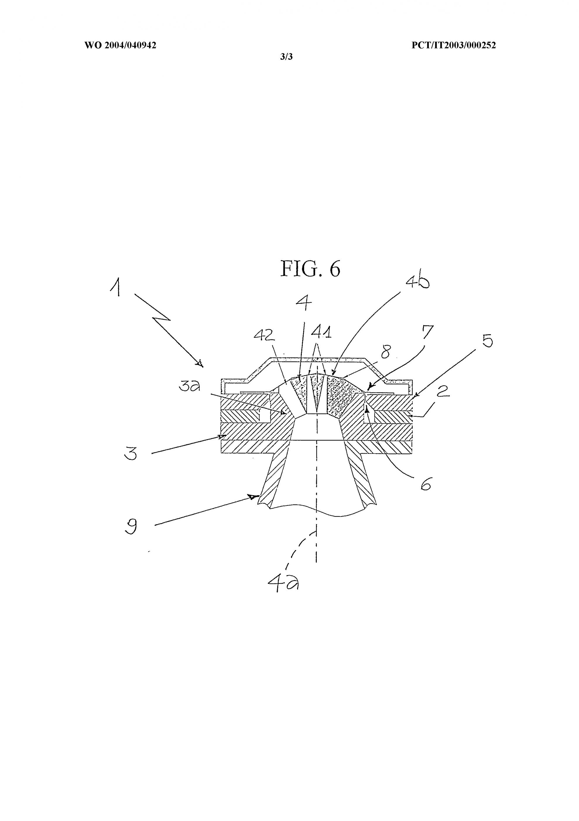

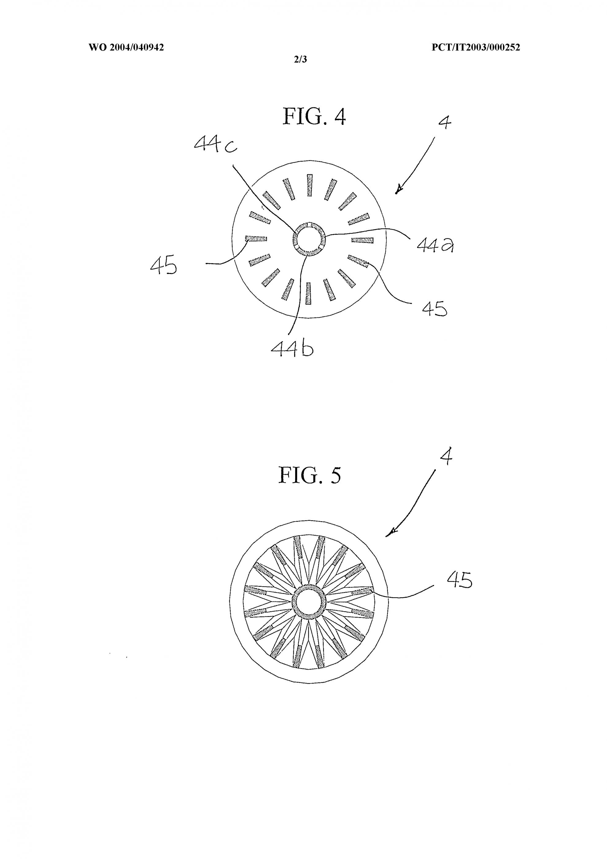

It seems to me that what he is referring to actually should be an inherent property of phase plugs in general, even before sound enters the waveguide:... But the take away point for this thread is that these waveguides won't have the problems that Dave showed. It is always much more effective to get rid of the problems at the source than try and cure them after the fact.
"The openings in a phase plug are arranged in such a way that, from any point on the diaphragm, the path to an opening is relatively short. The designer of the compression driver intends for all of the sound power produced within the driver to leave via the “nearest exit”. However, a significant fraction of the sound energy arriving at a phase plug opening will either continue past it or reflect back from it; in either case arriving later at other phase plug slots where the sound is divided again, ad infinitum. Rather than a single acoustical impulse, the response exhibits a decaying sequence of impulses."

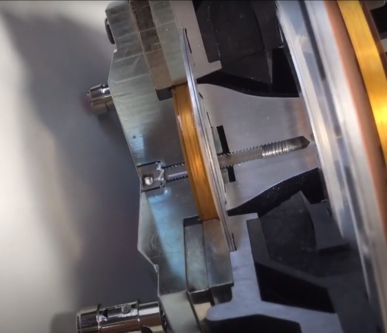

The volume of the throat chamber formed by the distance between diaphragm and phase plug creates an acoustical band pass, cutting off HF response. You can model VTC in Hornresp and see the effect.Couldn't a thin layer of a soft fabric (maybe wool) placed between the diaphragm and the phase plug, basically dampening the compression chamber, be beneficial? I understand that the acoustic velocities are small there but nevertheless.
BTW, what are the common distances between diaphragms and the plugs?
For output to 16-20kHz, the distance between diaphragm and phase plug is held to under 1mm, regardless of diaphragm diameter or composition.
The slits in the phase plug are optimally twice that distance, <2mm.
Art
18Sound's 3P Patent.
"The Proprietary Phase Plug (3P) technology identifies a combination of radial and
tangerine slot geometric design. With its short openings and high flare rate value, 3P
technology assures low distortion in the mid-high frequency range, providing a smooth
coherent wavefront at the horn entrance."
AFKJgEQMEz5z8PFmYTaqXVxSX5RQ6n2PvP-q8e4Hu_5kuK0KHIJQq-VBw1RvS5Jbjaf_55dh-N-vxexqsZ3JyrqEKmLCfkck.jpg191.4 KB · Views: 452
6BpTKpgZAtXtSCKCbtOJuWMiXLcsOKclS_eDuaAfBJ6YRYQ8vnAihI2kP2bRYLu1NeC8mIsNvKkWI-LWX5pwvez-s61M_AP4.jpg205.5 KB · Views: 448
7ciKDwCsnkR0pN3K4G4Soe2e97LBssaJC1eLhXruoD2EpnFB2pUN2LyIJCoD-giuxcUbsRUjmAENzZbh06QqbeHp3-V87fdA.jpg198.4 KB · Views: 439
WO2004040942 - EQUALISER, OR PHASE PLUG, FOR ELECTRO-ACOUSTIC TRANSDUCERS.pdf582.4 KB · Views: 166
