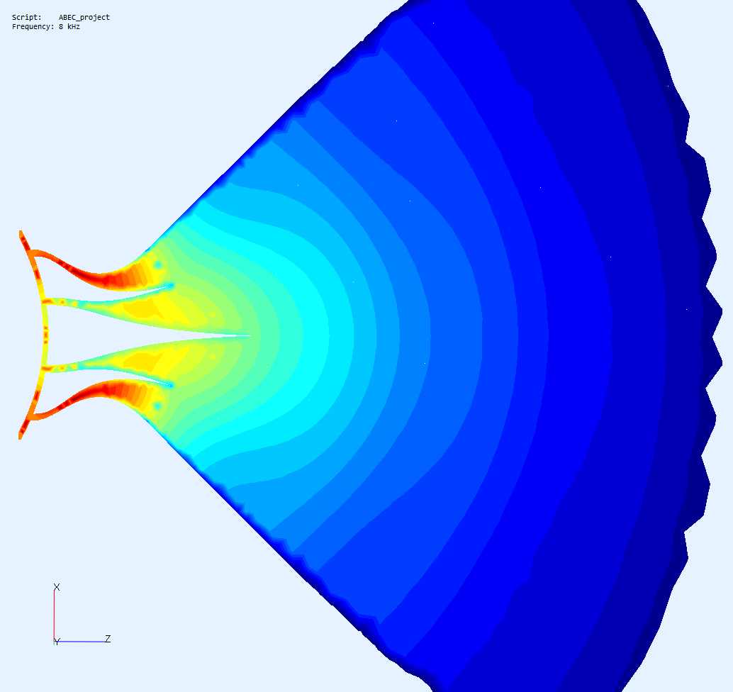

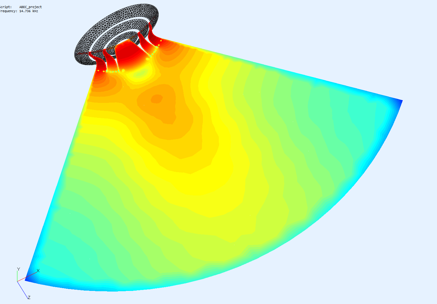

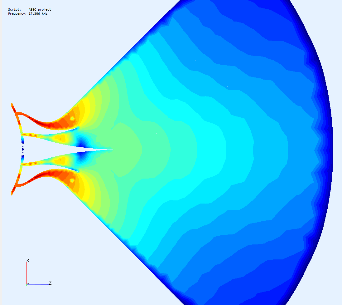

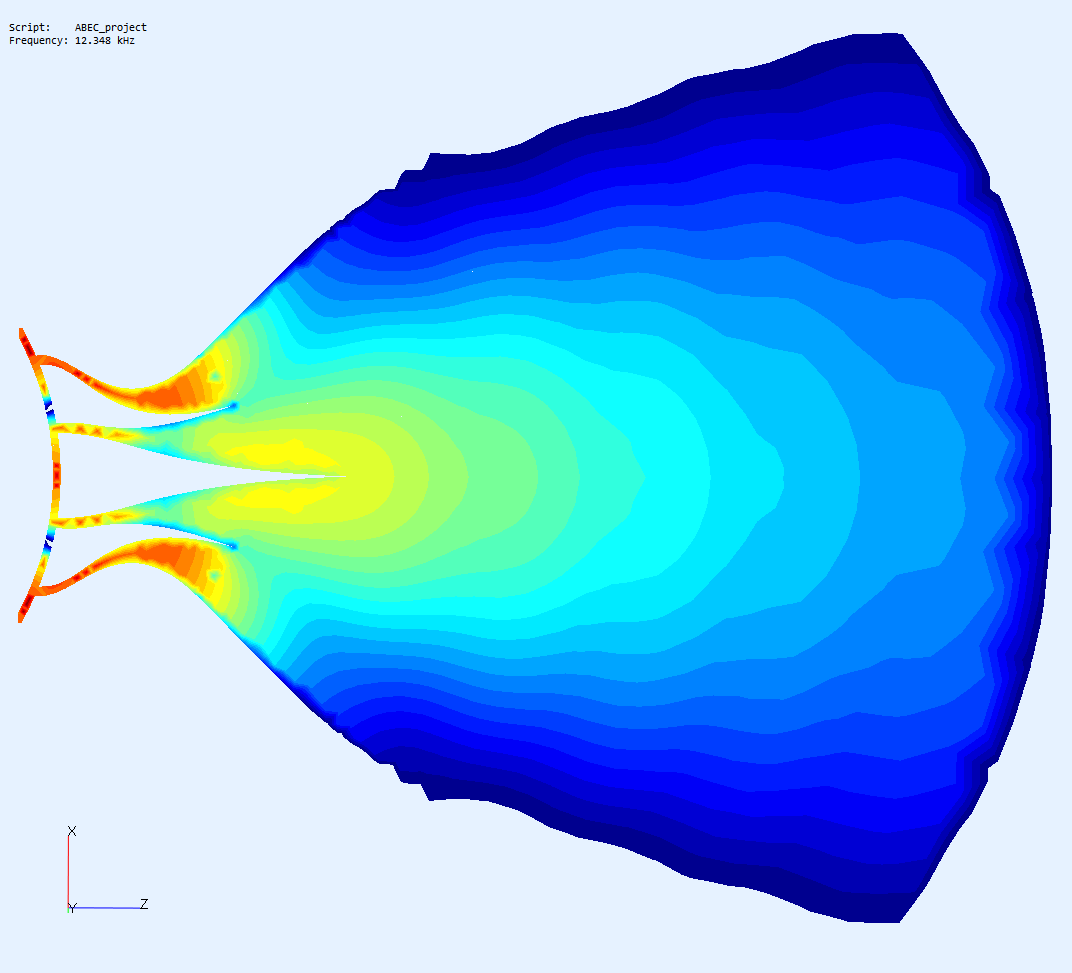

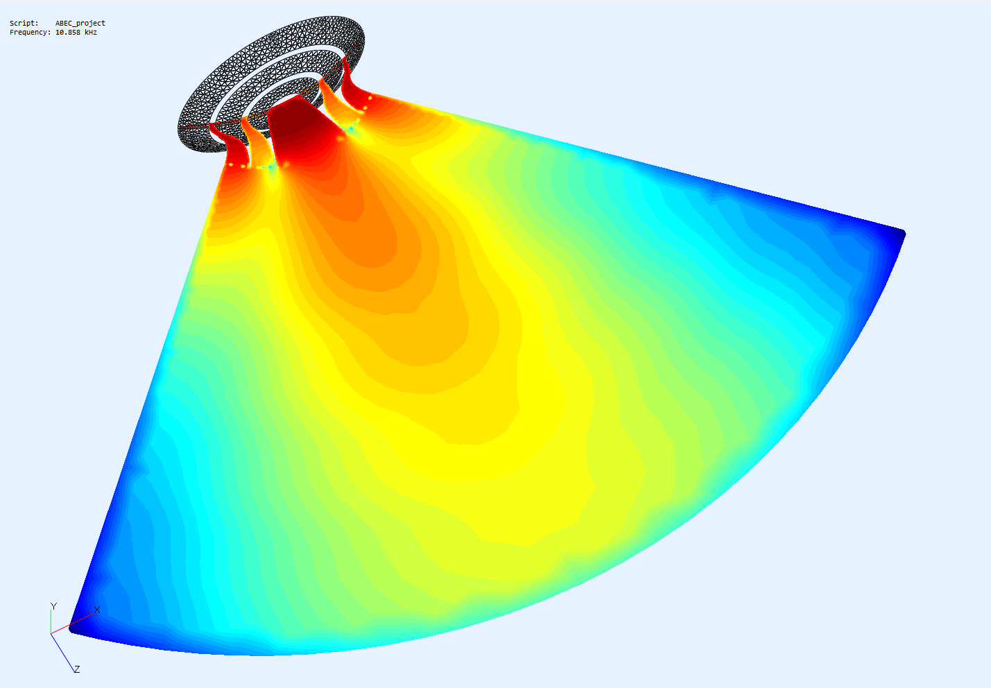

There are still some ugly things however, mainly because of the cavity modes and the reasons why they occur. This was expected as the design was not really optimized yet in any way -
But it's quite interesting to actually see these images.

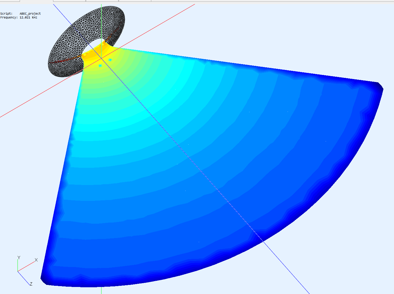

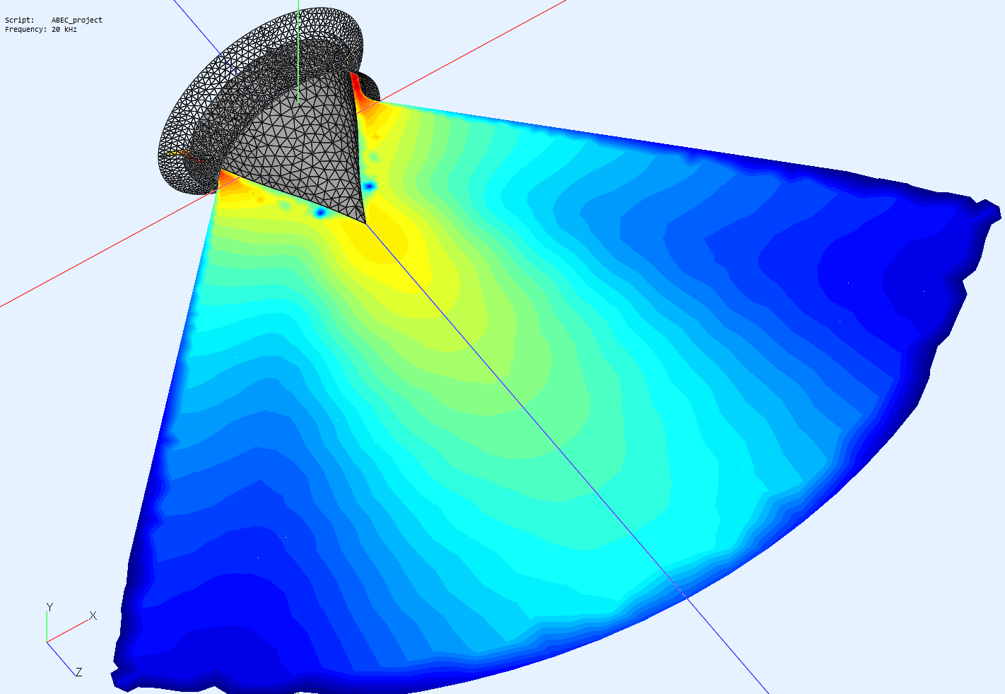

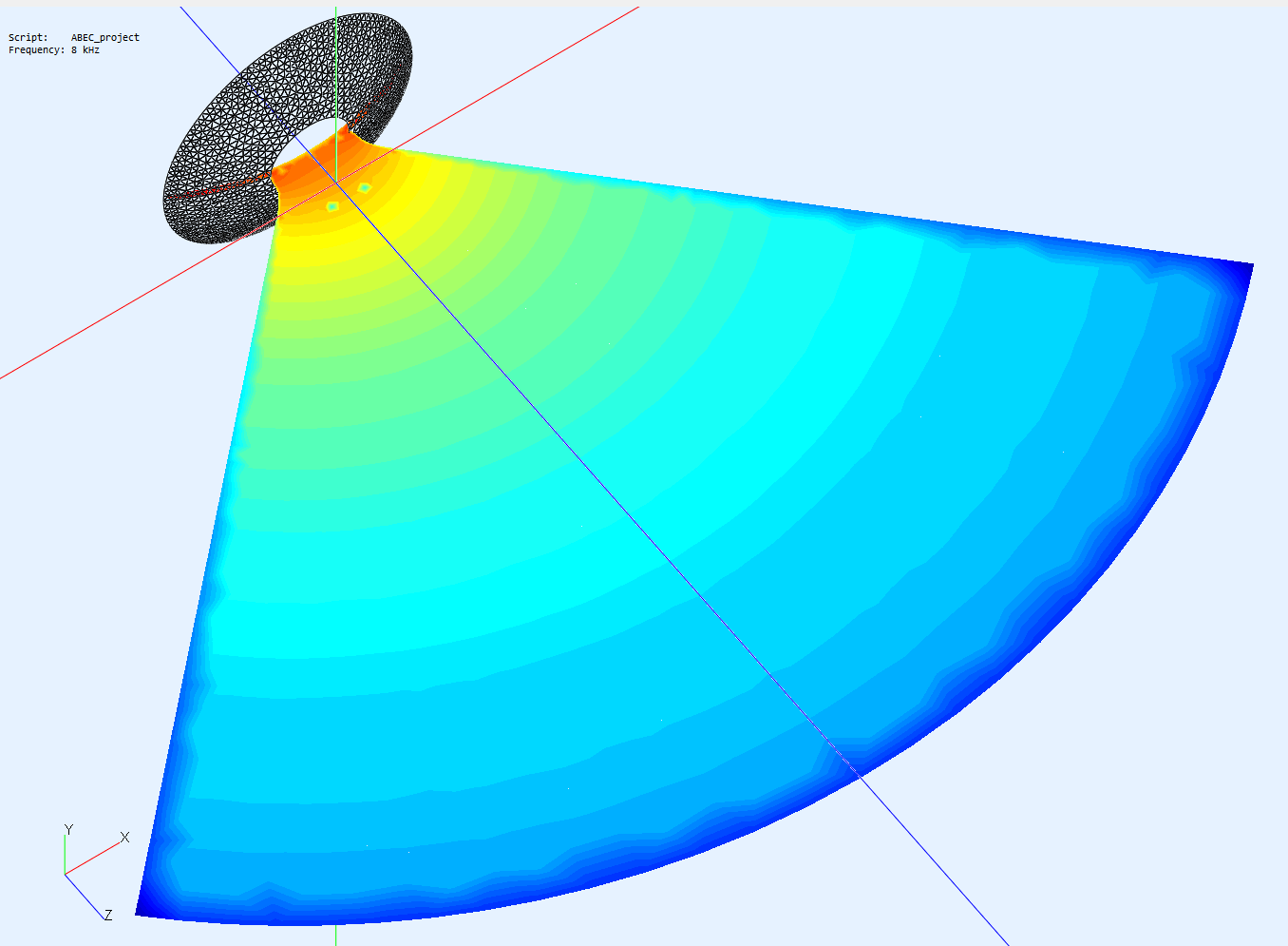

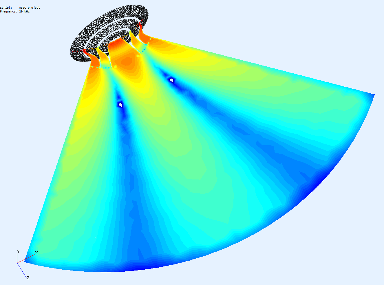

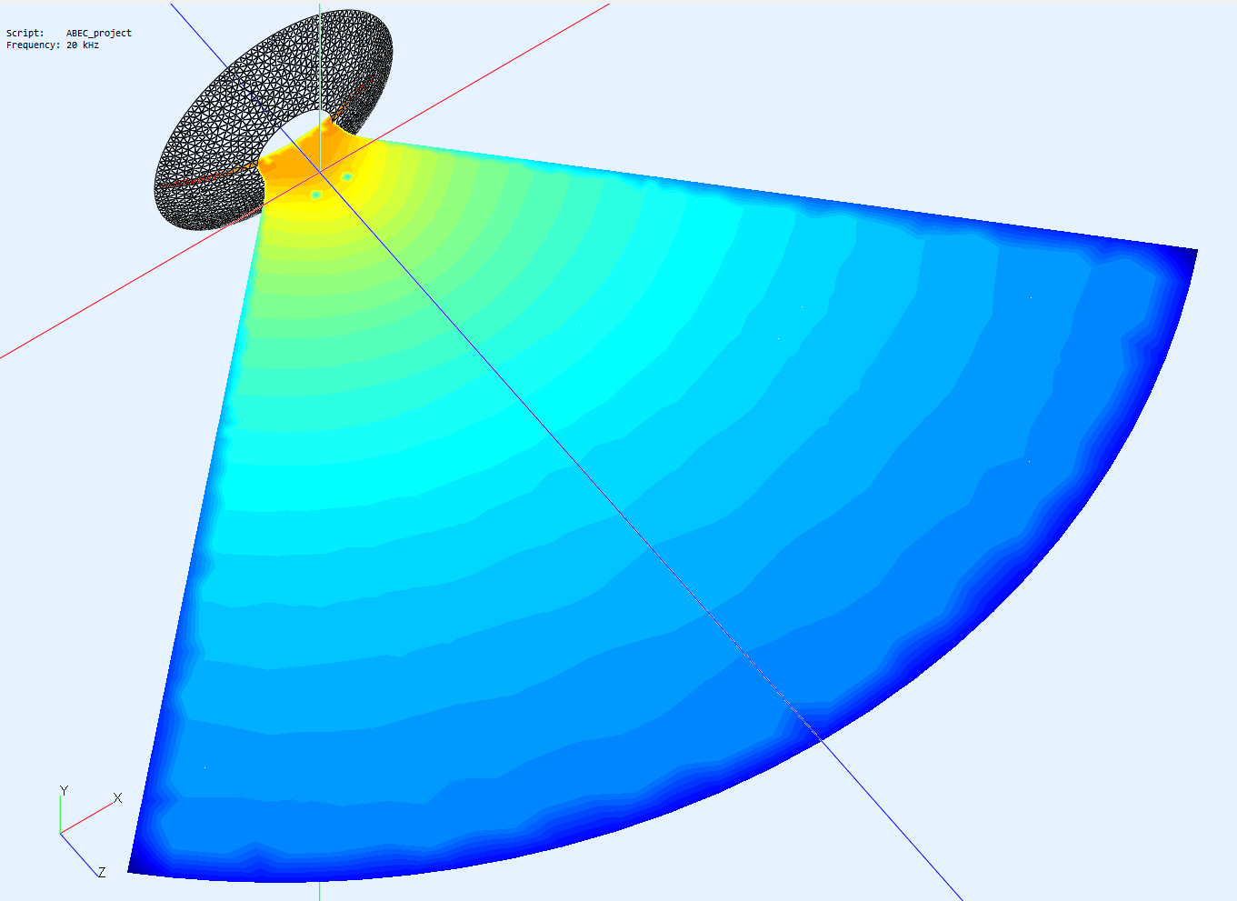

Or just add a central sting - 10 and 20 kHz![]()
This morning I wanted to suggest to experiment with "an open chalice" as center channel to see how it works out.
The trouble is that the contributions of the channels are dependent on pressure distribution in the chamber which is far from uniform. And as this distribution is determined by the acoustic impedances and positions of the channels, it's really not very straightforward. The guys at KEF/Celestion have apparently some papers on that, which I haven't seen yet.
Now I'm more wondering, why not to leave there only the central channel? Overall SPL cancelations? I need to add some absolute SPL charts vs frequency.
Not much, and in fact this is just what it takes.Is there any curvature in the center channel?
Yep, that's really just a cap with a hole placed over a convex dome diaphragm. There must be some other problem however, otherwise it would be too easy.However, the center hole (in a spherical cap?) is interesting.
