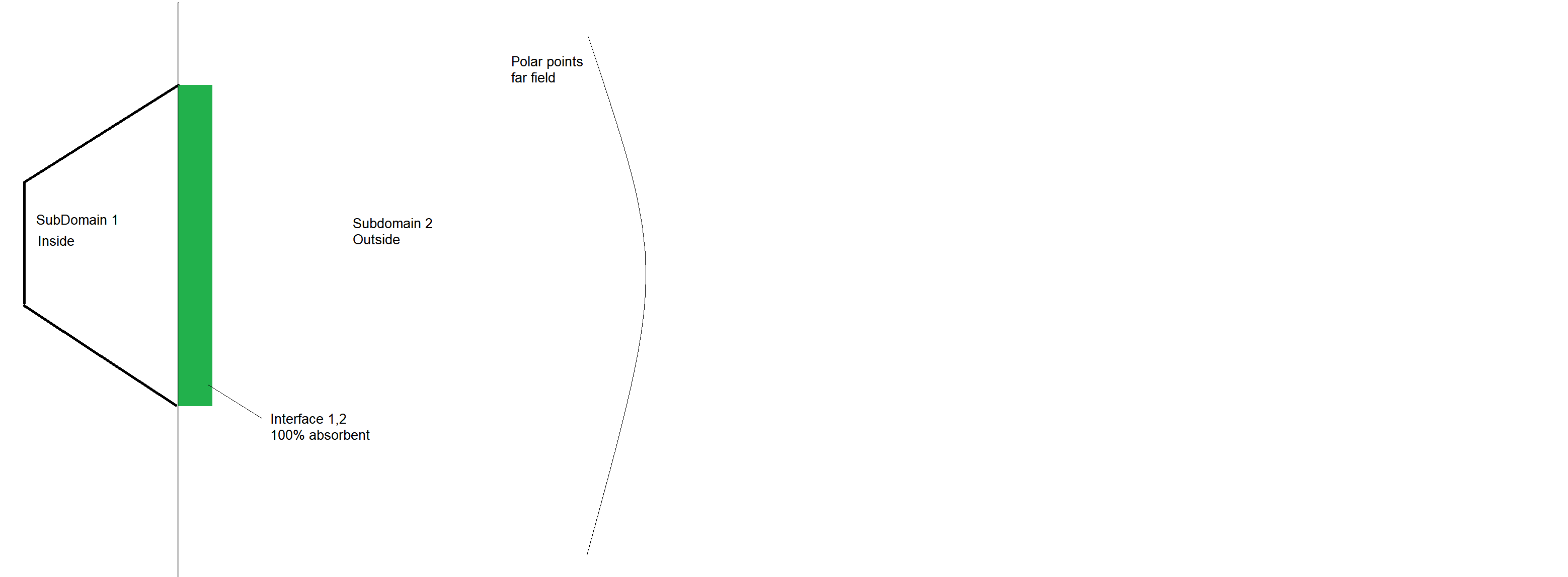

to obtain a far field polar and stil have a perfect temination, ABEC lets you add absorbtion to interface layer.
So you could couple your straight horn to the interfacer layer interfacing between the horn an the outside world and than make the interface layer completely absorbent.
This way you can exclude all the mouth reflections (basically having the perfect mouth roundover) and 100% focus on the effect of the phase plug.

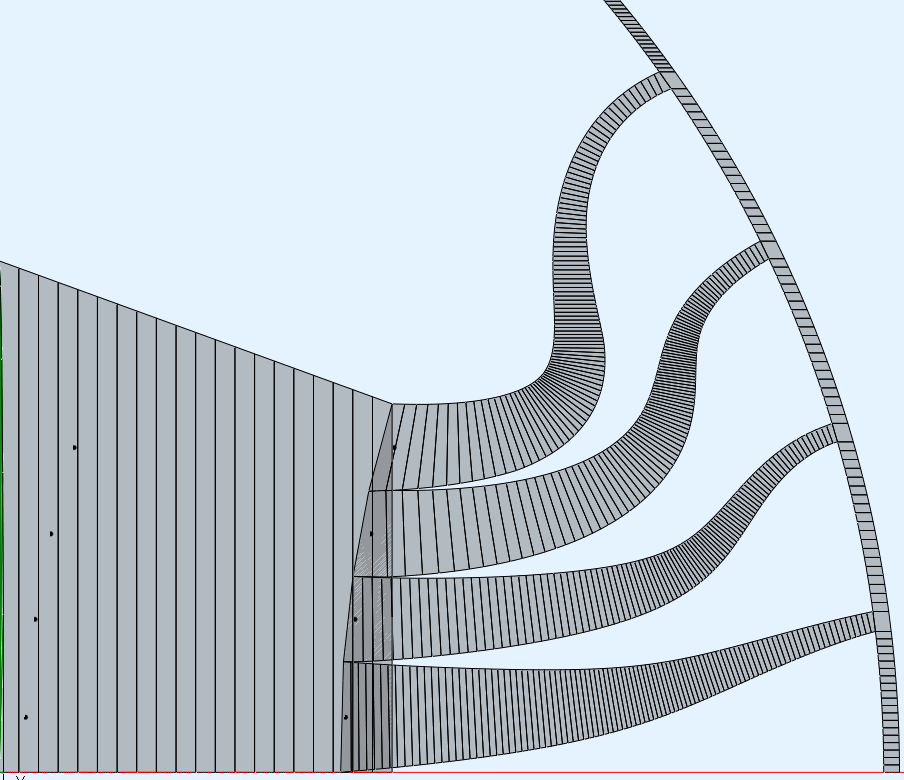

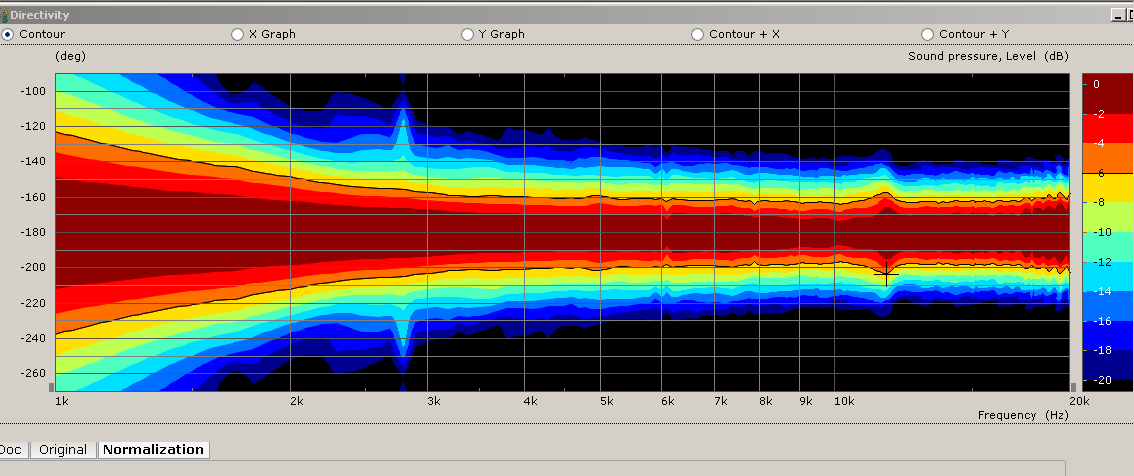

I have created a custom 40 degree phaseplug fot an excisting 4inch compression driver for a customer in the past following these rulses.
If you do this well, you van just go directly to conical from here on and if works well.
The attached directivity plot is a sim with the horn in freefield conditions, so no infinite baffle.
The 3D printed protoype performed nearly identical to the sims, but the cutomer found the phase plug too expensive to produce, since its feutures a 4 channel slit which needs very low tolerance CNC-ing.
I am sorry that I can't share more details, since the customer paid me to do this for them.

Sorry I am not explaining myself properly;
use the interface layer to couple to an outside domain (via the infinite baflle) and make the interface 100% absorbent, now you can make a far field directivity plot with point laying in the outside domain at i.e. 50m distance
Are you saying that there will still be a wave propagation behind the 100% absorbent interface to the outside domain? That would not be my guess, I must admit. Thanks for the picture.

One final tip (probably the most important one, costed me days to figure out);
as you can see in my excel channel overview I keep all channels equal length. this is mandatory to get equal loading on all channels, if you fail to do so you get all kinds of extra resonances.
So I create the needed time delay for the wavefront curvature by physically placing the excits of the channels.

Kees, looking at the channels of your phase plug, it seems that you've created a "stepped plane wave" at the exit. So is it really good enough to be connected directly to a conical horn, as you suggest? If that was the case then a concave side of the diaphragm could be used. For a long time I considered this to be impossible. Yet you seem to have succeeded.
Yeah I think it is possible (as I have seem to have done it ;) ) the stepped thing is relative to the wavelengths involved but has a bit tolerance as you will see.
My advide; take it step by step;
1-define where the input of the channels will be located by the steps I described before
2- define where your outputs need to be phyusically located to ge the desired wavefront
3-define the compression ratio you want to achieve (this will affect loading but also nonlinear distortion which can not be modelled by ABEC, I suggest lowish for hifi, like 1:7 for instance)
4-model the channels connected to the compression chamber but UNCONNECTED to a horn but all terminated by perfect absorbtion at the end, put measuring points right at the end of each channel and match the amplitude within +-1dB and the phase within +-10deg .
This is the hard part, play with curvatures en shapes as much as needed to achieve the goals
5-attach horn and verify goals
6-3Dprint
7-build speaker
8-have a nice drink and enjoy incredible sound ;)

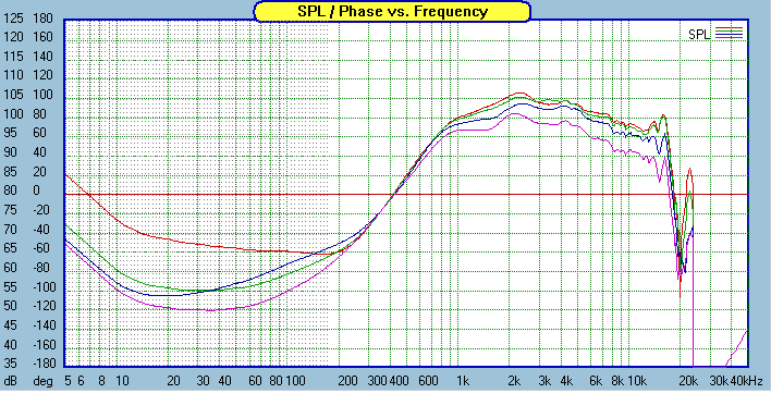

For instance, here's the polars of QSC's QSC PL-000446-GP waveguide, with the Eminence N151M. I've been raving about this combo for months; costs less than $100 and I'm not aware of anything that can beat it for under $100.
attachment.php
In the attached image, we see the response of the B&C DE250 on the same waveguide. The B&C is good but the Eminence is better. The Eminence is cheaper, it's more extended, it's smoother.
If I'm understanding your post correctly, I have a hunch that the superiority of the Eminence may be due to the larger exit angle? It has an unusually large exit angle - about 35 degrees.
Taking this a step further, one might argue that the oblate spheroidal geometry is a bit of a "band aid" on this problem: it minimizes the effect of the transition from a narrow throat angle to a wide horn angle. But perhaps the ideal solution is to fix the phase plug, so that we don't need that transition from throat to waveguide at all.
IE, if I want a coverage angle of 90 degrees, perhaps I need a phase plug that produces a wavefront of 90 degrees?
