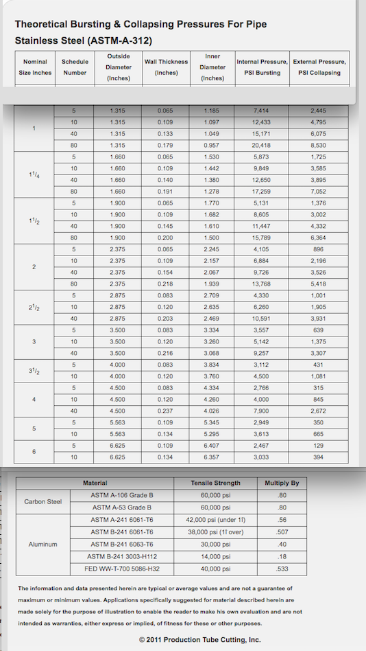

As Curt Graber (designer of the loudest acoustic speaker system in the world, and perhaps the best midrange compression drivers ever produced) put it to me in a phone conversation 3/22/12, “a compression driver can "go ballistic" on the forward pressure side, but is limited to pulling a vacuum on the negative”.No such target yet. I still don't understand why there should be any difference in this regard (convex vs concave). Aren't the forces the same after all? Isn't it only a coincidence?
The resistance to compressive forces compared to rarifaction forces regarding convex vs concave can be compared to the bursting and collapsing pressure for pipe.
Looking at the thinnest wall thickness (.065 on the chart below) for 1” pipe, we see a 3/1 ratio in favor of bursting (concave) compared to collapsing (convex).
Going up to 4” pipe, the ratio goes to almost 9/1 using the same wall thickness.
To get down to the 3/1 ratio would require 3 times the wall thickness and weight.
An increase in diaphragm mass reduces high frequency output (mass rolloff).
A reduction in diaphragm thickness increases flex, while diaphragm motion must be limited to about 1mm from the phase plug to reduce the acoustical band pass HF rolloff.
This all leads to a balance between the minimum thickness diaphragm that can withstand the pressures encountered without flexing resulting in contact with the phase plug or too much anti-phase behavior.
Putting the diaphragm in the convex (dome towards throat) compared to the usual concave (dome away from throat) requires a thicker, heavier diaphragm to withstand the forces.

Yeah, but during the waveform there isn't just compression or rarefaction. There's a cycle where the two are repeating one after another. It still seems to me that you are speaking about only a chosen half of it. During the other half the situation is just reversed, isn't it?The resistance to compressive forces compared to rarifaction forces regarding convex vs concave can be compared to the bursting and collapsing pressure for pipe. ...
