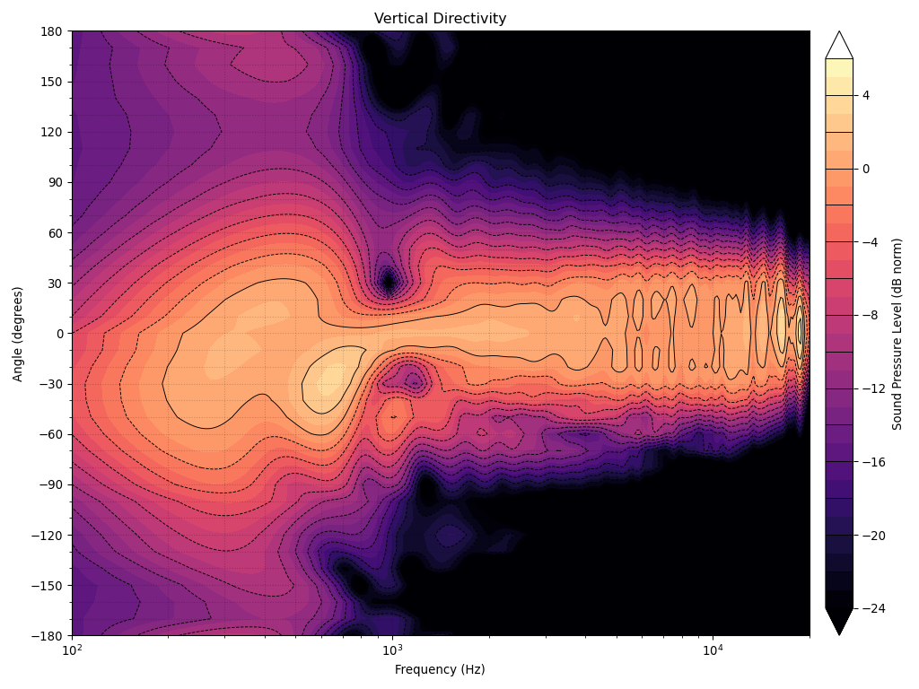

The driver spacing is 32cm (12.6in) and the crossover is 1050Hz, so they are about one wavelength apart. I didn't do any simulations of the complete loudspeaker, only the waveguide. Maybe I would have if ABEC3 was easier to use 🙄.
Here's the vertical contour plot, which I didn't post before:
attachment.php
The crossover slopes are fairly steep (LR6 acoustic), so the nulls are narrow and have little impact on the sound power.

Here's the vertical contour plot, which I didn't post before...
Thanks for the extra plot.
About as expected, for the separation and crossover slope you have.
As you say, not too much impact on sound power.
It would be nice to reduce it even further but eventually this starts to compromise the on-axis behaviour.
I'm not sure yet where the best trade-off is but think some overlap is desirable, as you have done.

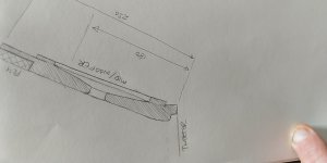

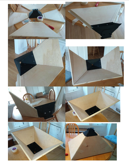

Hey team.
I am designing my own version of a 3D printed stubby I first saw made by bwaslo.
I am using different drivers so it's a complete redesign. I am hoping to have the plywood attached on the inside so I can simply use spacers to get the ply perfectly aligned with the 3D printed section.
So the question is, can and how do I tell ATH to transition fully from the round throat to a rectangle at 180mm up the wall, then continue (fully flattened) from 180mm to 250mm?
Hope what I am asking is clear.
Cheers
Dean

I don't follow this part: "...continue (fully flattened) from 180mm to 250mm". Why the extra segment? Maybe a sketch would help.
I could also add an option of a true rectangle for the guiding curve, without any corner radius, if that's what you want. You would be limited to STL output but that should not be an issue if created with high enough resolution.
Without the terminating term (Term.s = 0) it could be connected to a straight-wall extension like that.
Ok so I need to make sure the lower section of approx 180mm is fully transitioned from a circle to a straight sided rectangle before I can do the cutout for the ply in the second upper section.

I'm still not sure I understand. Anyway, you can't make a flat wall with OS profile. It flattens with distance from the throat but is never exactly flat. There's no way how to do that with Ath at the moment. The best you could probably do is just to connect the "almost flat" OS segment to the plywood.
Ahhh got you... It is the current os profile I have tried that has some curvature in the horizontal plane, which is intended for os, I just need the last 50mm to be dead flat towards the mouth.
Ta for input. Will post the stl if I get to to work.
