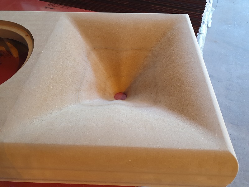

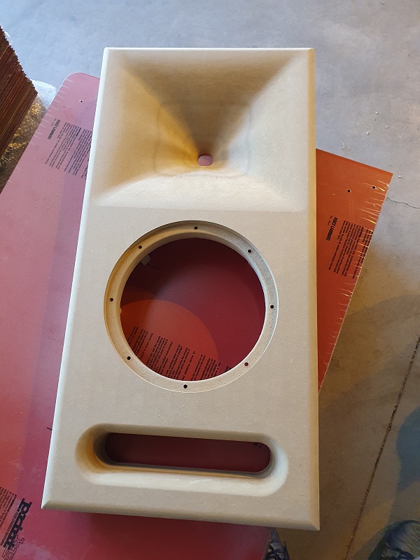

In the meantime we are progressing on Tritonia baffles (milled from a solid MDF block) -
Wow, looks amazing!
HF1440 is worthing some 650 to 750 XO in order to be married to a Faital 15PR400 - 2 ways in mind JBL M2 for "poors". However as a noob I don't know if those frequencies as cut-offs are suited to a 15" off axis ?
Do you plan to provide cnc/sell readymade/accept donation for a ready made horn/front bafle for the non hand gifted?
