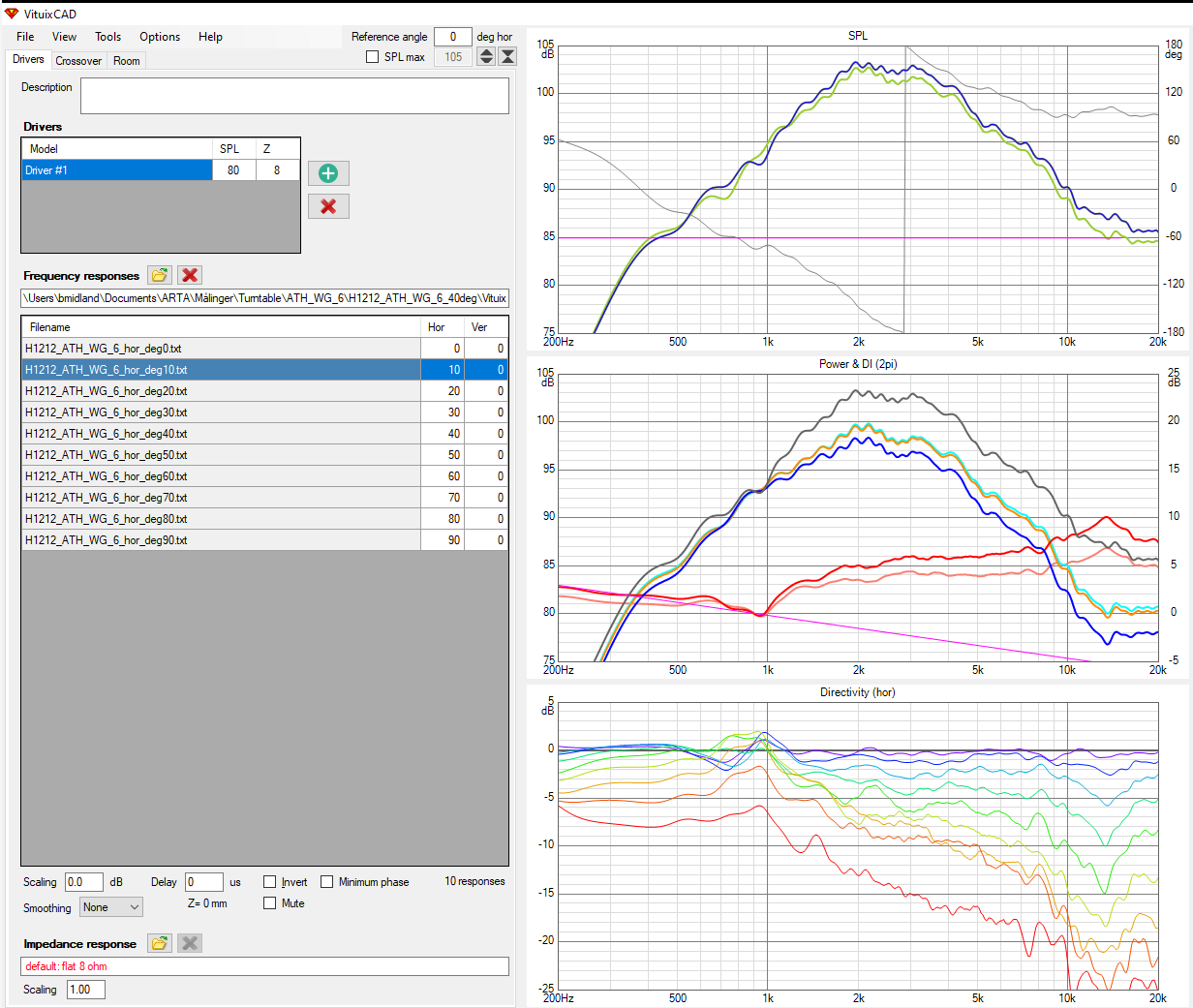

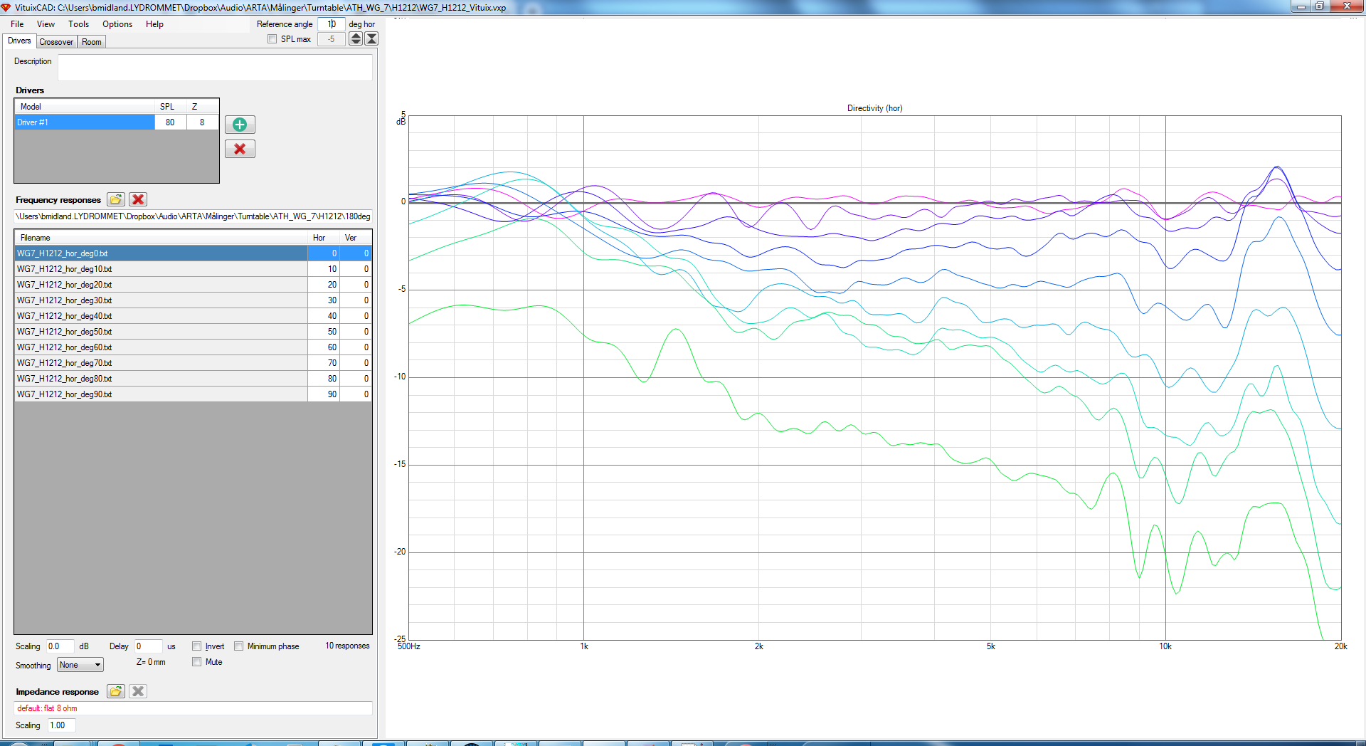

Nice, I suggest you to use VitiuxCAD tool to convert pir files to the frequency domain (a breeze to use by the way) and then you can see polar maps at your convenience
Thank you for this tips. I have not used this before.

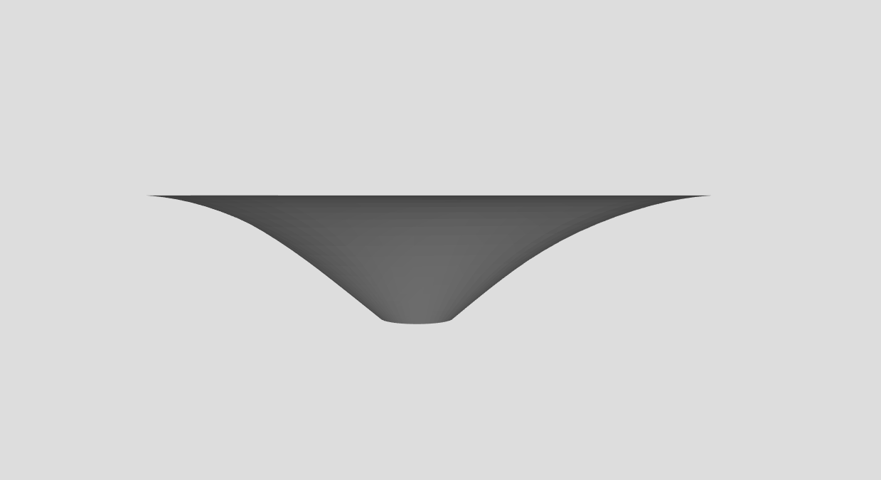

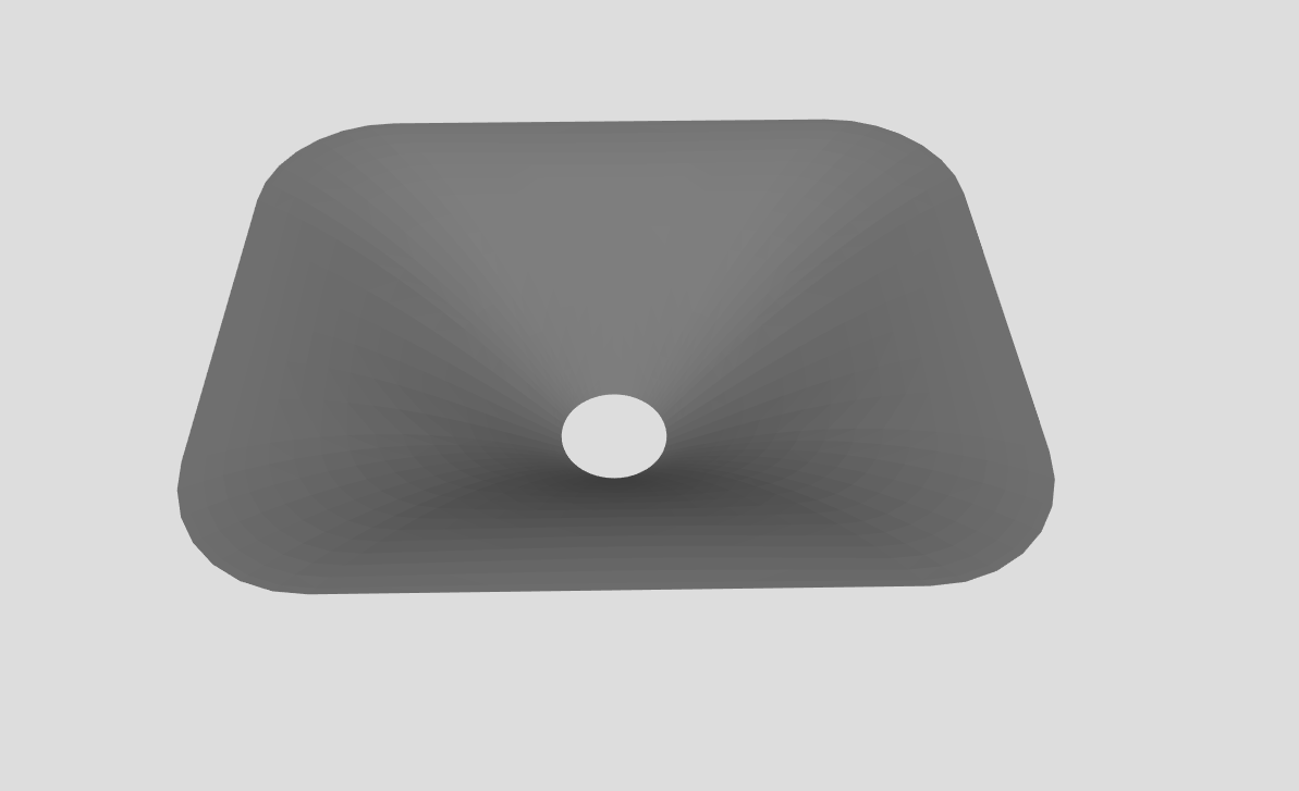

So I did another print based on the simulations you showed with a conical expansion from the throat.
I kept the overall outside dimensions the same as in my previous versions, but the depth is reduced to 52mm.
Code:
; Horn Geometry
Throat.Diameter = 31 ; [mm]
Throat.Angle = 40 ; [deg]
Throat.Profile = cone
Throat.Ext.Length = 0
Length = 52 ; [mm]
GCurve = SE
GCurve.SE.Exp = 2.3
GCurve.Angle = 50
GCurve.VertScale = 0.75
Term.s = 0.7
Term.n = 4.0
Term.q = 0.995
Morph.TargetShape = rect
Morph.FixedPart = 0
Morph.StretchExp = 3
Morph.CornerRadius = 35 ; [mm]

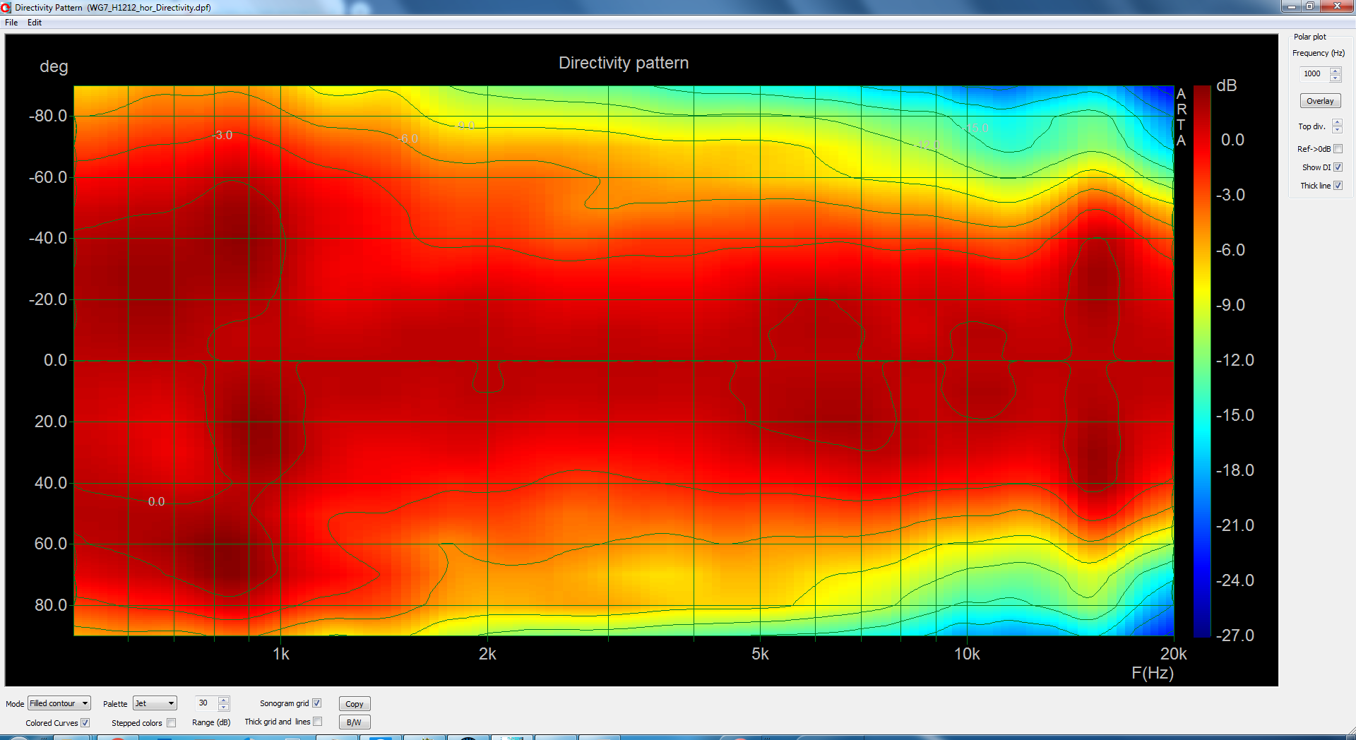

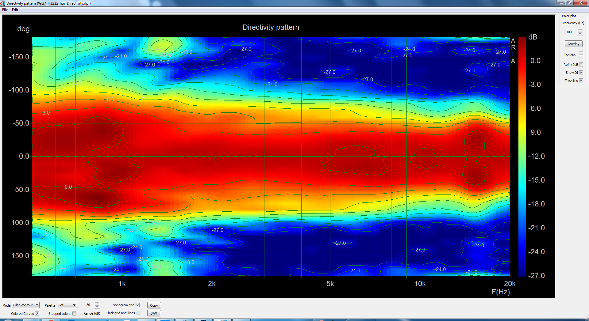

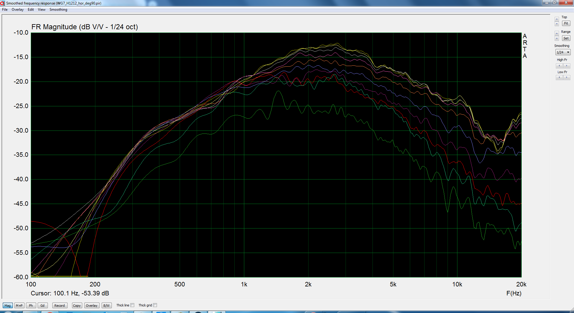

Directivity could be better above 10kHz, but it's getting quite good in the important range below 10k I think.
Measured in a 600 x 800mm baffle at about 1 meter.
The Vituixcad plot is normalized to the 10 degree curve.
Arta plots is normalized to 0 deg.

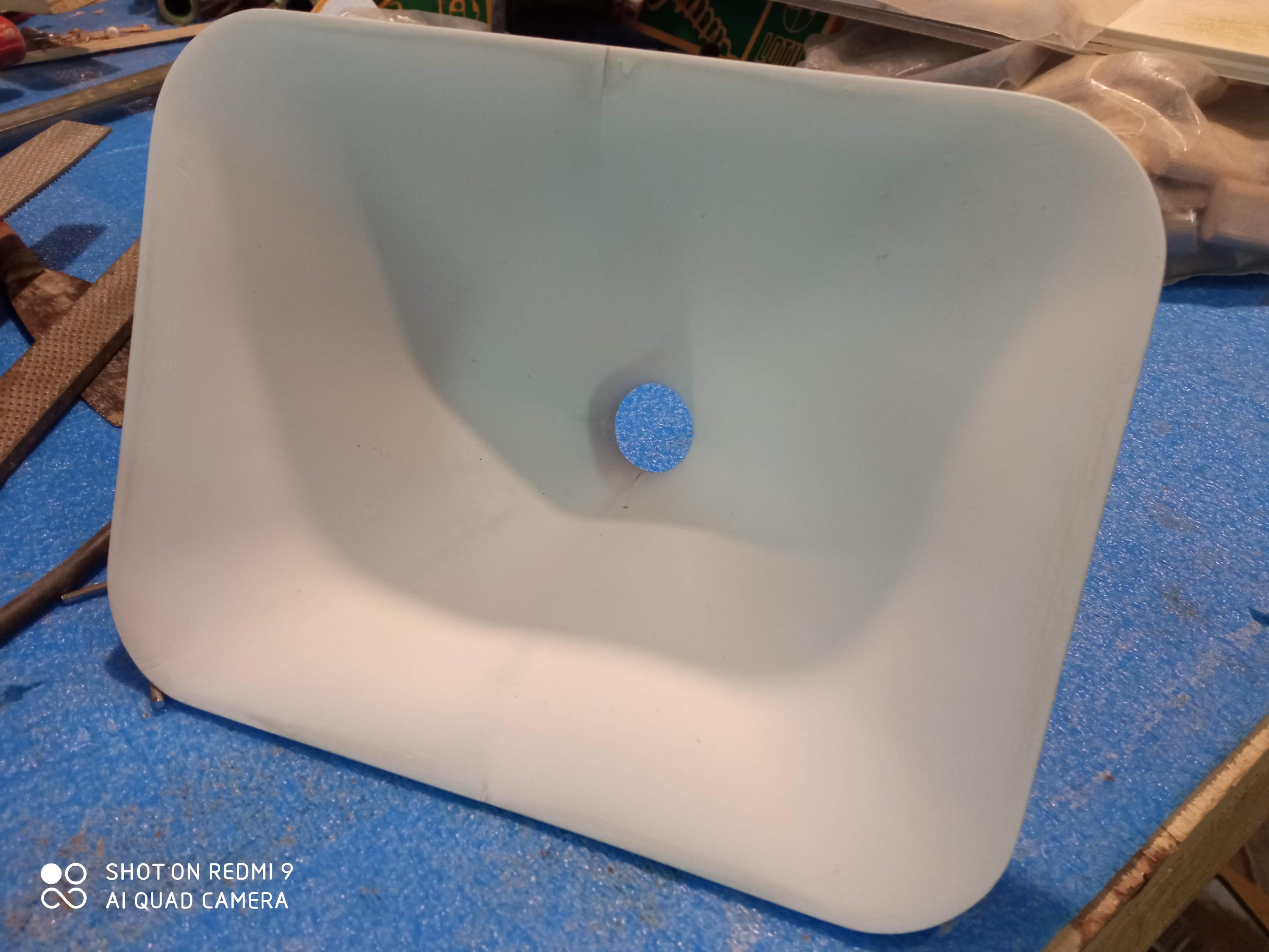

finally, everything works perfect! Thank you for your development! I used your soft, Sketchup and Fusion360 for machining. Result looks good. Will see how they will sounds when i'll finished them )

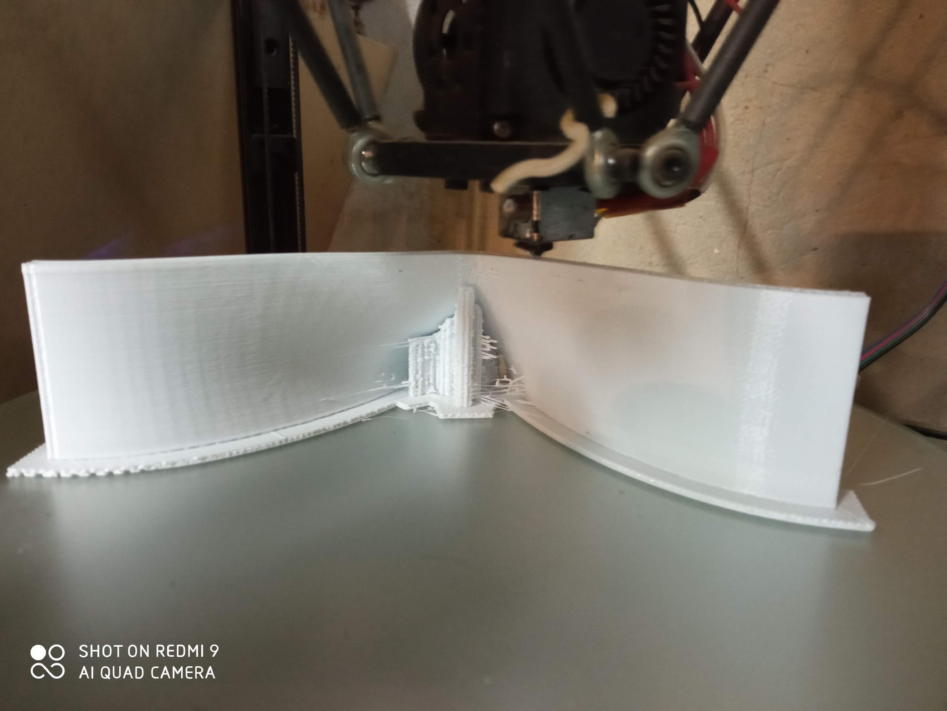

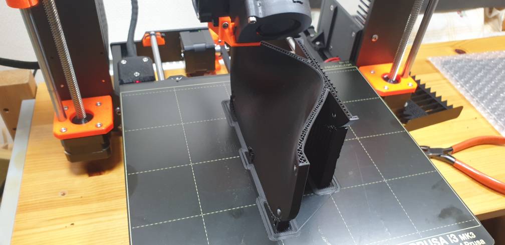

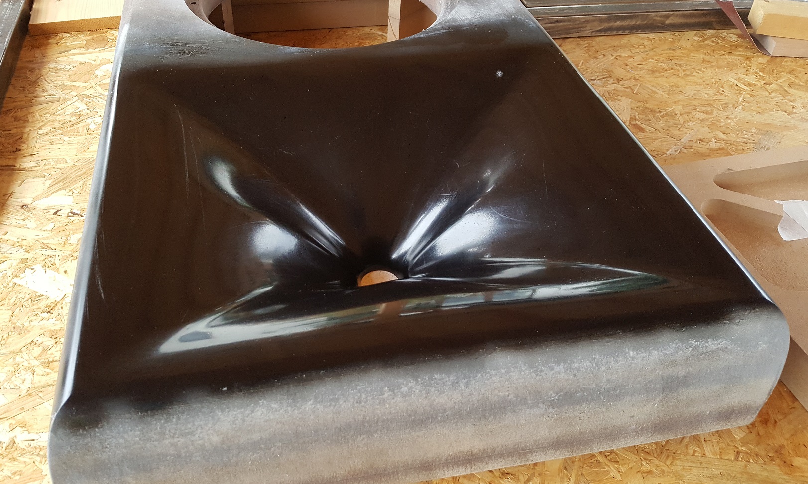

Hello again,
I have finally printed two TinyRs for my Linn Unik speakers, actually I have taken the file generated in the demo exported to Fusion, divided into two halves and printed in a 240mm diameter delta. The first half was made in ABS, with this material I had warping problems, I made the other halves with PETG. The result is quite correct, I have glued the parts with cyanoacrylate with activator and the joint is very good, it has resisted some fall to the ground. The first unit I taped together and put it in the unit to test, the second unit is a bit more elaborate, I have applied a coat of polyurethane primer and now wait for the finish color coat.
At the level of results I have to say that these small speakers are in my workshop of about 60 m2, the effect of the horn is a curious improvement in reproduction, from here I hope to make other prototypes with a little more previous analysis and looking for results , It has been a good test to evaluate the use of the 3d printer for the manufacture of horns.
