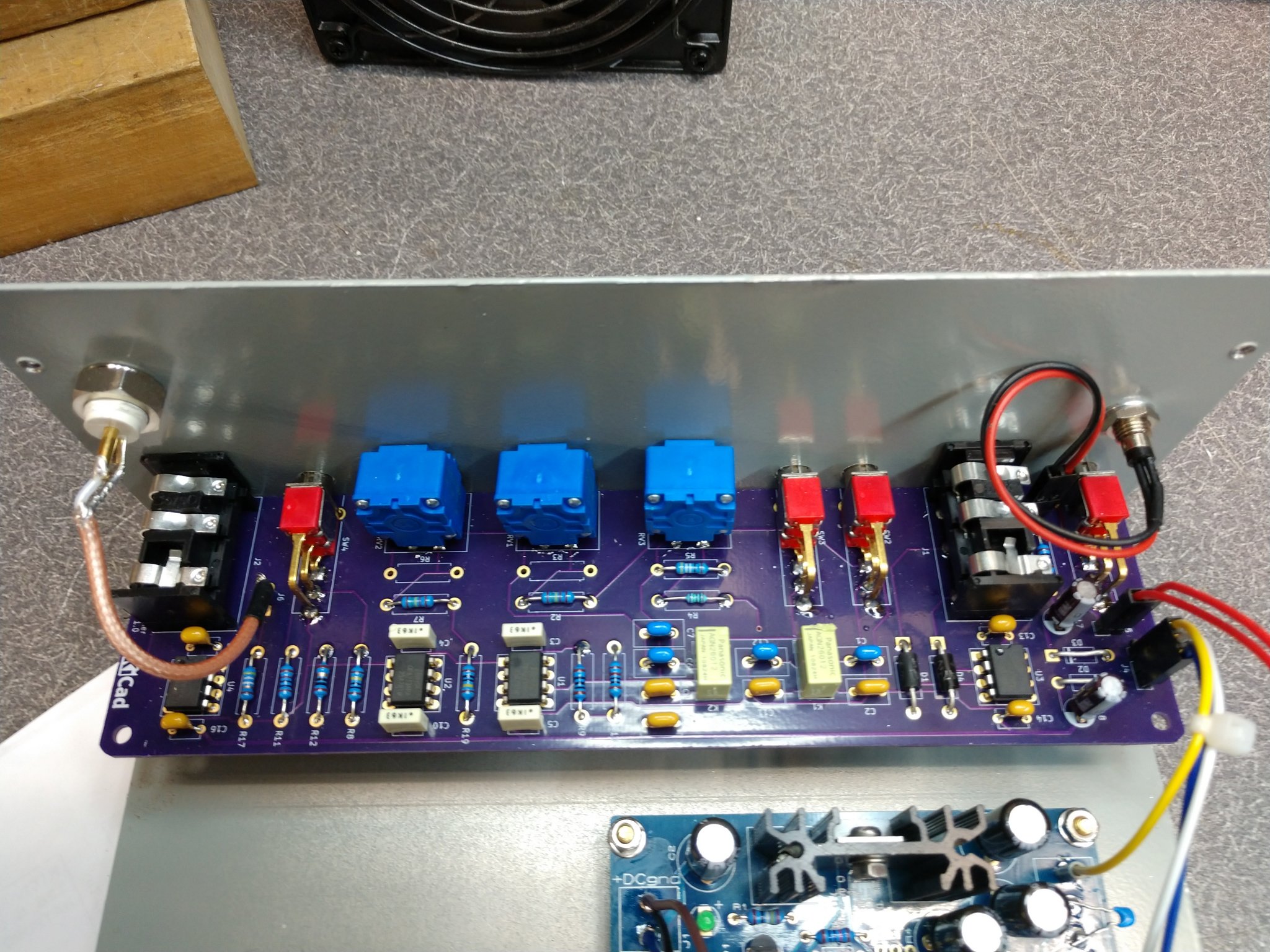

I finished and tested my Twin-Tee active notch filter today. It works just as designed (which is always nice). The sharp notch at 1kHz or 10kHz reaches -60dB easily with adjustment of the three front panel pots. I found that the easiest way to adjust those controls is to observe the filter OUT (Y) vs IN (X) on an analog scope in XY mode. The single-ended BNC output on the filter comes in handy for this while the Balance output can remained connected to the spectrum analyzer.
The Bypass and X100 Gain functions work well, as expected (not much to those circuits).

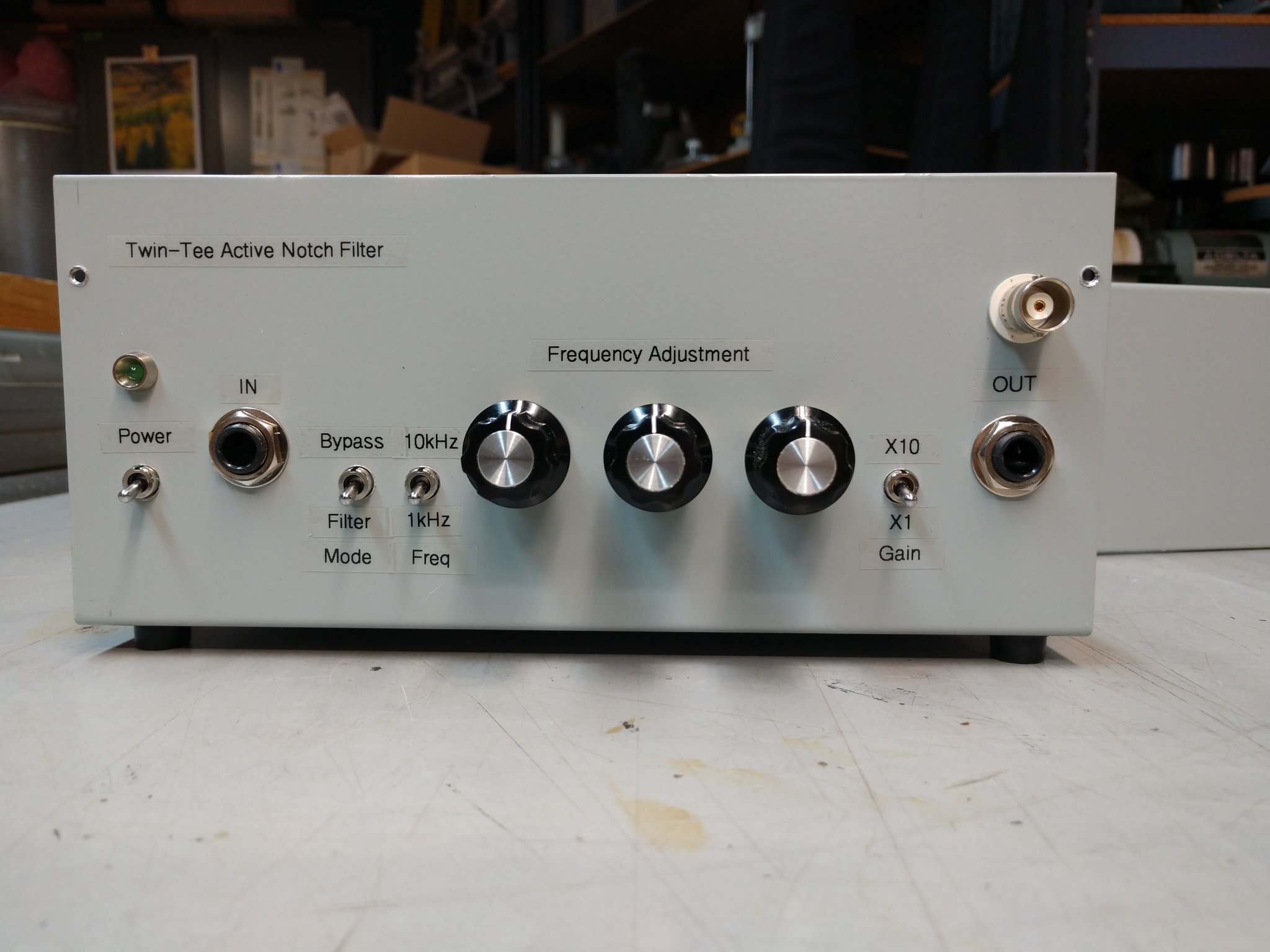

Note: The Gain control on the front panel picture should be labelled X1 / X100. I need to change that label.
The gain could be set to other than X100 by using different op-amp resistor values.
Anyone interested in buying one of the two remaining PCB's (BOM and schematic included) let me know. An external power source is required (+/-12V).
Cheers, Mike

Wait a minute, what is the cap's type did you use in the filter? As I see it is some cheap ceramic caps right? Actually, this is one of the most critical points is choosing the right types of passive parts. I using C0G 100-250V(selected from many different types and manufacturers) 2pcs in serial to get minimal VCC and make sure that my passives H3 limit is around -170db@1kHz. If you took the type that I guess, you got H3 result worse than the bare average ADC does -110-120db@1khz. Resistors are also critical due to VCR but in general, long enough resistor type has quite low VCR, so your looks good enough.I finished and tested my Twin-Tee active notch filter today. It works just as designed (which is always nice). The sharp notch at 1kHz or 10kHz reaches -60dB easily with adjustment of the three front panel pots. I found that the easiest way to adjust those controls is to observe the filter OUT (Y) vs IN (X) on an analog scope in XY mode. The single-ended BNC output on the filter comes in handy for this while the Balance output can remained connected to the spectrum analyzer.

I used my Brother P-Touch label printer with black on clear tape. ThanksNice built Mike! How did you do the labels - printing on clear self-sticking label stock?

For the filter caps I used TDK C0G 100V FG series ceramic caps.Wait a minute, what is the cap's type did you use in the filter? As I see it is some cheap ceramic caps right? Actually, this is one of the most critical points is choosing the right types of passive parts. I using C0G 100-250V(selected from many different types and manufacturers) 2pcs in serial to get minimal VCC and make sure that my passives H3 limit is around -170db@1kHz. If you took the type that I guess, you got H3 result worse than the bare average ADC does -110-120db@1khz. Resistors are also critical due to VCR but in general, long enough resistor type has quite low VCR, so your looks good enough.
