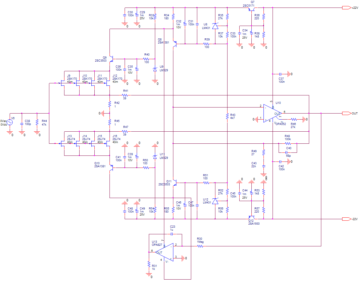

Here some 3 circuits to compare.
They all have different merits,
but not necessarily, the one of performing beneeth the general noisefloor found in electromagnetic fields of typical Western Hemisphere livingrooms.
There is different noise levels far in the tropical rainforrest,
no doubt. (water+trees blocks, screens radio cummnication).
LowNoise multi parallelled differential BC550 bipolar input RIAA (from old Elektor originally)
http://www.diyaudio.com/forums/showthread.php?threadid=91497
LSK389 JFET input pair to LowNoise bipolar Op-amp
http://www.diyaudio.com/forums/showthread.php?postid=1519372#post1519372
Cicuit: http://www.diyaudio.com/forums/attachment.php?s=&postid=1519372&stamp=1211672608
I guess it does not match your suggested design in 1st post,, syn08.
But my circuits can not be called as being 'bad ideas', either.
http://www.synaesthesia.ca/files/headamp.png
What do you think, John?
And what does the topic strater syn08 have for comment ..?
I just dont like to make gigantic and complicated circuits
just to hunt for lower noise than runs through the RCA-plugs teminated Cables
that feed my input.

lineup said:![]()
Hi Lineup,
I'm impressed by the number of input trannies, but does it any good if R18=270 Ohms? (2.1nV/rtHz !!!)
Edmond.

1. Totally :bs: You can parallel bipolars and JFETs until the cows come home, if the feedback resistor is 270 ohm, that's what will set the noise. 270 ohm has about 2nV/rtHz, barely good for MM. One, max two of the BC550/560 devices are already under that noise level.
2. Not good. The 5534 is wrongly wired. R1gain sets the noise, and you won't be able to make it very small with that opamp. Don't do differentials for low noise, you'll only increase the noise by SQRT(2) compared to single ended. The current sources will add common mode noise and any imbalance will put it on the output.
You'd do better with a simple opamp stage; an AD797, OPA211, LT1115, LT1128, LME49710, ADA4898 will easily do 1nV/rtHz, better than you can expect with any of the above.
BTW, this is the HPS 3.1 input stage latest schematic. http://www.synaesthesia.ca/files/front_end_new_servo.png This is a fixed gain input stage (gain is set to 40), you need to add the RIAA correction stage(s). At the end, it's pretty complex, the board has 9.4" x 4" (including the power supplies for a dual mono version).
Lineup, at least you gave it a good shot.
Ck # 1 looks like something we might have made in the early '70's, before complementary jfets. Good comp-diff design, same topology as later JC-2 output stage (1973) except the JC-2 used fets on input. Inefficient use of low noise devices due to differential, as 4 times more devices must be used than JC-1 circuit to approximate noise, even open loop.
Feedback resistor, as already shown by others, throws away everything.
Ck # 2 comes from app note from Siliconix in late '70's early '80's, and IS noisy because the noise of the second stage of the 5534 is worse than expected.
If you're referring to the use of pins 1 and 8 as the inputs, it is OK. It was a circuit published in an old Siliconix data/applications book so that a low-noise dual JFET can replace the input of the 5534.
Yep, didn't thought about. Still, not a very good design for the other resons I've mentioned.
