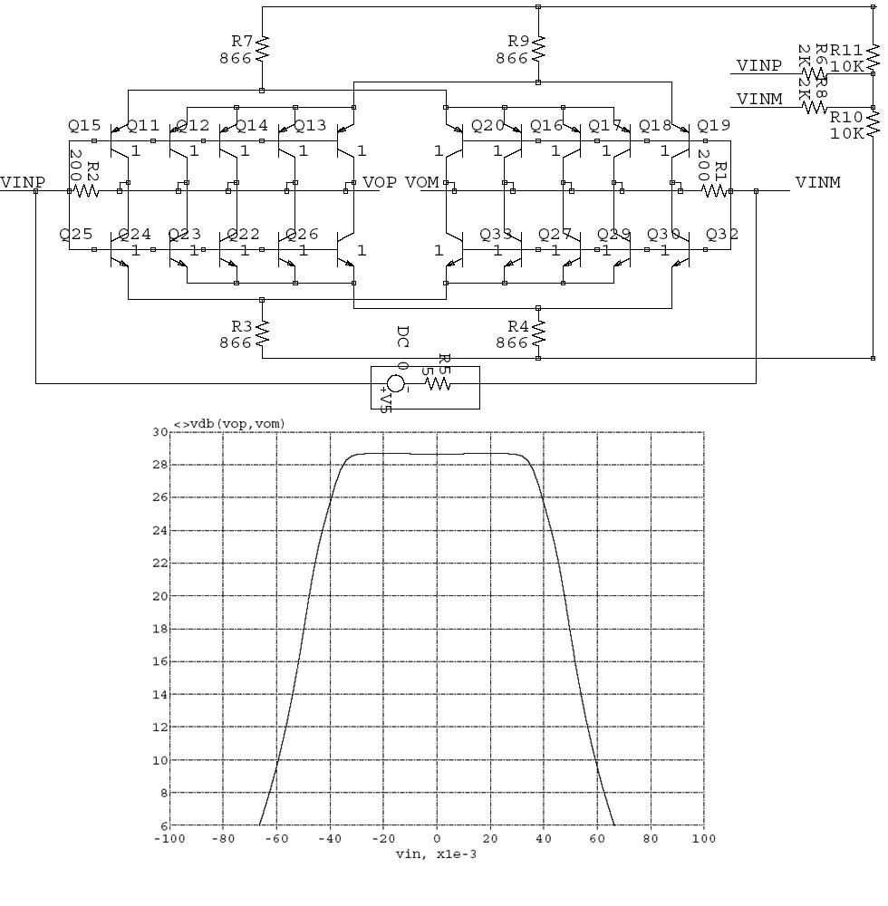

Here’s another one for your list lineup. I always wanted to try this. 4:1 is almost a perfect ratio for the Schmook/Gilbert multi-tan input. Here is a fully complimentary floating version, an homage to John Curl as it were. This circuit floats on a 9V battery. The linearized transfer function is pictured below, in sim almost -100dB THD at 250mV p-p out. I bet with 2N4401/2N4403’s pulled off of a strip you could get it to work. Noise is sub 1 nano-volt.
Offered up as food for thought, trims and bypassing could be added. You could even get the cartridge current to 0.

My design was made to operate to a maximum of 100mV rms. It was a pre-preamp, designed to replace a transformer. A normal 30-40 dB gain phono preamp followed this circuit. I became famous with this design, because it could have 0.4nV/rt Hz noise, virtually unheard of, in 1973. but it is flawed, in that it has limited dynamic range.
john curl said:My design was made to operate to a maximum of 100mV rms. It was a pre-preamp, designed to replace a transformer. A normal 30-40 dB gain phono preamp followed this circuit. I became famous with this design, because it could have 0.4nV/rt Hz noise, virtually unheard of, in 1973. but it is flawed, in that it has limited dynamic range.
I see, John. I mean, pair of transistors, collector to collector, with feedback from collectors to bases.
Why you did not increase collector - emitter voltages?
john curl said:Later designs raised the Vce by adding cap bypassed biasing diodes, but it overcomplicated the circuit, and it was only sonically semi-successful. Measured better, however. Yup, been there, done that!
I was thinking about bypassed resistors.

This is very elementary. You should read syn08’s post one more time. He is giving you the formula for resistor noise. You can actually parallel as many transistors you like, but the main noise source will be the resistor.
By paralleling two 470 Ohm resistors you are now getting 235 Ohm instead of 270 Ohm so it will be slightly better, but not much.

john curl said:That is why my MC preamp stages run open loop. It is almost difficult to fix, without using a power amp to drive the feedback resistors.
And live with the distortions. It seems like today is a day you don't care about.
BTW, can you tell us (before I do, 'cause I got the reverse engineered schematics) what is the Vendetta's headroom aka dynamic range?
john curl said:About 10 times more than the Levinson JC-1 pre-preamp.
20 dB more? You wish, try again and this time use numbers

One conclusion of the discussion in this thread could be that, due to the alarmingly nonlinear Vbe/Ice characteristic of bipolars and some other annoyances also mentioned, makes them inferior to FETs in transconductance stages. (That´s why the more concordant functional Ibe/Ice relationship often is used for calculations).
stinius,
any objection?
I`m not. It won`t sound good. Sound quality decreases with the number of paralleled devices.I'm impressed by the number of input trannies
