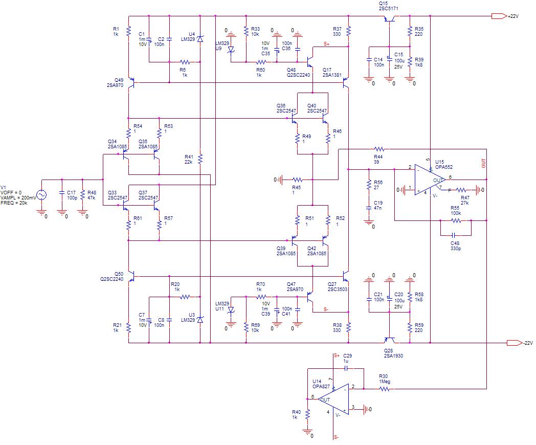

Hps 4.0
Unless I get a better idea, I think I've decided about the HPS 4.0 bipolar input stage. A few key parameters (the results of breadboard measurements, matching pretyy well the simulations).
- 0.3nV/rtHz noise. With 2SC2240/2SA970, noise is 0.7nV/rtHz, not bad at all, still pretty good for a MC cartridge (it's similar to HPS 2.0).
- under 0.001% distortions at 20KHz and 100mV input (4V output).
- 2MHz ULG and 85 degrees phase margin.
- Input impedance is 4Mohm up to 1KHz, then dropping at 1Mohm @20KHz. Good enough, even for a MM cartridge with 0.5H inductance (which is anyway beyond the scope of this project).
A low noise input stage/follower, biased by a constant current source (mostly for increasing the input impedance). A low noise cascoded gain stage, then the same folded cascode and high output current opamp, feeding the feedback network. The emitter ballast resistors can be omotted, although I decided to keep them to compensate for potential devices little mismatchings (although the Hitachi pair, being ion implanted, are very well matched out of the tube). A total equivalent of 0.25ohm doesn't really matter.
Here's the schematic:

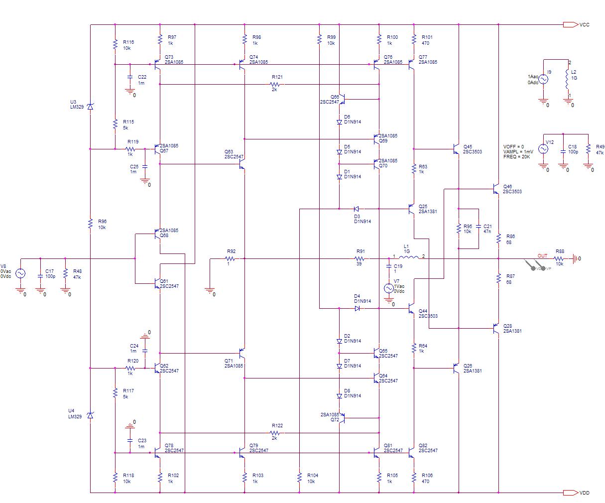

a) A discrete current feedback opamp architecture. While this option had some nice features (increased input impedance, better thermal stability, Baker clamp, ability to run the output stage in class A providing abyssimal low distortions) I considered it to complicated for very little improvement. The noise performance is about the same as above. Here's a schematic draft (it misses the servo and the frequency compensation).
b) A derivative of Edmond's CMCL input stage. Working fine, but I found little reason why CMCL would help here. Distortions are not really an issue neither is the "fighting VAS" effect. Again to complicated for very little gain. I have also found pretty difficult (although possible) to frequency compensate this circuit. Here's a schematic draft (missing the frequency compensation).
c) A floating input stage. I have tried prof. Leach input stage and prof. Hawksford idea, published in Wireless World. They both work fine (having pros and cons though) but require battery supply, or some sort of floating power supply. Unfortunately this is where I failed miserably, I was unable to create a simple floating low noise power supply. While the supply itself is not a big deal, unless it's fed from a separate mains transformer, the capacitive couplings between this supply and the others on the same transformer are cancelling any "floating design" at high frequencies. Such a configuration would require at least four mains transformers for a dual mono construction, which is to me a to hefty price to pay for zero cartridge current (and that at DC only). Of course, and R-core could be the answer, but I don't have any and I was unable to source some, at a decent price.
![HPS_4_0_is_final.jpg](/community/proxy.php?image=http%3A%2F%2Fwww.synaesthesia.ca%2Ffiles%2FHPS_4_0_is_final.jpg&hash=e76cc2aef5d2ae9dd27d615e7d66a793)
![HPS_4_0_is_opt1.jpg](/community/proxy.php?image=http%3A%2F%2Fwww.synaesthesia.ca%2Ffiles%2FHPS_4_0_is_opt1.jpg&hash=2fe20137c6c588370fe017751c15e0f3)
![HPS_4_0_is_opt2.jpg](/community/proxy.php?image=http%3A%2F%2Fwww.synaesthesia.ca%2Ffiles%2FHPS_4_0_is_opt2.jpg&hash=04a9590c0fa1d28dfd0bb4c6e5ef7cae)

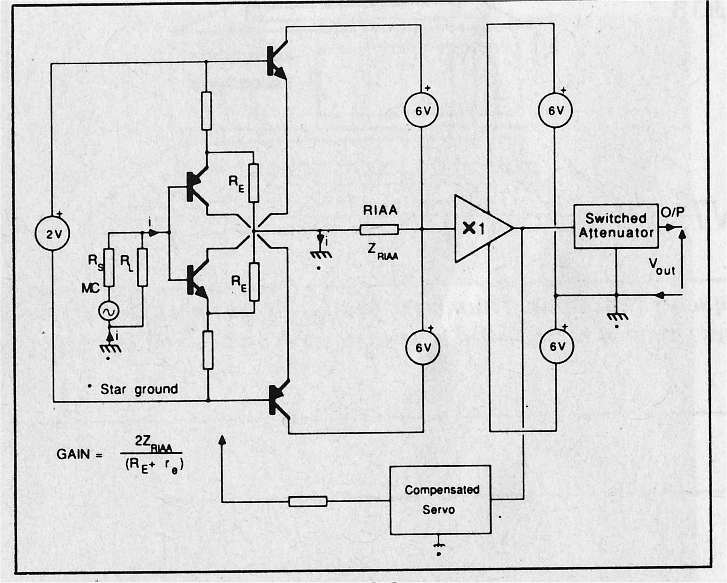

~1mA will probably offset the generator armature too far to be optimum. 1uA could well give an unmeasurable generator offset. Obviously 0.1uA is better.
Hi, Andrew, what is your argument for this?
Any number will strongly depend on strength of magnetic field (geometry, dimensions, used material) and its coupling to cantilever. I don't see yet how one can estimate that reliably so I would be glad to receive your input.
Have fun, Hannes
Ovidiu -
excellent work!
Thinking about 4 transformers I see no problems with that when the gain is to have zero DC current through an expensive MC cartridge. The cost for 4 transformers is relatively low!
What DC currents do you suspect are going through the cartridge for the different designs?
BTW,
thanks for the two SPICE models!

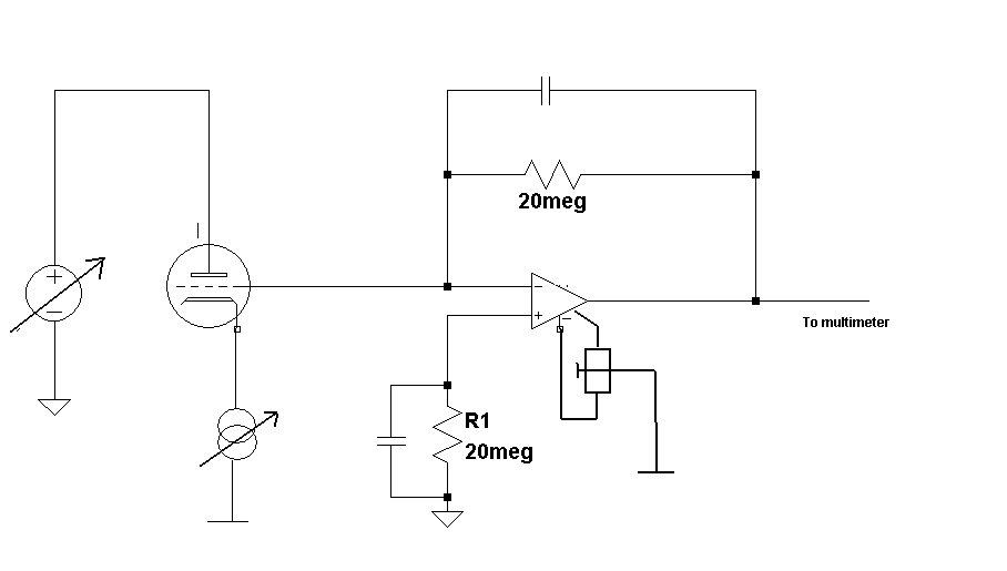

Sigurd Ruschkow said:What DC currents do you suspect are going through the cartridge for the different designs?
Certainly under 1uA - this is what I measured on the breadboard. Unfortunately I don't have very low current measurements capabilities, so I can't be for the moment more precise.
I'm still looking for references/discussions about, meantime what I got on this forum convinced me it's not that critical. I also can't find any test data on commercially available MC stages, nobody (including Stereophile) seem to care about such. I can't imagine all high end MC stages are build with low noise JFETs.
Unfortunately, it is thermodinamically impossible to cancel the base currents, so that the input current is null, without impacting the noise. This can be rigurously proved based on the semiconductor transport mechanism (Boltzmann transport, etc...) but before going there, imagine a circuit that would cancel the input bias current. Sensing the base currents (and balancing them) or sensing the input offset (due to the input bias current) would insert at the input either a current noise source or a voltage noise source. Unfortunately, uncorrelated noise sources never cancel, but always add, so the input current cancelling circuit will actually add to the noise... Of course, a manual one time adjusting of the input bias current is always possible, by manually balancing the input stage bias collector currents.
So one way or another, a bipolar MC low noise amp has to live with some input current...
You don't need much.
Here is what I use to accurately measure / test tubes for grid current.
A precision, jfet input opamp is required here. The caps are just low value polypropylene; required to prevent oscillation (LF pole caused by the large resistors and the opamp input capacitace).
The output voltage is equal to -20mV/nA
Your not measuring femtoamps? I thought tubes had really low grid bias current. Oops, sorry, thats electrometer tubes.
Jfets have a low bias current but not zero, and it increases quickly with temperature. I would suggest a chopper amp for that application. The MAX4238 bias current for example is 1 pA so the error will be very low.
