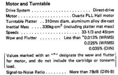

Right. So I just didn't even start to bother and got a Pioneer PL-L1000 from which above specs are. The looks are certainly not everybodys taste, but if you happen to like them you get a truly great linear tonearm for free. Another source of distortion eliminated.
Have fun, Hannes
EDIT: forgot, the Kenwood KD-990 meets more the general taste and has also a very nice 10.5" arm. Tons of other directdrives not as popular as a SP10 available with very competitive specs at much small price.
Thanks, I see these go for as little as $150 certainly worth some fooling around. From old threads I gather it will be time to get out the Mortite, ah the 80's again. I gave away a set of KEF "units" that the previous owner had slathered with bitumenous felt.
Use caution with those early direct drive turntables. The servos are pretty primitive. While they have the correct rotation and low measured flutter they are not really "stable" and act like they have zero gain on frequency. They tend to shift up and down about the target speed. Like a primitive pll. Since the 80's PLL design has become much more sophisticated. PLL Design primer
A real rework on one of those early direct drives could have a major effect on the sound but isn't going to be successful without an understanding of the challenge. Scott is probably up to it. Its most likely too deep for me. I have an SP10 that I'm not happy with, and SP15 that seems to sound better and a granite behemoth with a Pabst direct drive that seems pretty good but too big to set up. A 50 Lb platter can do wonders for servo problems.
