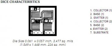

Now that Hitsware has put up links: Check out the differences between MAT 01 and MAT02 data sheets, and note the difference in capacitance, and beta linearity. This is why I had to ask Scott Wurcer about his input device characteristics. I am surprised that he could use a MAT 02, because of the input capacitance. Check it out.
Here the MAT02 picture.
I have asked several people at AD about the MAT02/SSM2210 process but no one can give me any info.
Did you try the SSM2210 and did it sound as good as the MAT02? Looking at the datasheets the MAT02 is really dual monolithic but the SSM2210 just states "dual matched transistor pair" so it may actually be just two selected chips in a single package.

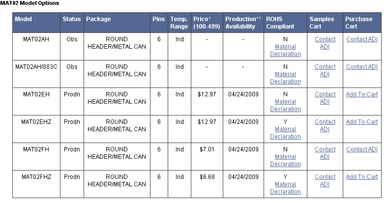

Allen Wright said:
We use the SSM2210 in production as the real MAT02 has been discontinued. Seem to work perfectly.
reports of Mat02 end of life seem vastly exaggerated:
(from AD web site this morning)
Agreed! And MAT02 is better than SSM2210......

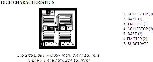

G.Kleinschmidt said:
The SSM2210 is just a MAT02 in a plastic dip - a lower cost version.
They are monolithic, with parasitic, high capacitance diodes between the collectors and the substrate. These diodes are 70pF each and give a collector-collector capacitance of 35pF (specified on the datasheet).
A major interest is log conformance over many decades of Ie not necessarily audio. An oxide isolated process would help but I doubt if the economics would justify it. The price of the cans is also an unfortunate economic necessity. The input devices on the AD797 are far smaller than this, almost an order of magnitude or more I should see if I can find a pic.
