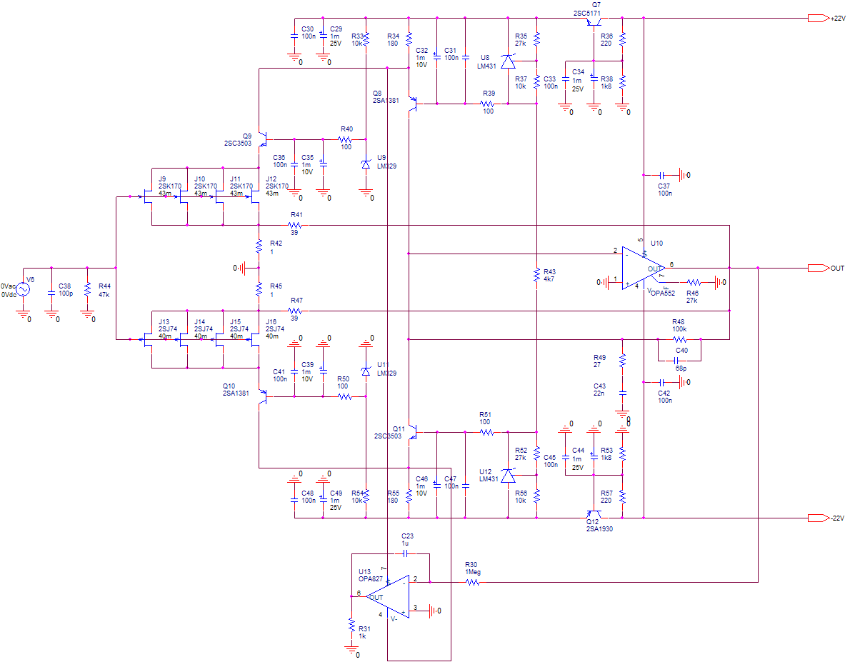

A new servo
I was giving the front end servo some more thought; certainly, it's an interesting challenge. In the previous schematic, the servo output current noise contributes to the input referred noise as In/Gm where Gm is the first stage (JFET) transconductance. The V/I stage in the servo, required to convert the output voltage to an current error imposes some challenges; it needs a decent headroom (10-15mA) to compensate for gross JFET mismatching, hence the 100kohm resistors. These makes the V/I stage pretty sensitive to the opamp input noise current and therefore a JFET input, high voltage opamp (such as OPA445) is required. Certainly, not a cheap part and not in everybody's drawer. Such opamps are usually not optimized for noise voltage and precision. Even if the noise voltage doesn't contribute much to the total noise, it would certainly useful to use a cheaper low noise opamp. Also, the whole servo arrangement looks pretty complicated...
Here's a modified servo. It uses only one opamp, JFET input type. This one doesn't even need to be low noise, any fair precision model will do. It also doesn't need to be high voltage! I've tried so far OPA134, AD8065, AD8097 and OPA827 with very similar results, overall still around 0.31nV/rtHz.
Now, the question. Small differences (in terms of noise) between these opamps still exist. I was not able to find any correlation between the opamp datasheet specs and the noise results (OPA827 is doing the best, the worst being OPA134). Is there any well established relation between an opamp input voltage/current noise performance, the load, and the resulting noise current in the supply lines? This noise contributes to the total noise as much as the output current noise in the previous V/I convertor...
I will of course measure this independently, just curious if there is any well established theory about.

![front_end_new_servo.png](/community/proxy.php?image=http%3A%2F%2Fwww.synaesthesia.ca%2Ffiles%2Ffront_end_new_servo.png&hash=5cb1102c9ad5d30cd4d7b2f5bc44e41b)
