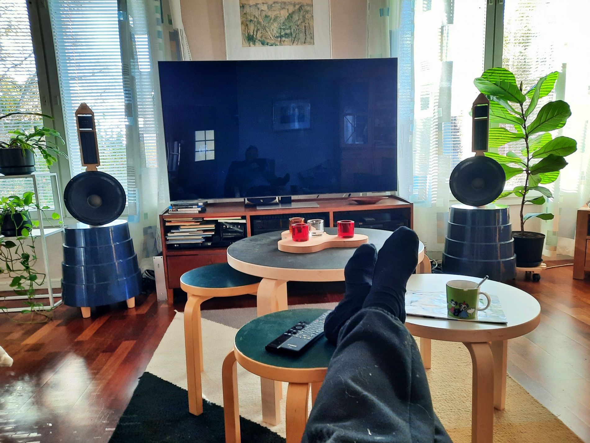

I studied Linkwitz and Kreskowsky homepages and got personally helped by Rudolf Finke. Minidsp and REW made all this possible for me and are key factors in multiway dipoles for dummies! The shape of bass module comes from a very popular glass by Aino Aalto, wife of architect Alvar Aalto. My daughter and grandmother are also named Aino.

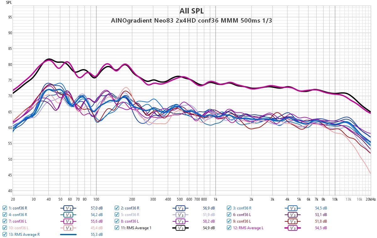

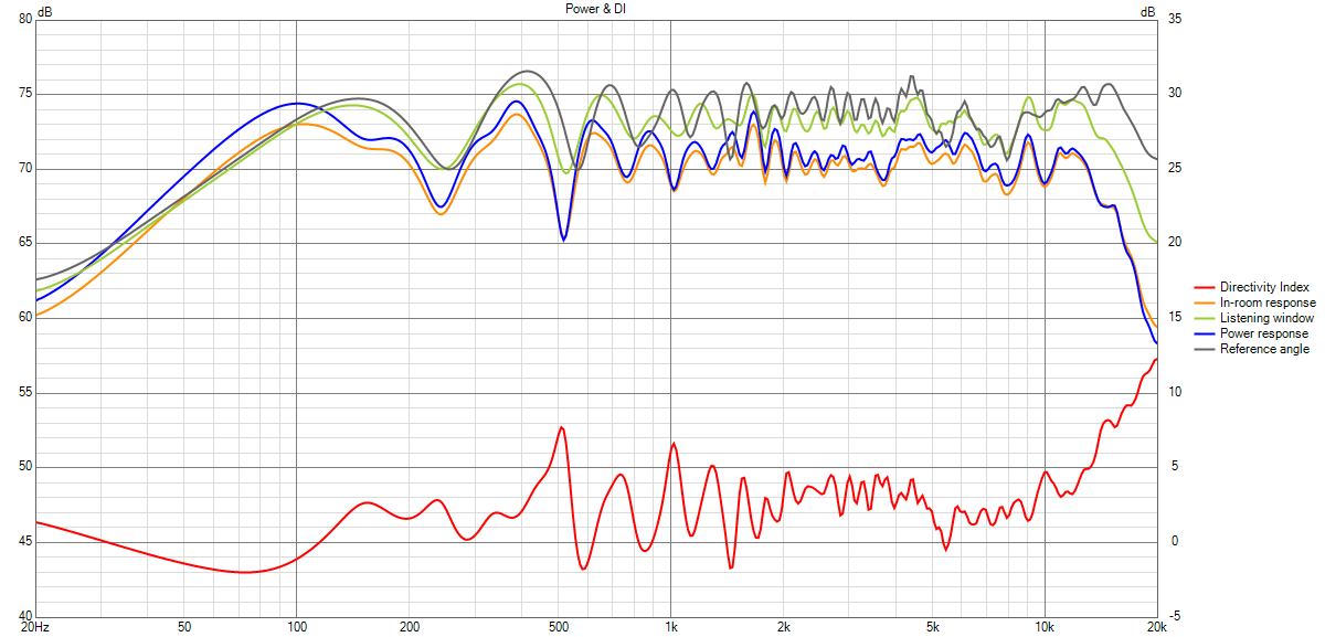

Acoustically Ainos are monopole below 100Hz, cardioid 100-300Hz, dipole from up there (highest dipole null around 6kHz) In early stages I struggled with rearside radiation anomalies of cone drivers and reflections from the large magnet of Fountek Neo3.H. These were fixed by using B&G Neo8 and Neo3 planar units. Another great struggle has been indoor measurements, remember the weather here in Scandinavia!
For the last 9 months I have only made minor adjustments in minidsp settings, mainly to optimize acoustic responses of each driver and tonality of the system. I am very happy with the present performance, and so were the people at the Finnish diy-audio event - AINOgradient got the nomination for "Best Sound in the Show"

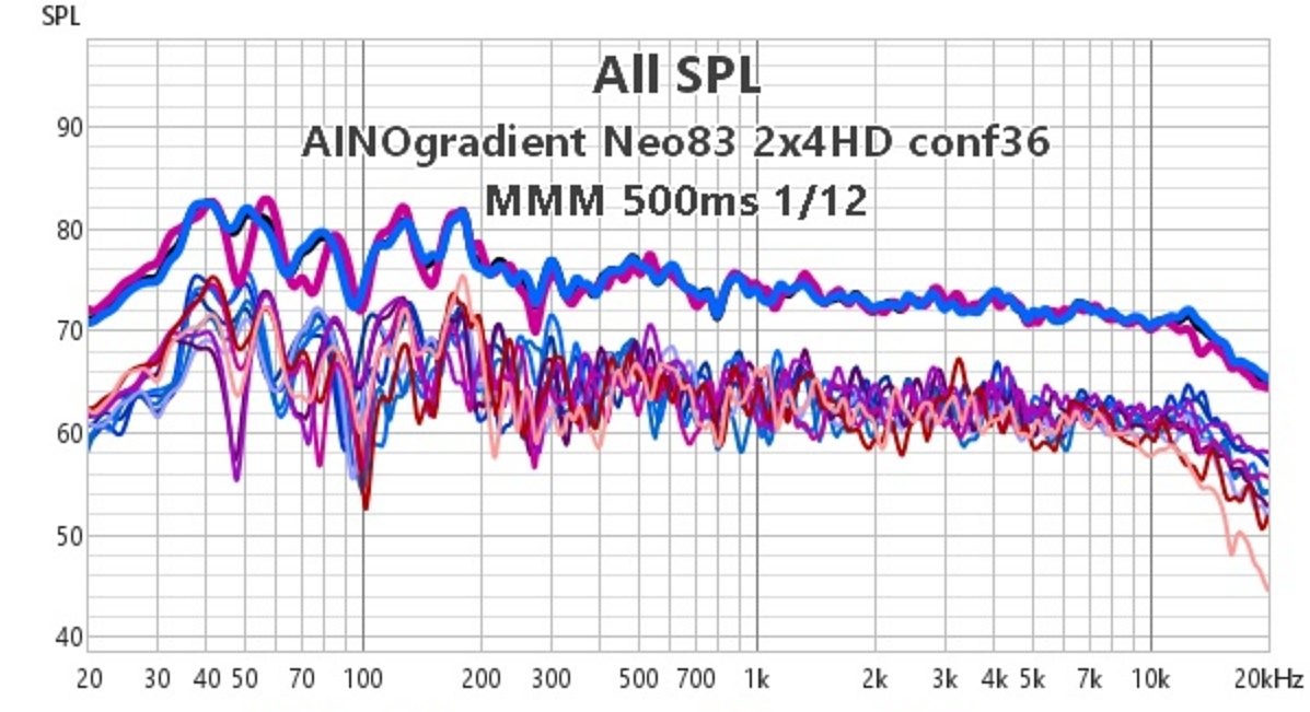

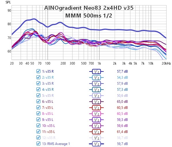

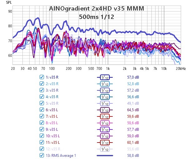

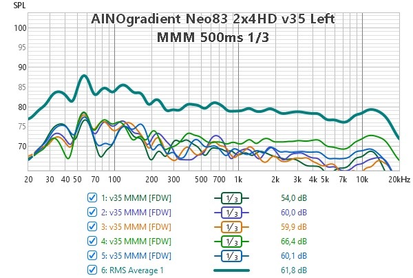

Here indoor-measurements at 1.5m distance. RTA/steady state response in-room is 16Hz -18kHz in a slightly descending (ideal) room curve. The upper end is limited because of Icepower D-class amplifier's input-impedance problem (but my aged ears don't hear that)

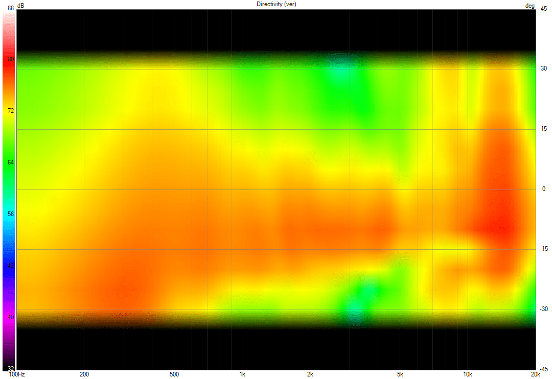

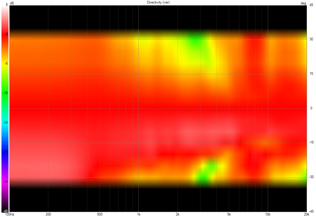

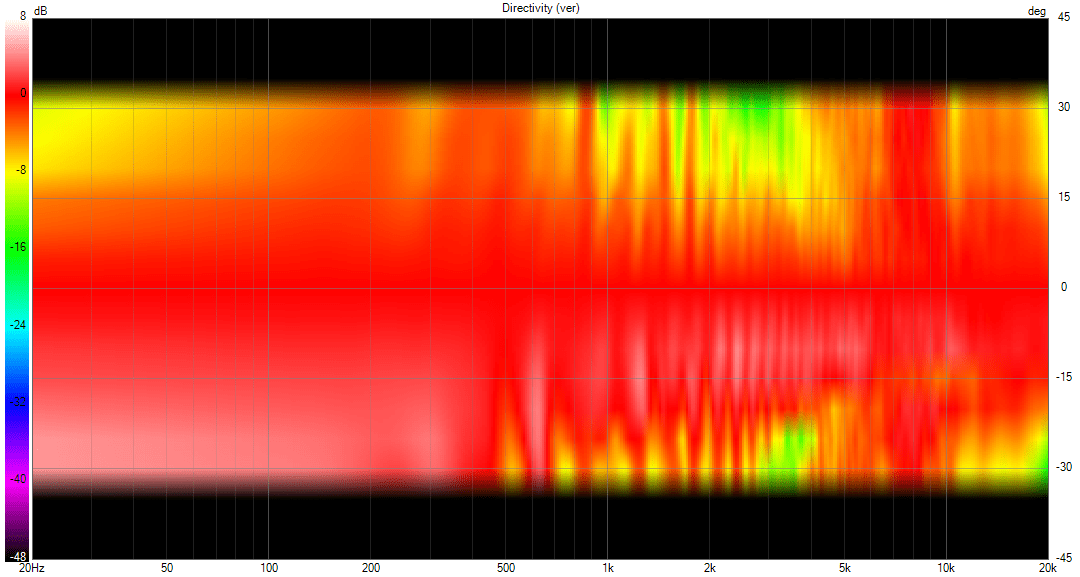

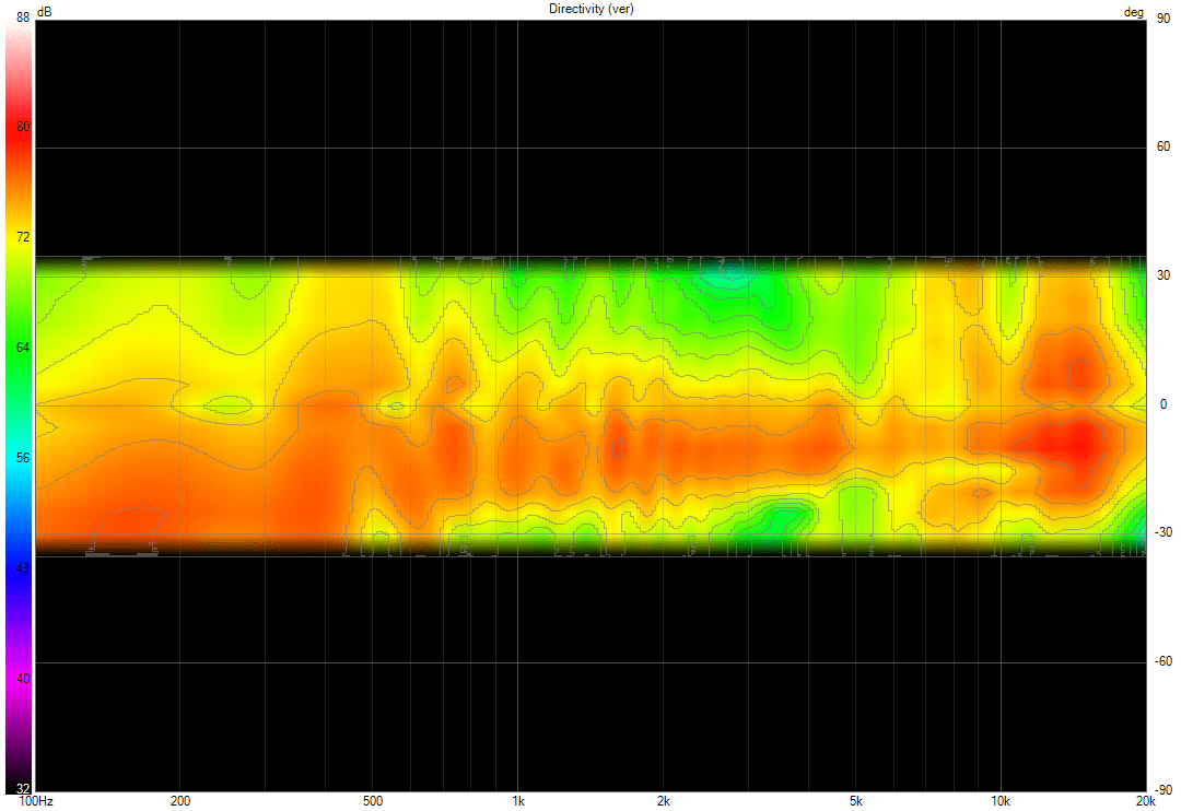

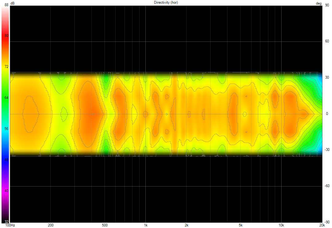

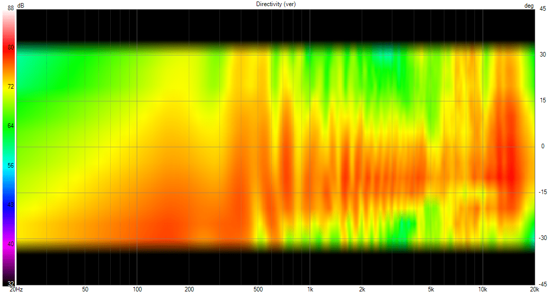

I finally had time to make vertical directivity measurements!
Angles estimated with 5 deg steps up to 30 degrees. Indoor with quite many disturbing reflections, so I will show only smoothed 4ms gated measurements. Lower limit in graphics is 200Hz, keep that in mind when looking and comparing to other similar from eg. ASR or Erin's Audio Corner

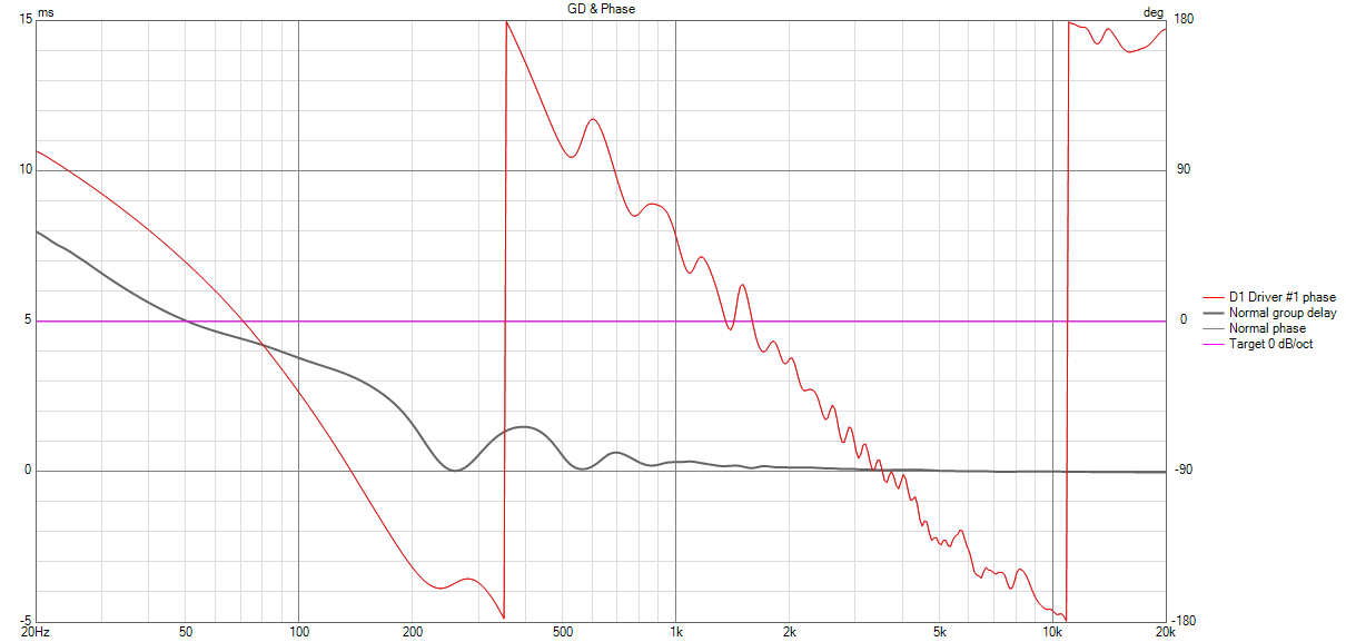

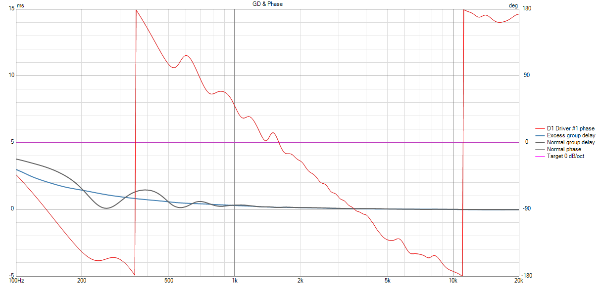

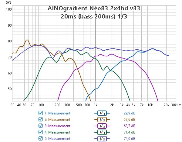

Present eq-xo is done with Minidsp 2x4HD using parametrics (not FIR). Slopes are basically LR2 but with elliptic tails. In v35 lowest xo is 150 Hz, second 600Hz, then 4500Hz. Previous v33 has higher SW and WM xo. Peaking above 10kHz can be eq'd easily, but it's not disturbing to anyone.
4ms 1/3 smoothing 100-20 000Hz

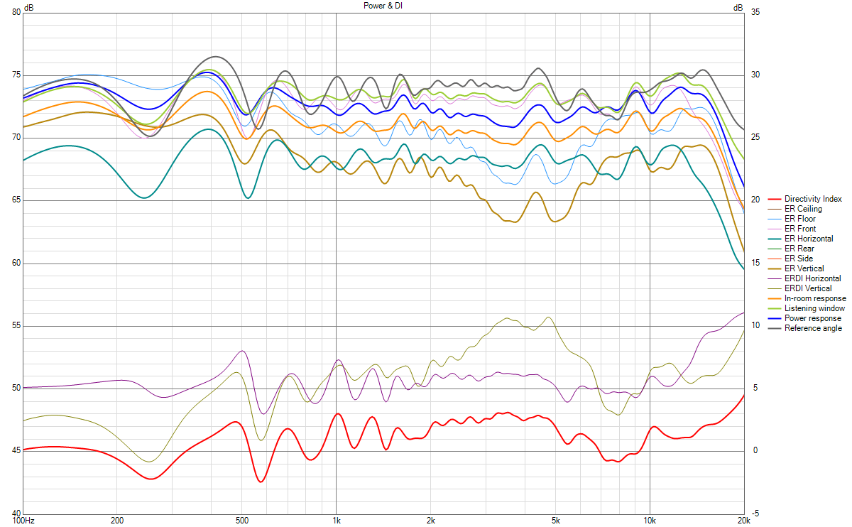

9ms 1/12 smoothing 20-20 000Hz
![ainogneo83 2x4HD v35 in vertical 0-30.png ainogneo83 2x4HD v35 in vertical 0-30.png](https://www.diyaudio.com/community/data/attachments/1203/1203583-81ee4693d78c8b79b3eeecd5876d2056.jpg)

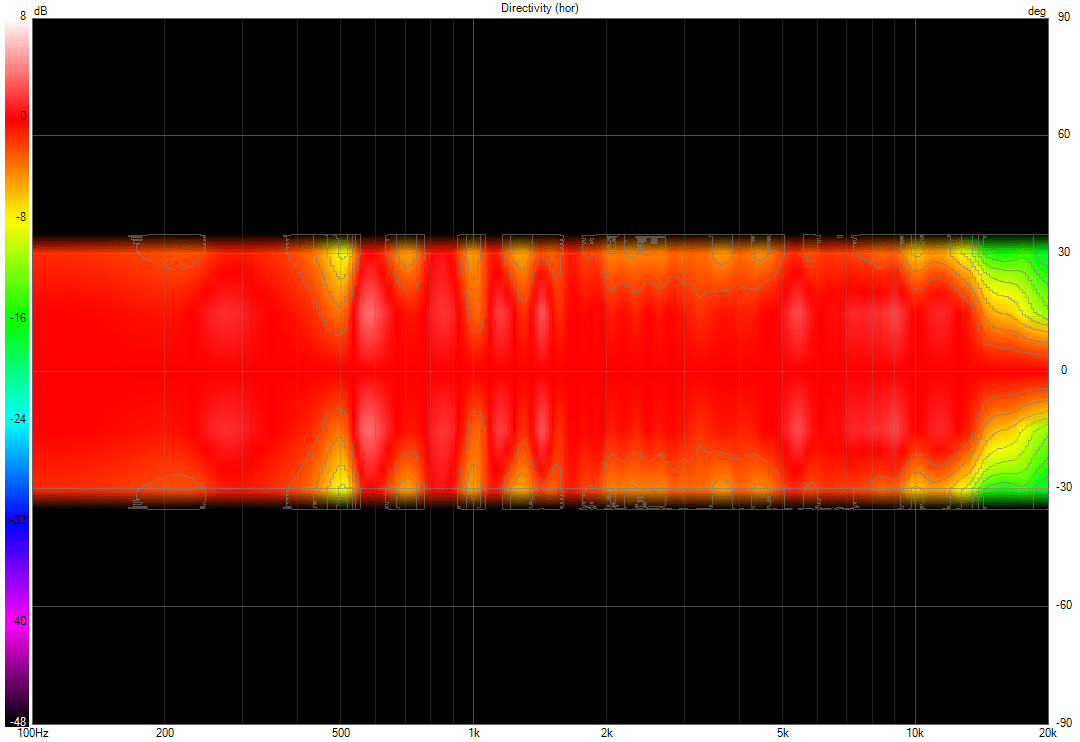

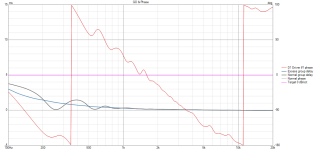

![AINOgneo83 2x4hd v35 in 0-45 horiz GD+Phase.png AINOgneo83 2x4hd v35 in 0-45 horiz GD+Phase.png](https://www.diyaudio.com/community/data/attachments/1203/1203578-a91629f9354a2fbfd91fa117814841ad.jpg)
![ainogneo83 2x4HD v35 in horiz 0-45 spl.png ainogneo83 2x4HD v35 in horiz 0-45 spl.png](https://www.diyaudio.com/community/data/attachments/1203/1203579-62cdd2e5565785e8af129226756b5c53.jpg)
![ainogneo83 2x4HD v35 in vertical 0-30 4ms 13 normal.png ainogneo83 2x4HD v35 in vertical 0-30 4ms 13 normal.png](https://www.diyaudio.com/community/data/attachments/1203/1203580-9ae38d784082c81cb57e3cbc9129ec82.jpg)
![ainogneo83 2x4HD v35 in vertical 0-30 4ms 13.png ainogneo83 2x4HD v35 in vertical 0-30 4ms 13.png](https://www.diyaudio.com/community/data/attachments/1203/1203581-828da5cbd2b00685eb3a91357414a490.jpg)
![ainogneo83 2x4HD v35 in vertical 0-30 norm.png ainogneo83 2x4HD v35 in vertical 0-30 norm.png](https://www.diyaudio.com/community/data/attachments/1203/1203582-6e988d3b5b4709550625530f79f05dd1.jpg)
