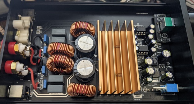

Hi Claude, Thanks for the input.There aren't here many people not liking "quite a lot" OPA1656, and that in various configurations suited to his specs (say mainly what people consider standard FET equivalent use, be it pre amp, amp, RIAA amp... quite versatile and robust little OPA as long as considering implementation as one should).
This application suits OPA1656 idealy. We had though already one person, out of a few hundreds, reporting not being happy. That means 2 things in my limited eyes and I won't go further as I do consulting for a living and that would mean charging you if starting a debate :
1- Something is wrong with your OPA1656 set up. SMD soldering, socket, PS... whatever...
2- You like it biased and non neutral re sonic performance, funky or loudness effet hello, or whatever your taste... and I respect that. Admittely there are more 'typed' OPAs around that can give you the sound YOU like and the beauty of the socket is you can try many provided they are compatible for this location.
As said, I won't expand further, did that already and opened a can of worms with someone that had limited tech knowledge. Further, at the end, my comments don't matter : this is Audio DIY, your are tweaking, important is YOU are happy and comments from others, including mine, are just what they are.
Have fun
Claude
PS: hint ...have you ever soldered SMDs before and did you consider a quick reflow of the OPA's pins?
I AM OUT, REALLY LOL!
I have been soldering smd components since last couple of years when I started playing with class d amps. However this is the first time I have soldered a 8 leg chip. Also I cross checked every solder joint just to make sure they aren't cold joints. The sockets and pins are pretty snug.
As for my like-ness for non neutral sonic, I am not sure. I feel NE5532 is much more neutral (i also see almost every site mention them as being neutral though a bit clinical) & the OPA 1656 which are certainly much evolved chip on paper lacks that level of neutrality. It sounds more warm, but that's fine as long as I am not loosing on details and soundstage. I can assure if you listen to my A07 with OPA 1656 , you will feel the loss of detail and that the soundstage became very narrow as compared to when it plays with NE 5532.
Also somebody said in OPA 1656 thread that what I am hearing as more details in Ne 5532 is the more noise !!! And that bcoz 1656 cuts those noises I am feeling it's less detailed! I have an argument against calling the NE 5532 less neutral and noisy though. How come the A07 with NE 5532 sounds closest to my other amps without any opamp ???? I guess best opamp is no opamp. And if NE 5532 sounds as close as those amps without an OPA, that means something. I am not bashing 1656 as that has been widely proved as a really good opamp but I really don't feel the Opa 1656 is a good choice in A07, might be the accompanying components around it doesn't synergize well with it. The difference is huge in a bad way. But I will still give it some time to mature.
Quite possible. Though almost all of the components seems laid out in a similar fashion and values (presuming) . But it's quite possible that OPA won't play equally well for both A04 & A07.Ah, of course then there is a third option!
I completely forgot that you had a 07 and not a 04 and hence none of our posts in this entire threads is relevant! It can be... or not.
Sorry, my bad, thought 04... re 07 no clue, never had that unit! Who knows how it works, what schematic, or... what biase sound it may have and what mod to do to compensate for them. As, let's be honest, all of these cheapo amps sound great out of the box for the money, but none sounds like an ultimate amp IMHO.
=> OK, sounds good. Just in case of, and that isn't a lot of work and doesn't mean wasting time, may I humbly suggest, based on the pix you posted, that you simply pull out the OPA1656 together WITH their sockets, put a lot of flux on the OPA1656 legs and simply put the soldering iron across the pins / legs legs of said OPA 1656. Just across all of them with a say a 350°C iron, touching quickly. Flux means the pins only will reflow, job done. And then clean the flux. May not change anything, but at least I will feel more confident LOL.
OK, there is reason for that : quick chips like OPA 1656... and much faster ones I dealt with can be quite sensitive to micro failures we may not see...
You can do that, or not, I realise cleaning the flux is a pain, but then you have flux I suppose already on hand and you paid for the OPA 1656s, so if these can be "saved" cheaply".... win-win
=> Important is indeed what you like.
NE 5532 isn't bad, but in my ears re details, response shapness, 3D image, quite in another league than amps as AD825AD 20 years ago... which is also slightly lacking IMHO vs OPA1656 everywhere, a bit, bare in the (exagerated) bass department. So at the end NE5532 vs OPA1656 in the right application (04 is such one) and with the correct OPA PS (admittely modern OPAs are more sensitive to a correct PS) should be a no brainer. Where I come from a nice Tyrell Ford from the early 70s vs a Williams of the mid 90s LOL.
Not saying neither cans be beaten nowadays, but either way it ius true 2 balanced F1 cars somehow, not lacking anything if not compared directly ;-)
=> I found OPA1656 rather more neutral in that application and others. Sometimes you could say some bass distorsion is missing. Ok, it has some very low second harmonic that brains usualy like (need?).
But NE5532 has so many limitations... something must be wrong somewhere.
Saying that, if not comparing directly, on a balanced amp, one could be happy with NE5532, it isn't that bad that something obvious pops as a problem.
But your case is different, you can compare, and assuming the right power feed (again, OPA 1656 needs a good PS, NE 5532 probably can do with lesser ones), you should hear a difference.
Oh, and the you are! Either a right one, which means your 07 needs some compensation, or a non conventional one.
Let's reflow the board / chip, and then it leaves you with what you hear. If it has changed a lot and you like it, bingo, welcome on board. If not, then we can assume you really prefer NE5532 to 0PA1656 in your set up.
If that's the case, either you are happy that way, or you wish more flavour, in which case let us know what you would like. As things are, I have always my JFET flavour box with me, various OPAs of the best quality, all measuring the same à la ASR... and all sounding so different. Gilles knows that box, called flavour box as all OPAs are quite interchangeable (similar parameters so can be used for same application). As posted on the OPA1656 thread, we played with it, and ended up in all cases with OPA1656. Use the search function to find the other OPAs and "our " findings, just our ears in a given situation.
=> Please reflow, just in case, just to make sure it is your taste and not whatever else...

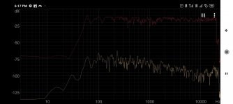

Ah, sadly you venture in a field I don't know.
We are back to 07 seeming at the end being quite a different fish than 04.
Regarding the rest of the system, can't comment either, other than a quick look on the internet on what makes IMHO the most of the sound, the LS, reveals that these are quite small speakers, defo not full range. Whatever the upgrade and how good they might sound (I don't know them), they are for sure very far from full range especialy in the bass department. Who knows what they like to be compnsated with...
The secondary system I used for this moderate 04 cheap amp testings had bass reflex speakers (quick bass loss) with 32Hz at -3dB... my very own system, the one I cherich a lot and who sees much more elaborated amps than these Class D toys, has closed cabinet speakers (slow roll off!) with 25Hz at -3dB...
Bass is not the last word of course, but I find that bass contains... not only bass when it is recorded, but a lot of room information regarding echo and location, spatialization etc.
I can't really say how your system sounds, how coudl I! but based on tour product description I would say it either needs a big boost from a subwoffer or a some kind of compensation in the low range. After decades of experience, I would say that eventhough prople tell us that walls etc. boost the bvass, it doesn't come close to the real thing.
Bottom line, and that's a pure conjecture, only in hope to be helpfull: it could weel be that you prefer for your set up an OPA with say quite a bass boost, and even some distorsions might be perceived as benefical in some cases.
If you feel you need more ommph for your taste, then you might indeed look for modern but somewhat bass heavier OPAs
If all this is not the case, please just ignore my post, sorry for interfering!

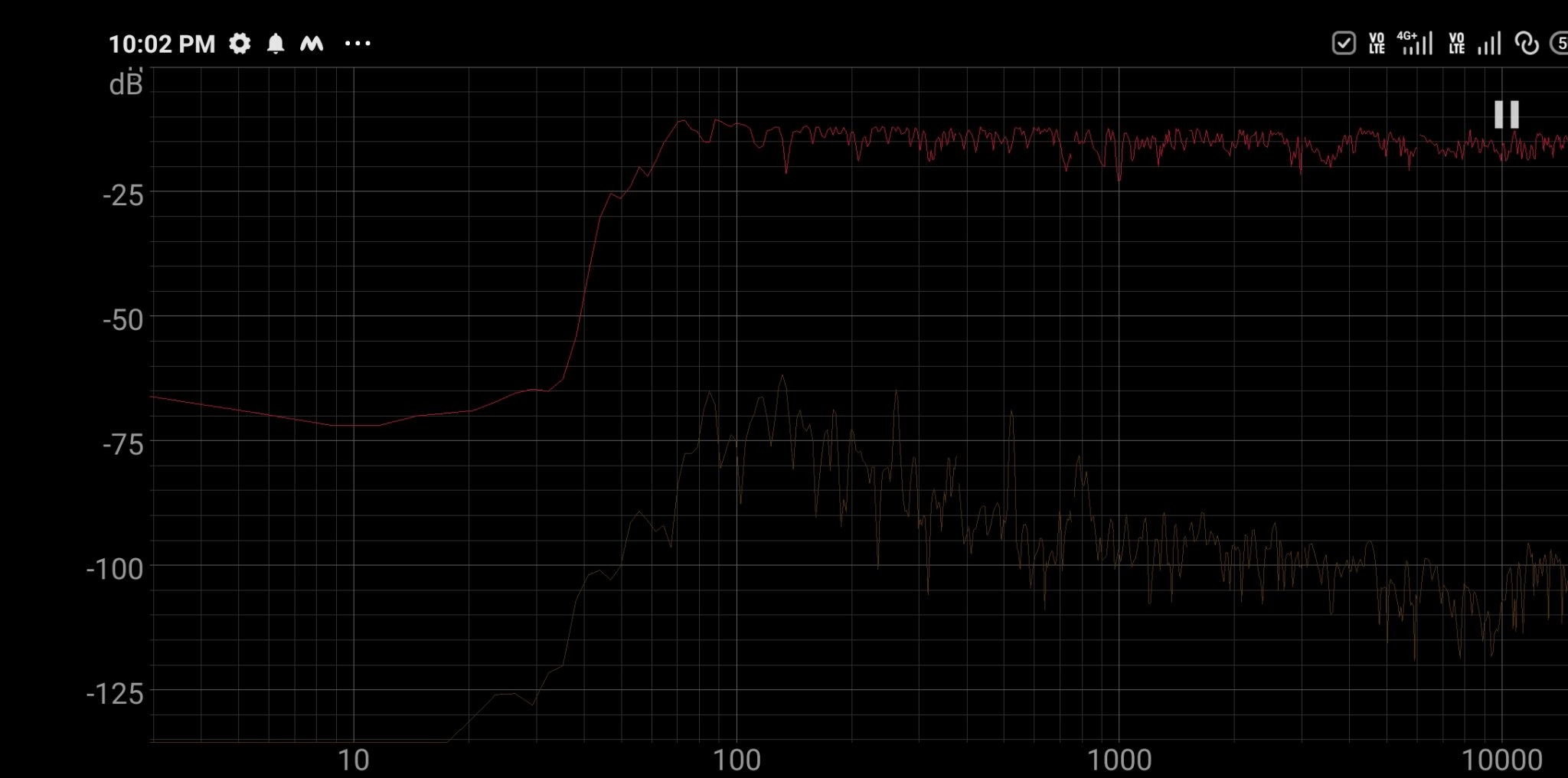

I have attached the frequency response of my speaker (Placement 1). Its pretty flat from 100hz onwards. The dip you see at 70 & 120 are room modes. Also the hump at 60 hz is room mode. It might be due to the depression in 120-125Hz that's causing a feel of thin sounding bass. But am pretty content with it. These are 4 inch speakers in a very small cabinet. The bass they do is unbelievable for their size & also my room is roughly 15x10x12 ft. I can feel the bass from 50hz onwards very prominently. I have managed to eliminate the crest & trough in bass region via some careful planning ( Placement 2). Still the trough at 120-125 hz persists(attribute thin bass which i dislike, lack of boominess that i like). I am still okay with that untill i do proper damping.Ah, sadly you venture in a field I don't know.

Hello, I hope someone can help me!
I a couple of weeks ago I got a couple of Aiyima A07 amps to build a surround system.
For the main speakers I use an amp which I just built using 60W Ultra-low distortion composite amp kits from Kaltecs.
I read a good reviews about Aiyima so I thought it would be a nice fit.
I was absolutely amazed how small they were but this was the only good thing!
First, I tried them with my main speakers. The sound was not good at all - hum, no clarity, very poor dynamics, feeble bass, terrible highs.
I read that op amps rolling is very good mod so I got OPA1656 and OPA1612 from an eBay seller with 100% positive feedbags.
I installed the new op amps. First OPA1656, the sound got little bit better, highs got improved, but still not clarity and hum in the speakers (hearable 10" away from the mid range), poor bass. Then I tried OPA1612. The sound got little bit better than OPA1656 but still far away from the quality that I expected.
Second, output power. The amps are rated 2x300W. Ha, ha, ha, what a joke. If this is 2x300W, then my 60W kits must be 600W!!!
Third, I tried them with my surround speakers. In this case the difference in the sound quality compared to my main amp wasn't so huge, but still very long way to go.
So, as I already modded the amps I can't return them and I was wondering are there any other mods that I can try? Maybe my speakers are not good match for Aiyima amps. Maybe the power supply is not good.
Any help will be highly appreciated!!!
