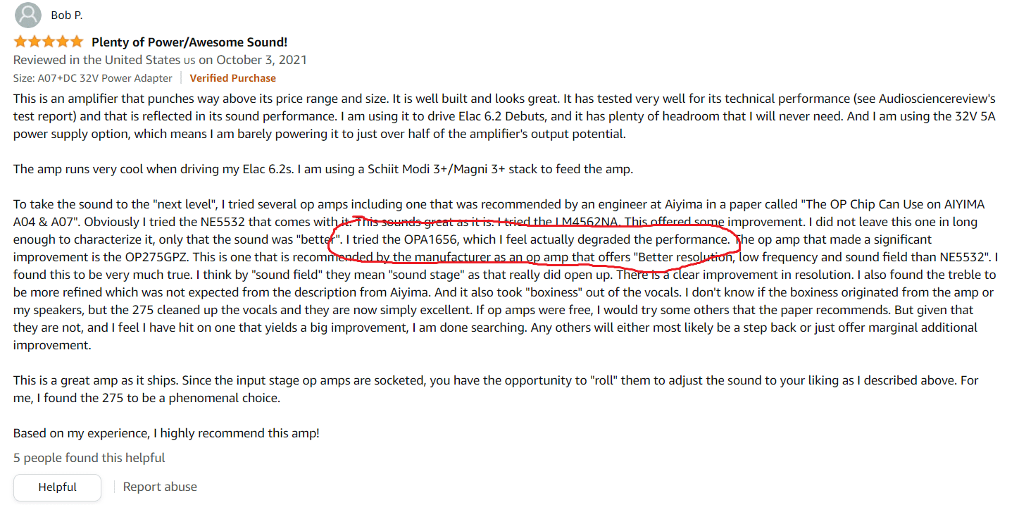

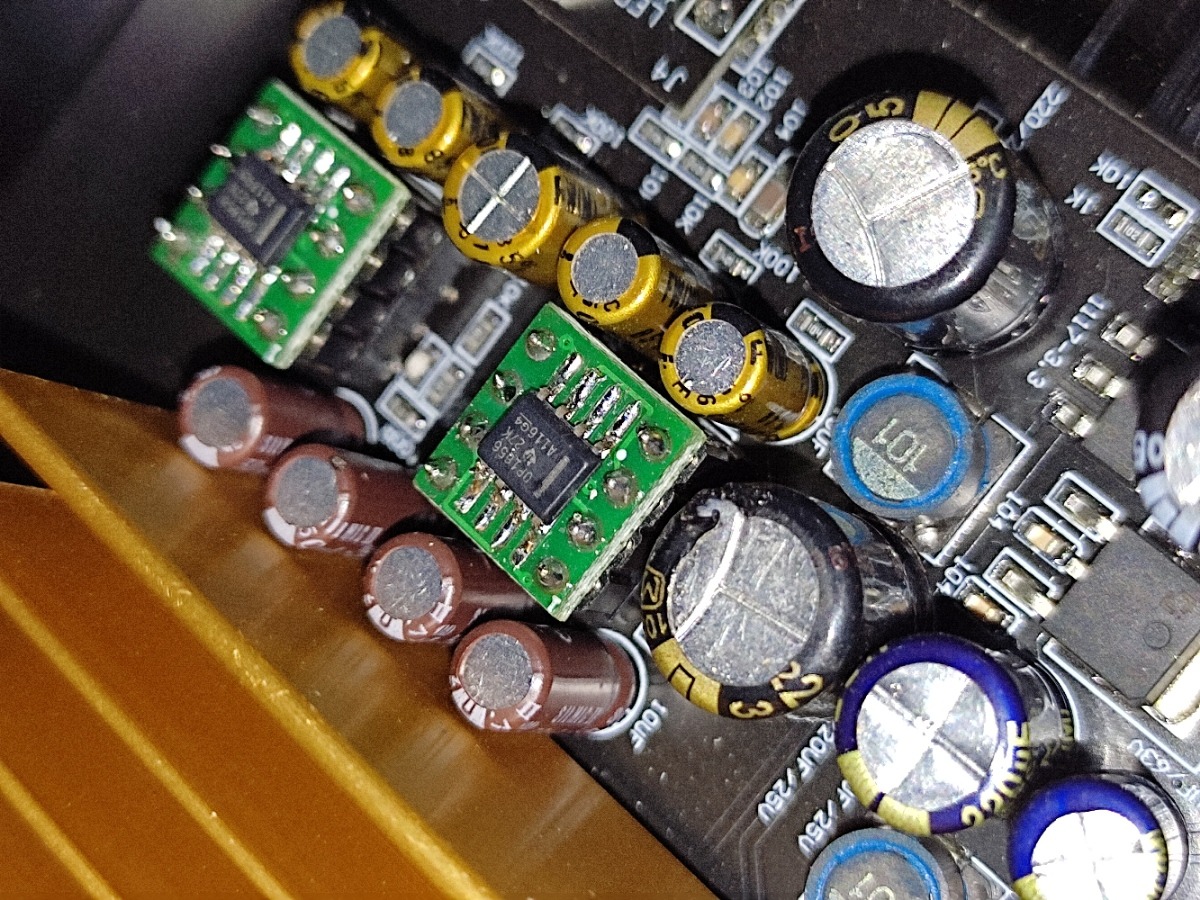

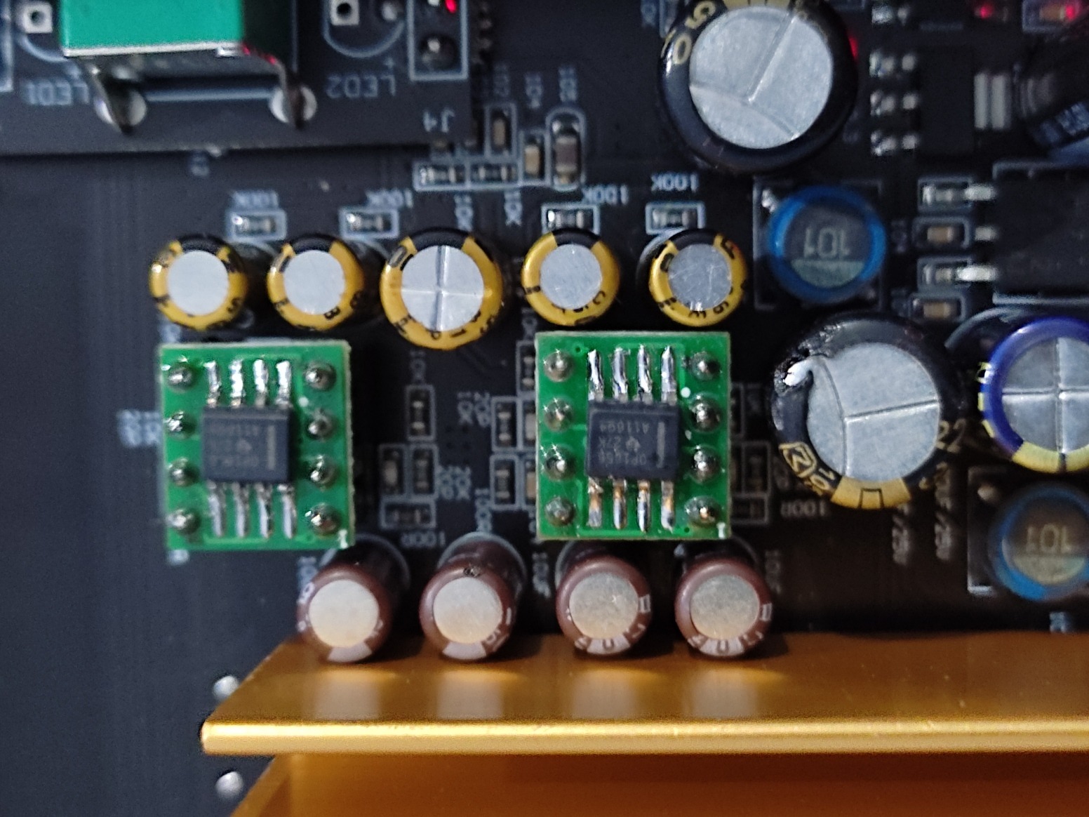

Hello everyone. I upgraded my OPamp on my Aiyima A07 from stock NE5532 with OPA 1656, having read alot of good things about them. But i am very dissappointed. The sparkling high end details dissappeared while making the whole presentation very dull & boring. The audio feels much better overall with NE 5532. How is this possible. Am i doing something wrong ? Or are the 1656 chip supposed to have a burn-in time ?
Also, I have used 4.7uF electrolytic + 0.22 uF film cap across the OPamp power pins. But removing them doesn't improve the sound either.
I would recommend to remove the bypasses(which you already did). The new opamps brand new should be better than the stock "NE5532" which are probably fake(mine were). One question: where did you buy the opamps?. A trusted source like Mouser or Digikey is recommended. Could you share some close up pictures?Hello everyone. I upgraded my OPamp on my Aiyima A07 from stock NE5532 with OPA 1656, having read alot of good things about them. But i am very dissappointed. The sparkling high end details dissappeared while making the whole presentation very dull & boring. The audio feels much better overall with NE 5532. How is this possible. Am i doing something wrong ? Or are the 1656 chip supposed to have a burn-in time ?
I bought these chips via mouser & have hand soldered them myself. I have rechecked all solder joints & everything looks as it should be.I would recommend to remove the bypasses(which you already did). The new opamps brand new should be better than the stock "NE5532" which are probably fake(mine were). One question: where did you buy the opamps?. A trusted source like Mouser or Digikey is recommended. Could you share some close up pictures?
Right now I have bypasses removed on them & waiting on how they will compare to NE 5532 after couple of days. It's just an hour old for now.
The sound is not bad actually but i don't feel it as an upgrade !
The sparkle is gone (i was fearing this since 1656 are considered bit warm & analogue-ish, but thats okay). But i sense a loss of detail as well
The sound now feels like its coming mostly from in between stereo speaker ( much constrained ), while wiith NE 5532 it feels like the notes are floating all over in the space between & outside the speaker.
It killed the lively sound and is now very polite which lacks musicality in my opinion. The hi-hats , percussions feel boring & not lively at all.
Should i expect them to improve over time (dramatically?) ? Or is it just that this OPAmp isn't synergizing well with the rest of my system ?

1- Something is wrong with your OPA1656 set up. SMD soldering, socket, PS... whatever...
2- You like it biased and non neutral re sonic performance, funky or loudness effet hello, or whatever your taste... and I respect that. Admittely there are more 'typed' OPAs around that can give you the sound YOU like and the beauty of the socket is you can try many provided they are compatible for this location.
As said, I won't expand further, did that already and opened a can of worms with someone that had limited tech knowledge. Further, at the end, my comments don't matter : this is Audio DIY, your are tweaking, important is YOU are happy and comments from others, including mine, are just what they are.
Have fun
Claude
PS: hint ...have you ever soldered SMDs before and did you consider a quick reflow of the OPA's pins?
