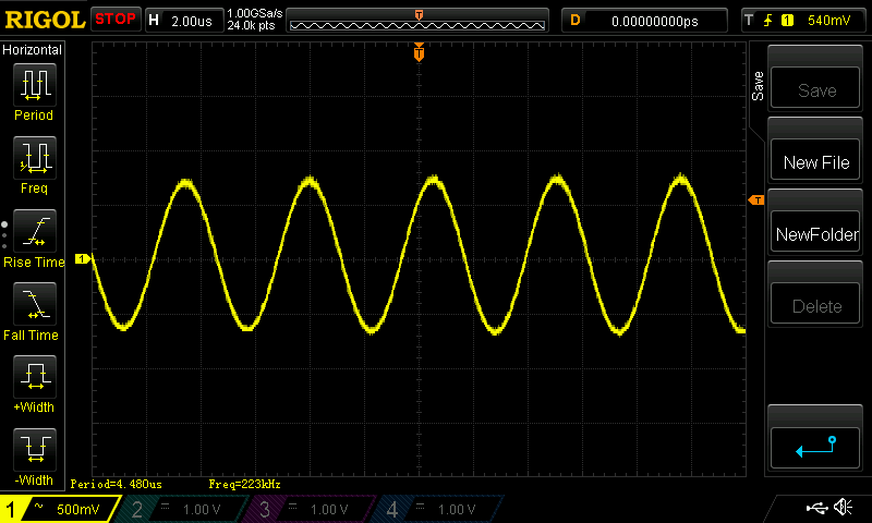

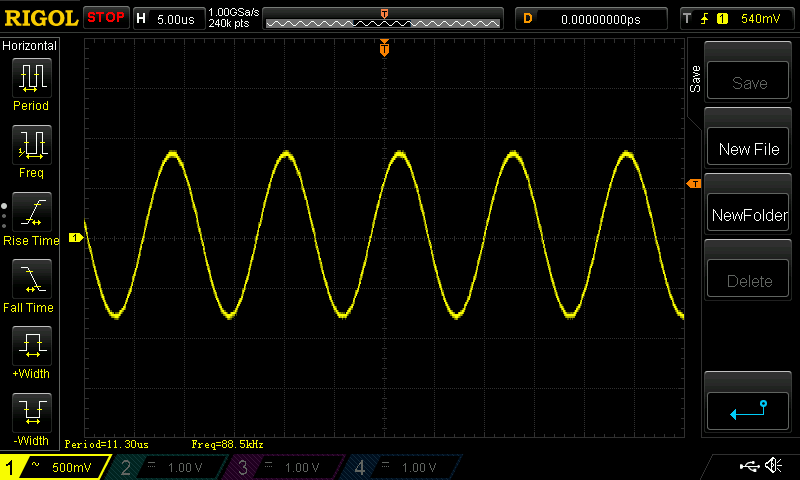

88kHz signal at 192kHz (24.5MHz MCLK) would get directly converted by the DAC to fig 1, but after complicated upsampling to 384kHz (again 24.5MHz MCLK) it gets converted to fig 2. The subsequent analog filter visually fixes the worst, but wide-bandwith analysis would likely show some major 384kHz content.
The DAC's support for higher samplerates is just a marketing crap, IMO.

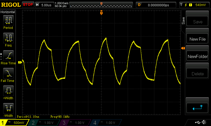

My motivation was 512kHz samplerate ADC with DAC logically running at the same fs. Now this AKM "feature" is a real game changer. I can "crank up" FSx128 (i.e. the properly working quad) to 460kHz (MCLK 58MHz - look at the pretty 220kHz at DAC output with the sharp filter selected - fig 3). But at 512kHz FS (MCLK 65MHz) the digital filter already hits random errors :-(

The support for higher sample rates is there. What seems to be missing is the support for 8x digital filter above 192kHz.
But is this (IMO correct) conclusion anywhere to be found in the datasheet? It even talks about oct and hex modes, as if they did anything useful. Maybe a short explanation could have been added:
normal -> 8x oversampling
double -> 4x oversampling
quad -> 2x oversampling
oct -> no oversampling
hex -> no oversampling
