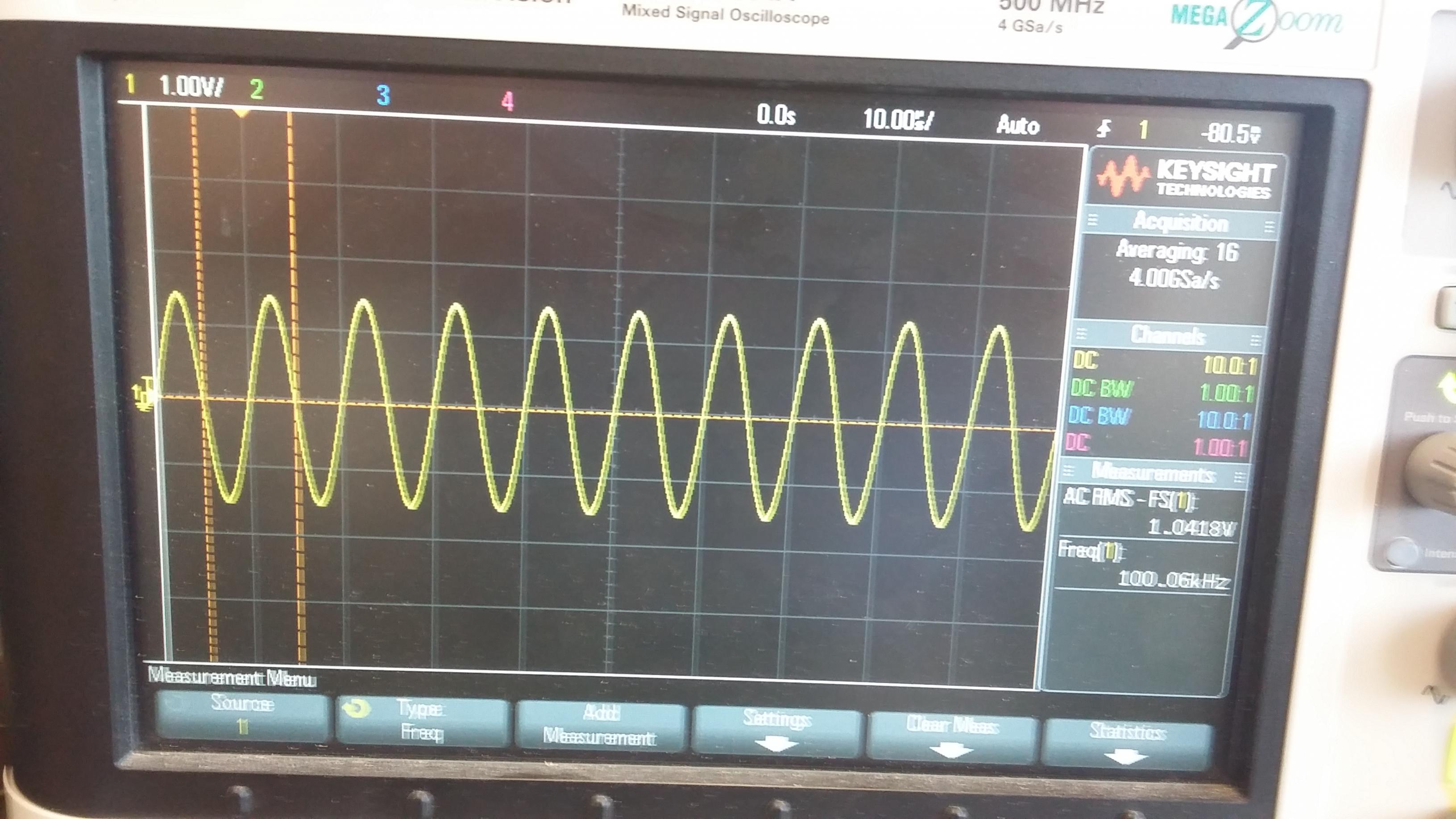

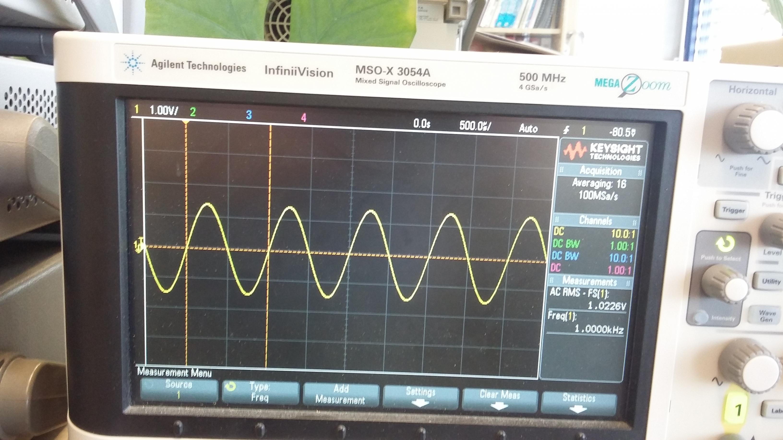

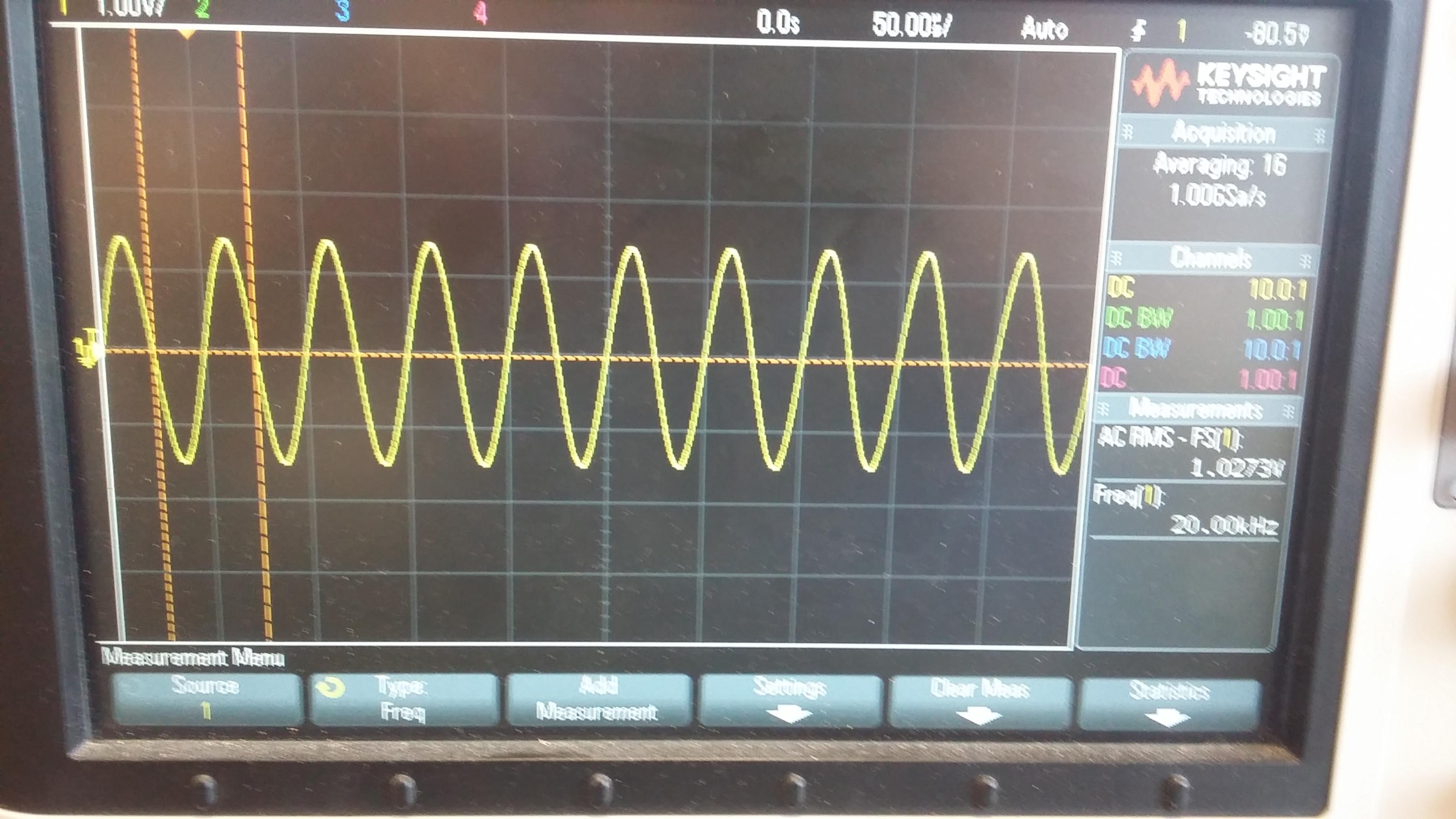

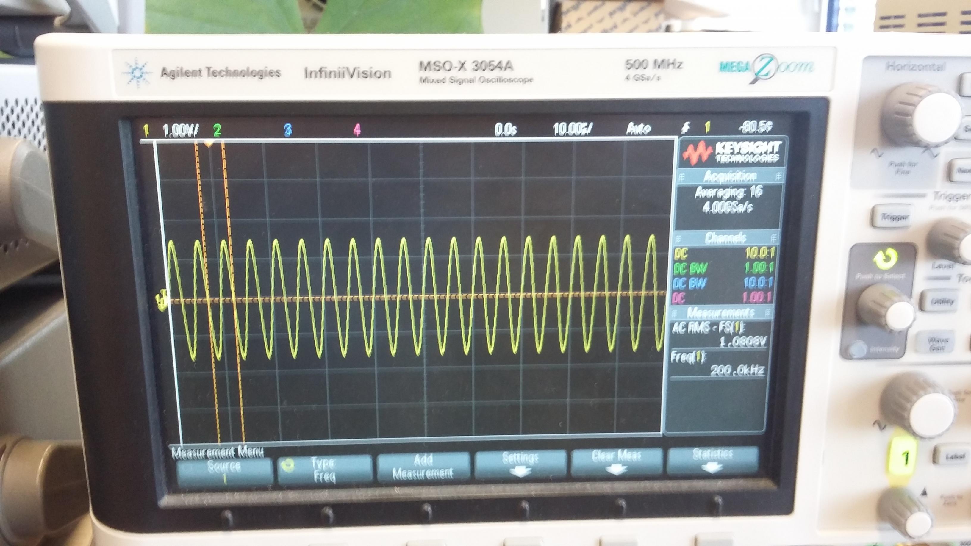

FR of ES9038Q2M @768kHz samplerate, probed at output of analog filter with Fcut-off = 400kHz.
1k, 20k, 100k, 200k flat, at 350k drop 10% (may have been caused by the filter)

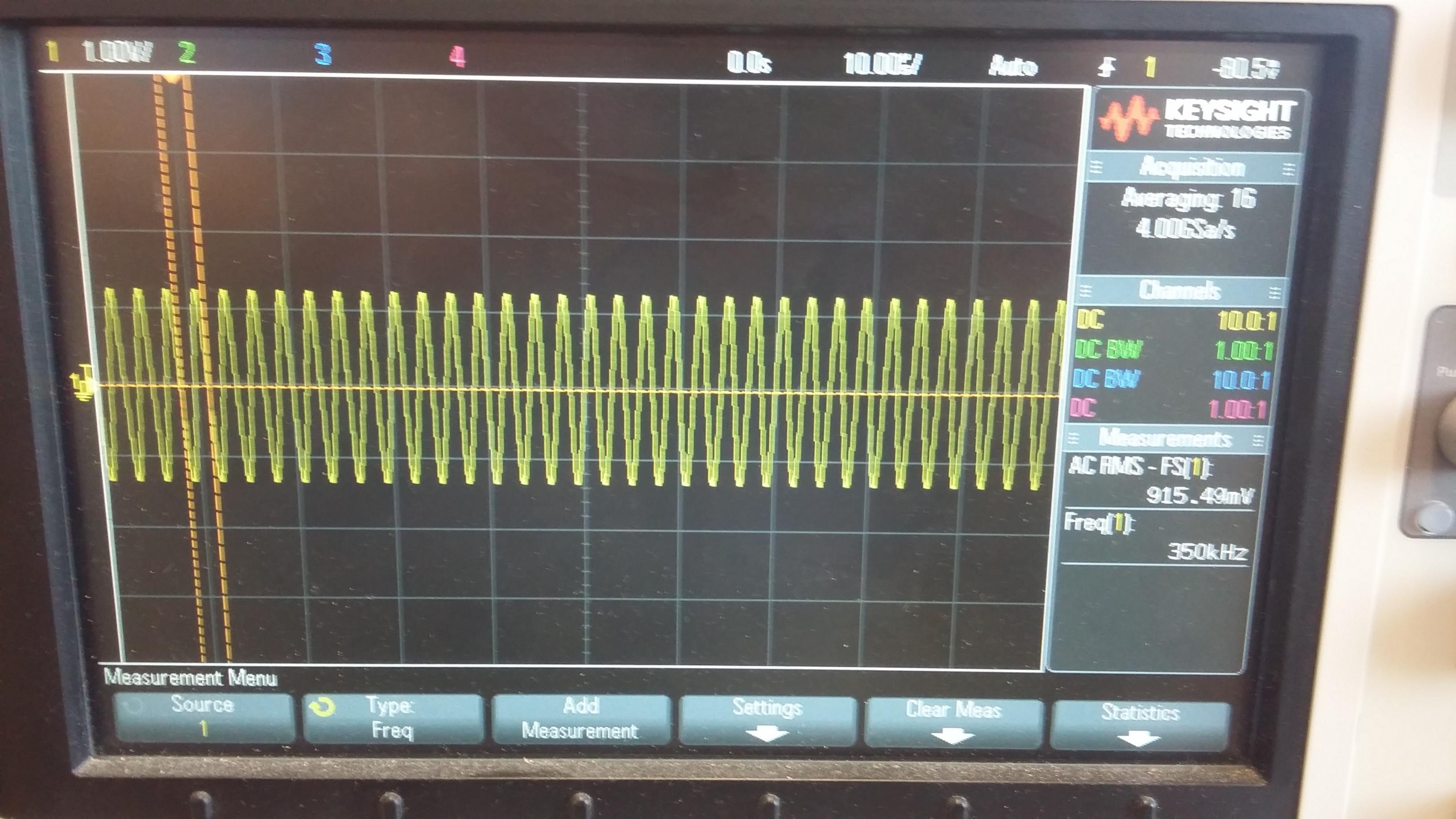

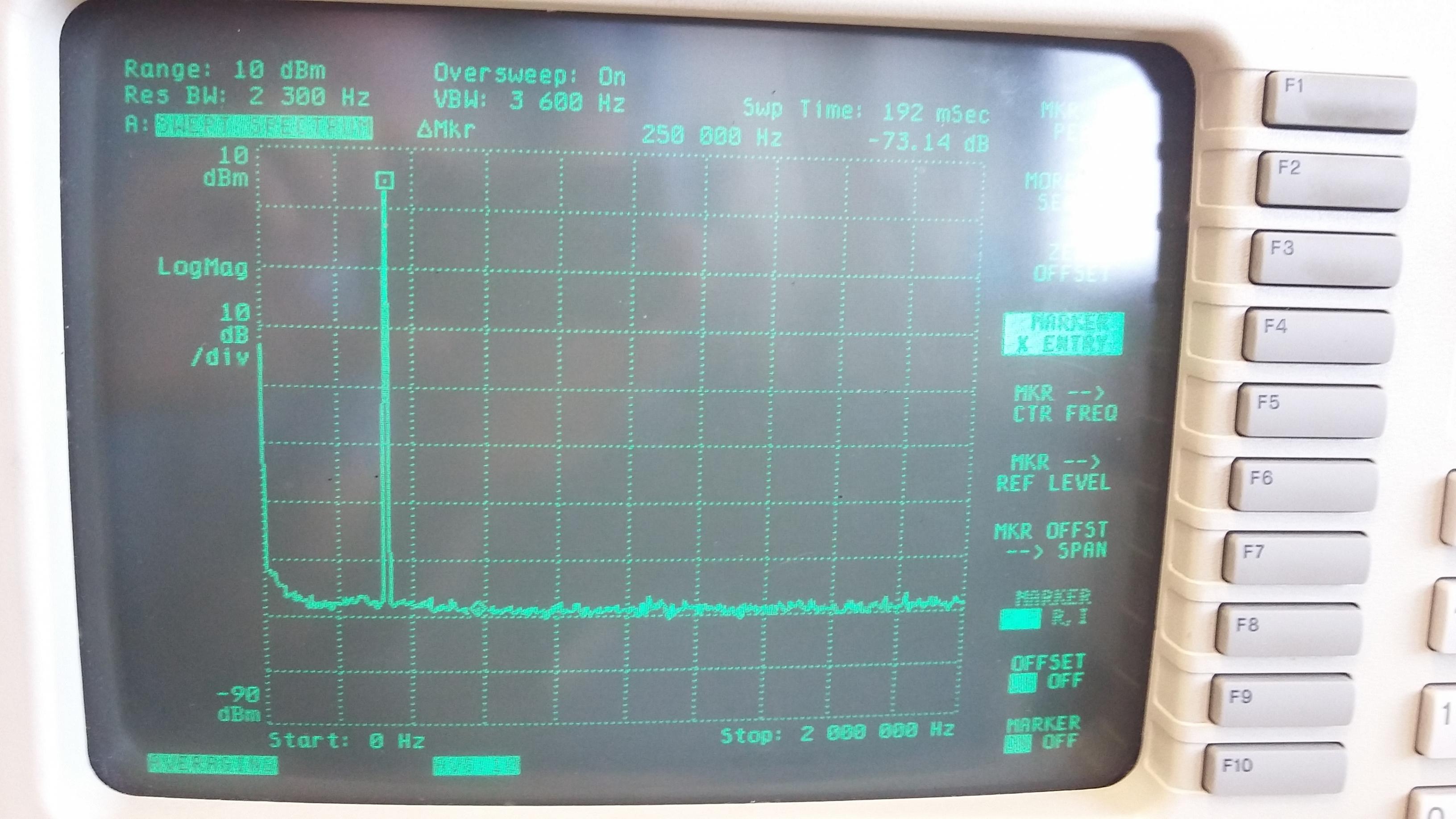

Wideband frequency analysis:

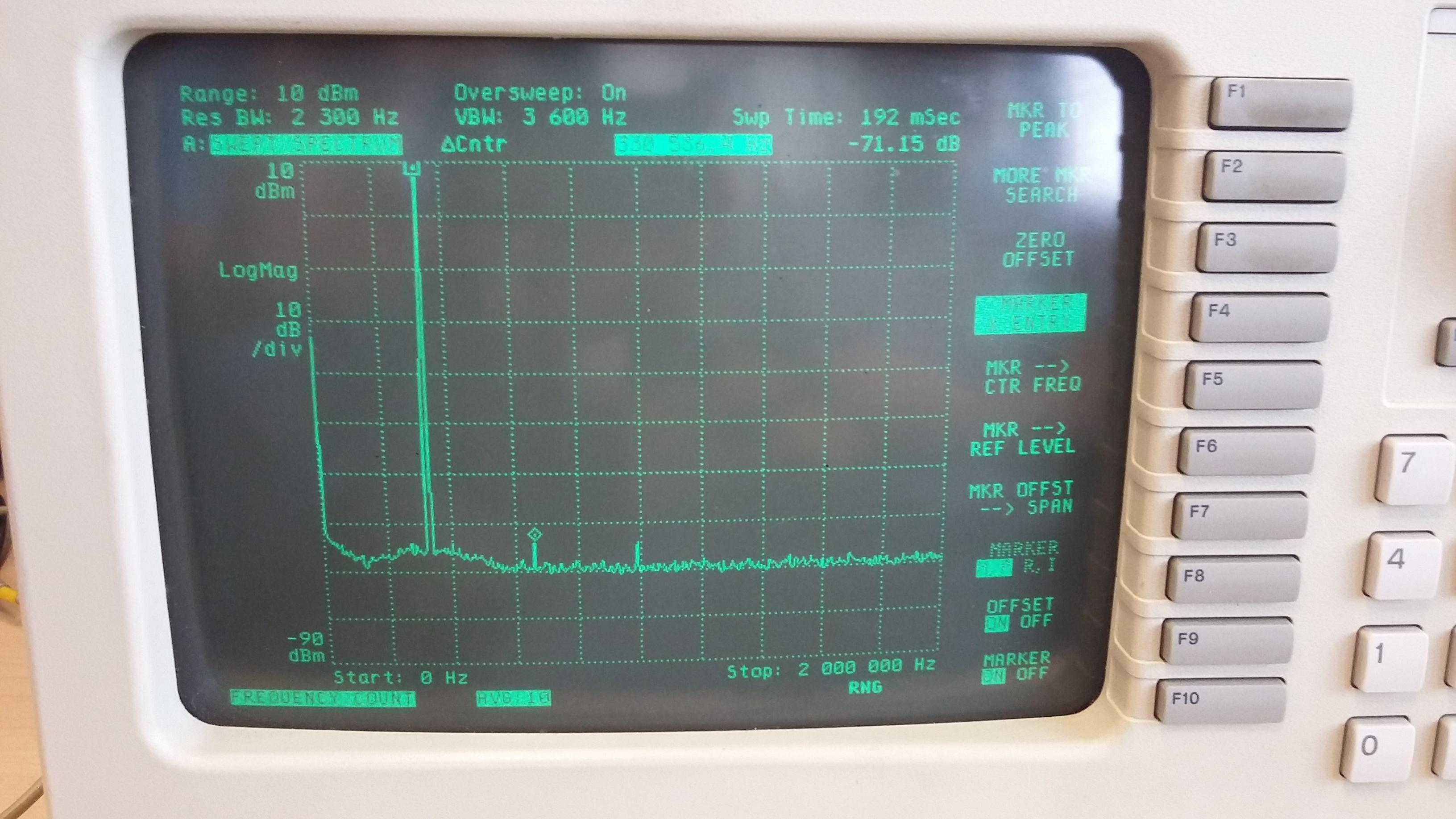

Fig 1 - 350kHz@768kHz, I/V output, 2MHz range, no harmonics above -73dB analyzer noise floor
Fig 2 - 350kHz@768kHz, filter output, 2MHz range, the filter starts distorting, OPA1656s are too slow

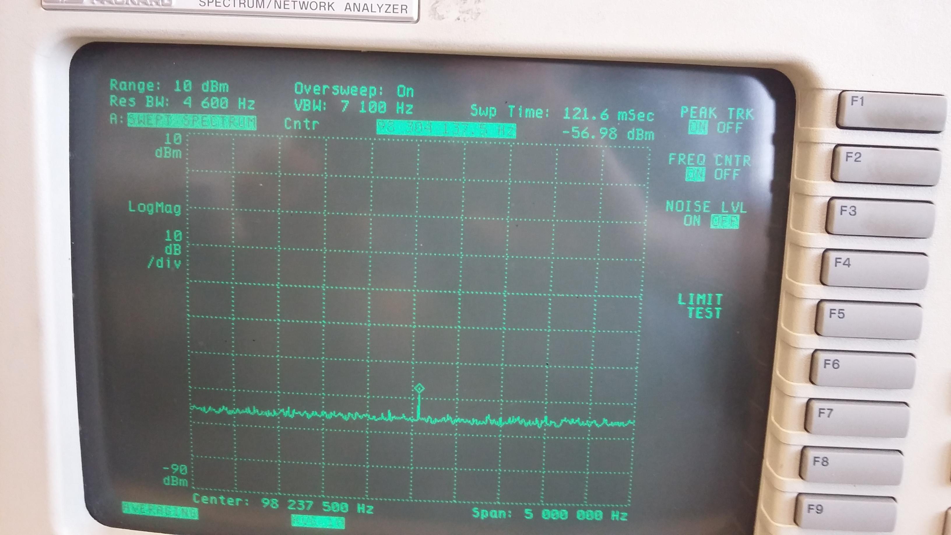

Fig 3 - 350kHz@768kHz, I/V output - range up to 110MHz manually scanned, first peak located at MCLK 98.3MHz, -57dBm=320uVrms

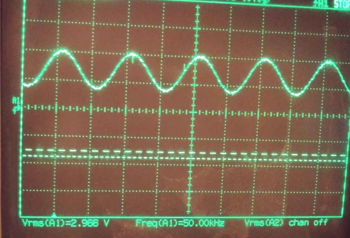

"directly" mean at DAC's pin before LPF?Originally Posted by phofman View Post

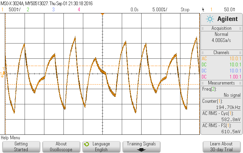

50kHz directly behind AK4493@768kHz
Sorry for the bad picture from old HP, newer scope is at another room.
This is AK4490@768 at pin 25:
My picture above was with 512fs (22/24MHz), so at 768 it was 32*768.
50kHz is non-integer samples per period and thus moving. Please try integer divider (e.g. 48kHz) or single-shot. IMO you will not see any oversampled points (only the original 16 points per period), unlike 48kHz at samplerate <=192kHz.

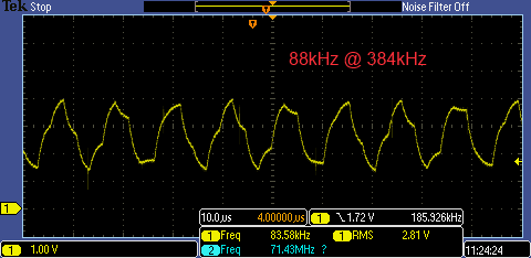

48kHz@768kHz, single shot.

Altor, do you have your DAC switched to quad at 192kHz?
Yes, DAC is in quad at 192, oct at 384 and hex at 768.
In this device I used 512fs clock (22/24MHz) and Auto Setting Mode (ACKS bit = “1”).
We talked about the digital filter, before D/A conversion.
Sorry for the misunderstanding.
I'm also puzzled by the NOS appearance of you 88k@192k in quad mode. If what was discussed earlier in this thread is valid there should be 2x oversampling at quad mode.
