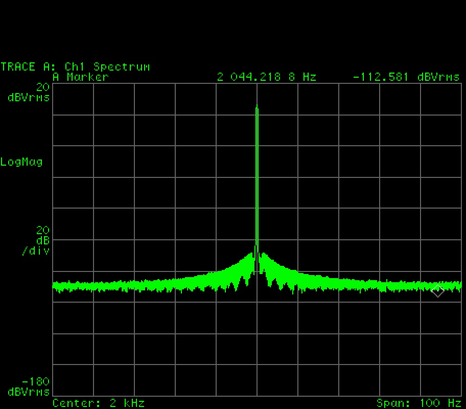

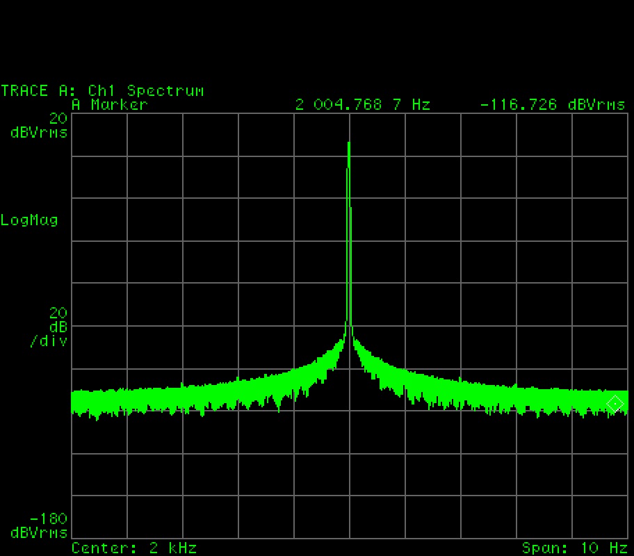

Here's the much sought after close-in noise effect on an analog DAC output. Conditions:
- PCM5142A DAC chip with datasheet dynamic range=112dB SNR=112dB THD=-93dB. This is a poor DAC by any high end audio metric, it is for TVs, auto, AV receivers, other cheap consumer products.
- DAC Clock is a $3 ASTX-H11-20.000MHZ-T (Abracon Corporation) with -130dBc @1kHz offset, no spec below. By all high end audio metrics, a cheap piece of junk.
- The DAC is followed by a 2KHz 8th order filter. Before the filter, distortions in an 80KHz bandwidth is measured -97dB, after the filter is measured -128dB, both THD.
- Single ended output, DAC is @FS (analog: 11.88Vpp = 22dBV)
- SA driven by 10MHz reference from a Datum 2100 TymServe GPSDO with a MTI-270 oscillator OCXO in a PLL. OCXO phase noise is specified as -105dBc @1Hz and -157dBc @100KHz, better when the PLL is closed, no idea how much.
- FFT with 3601 points, RBW=30mHz, span 10Hz, flat window (high amplitude accuracy), 15 averages. Process gain is about 34dB @fs=48KHz.
From the screenshot (vertical 20dB/div, Hor 1Hz/div):
- Noise floor is around -117dB
- No spurs in this BW
- Close-in phase noise creeping from the noise floor at 1Hz around the carrier and extends to -90dB
- SNR = 22dB + 117dB = 139dB. Subtract the process gain and you'll get the DAC SNR = 107dB. Lower than the DAC spec, but this is measured very close (5Hz) away from the carrier, probably in the 1/f phase noise region.
- DAC SNR at lower than 0.1Hz from the carrier is 22dB + 90dB - 34dB = 78dB
Now somebody has to show proof that he can discriminate by hearing -78dBc noise @0.1Hz Note: Masking effect is real.
This is a mediocre DAC chip (to put it mildly) and a cheap DAC clock. Though the Golden Ear that proves, by a rigorous controlled listening test (anecdotal stories are not acceptable), that he can identify this crap DAC, from the best of the best DACs and clocks on the market (self made, modded, or commercial) gets a prize and my apologies for sub estimating the human hearing abilities.
P.S. Why did I bother to show this? It will not change anything, nothing could. I guess I'm an ethernal optimist, though.
A quick pass with a BW of 100Hz (Hor 10Hz/div) confirms the above hypothesis, see attached screenshot: process gain is now 24dB @fs=48KHz and therefore the SNR is 22dB + 113dB - 24dB = 111dB which is right at the PCM5142A datasheet SNR of 112dB. Conclusion: the crap Abracon oscillator is actually not bad at all for this cheap DAC. It's phase noise corner frequency is likely buried in the noise floor.

Finally the measurement that everyone was waiting for has arrived.
Then the dacs are all the same!
This I really did not imagine.
Many thanks, now I throw out my devices and stop all new designs.
I don't even need to buy the DAC, I already have a nice 47 Euro ALLO Piano kindly offered by the manufacturer.
Of course, I also throw out the ALLO Kali, the FIFO buffer does not matter because there is no difference between its NDK oscillators and that of the RPI source with its nice PLL.
Nor there is a need to isolate the time domains between the source and the DAC, timing errors don't matter.
Recommended for everyone.
Maybe someone should change the title of this thread from "Best DAC ever" to Best DAC ever: they are all the same"
Congratulations, you have measured the diameter of a microbe with the tape measure.
