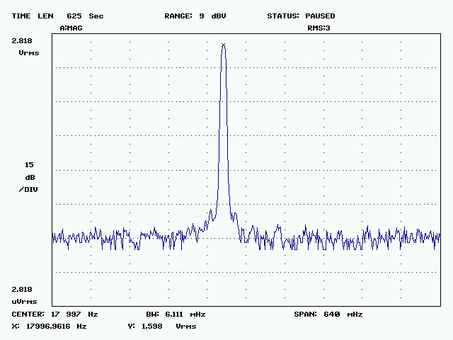

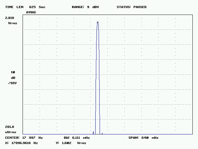

Hmm. When I saw the result of Syn8, it dawned on me that this one I can repeat too. Not exactly, because I only have an 3561a, but the core of it, like to have a close look at a single tone signal, with an instrument developed for this purpose, it could be done.
The declared dynamic range is 80dB, and in fact, I can't get a lower floor than ~-85/86dB.
But looking at the peak zone, how much it is enlarging, could be done. The card is my EMU1616m, i'm generating a full scale 17997Hz signal and I'm using one half of the balanced output.
Only ~18kHz, because it drops too much approaching the max freq. output.
I put it here, just so as to disturb the waters..
10dB/div, 6,11mHz RBW, 600mHz span, (0,6Hz the whole screen..) window is flattop
The signal has a cca. 15mHz FullWidth -75dBc down

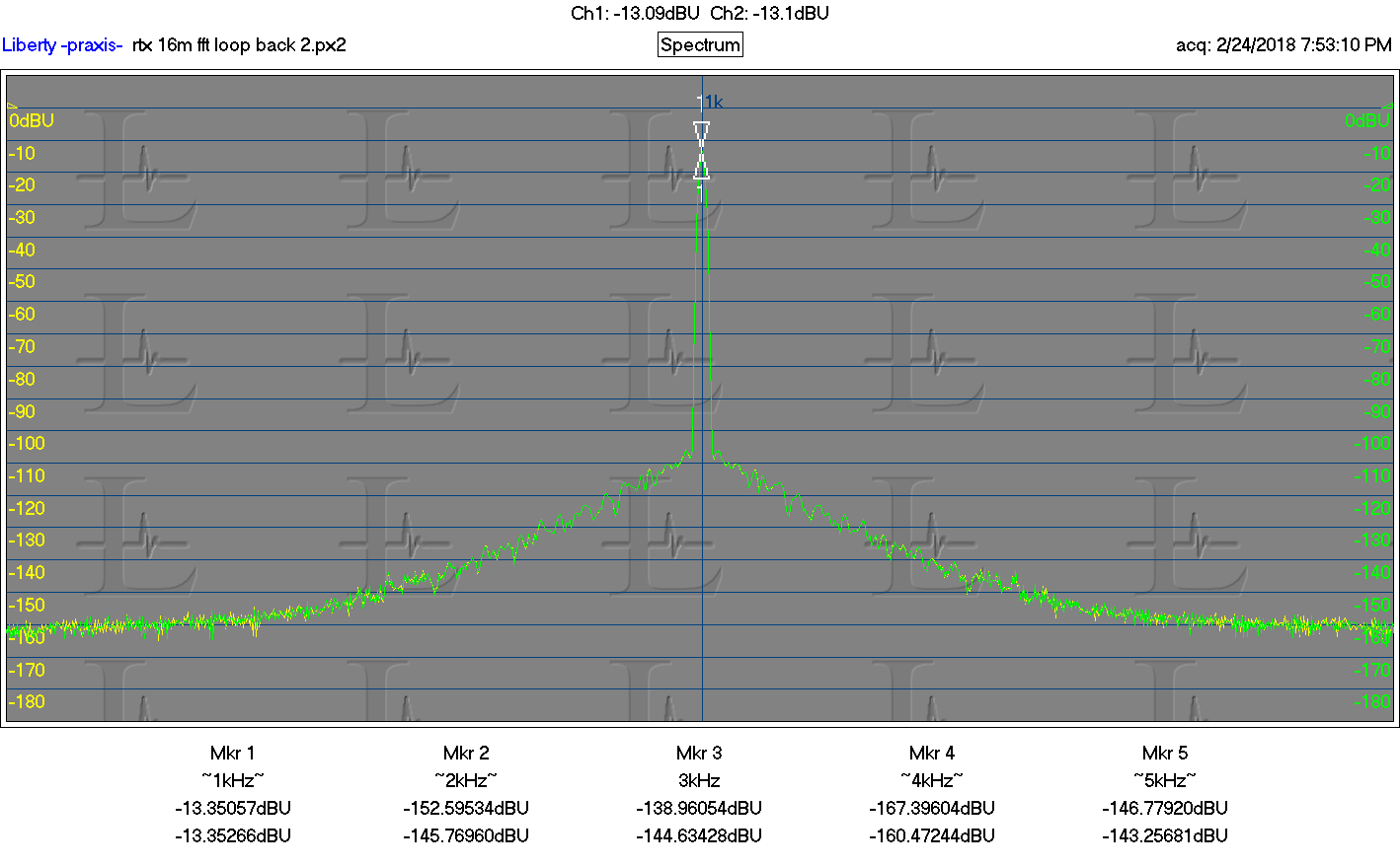

Here is a loopback measurement of an RTX. It 192 KHz sample rate and 16M points. It took a while but you can see close in with this. Its 1 KHz +/- 5 Hz. There are some windowing issues I'm sure but its something like .01Hz resolution.
I do not have a similar test between two boxes running on separate clocks however i may be able to set that up later this week.
Demian, not sure if a loopback is correct/relevant. If the DAC and the ADC are running on the same clocks (as I assume they do) then the phase noise is correlated and it averages out. What you got is mostly a windowing effect (use a flat window, BTW, since it preserves the amplitudes) You need an independent ADC, running on its own clock (with very low phase noise) in order to analyze the DAC clock effect.
