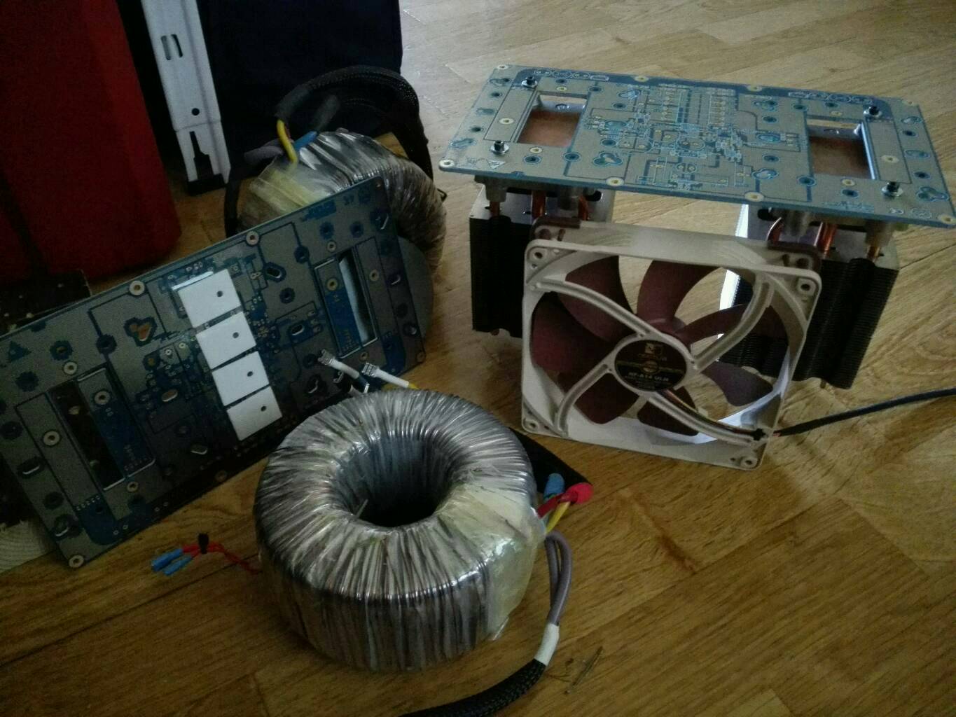

The psu rectifier heatsinks are 58°C and the resistors are 55°C, the hottest part on the BB is the aluminum angle used to clamp the mosfet to the cpu cooler at 42°C.
Way to go X, you’ve been right on with the cpu cooler experiment!
You have no holes under those heatsinks, in that case, you supposed to lift up the heatsink from the PC board 5-10mm. Around your heatsinks, the air cannot circulate how it should. For class A/B or low-class A, it would be fine that PS setup, for heavy biased class A amplifier not the best, imagine if you move it into a (almost) closed amplifier case. Be careful when you increase the PS voltage that will increase the heat also. I think you know that.
Gaborbela,
I was thinking about drilling holes in the board under the heatsinks but, there is no clear shot. I’d either drill through the ground or power plains. Since the to-220 mounting hole is not centered, I’m thinking about flipping the heatsinks around and I’ll get a gap the bottom.
Also, I’m thinking a 500va, 30vac secondaries would be a better option than
28vac. Especially if I go with a CRCRCRC type psu.

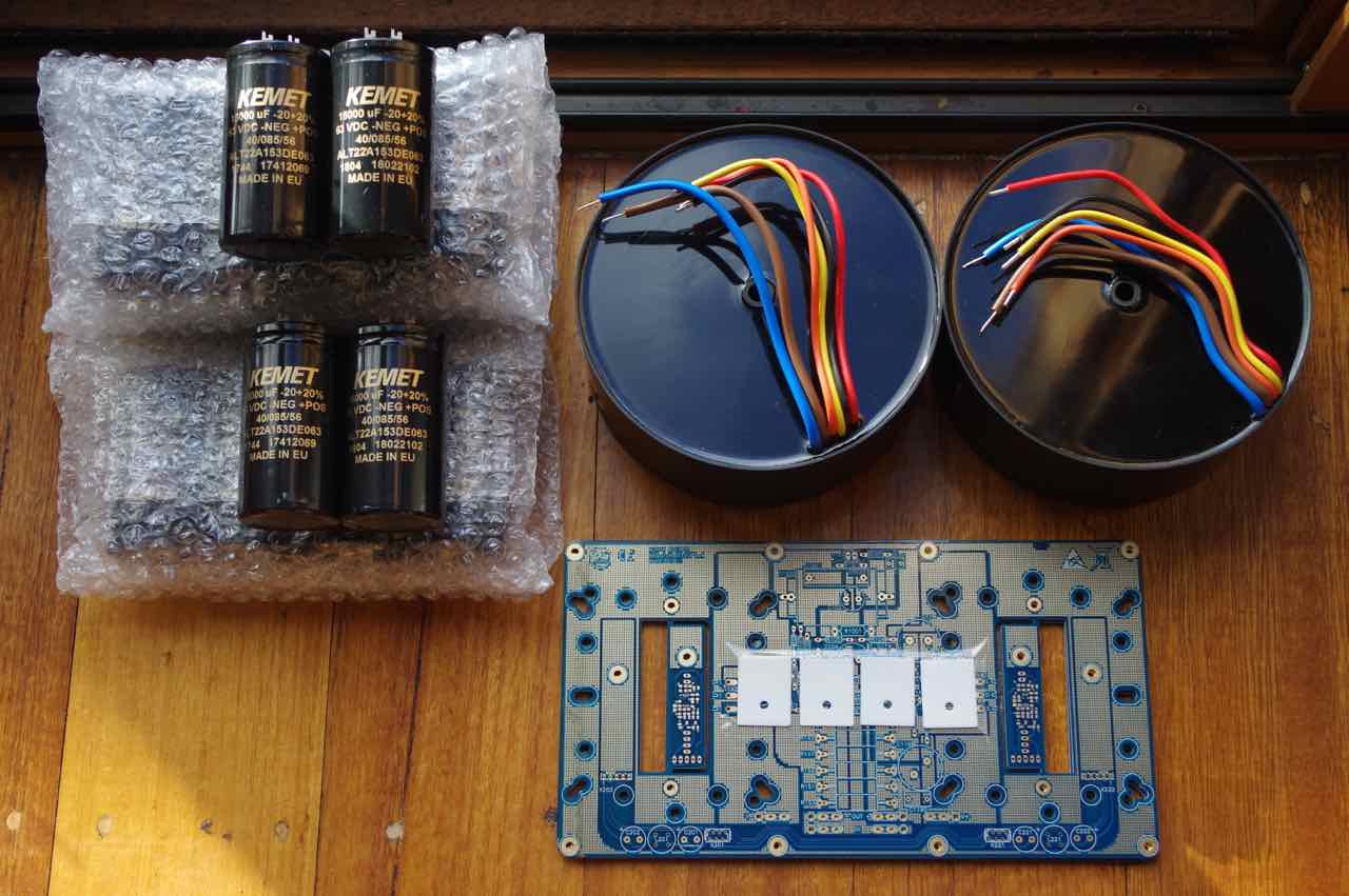

The transformers are RS PRO 500va 30v rebranded Nuvotem Talema made in the Czech Republic. $84.93 AU each.
X, Caps are Kemet 15000uf 63v from Mouser I reckon these are a bargain at $7.25 AU each but i did buy 16 so it does add up but i'm only going to build the BB Alpha one time At least i hope so.
Steve.
Wtl,
Real nice parts for your BB
I’m going to use the same size trafo’s also.

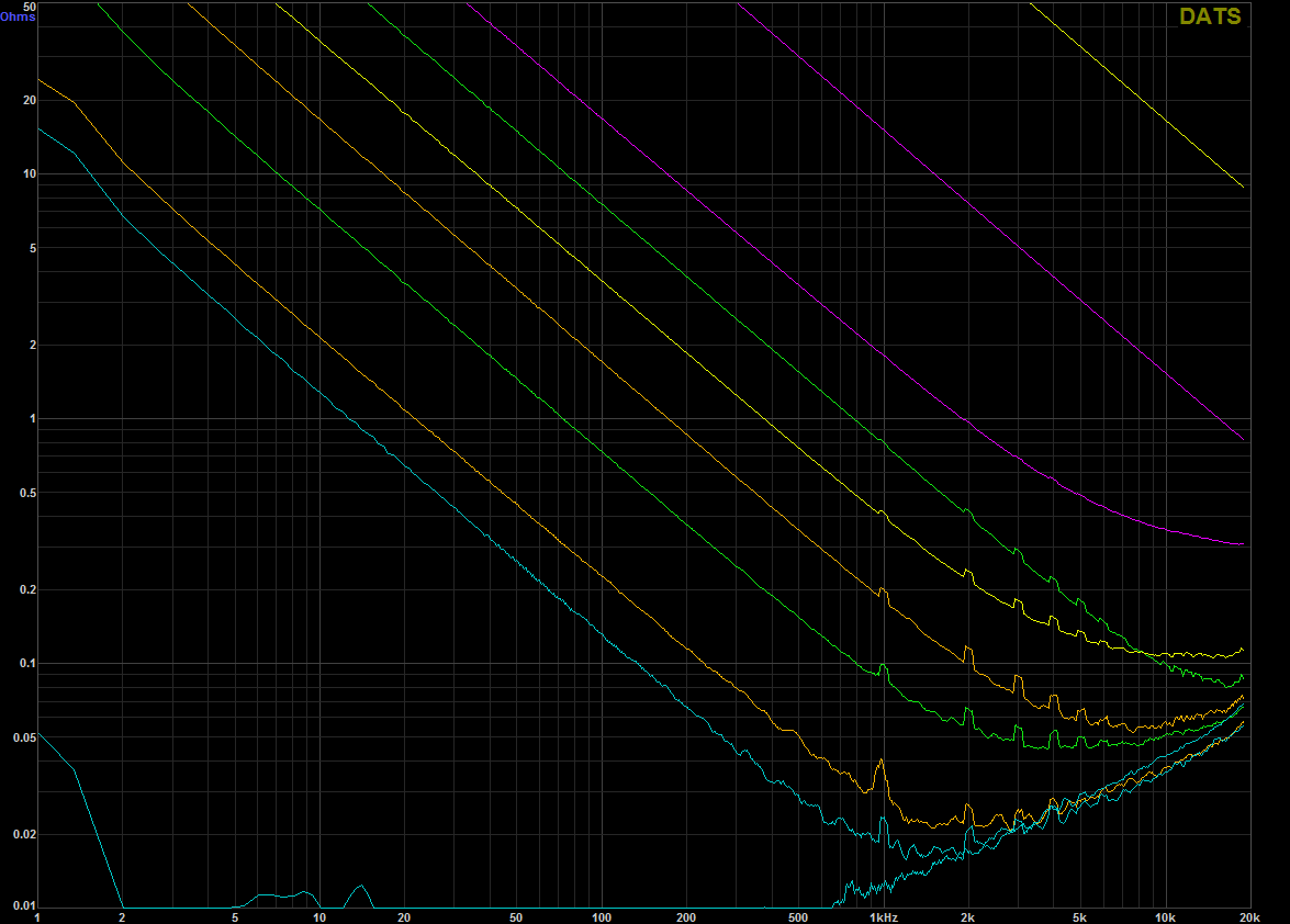

...I think lower ESR power supply caps will give better bass authority, not sure how it affects the mids and highs and transparency or forwardness though?
Could a good guess be speed of available current when amp needs juice is proportional to actual AC impedance of last stage of capacitor bank that amp can see as its feeding rails.
Below is a homemade AC impedance overlay for 1uF/10uF/100uF/220uF/470uF/1mF/2,2mF/6,8mF/12mF/35F, regarding dielectric 1uF and 10uF stand out in they PP film where all the rest are traditional electrolytes, the big value 35F one is not very practical in its voltage range is a low 2,5V number.
Think one could kind of scientific investigate this point measure a power amp using low value power bank verse same amp using big value capacitor power bank, then in REW look for if excess phase at lows increase some cycles for the low value power bank verse the big value one, kind of proportional to how impedance graph for the two between will look.
Sorry i kind of thought overlay would give itself and some of the reason why we pick high or low values for a particular job whether its for filter shunts or coupling : ) the right order of traces is higher values starts at left so the two strait lines at right are the smaller values of 10uF and 1uF that also happens to be the PP dielectrics, in reality those strait lines would look close to scheme of the bigger values its just that it happens up at a frequency not covered by DATS bandwidth.
