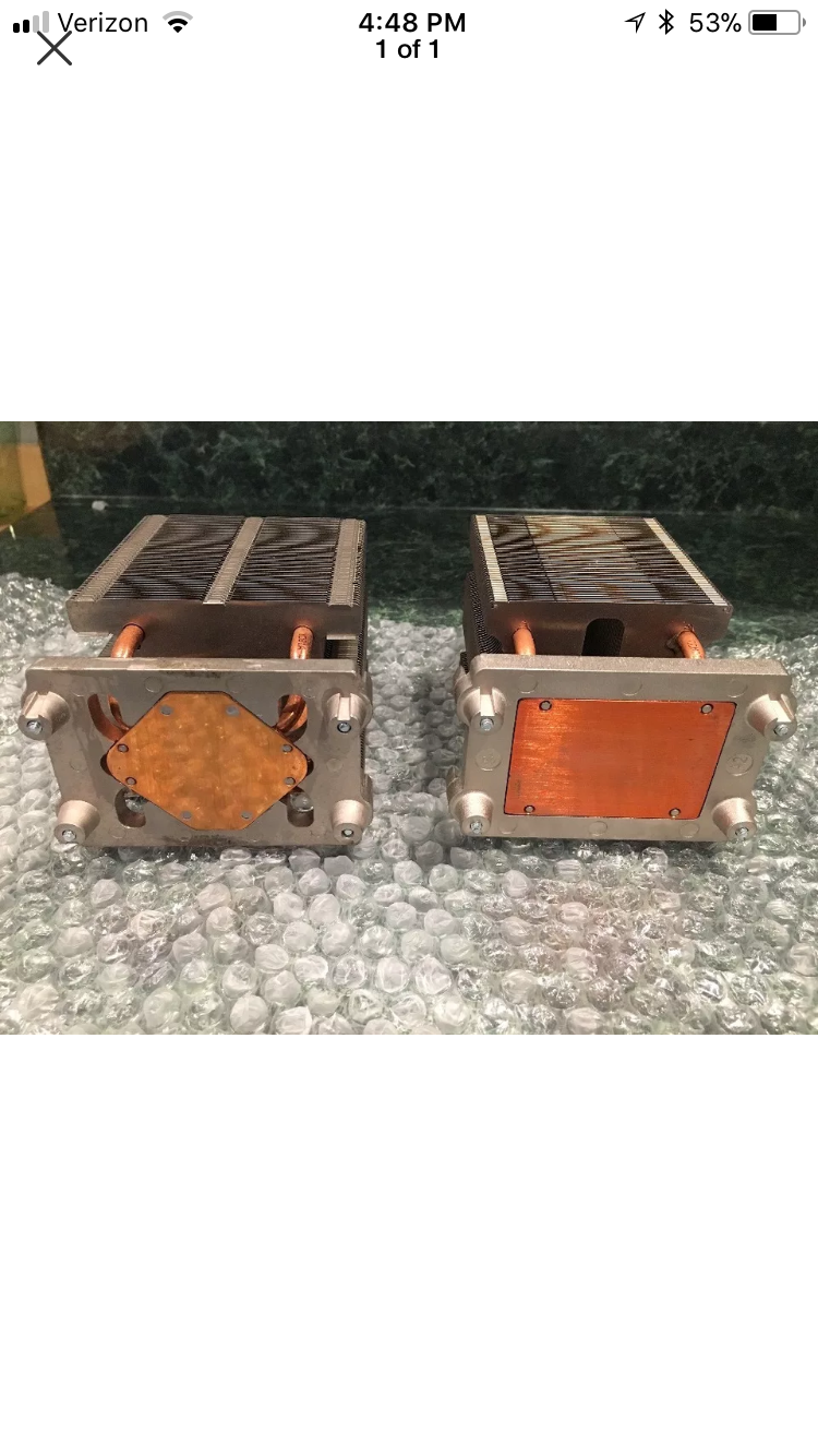

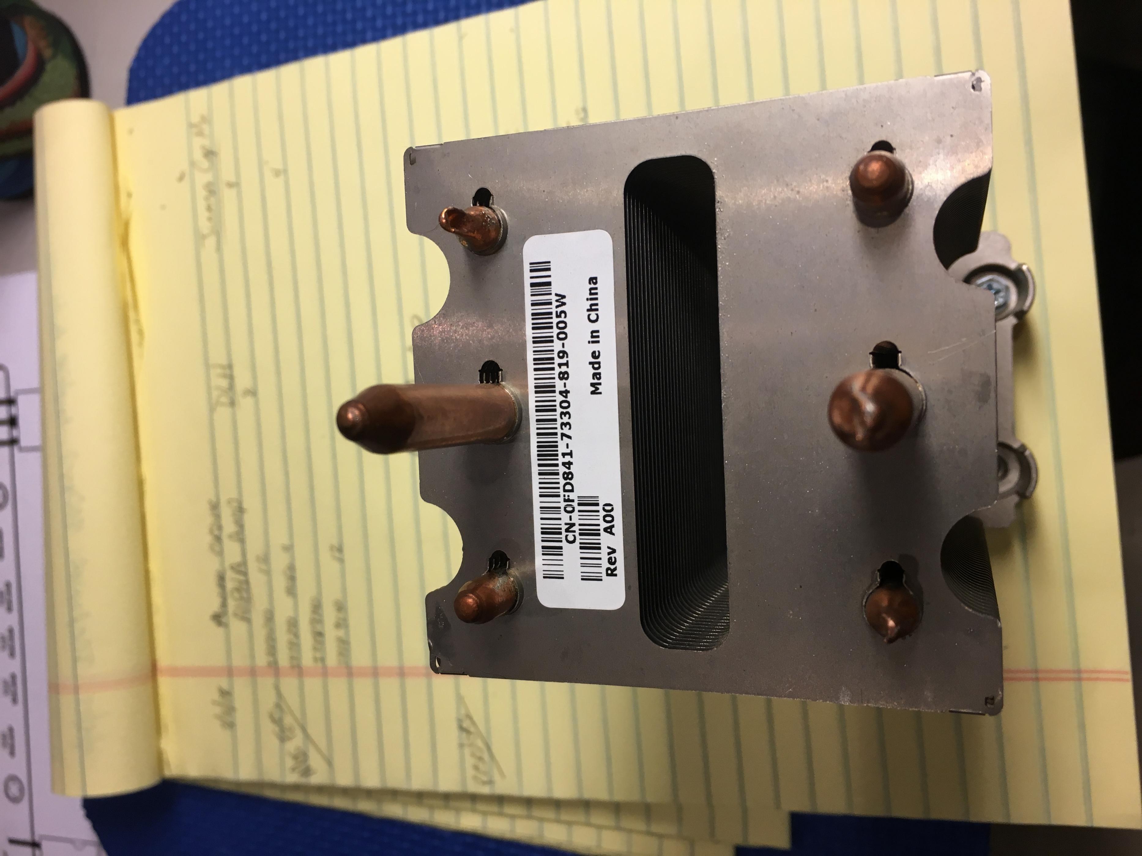

Hi everyone,
I wanted to share what I found out about the Dell FD841 cpu coolers.
There are two versions of the FD841:
One has the full copper rectangle base which is the preferred and carries 73304 in the model number,
the other has a diamond shaped copper base that will not work for the Big Boy ALPHA. The diamond shaped cooler could possibly work with the ALPHA 20w since it uses single transistors.
Hi everyone,
Good catch Vunce!
It looks like all 4 of mine that I ordered are the rectangle base. I'm building a 20w, but nice to know I have options in the future
I purchased a quad from the a seller and two were the "diamond" version
So, I ordered from the same seller you did![]()
All good now![]()
They shipped pretty quick, fair price too.
