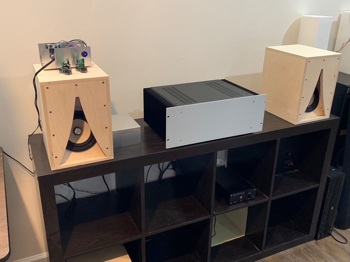

That's my daily driver combo too for the kitchen upstairs. Amazon Dot driving Aksa Lender driving MoFo driving 93dB 0.53x scale Karlsonator speakers with dual 3FE25 drivers. Superb combination.
The Aksa Lender was designed to drive amps that have 0dB (unity or 1x) voltage gain. To get 25wrms out of an amp requires a preamp that can cleanly make 40Vpp without fuss. This is the preamp that does that. It can drive F4, MoFo, or other amps.

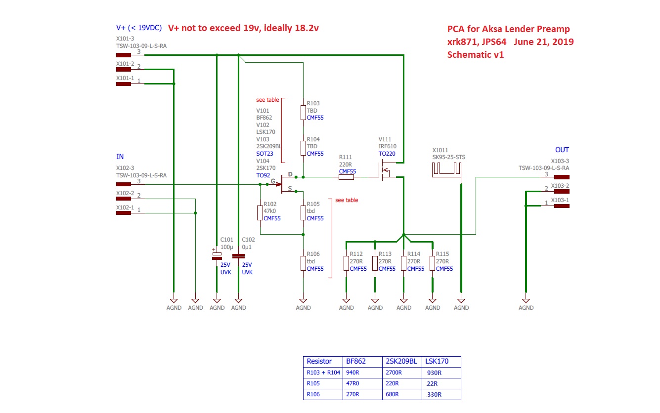

PCA Daughterboard for Aksa Lender
Given how much fun owners of the Yarra preamp are going to be having swapping out their core amplifier daughterboards to try out different topologies (Melbourne, WBA18, and PCA), member Twocents requested that the PCA (Pocket Class A) be made available to owners of the Aksa Lender preamp. Since the PCA is a single rail design and all cap-coupled, it was an easy request and perfect fit for the Aksa Lender motherboard. You can now use big boutique caps and roll caps to your heart's content. Plus, the Aksa Lender motherboard has a terrific low noise power supply built-in. Just make sure not to exceed 19v at V+ pin on the DB itself. I have personnaly found that 18.2v is the sweet spot for the best balance in harmonic profile (for the BF862). For 2SK209 and 2SK170, you will have to experiment on your own. Thanks to JPS64 for his speedy and beautiful layout, we are now offering this as a GB. Please add your name to the interest list below if you want to get this. You can place the pre-order on my Etsy shop.
Schematic:

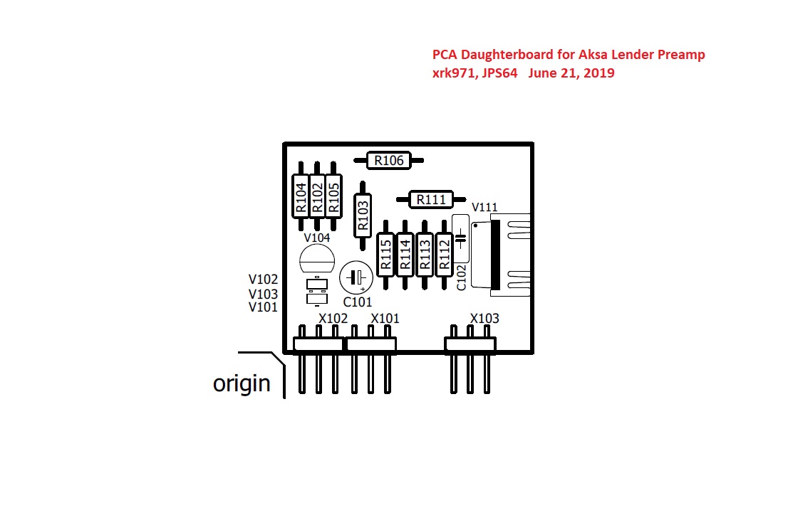

Stuffing Guide:

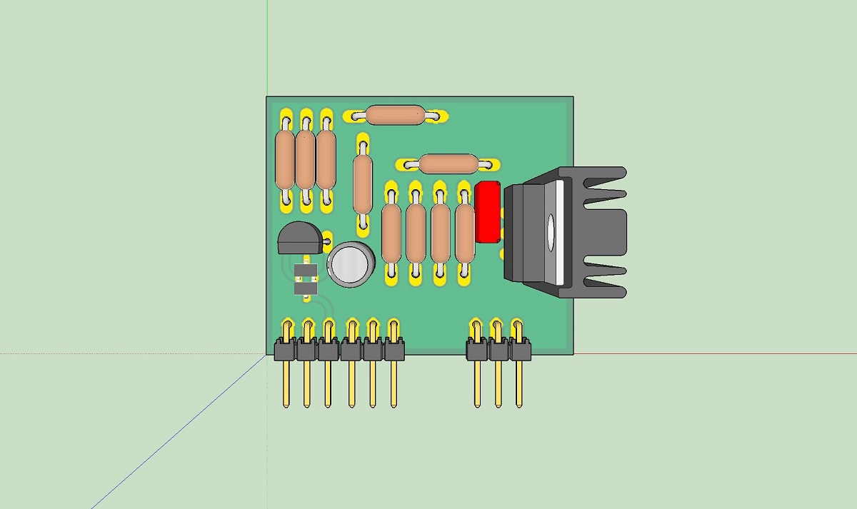

3D render:

Getting a BOM together for the PCA daughter boards, but my goodness 😱 - will this board make music with only 14 components? A very low parts count.You can now use big boutique caps and roll caps to your heart's content.
The big boutique caps referred to here is for the inputs caps on the motherboard right? The PCA daughter boards only has two caps of which one is a bypass - not much room for cap rolling here.

Just ordered a pair. I didn't read through the details too much, do I need to adjust any component values to drive my ~600 Ohm DT-990's?
This amp works surprisingly well with a heavier load, so make the R124/134 10k output resistor closer to say ~100ohms, and the 600ohm DT990's will work fine. If using with 50ohm headphones then leave the 10k alone.

Yes, on MB. If using BF862, makes sure Vcc at the amp is no more than ~19v, so make DC-DC voltage output about 22v to 23v. With 2sk209 or 2sk170, you can go a a few volts higher if desired. Design is at Vcc of 18v though.

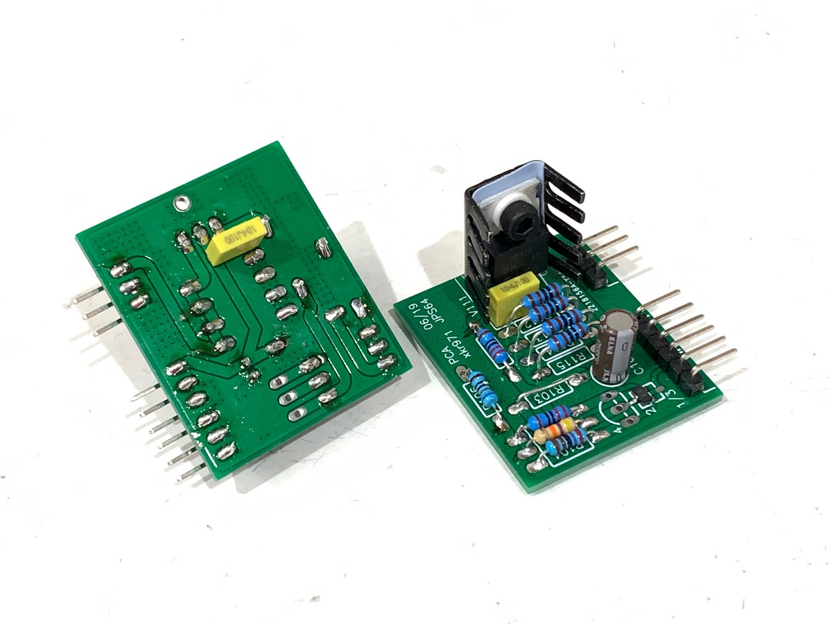

I am working on getting the BOM for the SMD daughter card and I have a question about R113, the 10K carbon. It looks like most builders are putting a through hole resistor in this place. What is the reason behind this change? Which other components on those boards should be through hole?
Is it better to use MELF resistors than the chip 1206/0805 resistors?
Are there any type of wiring diagrams for the connection of the other cards that come with the main board?
The feedback resistor is critical in preventing generation of odd order harmonic distortion my measurements show carbon film is best here. It is TH to allow easy changing of gain setting if, if needed. MELFs generally are better quality.

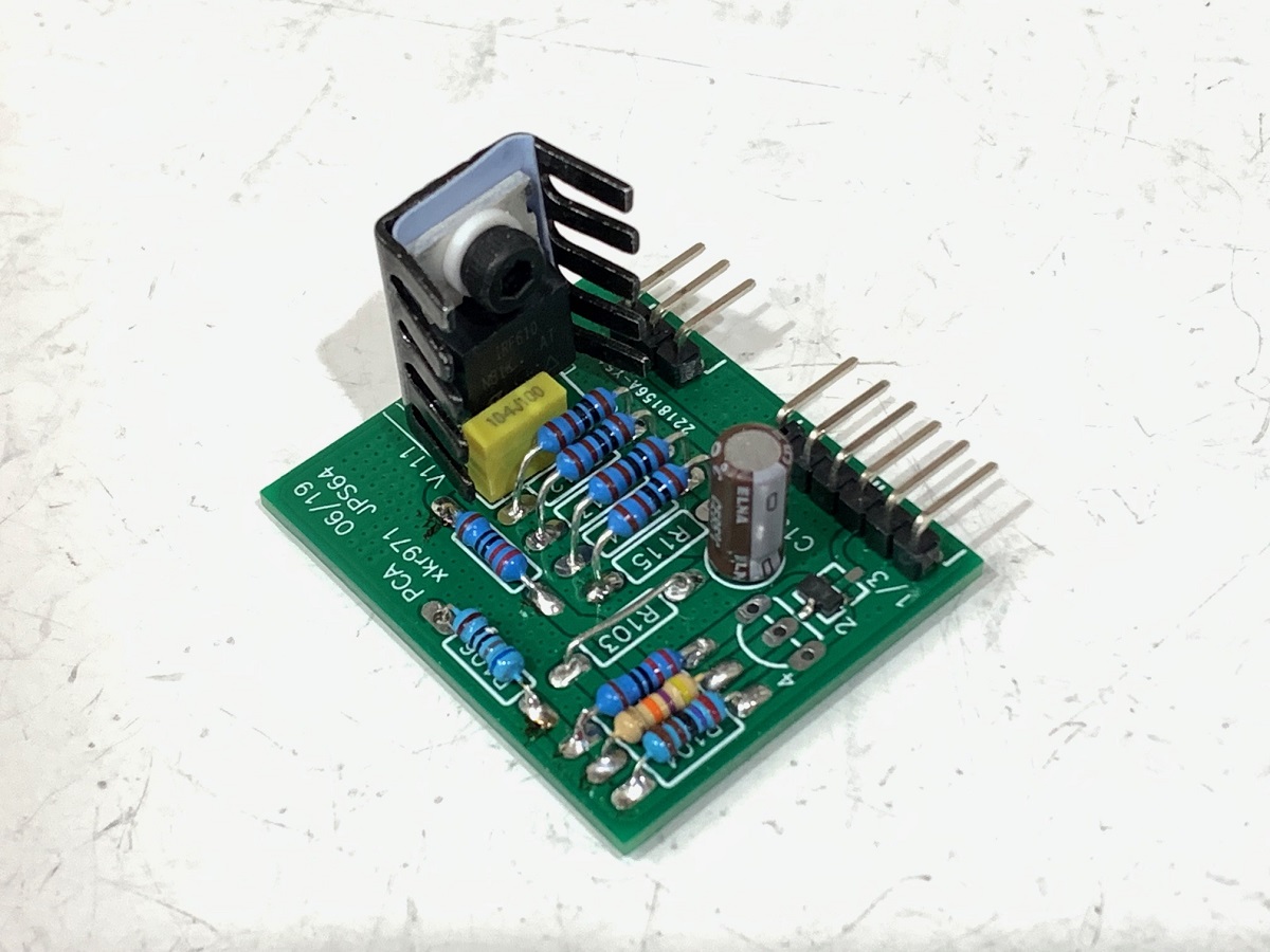

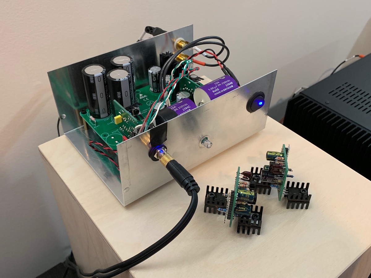

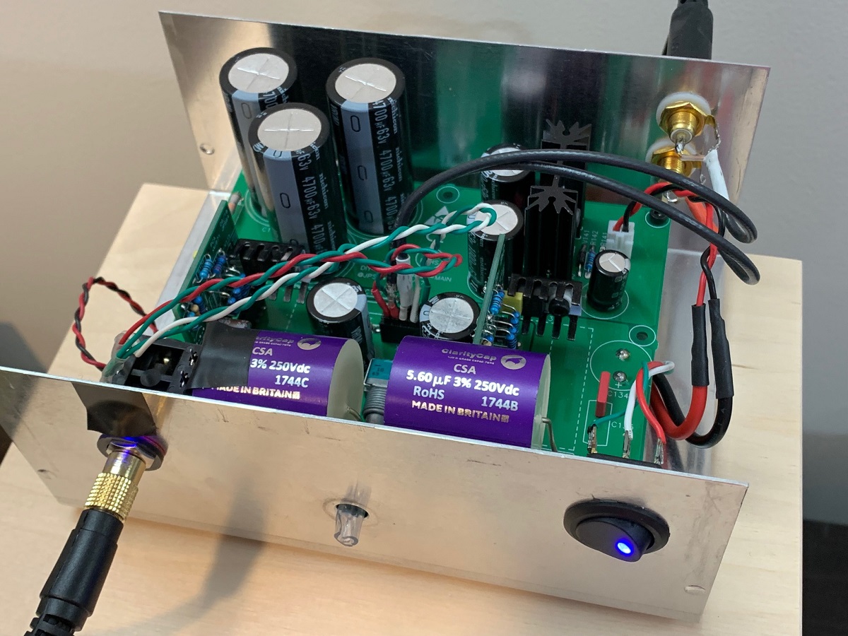

The PCA daughterboard has now been tested and works very well. Listening to it now - driving my M2X (Austin) and W5-2143 XKi speakers.
I am using SK209 JFETs as they are more readily available for new builders trying this out. They are a bit different in terms of operational settings so I am still tweaking to get the best settings. They do allow you to use a higher than 19v Vcc. I am driving them with 24v (at the drain of the MOSFET). The source resistors had to be changed to qnty 4 x 1k axial 0.25w metal thin film. This gives a bias current of 62mA - about perfect for a preamp or HPA driving cans higher than 100ohms. The heat dissipation is reasonable - not too hot at all. The 2k7 resistor R3+R4 needs a little adjustment because the voltage at the Source pin is 15.5v, about 3.5v too high - you want it about 1/2vcc. It still plays music but the headroom is reduced. For normal preamp duties, it is not an issue.
Here are the build photos. The 100nF film cap is could be mounted on the backside to give more breathing room for the heatsink and source resistors. I am using a small stamped serrated fin heatsink and that seems fine.
This has got to be the easiste project I have ever built - it took almost no time at all. Maybe 30 minutes and I have a working and nice sounding preamp!
