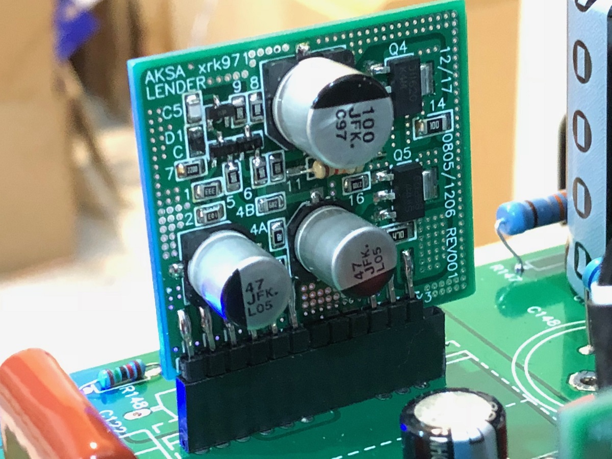

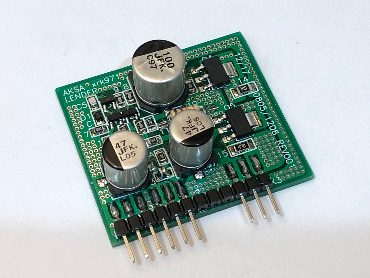

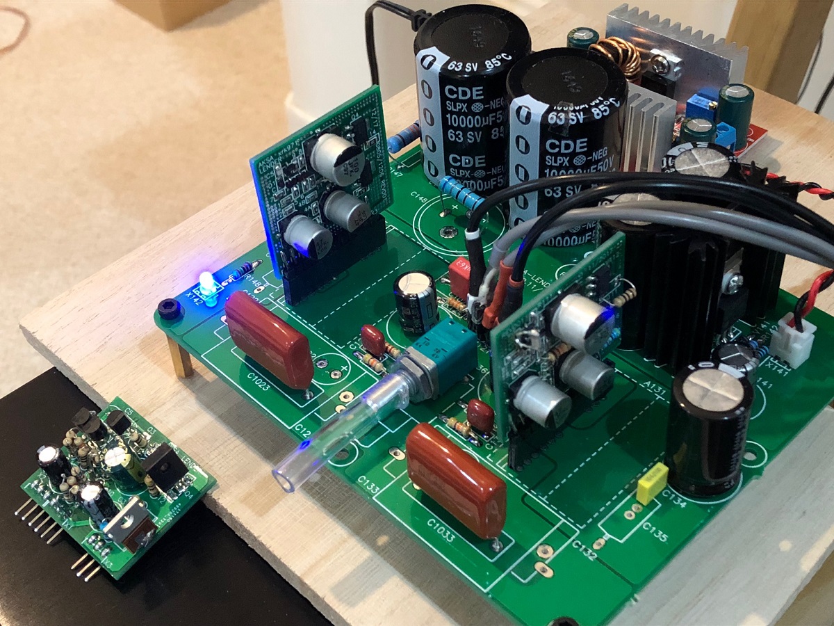

The new SMT 0805/1206 daughterboard has been verified to work. This build is using 10R degeneration resistors (R5/R6) and 12k feedback (carbon film) resistor. I am using two 4k7 in series to get 9.4k (specified 9.1k on schematic).
Closeup before installing on MB (I used solder paste from a hypodermic needle, heated with a soldering iron tip):
Installed on MB and playing music (it's the one on the left):
Closeup of the new tested SMT daughterboard:

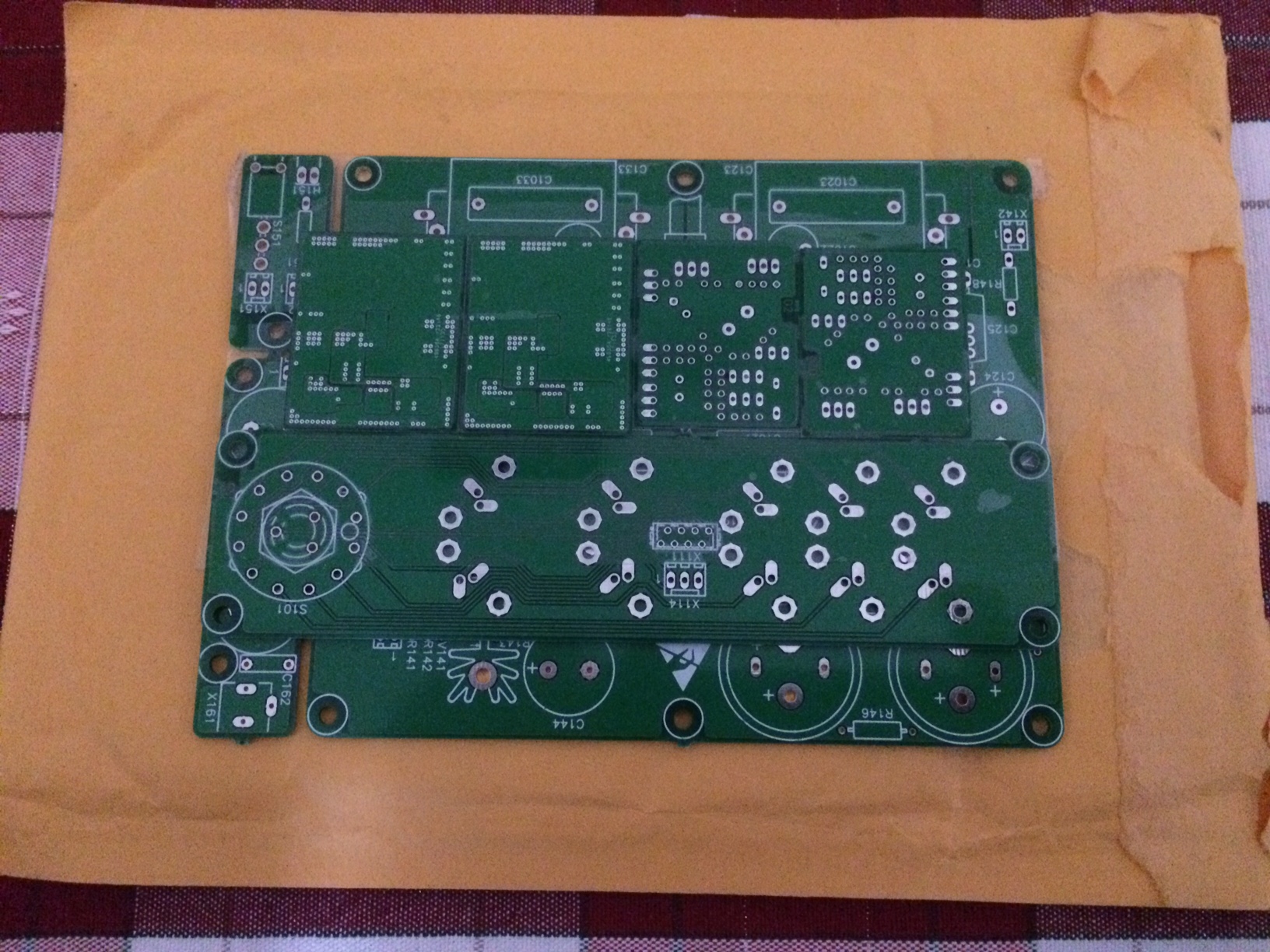

Thanks!
Received board today, thanks X.
