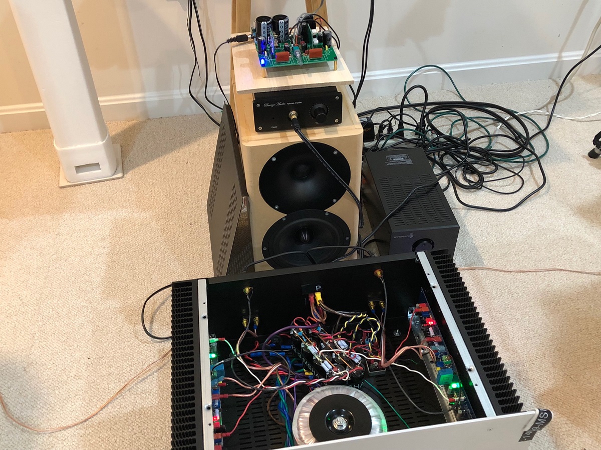

Using on main system now
I connected the Aksa Lender preamp to my new Pass Aleph J amp that I just finished building. The Aleph J is driving my ScanSpeak 10F/8424 & Dayton RS225-8 FAST speakers (fitted with transient perfect XO). The combination sounds amazingly dynamic and lifelike. Super clarity - so yes, the choice of preamp makes a difference with some power amplifiers. I will listen long term now. Initial impressions from the Eric Clapton "Unplugged" CD is very very good. That recording has a very high dynamic range and is ambient recorded with minimal post-production I think. Anyhow, I am quite certain that you will all be very pleased and blown away by the sound quality of the preamp.
