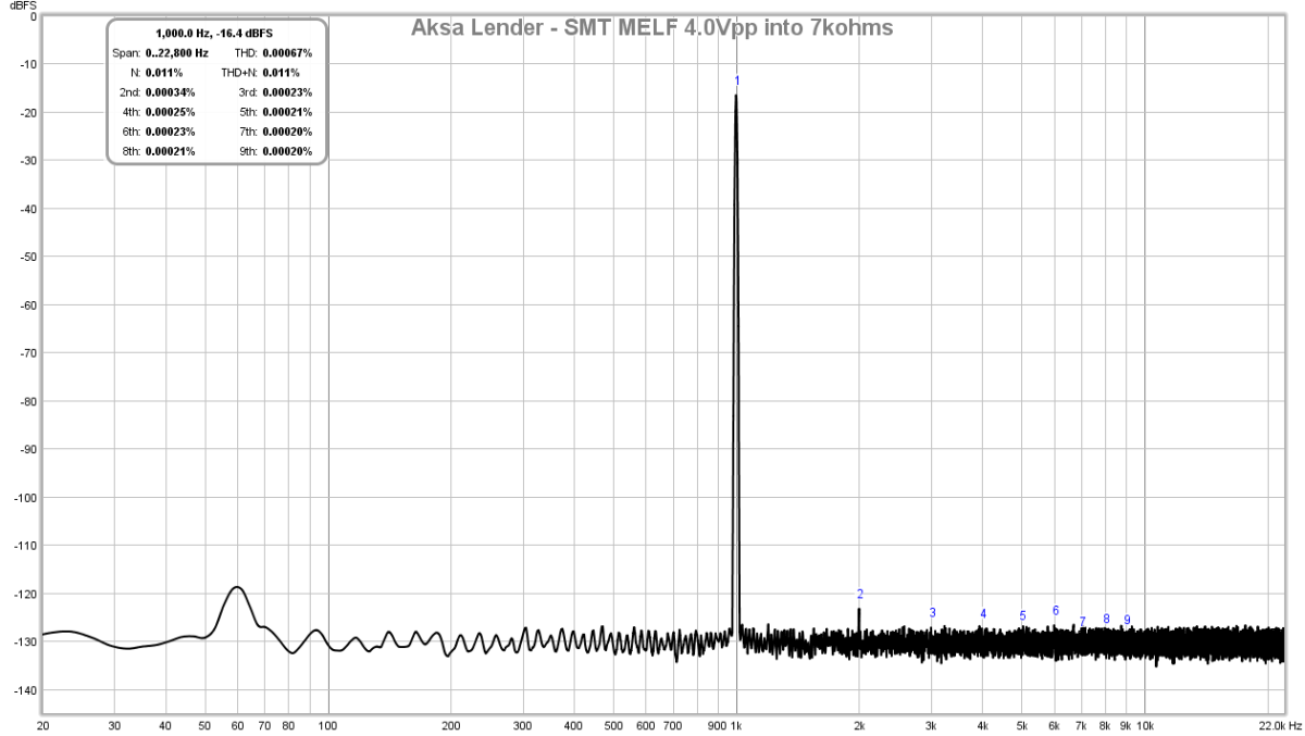

4Vpp into 7kohms (45v Vcc):

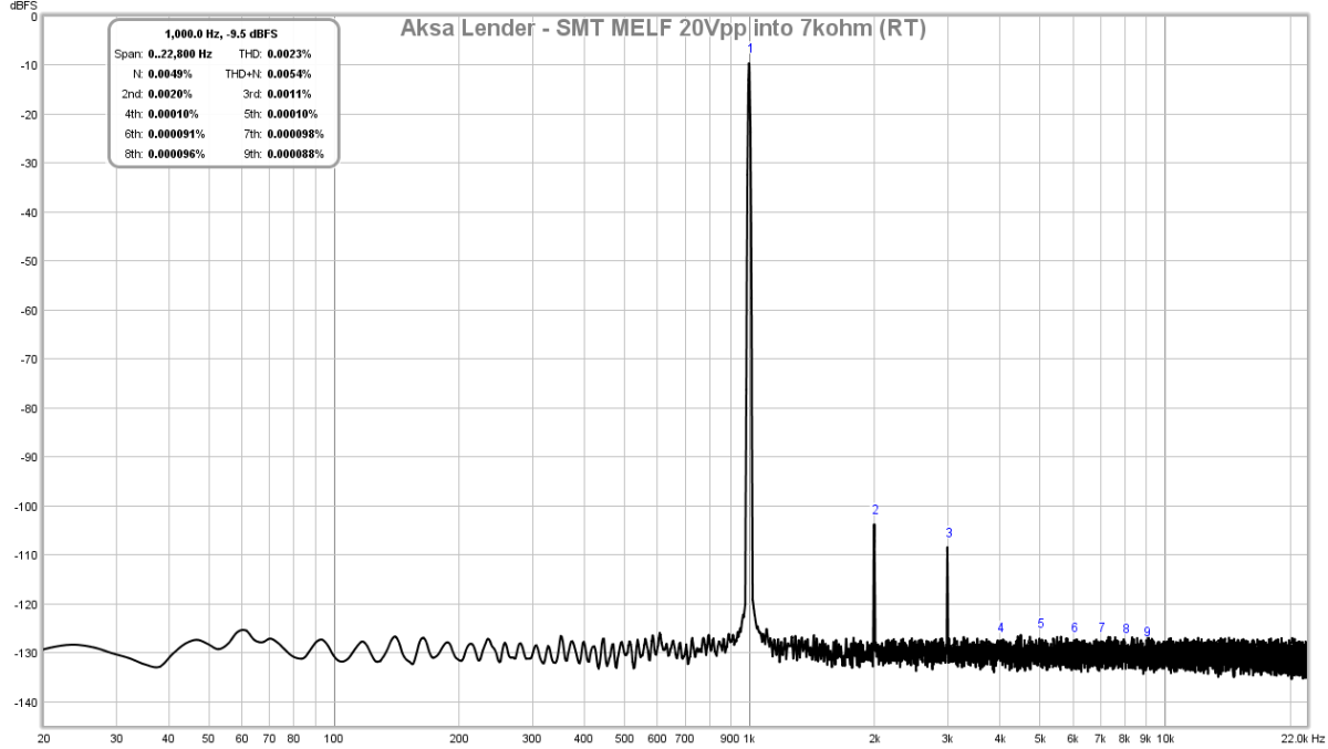

20Vpp into 7kohms (45v Vcc):

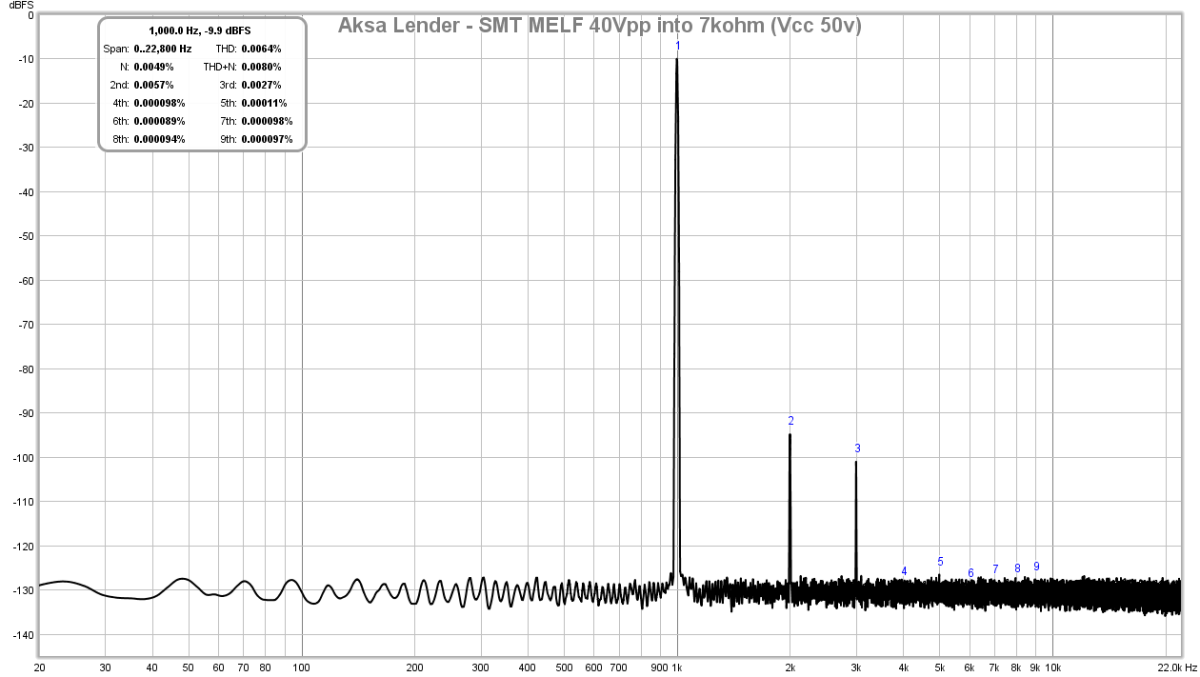

Now, for the thread title namesake, 40Vpp into 7kohms (50v Vcc):

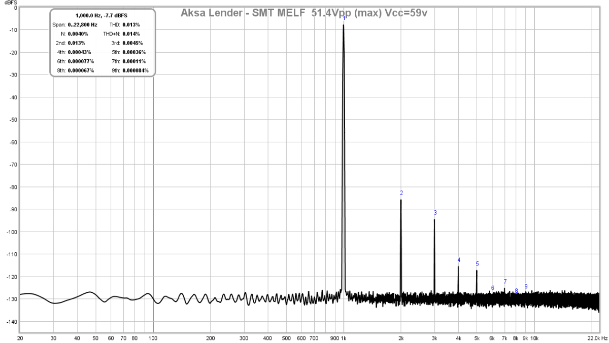

And if one raises Vcc to 59v, just before clipping this preamp can drive 51Vpp into 7kohms with 0.013% THD:
That's good for about 41Wrms into 8ohms if the power amp can handle it.
With Vcc at 59v, the SMT board is a bit hotter - but not excessive. I will let it burn in overnight to see if it can take it long term.

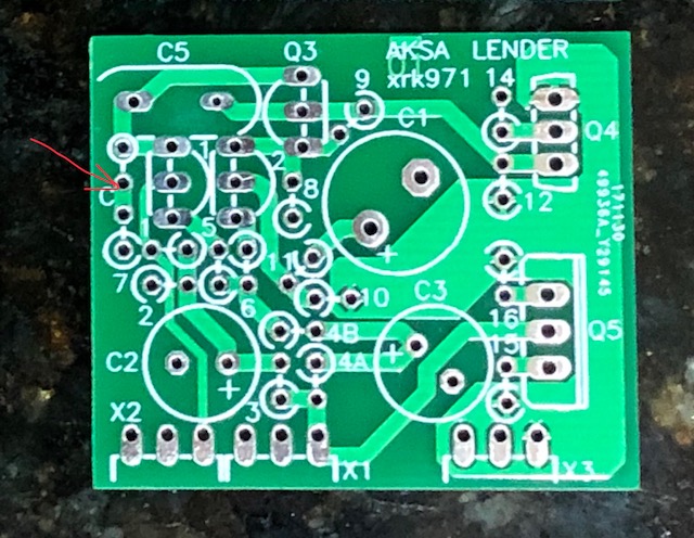

I’ve started to assemble the boards but I am unsure of the diode polarity on the TH daughter boards?
I assume you have the TH boards. The cathode (stripe or bar) end goes into the hole labeled with the “C”.
