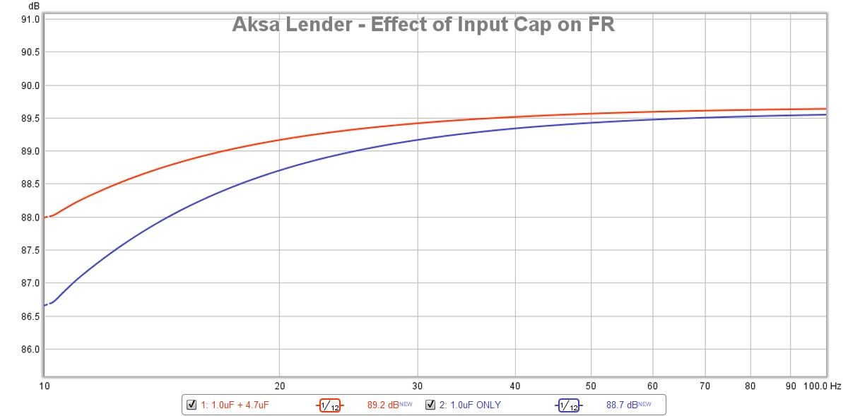

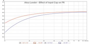

Impact of Input Cap on Bass Extension
Here is a quick test with and without the 4.7uF 50v Wima MKS cap. The remaining ChiFi 1.0uF cap seems to have a -0.5dB reduction at 20Hz and -1.3dB difference at 10Hz. So it would seem that this is probably not going to be audible from a bass extension standpoint, but from a resolution and transparency standpoint, it may be better to have just one cap.
attachment.php
So I will have a listen to the single 1uF cap and see how it sounds. Those 4.7uF Wima's are not cheap so this is welcome news.

Thanks for running that test X. Not to mention it could open up more possibilities for less expensive 1uf caps that fit a little better on the board. I'm thinking about CDE 940C 600v from Mouser. Only $5.05 per cap for great sound.
You are welcome. It was a good learning experience for me to actually verify that the bass falloff really follows the equations that we are told that they should follow. It also shows that the output cap choices I have apparently seem to be doing a good job on the bass extension as well.
For the record, I have the following combo on the output caps:
1. Nichicon VR(M) 1000uF 63v
2. Elna Silmic II 220uF 50v
3. Wima 1uF 250v MKS 4 (p/n MKS4F041004F00KSSD)
So about 1220uF should be good for F3 of 2.6Hz, so very similar to the 1uF input cap, so they are well matched.

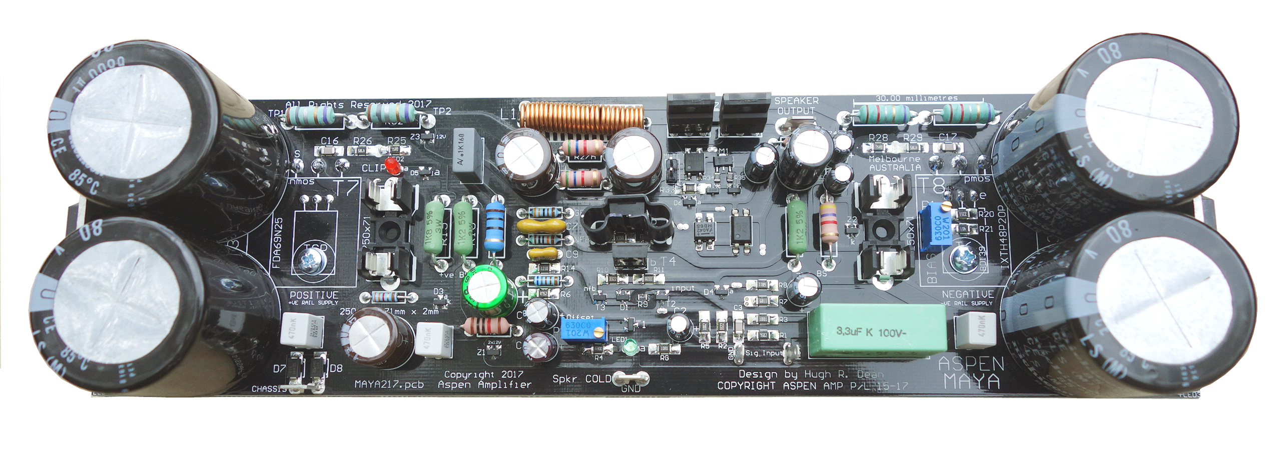

Hi Ammel,
Easy! I design the pcb on software, which I can blow up very large on a 22" monitor, and then hand it all to my assembler, a factory business with all the gear (including robot pick and place) for building very nice pcbs.
So I design with PC magnification, and then machines and youngsters to put it all for me!! Heck, I couldn't build themselves...... but as it happens, power amps need some high dissipation resistors, so only a few of the small ones are 1206 and 0805.
Here is one of my Maya 200s. You can see that not all are smds, but there are quite a few diodes/optos/transistors which are very tiny. Nicely put together for my assembler, and they always work perfectly every time.
I'm 66, BTW, but I have pretty good eyes, though long sighted. Can't read a newspaper headline without glasses. I have not yet moved to eyeglasses, but I do have a magnifying glass on the bench. I don't do much assembly these days, it's too onerous after a bunch of health issues.
HD

I don't think the hpf f3 of stages should match ?
You don’t think they need to match or you don’t think that with the values I have for caps, that they could match? As the output capacitance and headphone load impedance determines the output highpass frequency, one doesn’t want the input highpass to be the rate limiting one.

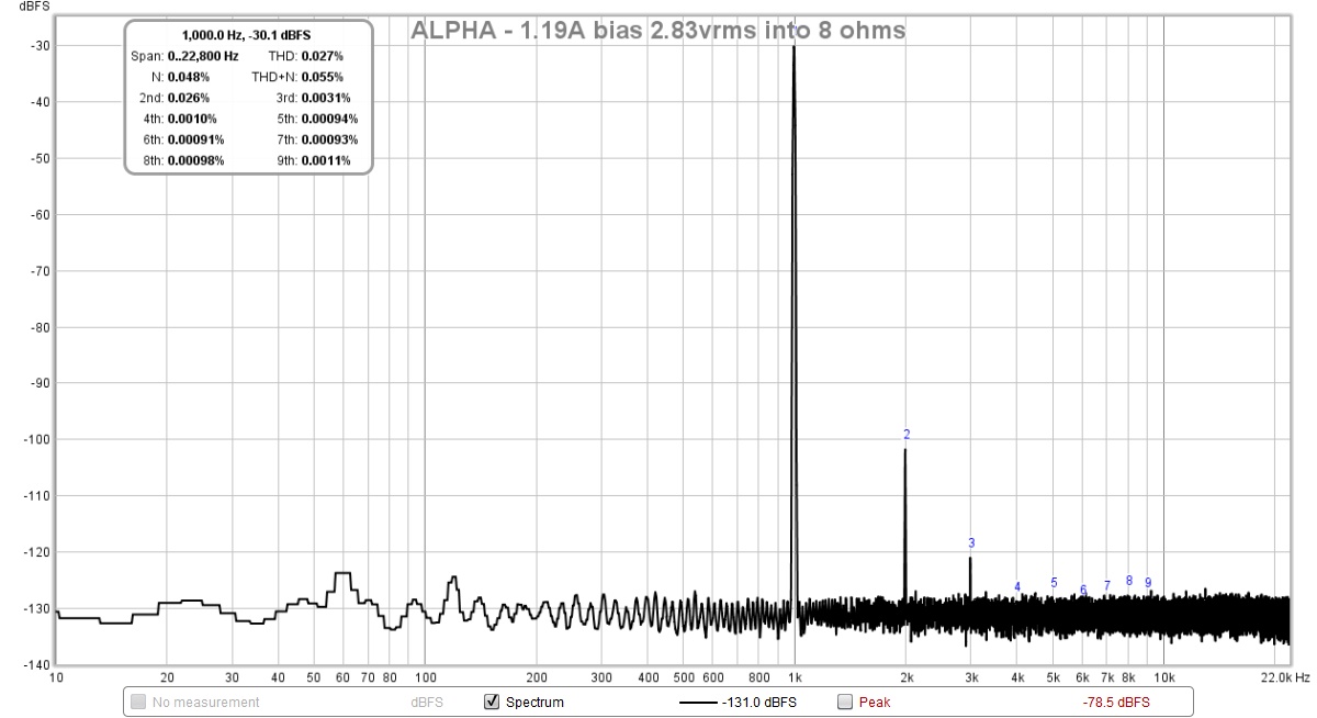

I forgot to mention to folks following this thread, in case you haven't seen it yet, there is a nice Class A amp based on this front end that Hugh came up with called the ALPHA (Aksa Lender P-mos Hybrid Aleph). The thread is here:
Aksa Lender P-mos Hybrid Aleph (ALPHA) Amplifier

FFT for 2.83vrms into 8ohms with 1.2amps bias:
659379d1517198709-aksa-lender-mos-hybrid-aleph-alpha-amplifier-alpha-1-19amp-2-83vrms-8ohms-fft-jpg
