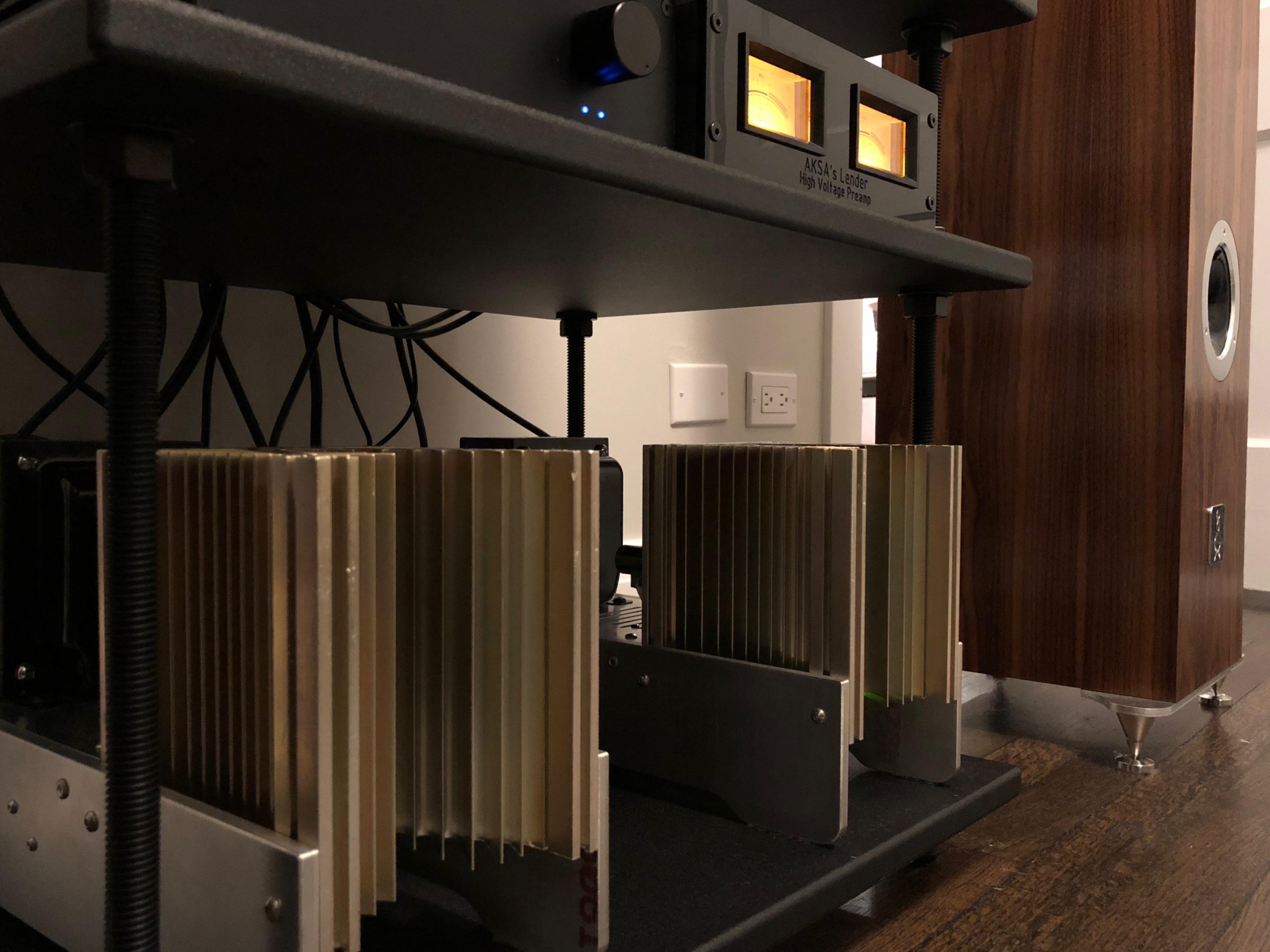

Please see one the finest Aksa Lender Preamp builds by Gtose in GB thread:
https://www.diyaudio.com/forums/gro...der-preamp-40vpp-ouput-gb-41.html#post5576044
Powering Super MoFo in his main system:

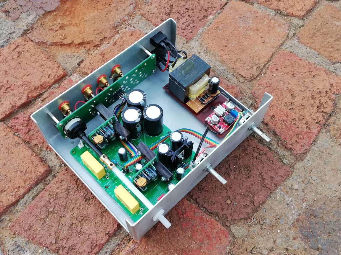

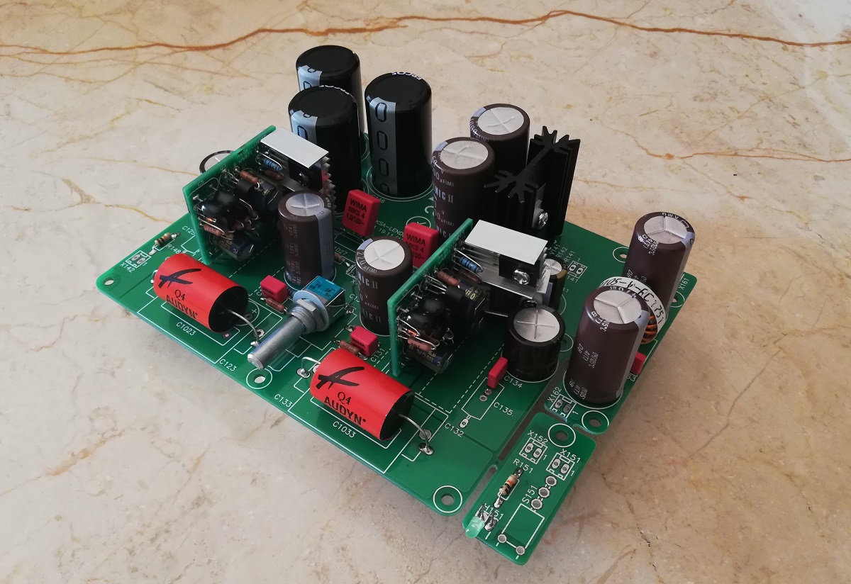

Got mine working today. Powered it up and it worked first time. :)
It still needs some work on the chassis, but I listened for a few hours and apart from more volume due to the gain (about 15dB. R11 = 2K2), I can hear an improvement in the soundstage and imaging. I've been using a B1 buffer up till now and really got used to how the ACA and B1 sounds on the 0.53x Karlsonators with dual 3FE25-16's. The AKSA Lender's sound is different - in a good way.
Thanks to Hugh, X and JP for making this design available. You guys rock.

Beautiful work, Skylar! That’s a nice layout you have there and I see you even made the input selector panel. Glad it worked the first time. If the ACA is about 14dB gain, and the Aksa Lender Preamp is 15dB, you have 29dB of total gain which is about the usual gain for most amps designed to be driven by line level sources. If you like less gain just increase the ground shunt resistor R11 to 3k3 maybe?
Thanks guys. I'm please with how this project turned out. The amount of gain seems right, X.
No comments about the two separate pots? :D
It's a feature that got carried over from the B1 because I like to have balance control.
@zman1

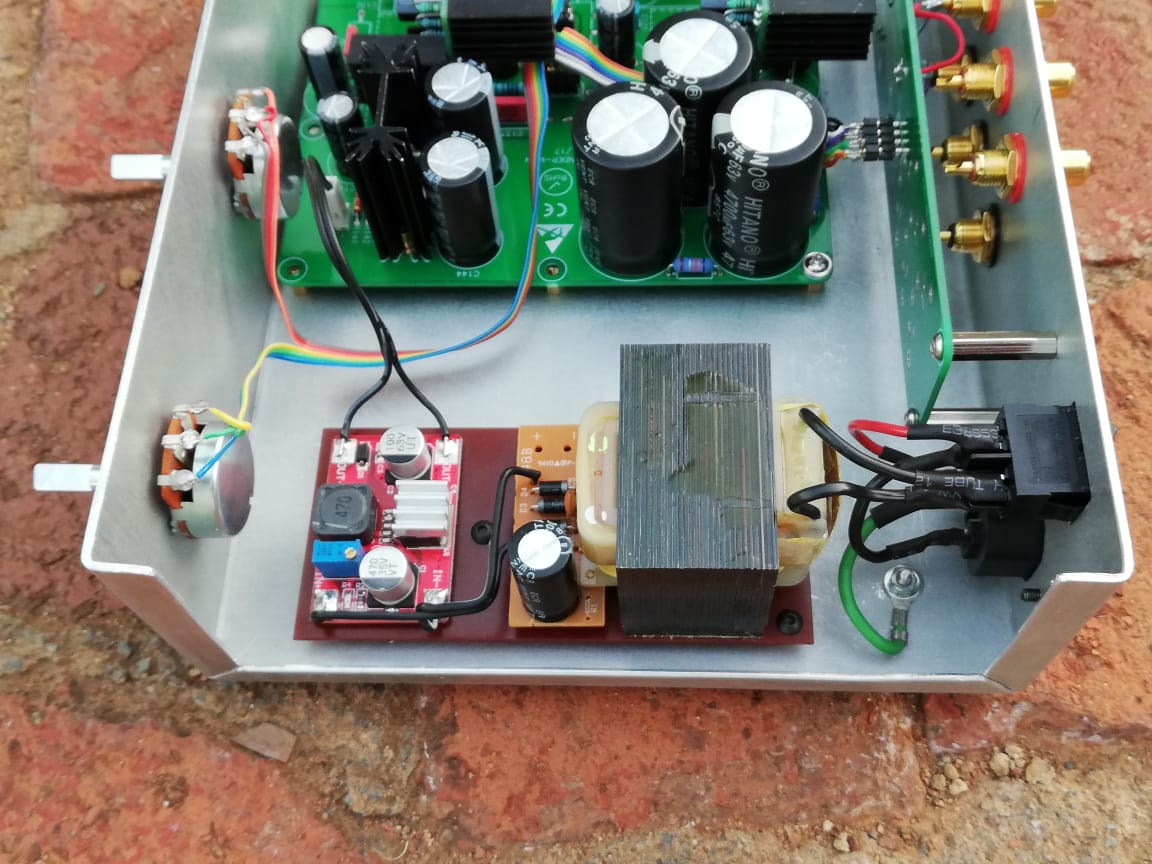

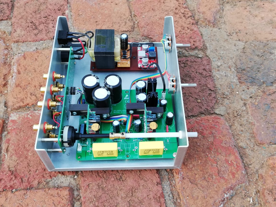

It's a custom made alu box that I've had for many years from an aborted non-audio project. The box was much too high, so I had to chop the top 60% off and then I had to build a bending brake to make a new lid. The new size is 225 x 175 x 71 high with the lid on.
I had two of these boxes and used the other for the B1 one last year.
Skylar,
One of the best preamps I have ever seen, beautifully, almost factory assembly.
Preamps are difficult because there are lots of inputs, controls, and metal holes. Lots of wire too, and tricky to keep them quiet.
The EI transformer is outstanding in this role because at low power the magnetic field is well controlled, important for a preamp.
Congratulations!!
Hugh
Thanks Hugh. It really means a lot to me, coming from Mr AKSA himself.
I also need to thank all the diyAudio members who contribute to this and the GB thread, clarifying preamp building mysteries. As a relatively new audio hobbyist, I still have a lot of questions.
I'm really enjoying this preamp. Never expected it to be this good! :D
