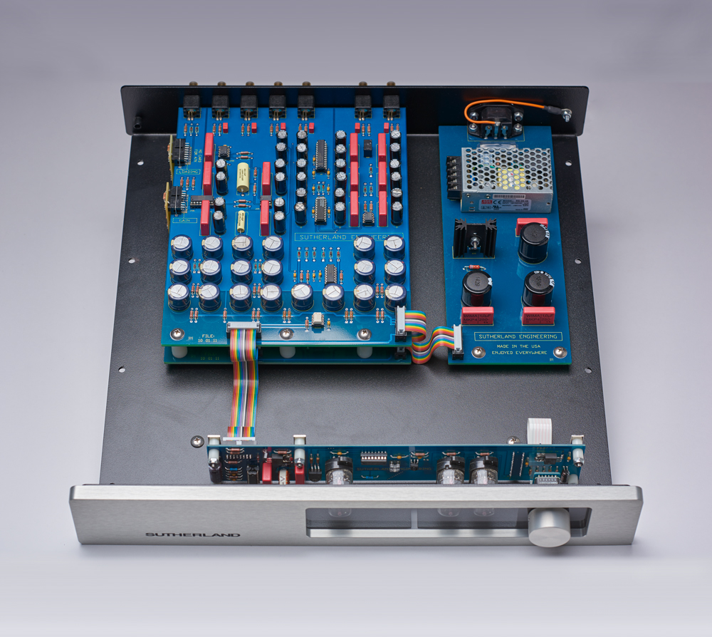

I'm considering to rather us an internal SMPS, like in the Sutherland N1 preamp pictured below. My question is: (for sizing the SMPS) What would the current draw be on the AKSA Lender (15dB version)? ...and if I measure it, would the current draw vary with sound volume? i.e. should I measure at high level?
Does that look like a Cap Mx on the N1 Sutherland PSU board?

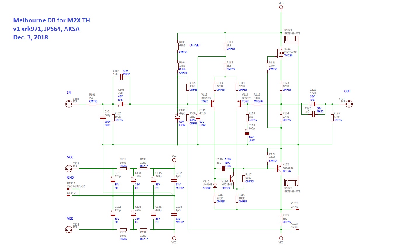

The Aksa Lender Preamp runs at about 15mA to 17mA bias current in stock form. So dissipation across the DN2540 and 2SA1837 equals 48v x 0.017A x 2 ch = 1.6w. The cap Mx is 4v x 0.017A x 2 = 0.14w. The DC-DC step up is about 90% efficient and assuming it uses a MOSFET with 4v drop, again another 0.14w. So about 2w total. Your little transformer may be adding a couple more watts. Maybe 4w total which can get warm if not heatsink or vented. Some air slots at the top and bottom should help cooking it off, or try using an external wall wart Class 2 transformer. I don’t recommend bypassing the cap multiplier. Besides filtering ripple it gives a slow start ramp up to prevent thump. Meanwells may work - that unit looks like it might be noisy. Also the DC-DC you have is noisier than the white aluminum ones I recommended.
What value source resistor are you using after the DN2540? If you are using lower than 47ohm there your heat output will be significantly higher. Remember that for headphone use, the current is higher but Vcc dropped to 24v. 48v at 75mA would be a lot of heat (7w a pair from DBs alone).

R11 = 2K2 for 15dB gain, as per your advice.

R15 is the 'standard' 47R5 and the heatsinks don't get very hot. Although it's running at 48V, I can keep my finger on the sinks indefinitely. It's the PSU transformer that makes the most heat.

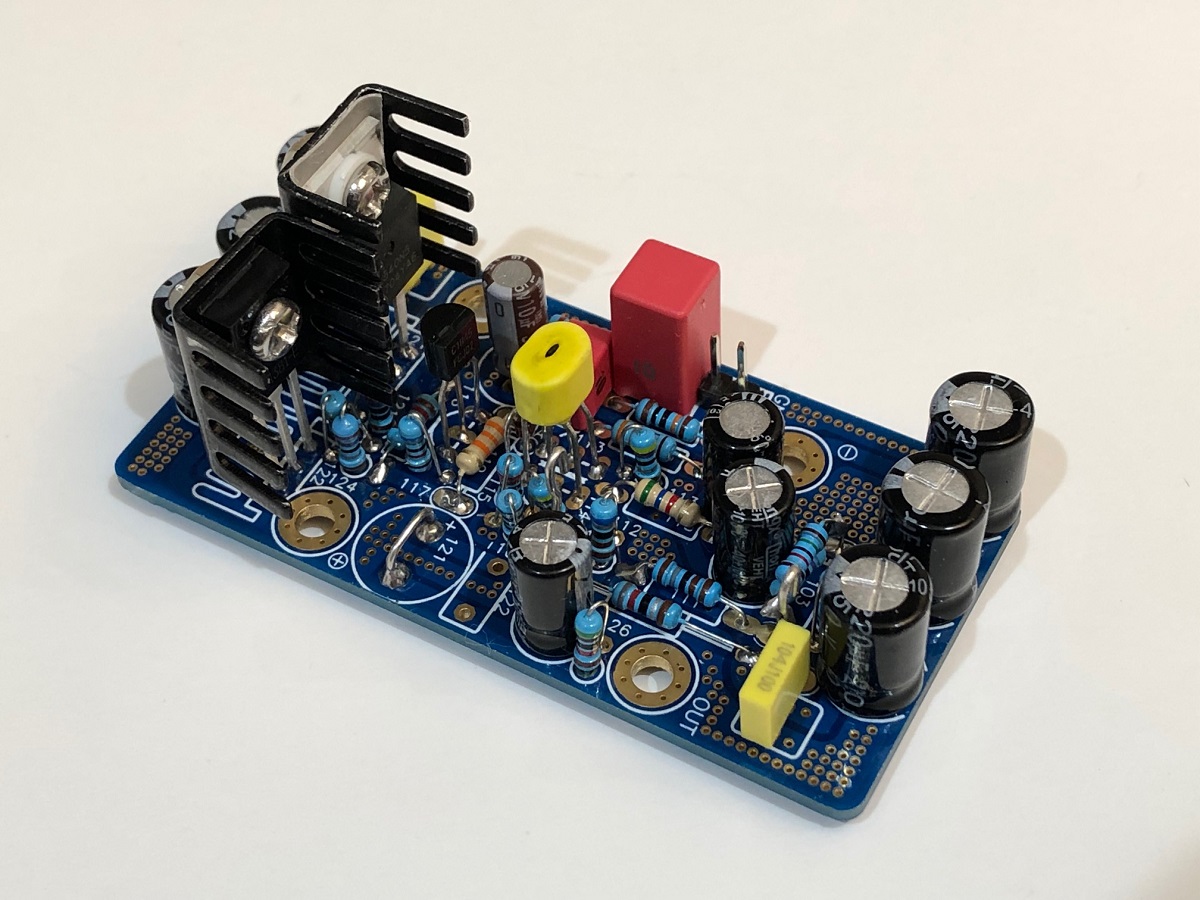

Received my boards thanks XRK, they look great but bigger than anticipated (should have measured them I guess, rather than 'yeah that should fit ok'
My plan is to run this as a front end to an ACA or possibly MoFo, do you see any issue in pulling 24v from the power amp and just mounting the DC-DC step up in the pre amp case (I don't see a problem). My only other thought would be any suggestion for a nice connector for the DC (I cannot really think beyond the 2.5mm DC barrel plugs used for 24v in on the ACA). I'm really looking to avoid excessive external PSUs.

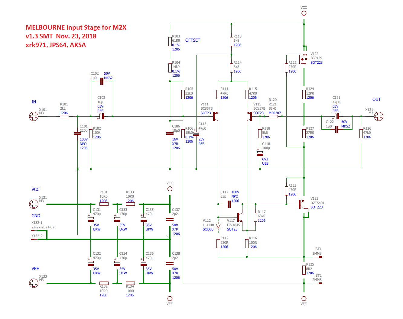

For use with the ACA the only recommended change is to use 2.2k for r11 correct?

Correct, 2k2 for R11 gives about 15dB gain. That's what I'm using with my ACA.
