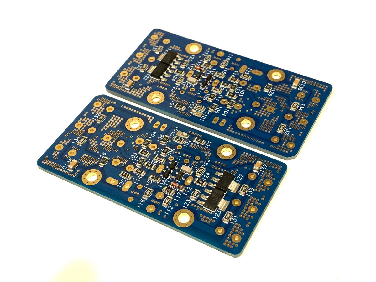

New thread on the Melbourne Pre-Amp (and headphone amp):
https://www.diyaudio.com/forums/hea...-class-headphone-amp-pre-amp.html#post5626218

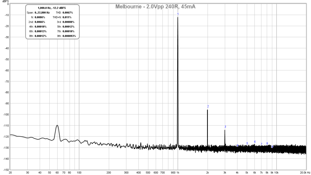

Here is 4Vpp into 240ohm load:

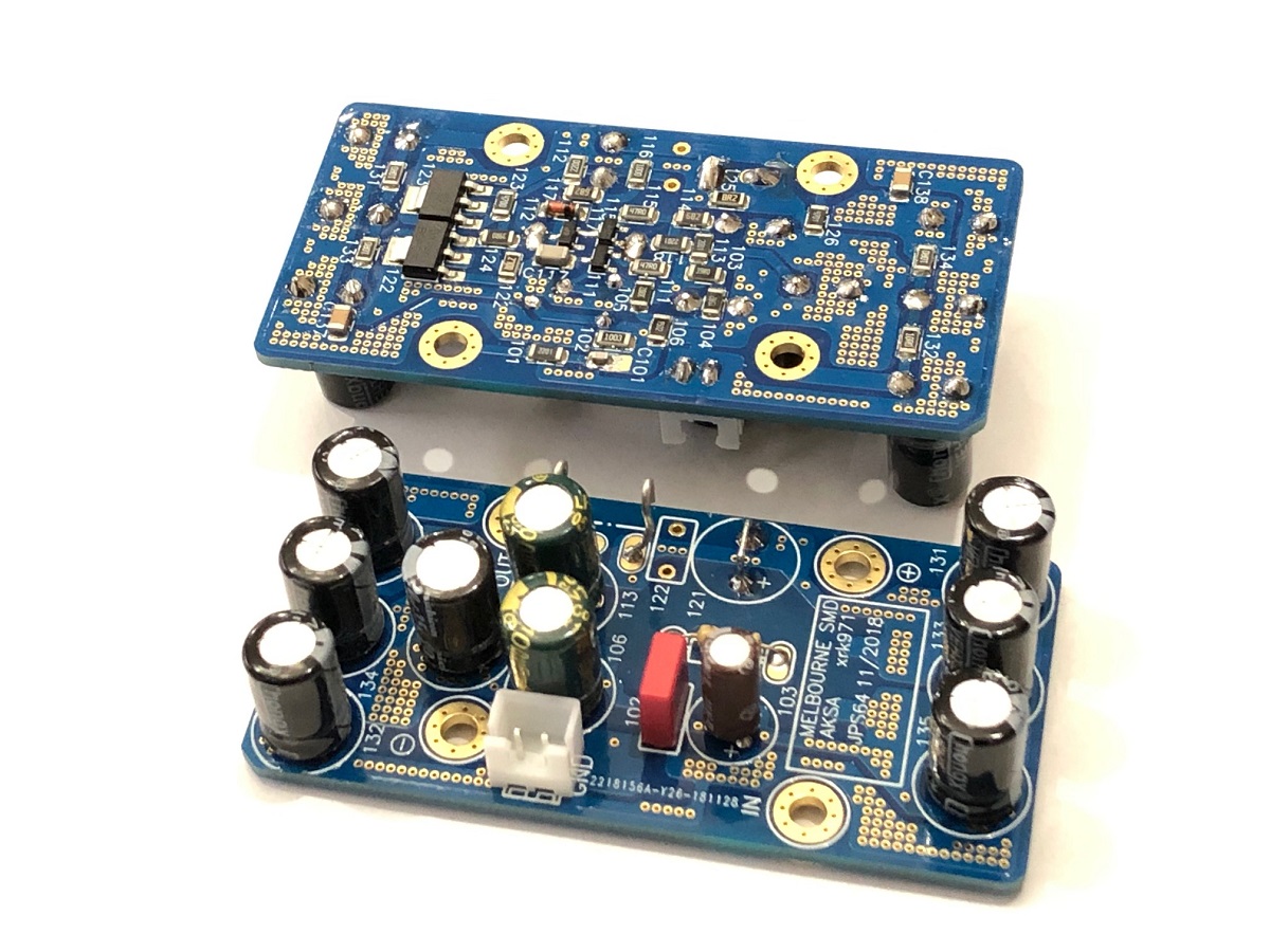

The modular self-contained design of the Melbourne may be easier for some folks to build as less intimidating than the whole main board on the original Aksa Lender. You can use the PSU of your choice, but a cap multiplier smoothed linear is not a bad idea.

As long as combined load of both amps in parallel is not lower than 2k you will be fine. If you need to drive lower impedance, we can boost bias current by changing 47R resistor under the CCS to say 33R or 27R. Provide more heatsinking of course.
If you notice the Melbourne can drive 520R no problem. But that’s 45mA bias current.

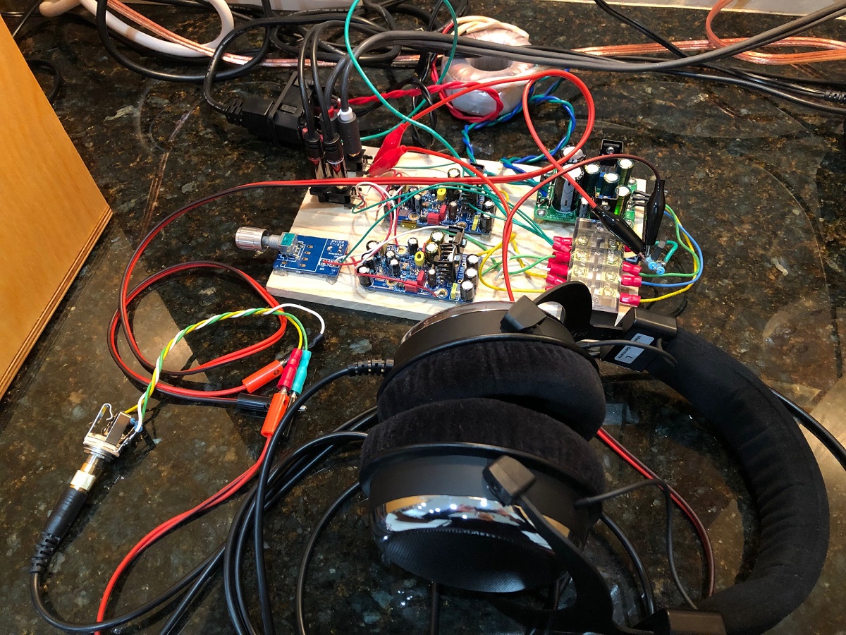

Can the Lender be setup as both a preamp and headphone amp? My headphones are the Meze 99 classics 32 ohm and really easy to drive.
Yes, please see this thread:
Aksa Lender HPA

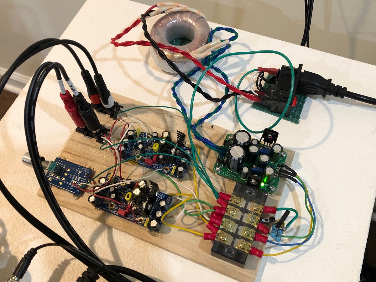

Or even several posts back in this thread I show how I am using the Melbourne to drive headphones here:
The Melbourne Class A Headphone Amp and Pre-amp
Aksa Lender HPA

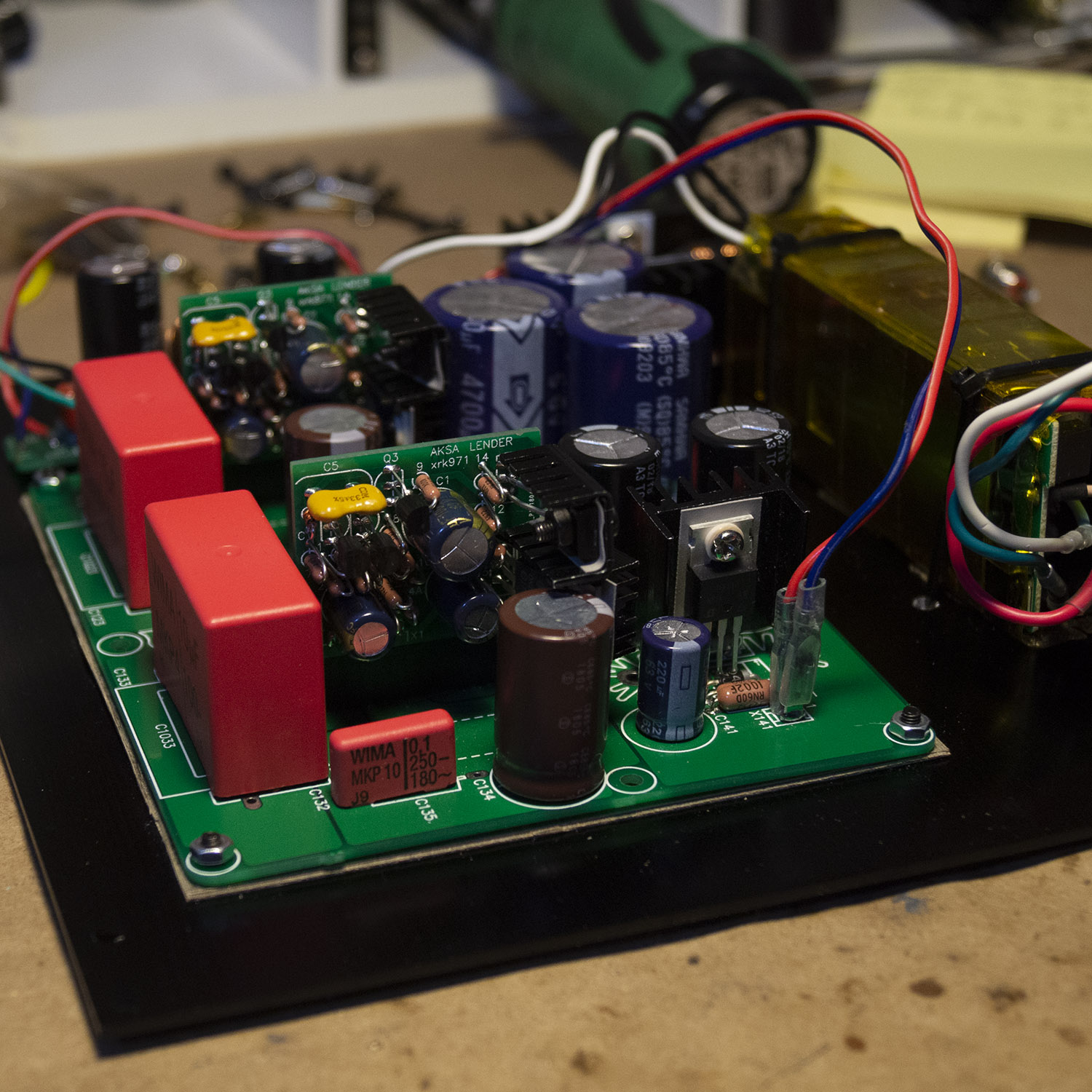

Right, I'm just starting my build here and this is my basic layout:
DSC_0363 by billbackhouse, on Flickr
So the base of the enclosure is 3mm aluminium, the main PCB will be raised on 5mm spacers to clear, the little boost board will be mounted directly on the base, the volume control will sit approximately where it is on a folded sheet metal mount, and I intend to build a 3 way relay based source switch in the remaining void (left of the vol pot). The switch will feed the pot directly, this will then feed the main PCB and the volume control will just extend on a 6mm shaft to the front of the enclosure.
The front will be made from the 10mm aluminium plate currently at the back of the chassis, the rear of the chassis will probably be 6mm aluminium or possibly delrin (would a plastic rear panel be sensible or not?). I will drop a small form arduino in there to drive the volujme and source switching from my samsung telly remote.
Power will be 24vDC daisychained from the Pass ACA this is driving. Do i need the filter circuit supplied, or can I run the boost output at about 47v directly into the main PCB on x141 with no ill effects?
Any suggestions for a nice miniature(ish) relay for source switching I don't mind SMT or though hole.
Any thoughts or suggestions for the build?
