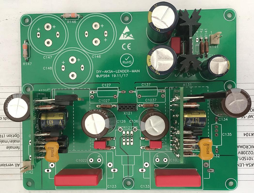

I just hooked up my Aksa Lender (mini MELF SMT version) to my MoFo amp and 0.53x Karlsonators with dual 3FE25 drivers. Great combo - the soundstage and imaging are superb. Something neat about a single MOSFET SE Class A amp with no global feedback. I have not listened to the Aksa Lender and MoFo combo in a while. It’s very nice if you can live with 11Wrms.
You need to use a CLC filter between your ACA PSU and the DC step up. Else you may get some noise back to your ACA amp. Better to use a separate 12v 1000mA or 24v 500mA Class 2 transformer wall wart commonly seen on routers, modems etc.
I really want to minimise external junk, so I might look at one of the smaller meanwell SMPSs, they do 48v output versions and the 15w would tuck in there nicely (the 25w being a squeeze), would just the supplied CLC filter be fine between the SMPS and main board.
...would just the supplied CLC filter be fine between the SMPS and main board.

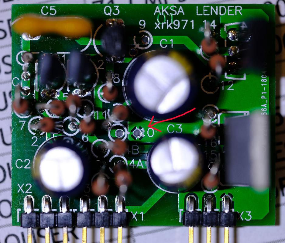

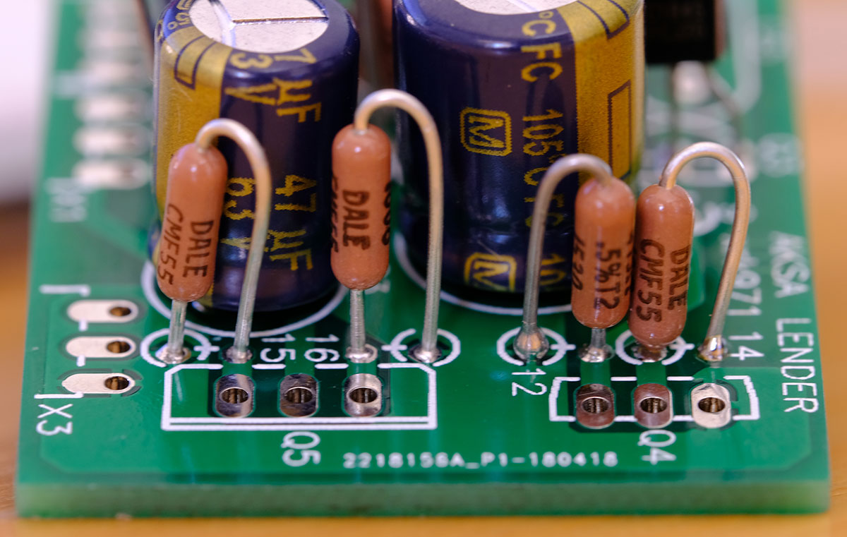

Hi.
Last night soldered some resistors to it, and now noticed they are correct resistors but some of them are not set to the circles on the pcb.
Does that make a problem?
If there’s no mechanical problem ( and it doesn’t seem to be one) then it is fine

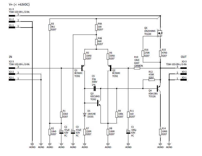

Here is schematic for TH board:
R10 is the feedback cap. Use a good quality metal thin film or carbon film here. Depending on how much gain you want set Gain=(R10+R11)/R11.
If you want to use as a normal preamp to drive, say, a 15dB Pass Class A amp like an ACA, you will want about 15dB. If you want an amp to drive a full 40Vpp to drive a 0dB amp like and F4, you will want about 27dB to 30dB gain.
In the schematic I have 10k for R10 and 1k for R11 so gain is (10+1)/1=11 or 20.8dB
Hugh recently reminded me that ideally, the input impedance on left transistor and feedback impedance should be about the same. So should leave R10=33k and play with R11 to get desired gain. So assuming you want about 15dB to drive ACA or F5, then use R10=33k and R11=6k8 and gain will be 15.3dB.

Thanks xrk971
So previously for the ACA, the gain for running from the Lender was set at 15db with R11 at 2k2, and the R10 at standard 10k0.
Now should be better if it was done with the R11 at 6k8, and the R10 set at 33k.
Both versions should give about 15db, but the newer version would be better.
For the R10, should still have those good quality metal thin film or carbon film resistors.

Irf510 is fine. If you don’t have metal thin film or carbon film go ahead and use what you have for now to get music. Change later. It’s a minor effect. Same with 33k and 10k on feedback R10. Use what you have to get sound and listen - it will work fine until your new ones come in.
