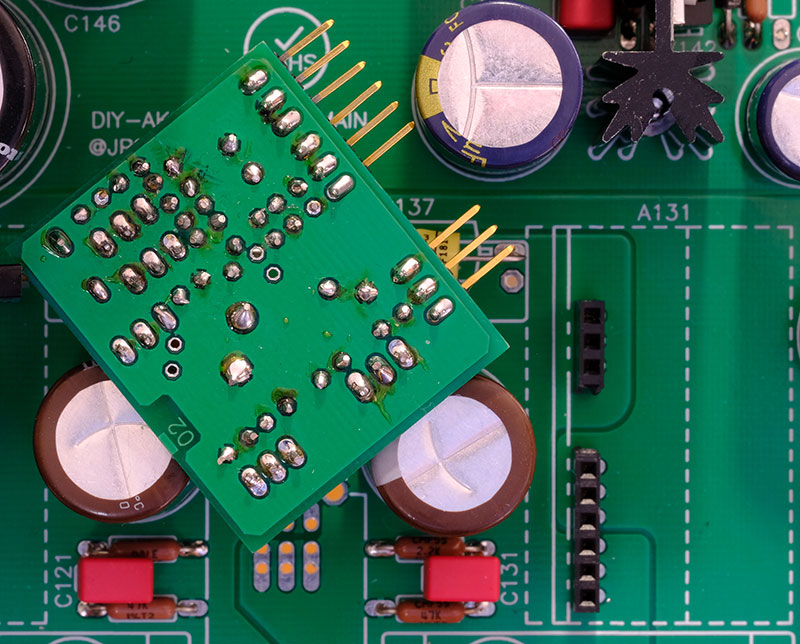

Can anyone see if the main board is ok so far? It just needs R141 and the volume switch.

Beautiful work - very neat! Looks good to me. Make sure you use edge card socket connectors for the DB rather than solder in directly.
Your PSU looks good but 19v laptop supply is overkill probably. A cheap class 2 wall wart transformer from an old WiFi router at 12v and 1000mA will suffice and probably less noisy than laptop supply. Although HP laptop bricks are some of the best and quietest ones around, so should work well.
Why ?......Make sure you use edge card socket connectors for the DB rather than solder in directly.

Maf_au – I agree with X – beautiful work!
I would also advise to use socket connectors on the motherboard for R121 (the pot) for easier connecting to your panel mounted DACT volume switch. I soldered wires from my panel mounted attenuator directly onto the board and regretted that later when I replaced the cheap problematic stepped attenuator with a Bourns pot. Difficult to solder between the caps there.
