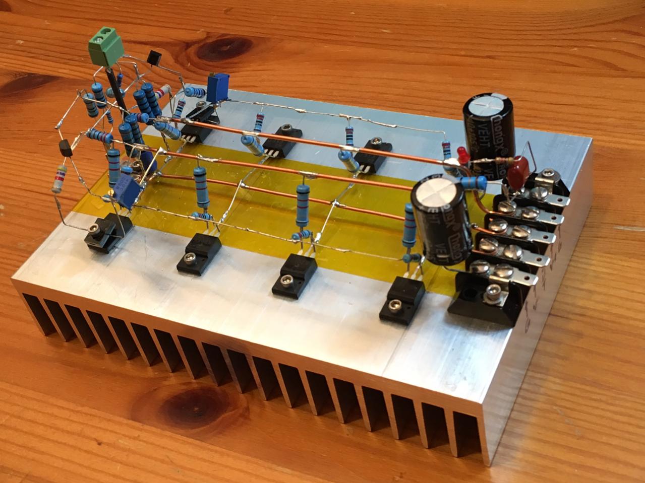

Yesterday I heard your fourteen amplifiers and I loved the F5 Juma sound.
Virtual Audition of Very Simple Quasi MOSFET Amp
Maybe the 15th would be the Cubie3
That's a nice amp, I agree. Perhaps it's liberated from the confines of a 2d flat PCB that makes it sing? Certainly, Juma designs some very nice amps.

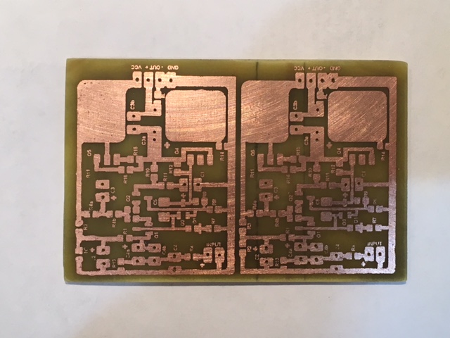

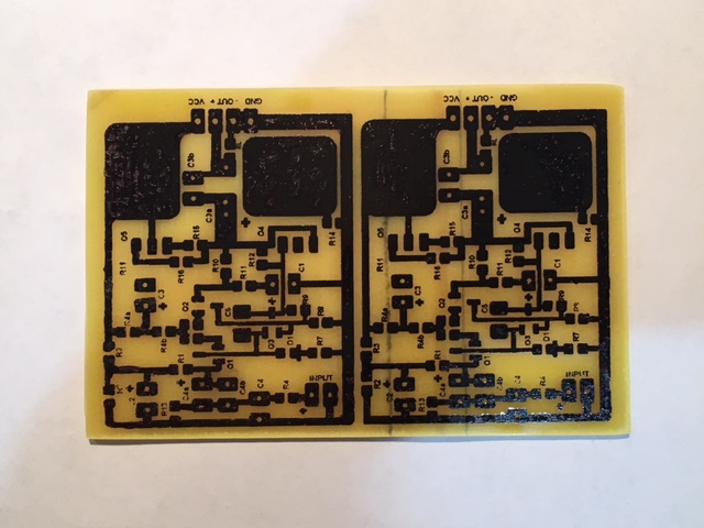

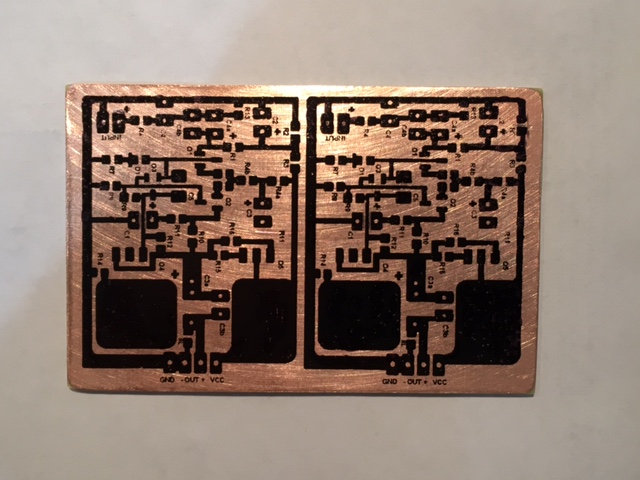

I just finished etching an SMT implementation in real FRP PCB. I had previously used the cheap phenolic or fiberboard ones. The layout was made by hand in PowerPoint and then laser printed for iron transfer.
Thermal transfer mask completed:
Etching completed:
Remove mask and drill through-holes completed:
Ready to populate and reflow solder with a hot plate.

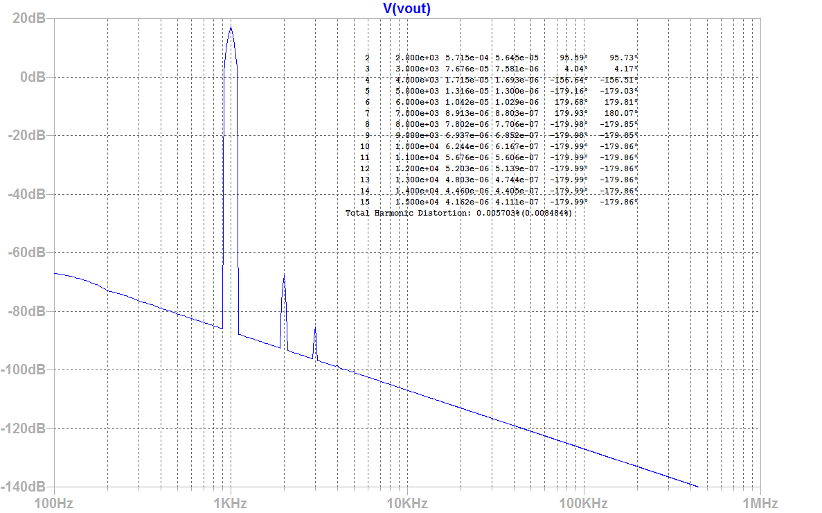

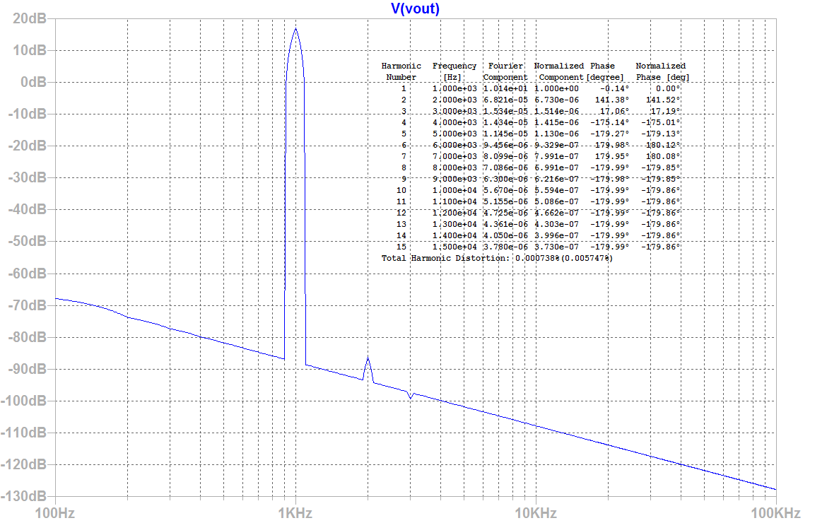

V1.7 with All SMT Components
I re-ran the simulation using some SMT parts: FJV1845 replaces KSC1845 and putting in a 600mA capable DZT5401 SOT223 package PNP for the KSA1381, and BC860 (same as BC857 model) and got an interesting improvement in the predicted THD. Recreating the 25k ohm load case at 20vpp drive, I am now getting 0.00074% THD, that's 7.4ppm I think. Compare that to my earlier 0.0031% THD using through hole parts. So, looking forward to building the little SMT version of this board then.
Predicted FFT for 20vpp into 25.3kohm load:
Now driving a 4.7kohm load to 20vpp, the THD is still a very low 0.0057% with nice profile:
