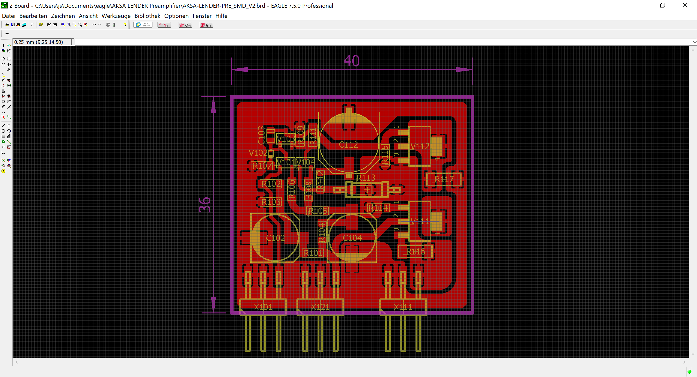

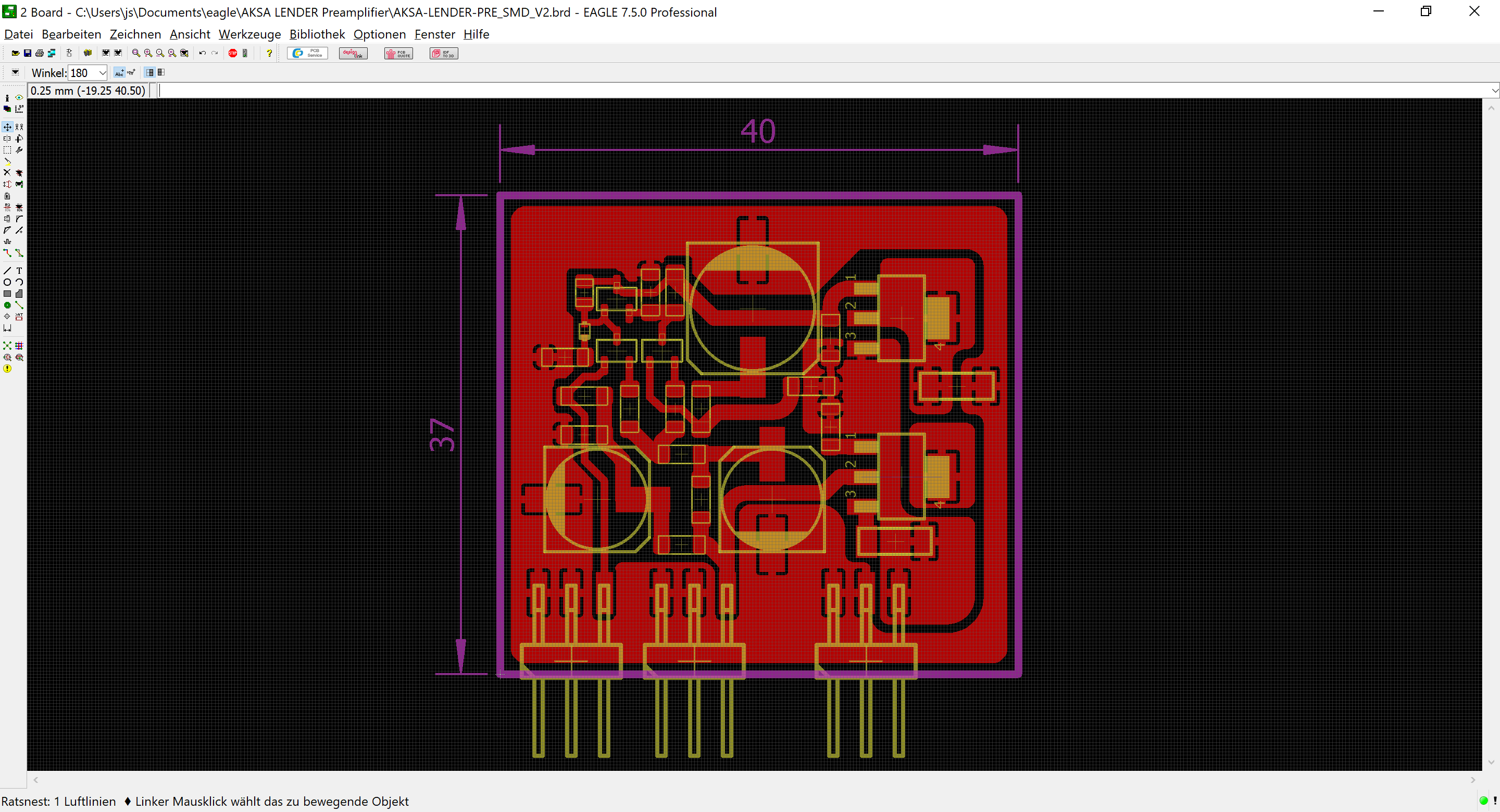

Why R10 carbon? or non inductive? Carbon as SMD resistor is very difficult to order!
MELF or MINIMELF enabling possibility to route signals under themself (starting standard size 1206) and IMHO they are a good choice for audio (from 0102(MMU) to 0207(MMB); SMD holder only for 0204(MMA)); also available from all distributors. Footprints are IPC compliant.
Remember, the metal core PCB doesnt allow vias.

I´ll check datasheets. Unfortunately, ELNA SILMIC SMD RVF (up to 10µ) or RVO/RVM types not yet available as small quantities order. Will check PANASONIC, RUBYCON and others.

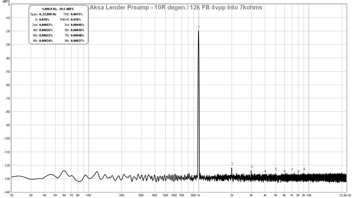

You missed the revelation a page back. This was killer to find - almost had to swap out every part on board to duplicate the veroboard before I found it.
Here is FFT with metal film SMT:

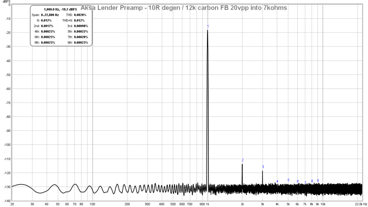

Here is carbon on R10 feedback resistor:
This confirms anecdotal reports that metal thin film resistors, when used in audio path, "sound harsh". It is extra sensitive in the feedback position. Matched LTP transistors hardly made any difference, and the difference it made was to reduce H2 even farther relative to H3.

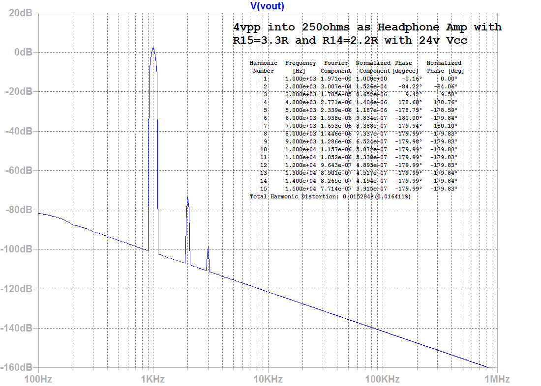

There is one other trick this circuit can do if you make R15=3.3R and R14=2.2R and drop Vcc to 24v. You get a pretty nice headphone amplifier! Here it is driving 4vpp into 250ohm load:
This is for 72mA bias current and about 900mW dissipation in each of the output devices and CCS MOSFET (still within spec).
Also, change output cap to bigger value if using lower impedance headphones. I put in 2200uF in sim but probably 470uF is enough for 250 ohm phones.

carbon 1/4W replaced.
100µ --> PANASONIC FC (leakage 0.01CV), others stay OSCON.
All other parts (input/output caps, volume potentiometer, cap-multiplier, CRCRC) on mainboard (in progress).

X that is no doubt a good observation and well worth to keep in mind, may we know exactly what brand, power rating and tempco the mentioned resistors were of, thanks.
The SMT 0805 5% thick metal film resistor was unbranded from an "assortment pack" (I did not have my usual Yageo 1% 0805 in that particular value. ) The carbon film was also from an assortment pack and unbranded. Maybe I will buy a set of nice 2% name brand carbon resistors from Stackpole the next time I order from Mouser or Digikey.

I did this test just for you Bimo. Feedback resistor is now 12k carbon (5% no-name brand from China), so about 2x the gain of the previous setup. I changed degeneration resistors on LTP to 10R (1% 0805 metal film Yageo from Digikey). Driving same 20vpp into 7kohm load, the THD is now only 0.002% and H2 is still higher than H3 but not by 15dB anymore. However, I suspect that this is still a very nice result that many would find transparent and very usable.
The lack of any orders of distortion above H3 is very nice result - a fresh breath of air compared to a forest of spikes often seen on complex designs. I will spend some time listening to it like this to see how I like it. The last config, is probably still going to reign king in my book, but I am trying to keep an open mind. 0.002% THD is nothing to be ashamed about I think (to put it in perspective, it is about the same as the least significant bit in a 16-bit CD recording).
Finally, as a typical line level preamp duties pushing 4vpp into 7kohm load gets 0.0011%THD with H2 only 5.7ppm and H3 4.5ppm, for regular use on power amps with some gain, these are going to be the max signal levels coming out of this preamp, and probably into n easier load than 7kohms (47k to typically):
So, this is a nice result as well I think.
