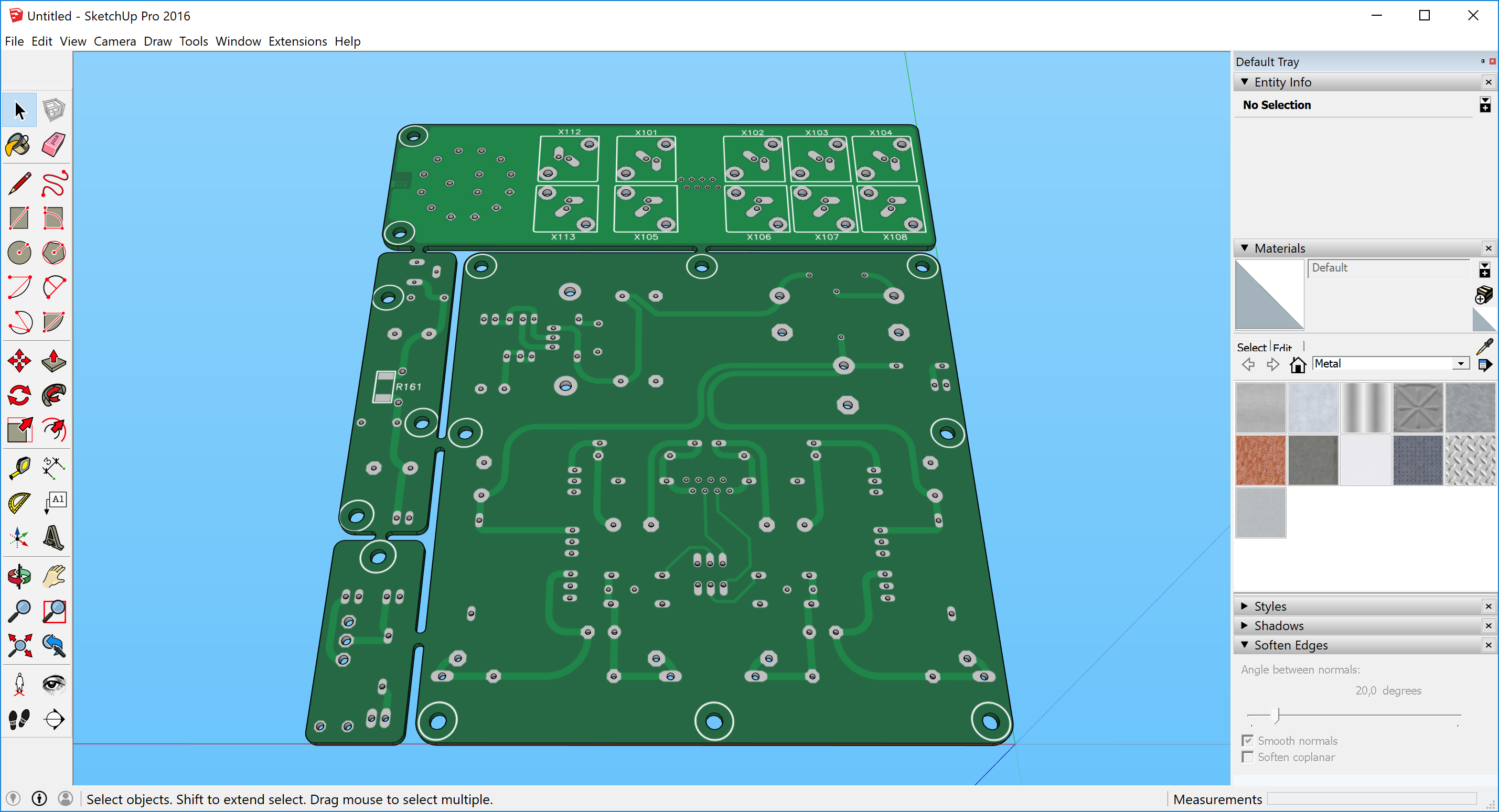

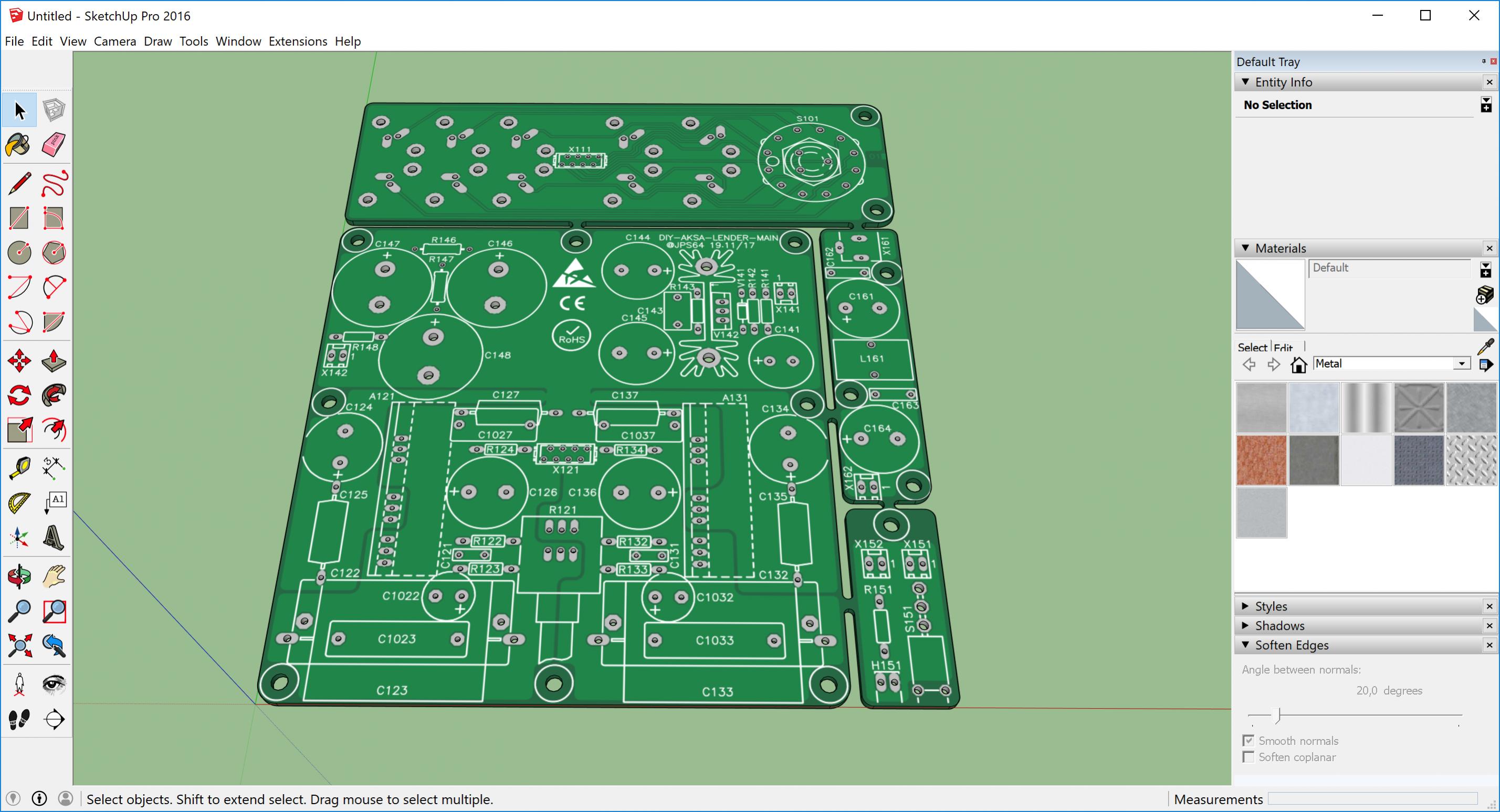

Main PCB only, silkscreen finshed.
JP
Very talented Sir, how in the world did you get it all done so quick
