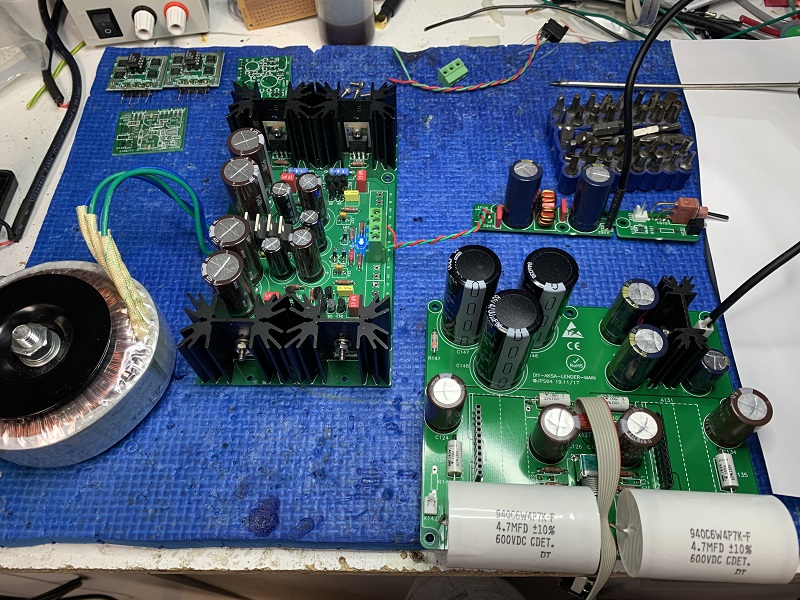

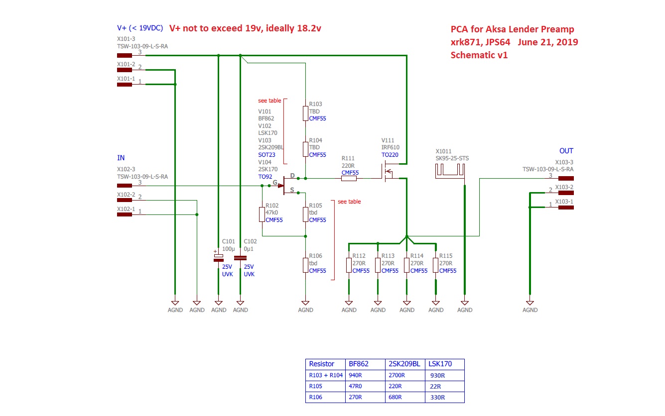

That’s an interesting question. I think take your favorite Class AB amp, remove the front end and VAS stage and put the Aksa Lender input to it. I have lots of discrete Class AB that could try this with. But why? The whole reason is to drive 0dB SE Class A output stages that don’t have any global feedback and the smooth no-crossover distortion characteristics that lacks high order harmonics. I have an Apex FX-8 Class AB that uses lateral FETs for the output so it will be inherently stable and less prone to thermal runaway. I might see if that can be rejiggered to bypass the input LTP and VAS and just apply the Aksa Lender to the output. Fnny, but I have taken that same amp and removed the output stage to make a slick +/-40V preamp.

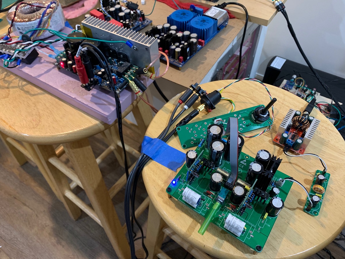

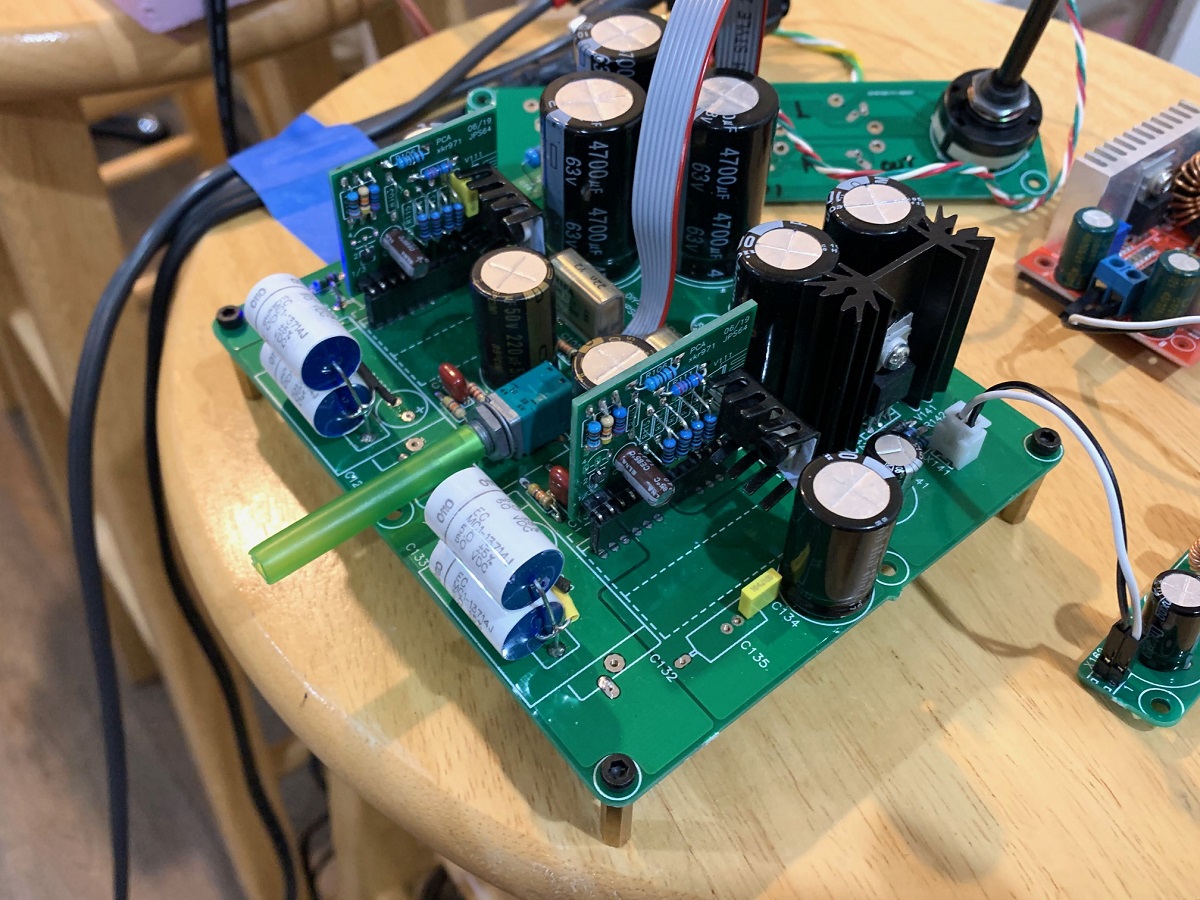

Just setting the Aksa Lender with PCA daughterboards on low gain, say 12dB and driving a conventional Class AB LM3886 chipamp actually sounds very nice. It’s sort of an analog sound processor that forces the amp to be dominant second order distortion.
Here is just such a system - just an inexpensive $40 stereo LM3886 with built in PSU and DC protection relay - just added a 250VA 25v trafo.

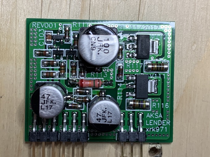

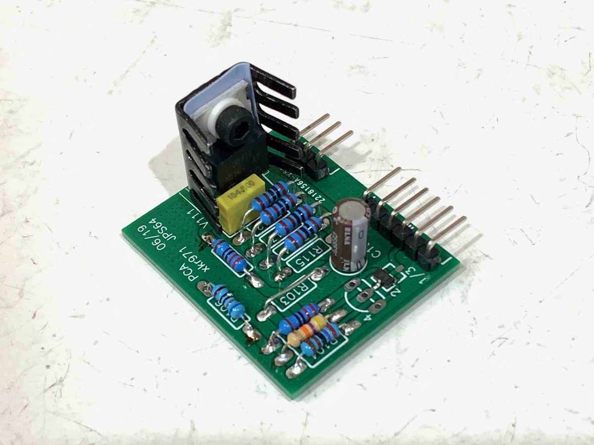

This is the PCA daughterboard:
Here's a couple pictures in test. The volume pot will be replaced by TKD sinc ethis one is a 3$ cheapo pot.
Just missing the chassis. I have two builds in there (not showing both), one for a friend and one for me.

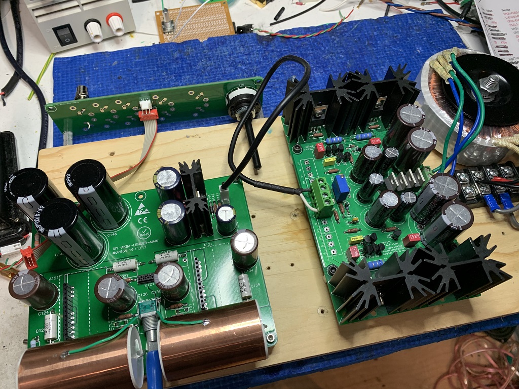

Here's my own AKSA Lender Preamp
I'm using a Sigma 22 but leaving the ground floating, so it is set to ~+/-26Vdc but using only + and - I'm getting a little over 52Vdc. I've added a 1W 25 turn 10K trimmer on it to precisely set the voltage.
Next step will be to add it to a chassis once I can get stuff from China.

This begins to look like a convention of users of boutique condensers
I had never seen capacitors that connect like this, in the middle. More info about them?
I don't think that is the capacitors but a copper foil connected to gnd.
Yes, exactly

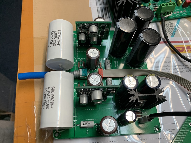

I did this since the CDE 940C are quite big and not being in a grounded chassis it grabs RFI when having my hands close to them. So adding a copper foil connected to ground shields the cap very good. I know there's a way to find which leg is connected to outer foil and this leg should be on the load side but using a copper foil fixes my thing for now.
With the additional foil in place, try measure the capacitance from it to each axial leg, should indicate which leg is connected to the outer foil layer.
