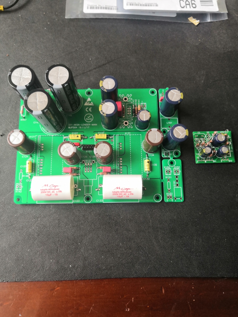

Finally starting to put my Aksa Lender together. I missed a couple of things on my parts order so hopefully they will arrive eventually and I can finish it up. In the mean time I was reading my notes on the build and it reminded me of post number 1035. Very slightly off topic but I can't wait to hear this through the AKSA. I would like to thank Maty Tinman for bringing Ahmad Jamal's album "Ahmad's Blues" to my attention last year, something I never would have heard otherwise. It certainly has many elements that make it a very good listen. Whilst I'm not a particular fan of Jazz I have enjoyed it live many many times, mainly for the live sound and the atmosphere in some clubs/bars. It really is a good listen whether you like Jazz or not.
Progress
Hi all
Progress picture, which has hopefully attached, and a question or two. I will be separating the boards but have just kept them together while I'm working.
I am just waiting on a couple of pieces to finish the pre-amp up such as R10 and R11, originally I had 10k and 1k but have since decided to order 33k and 6k8 after reading a post from XRK earlier in the thread. All that's left is arrival of a chassis and some time to finish it. However, I have also ordered the incorrect toroidal inductor from Mouser 2300HT-220-V-RC. The datasheet link:

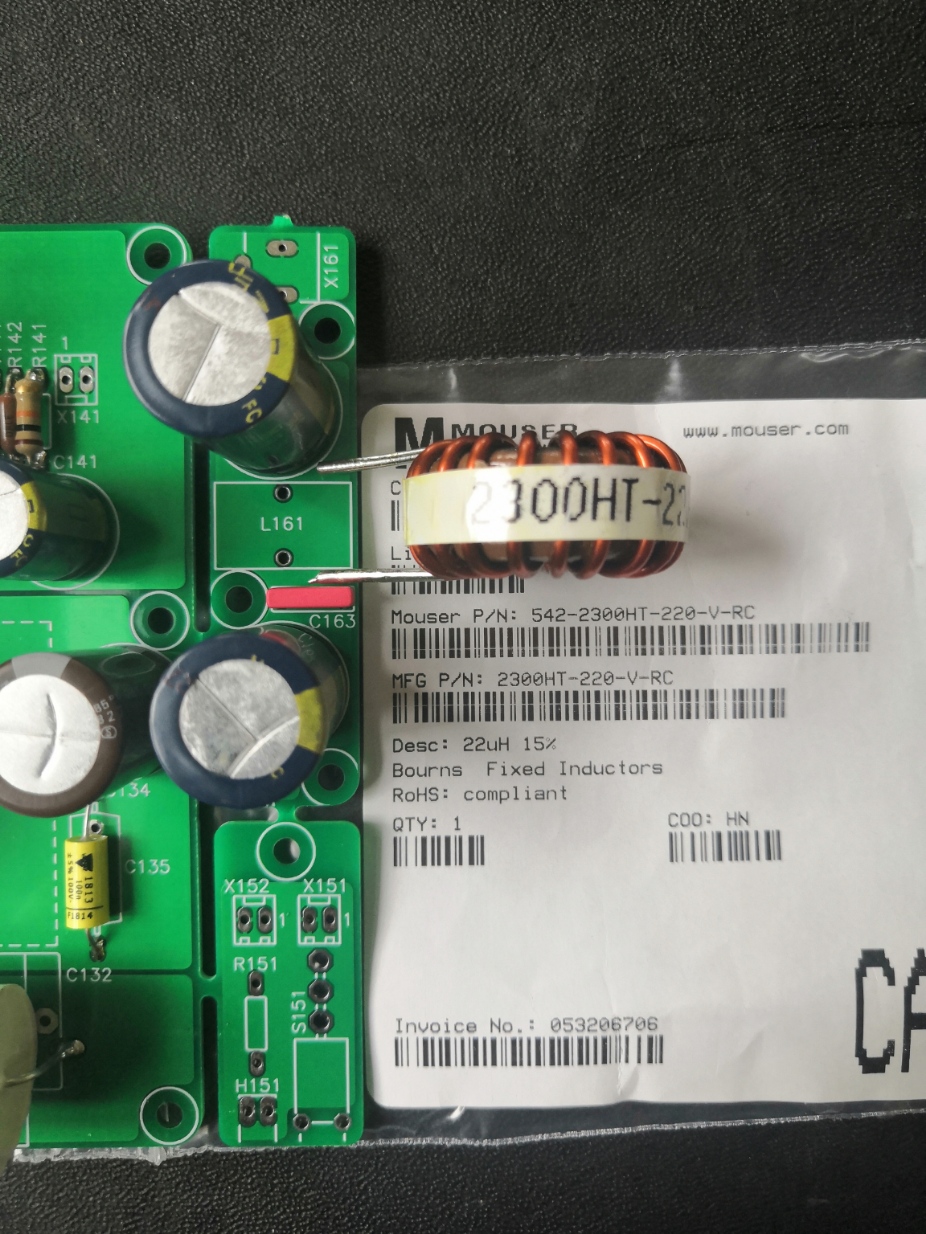

https://nz.mouser.com/datasheet/2/54/2300ht_series-776374.pdf
The correct part from Farnell is a Wurth 744017. The datasheet link:
http://www.farnell.com/datasheets/2...38.822102680.1586235817-2104837401.1585897469
Apart from the fact I would have to mount the inductor off the board, as its physically a bit larger, the DC Resistance Max is 0.008R compared to the Wurth 0.015R Max and higher current rating would the 2300HT from Mouser be useable?
Thanks in advance
