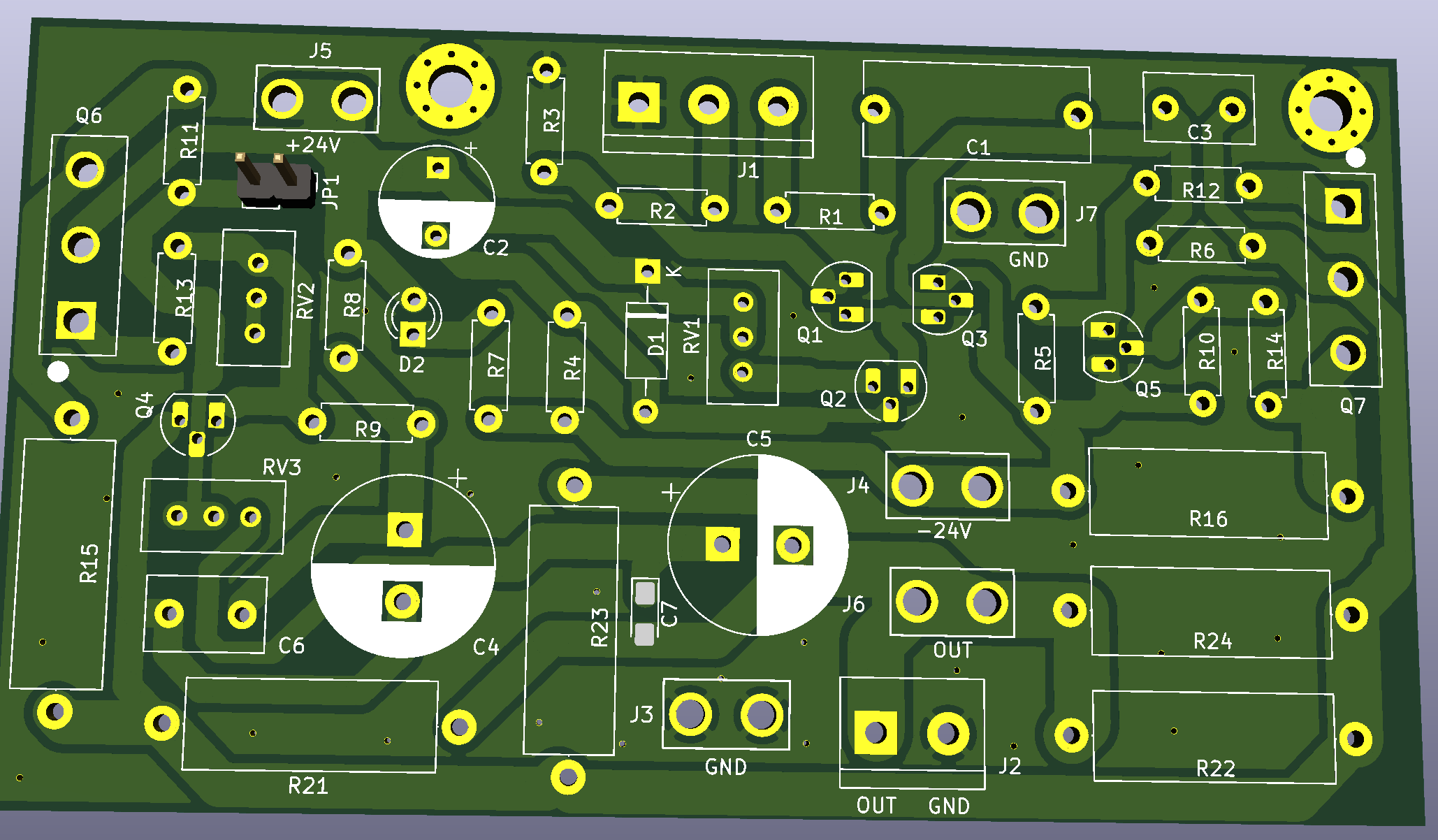

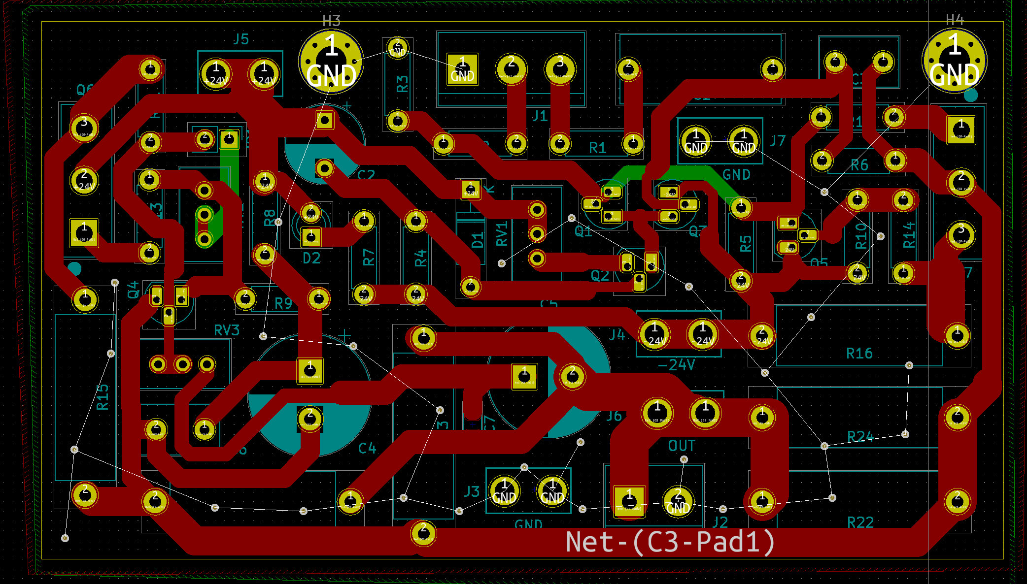

In related news im making a PCB (for personal use).
Comments are welcome, since I plan to publish gerbers later once its all revised and tested (of course, also for non-commercial use only), I have an interest to get it right.
J74 conveniently has the same pinout as J175, so board can also be used by people with greenies for j74's.
Edit: i wanted to just note that the design seems a bit schizo (for example, why aren't the 4 output resistors all conveniently next to each other?) because i have a strict design requirement of no side being more than 10cm. PCB manufacturing cost goes way up above that.
Here's what i have so far. (attachment)

noise is not a problem in this particular case

Very true, but i enjoy maximal DIY, feels nice to go off the beaten path even for a little bit. J175 has same pinout as lsj74, so i can always splurge and pop them im later.
But on a serious note, im on a rather silly quest to build the whole thing under 100usd (this is actually almost a third of my whole monthly income, so imagine for an American this would be 1-3k$ equivalent). Such is life sometimes, just gotta roll with it and see what you can do.

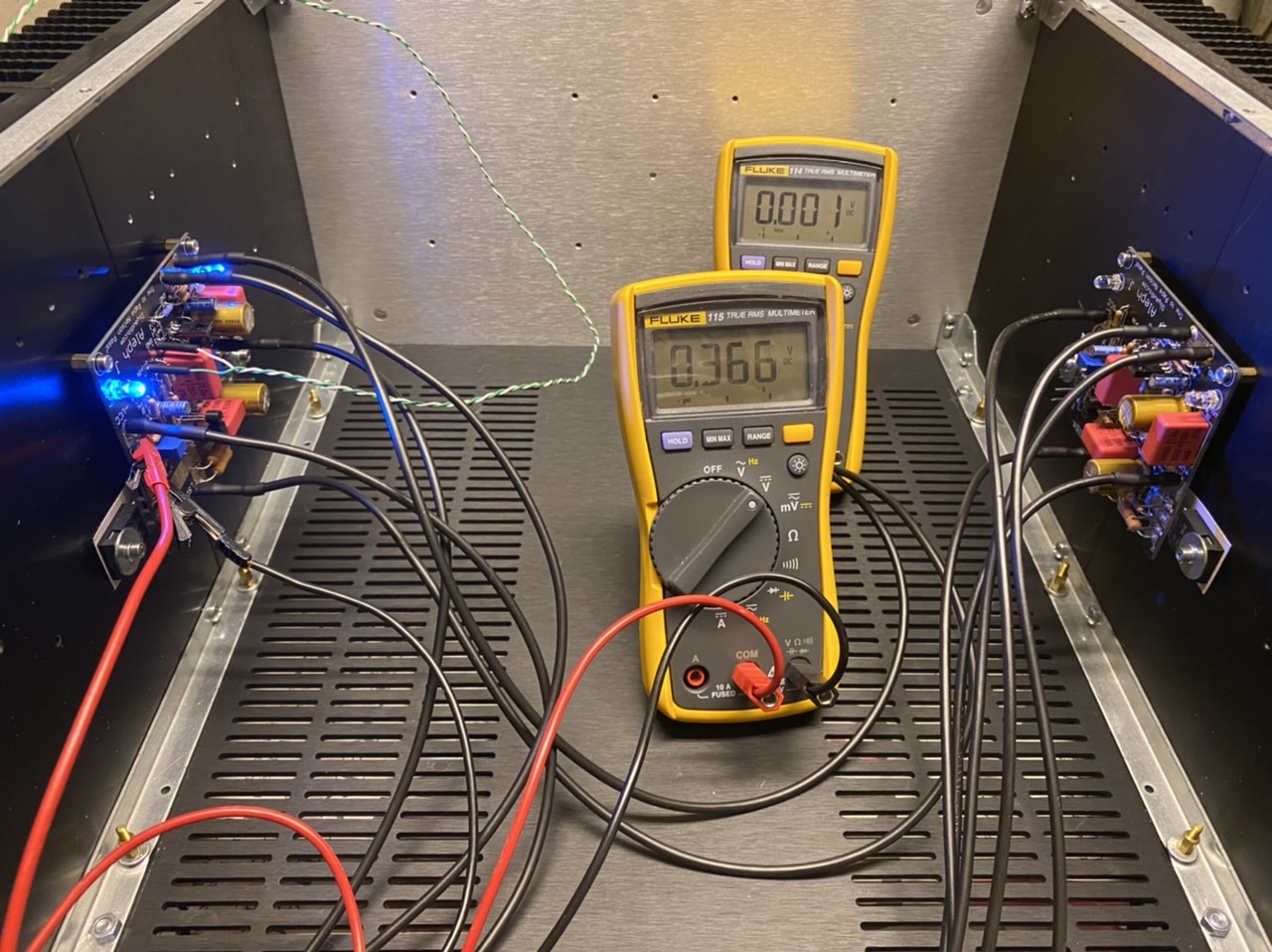

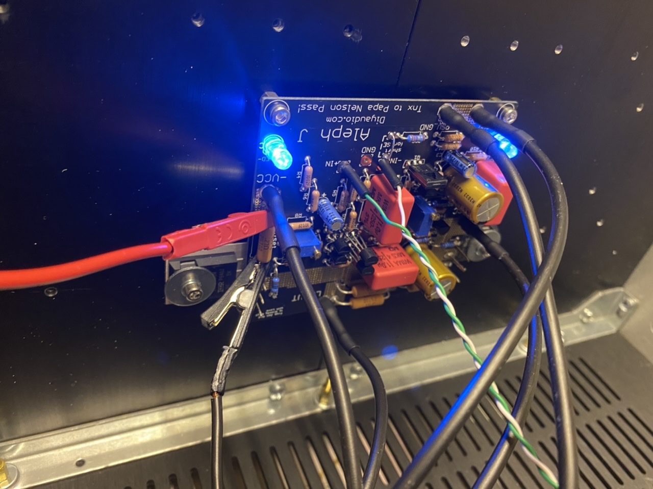

Second amp board up and running, also zeroes offset really nice. Reduced R23 to 27K on this one, a bit lower initial IQ so maybe I’ll make the same change to the other side.
Lovely build so far. Approx 5-7 hours work per side from start of stuffing to up and running. But maybe I am slow, dunno. Very happy so far.

Andy, for the outputs, just wondering how warm @ your preferred bias with those sinks. Of course when your able to reach complete closure. Thanks
