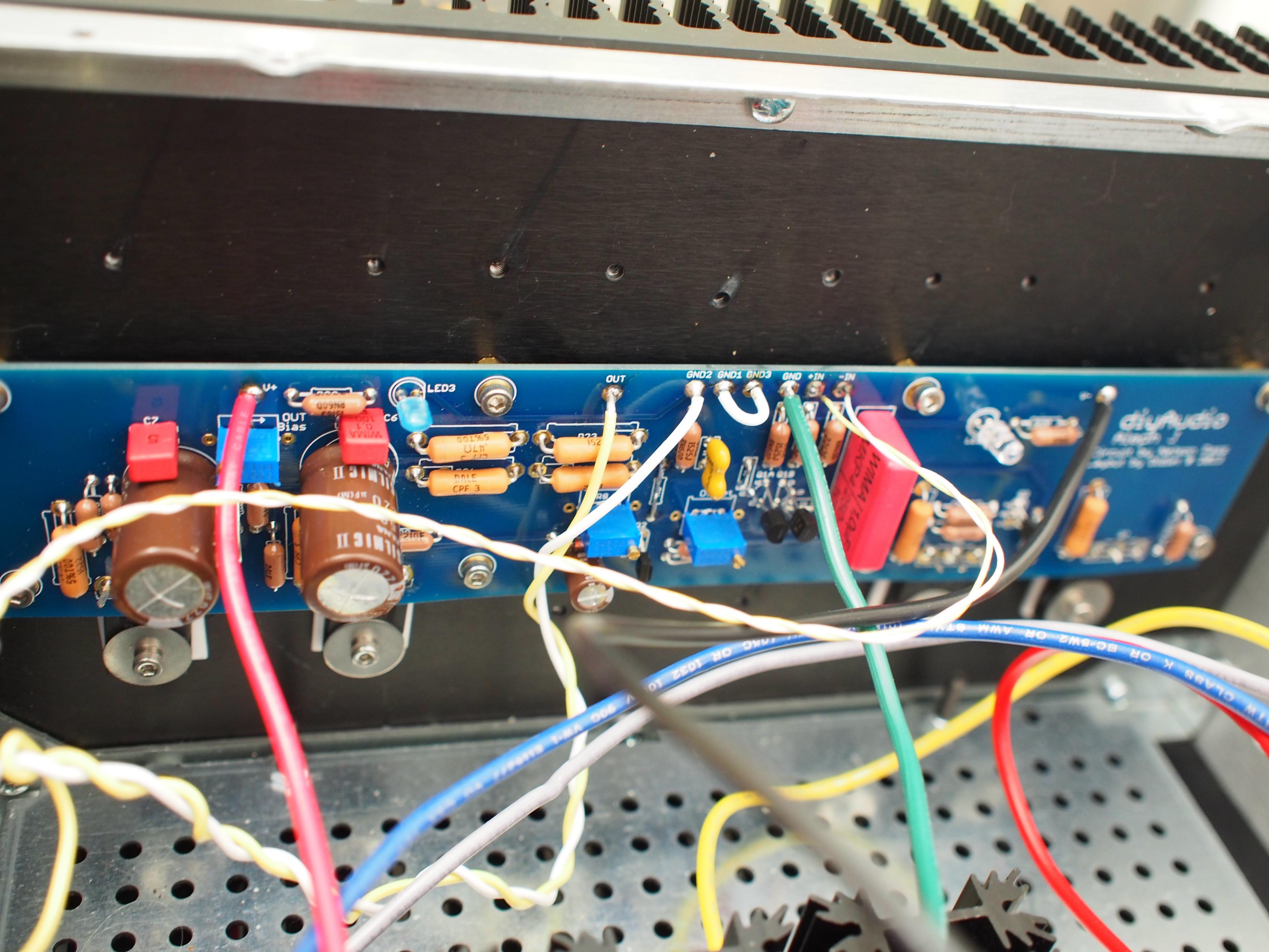

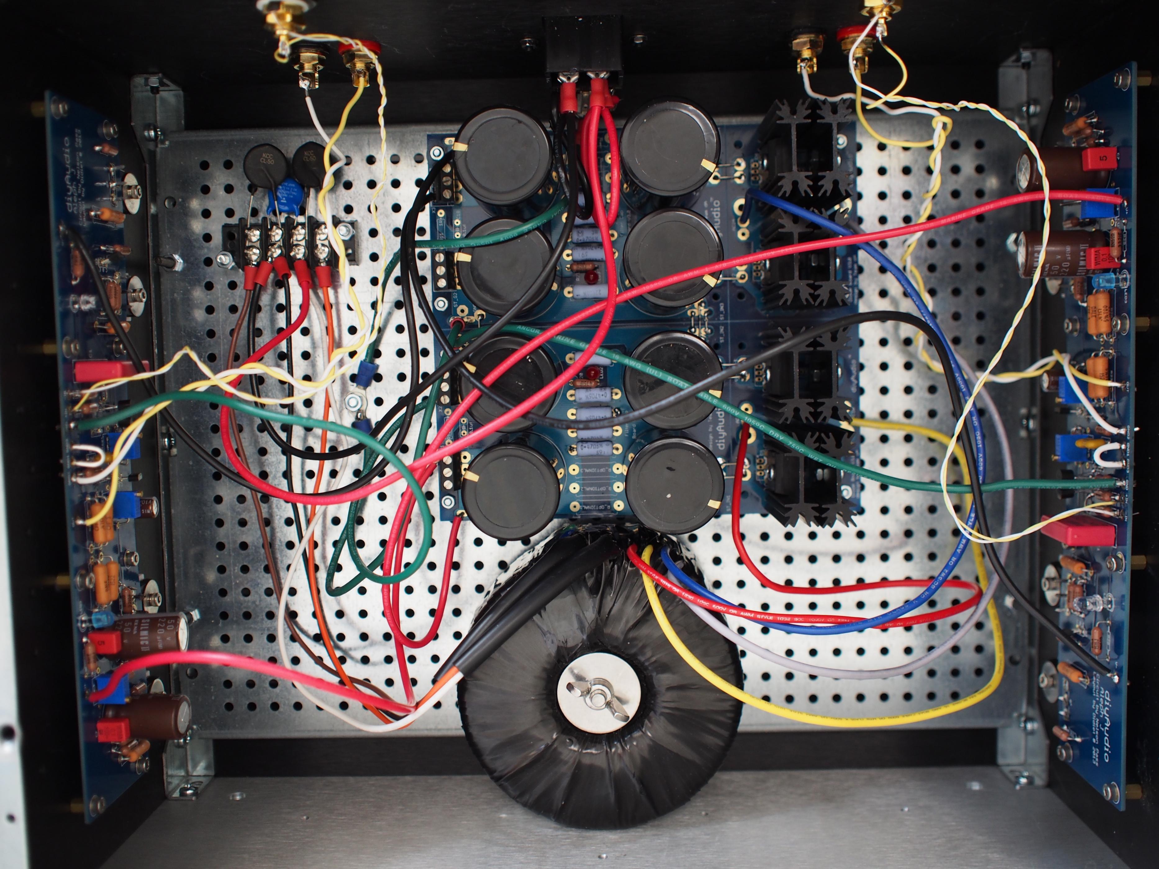

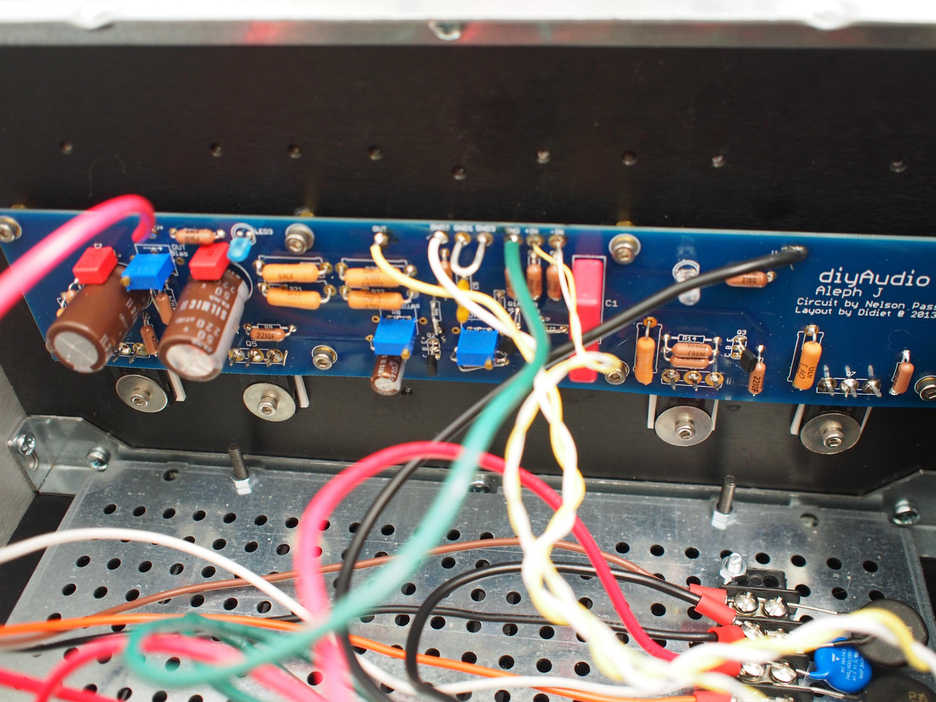

Just completed Aleph J lights up for a little while, then two blown fuses
So I switched on my new baby and was very happy to see all the LED's light up as they should. Then I switched it off, while I put the bottom bracket on and did a couple other things. When I turned it back on, no lights and two blown fuses. I used 250 V, 2 amp fast blo. Here are some pics, I haven't tidied up the wiring yet. Any ideas?
What criteria did you use to choose a 2A valued fuse? Did you use a slow blow type?
What is the VA rating of your transformer? Typically the fuse for the primary should be VA divided by 120V, then multiply that result by 125-150% (due to a turn on surge).
Yes, please twist all primary and secondary windings from your transformer.

I always use a 3 amp slow blow in all my amp builds, tube or SS. If there is a dead short somewhere it will blow just as quick as the 2 amp. Hopefully for you the normal turn on surge blew the 2 amp fuse.
qwertyl's comment about the RCA connection is correct, a common mistake on the J build I made myself and a friend of mine who just built did as well. Without being connected correctly you are subject to hum and most definitely low gain.
Ok, so I followed your advice, and first the good, everything lights up again, and no blown fuses. Now, the bad, while I can zero out the offset and set the bias ok on the left channel (looking at the front of the amp), on the right I get an offset reading of negative 21.65 volts, and no amount of turning on R7 changes this. I checked everything and I don't have any wires reversed. What gives?

I would echo those who have said to use slow-blow fuses to survive the power inrush at turn on. 2-3A should be plenty. As for rail voltage on your speaker output, I would check the mounting of your output mosfets. If you used a silpad and tapped your own holes in the sinks, check for a bur or sliver of aluminum from the sink that may be piercing the pad and grounding the mosfet to the sink.Any ideas?
