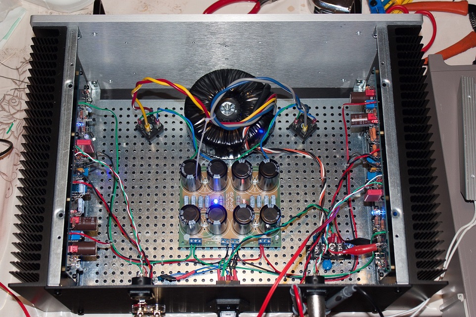

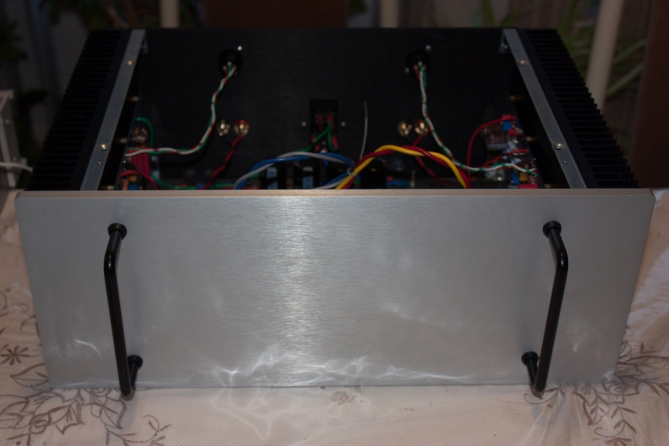

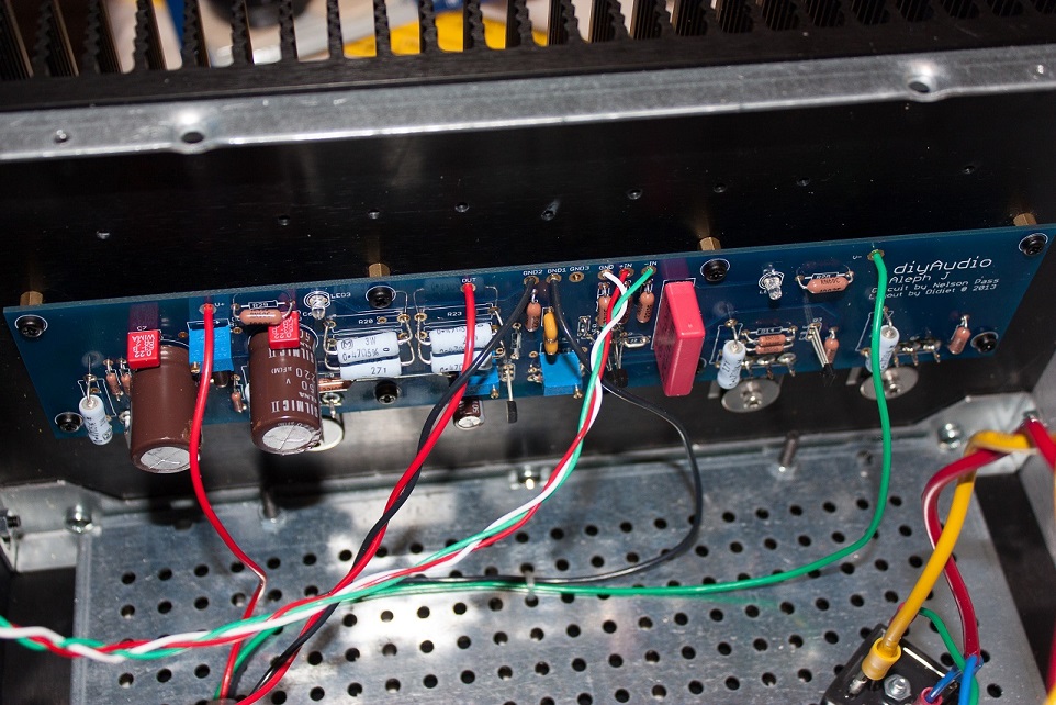

Here's an Aleph-J in a store 4U chassis wired with XLR inputs. The jfets
are 2sj108V instead of the more customary 2sj74/lsj74. The IRFP240
mosfets were curve traced and matched at 850mA. PSU consists of
a 2x18VAC 300VA Plitron and 8x22000 uF caps in CRC (R~0.12 ohm)
Bias was set at ~1.7A (0.4V over 0.47R source resistor) after about 1
hour. It sounded fine with the test speakers.
I hope in the coming weeks to get some time to run it in,
recheck and adjust the bias and offsets, before trying it with
the main speakers.
Thanks to Papa for this wonderful design and Jim for the build guide.
Dennis

Congratulations - looks great!
I also finished mine a few days ago, but unfortunately I have some problems with oscillations and the bias (can't get it above 0.32-0.35V). The same circuit as the store boards, but using PCBs made by a friend. I'm trying different things but till now without success🙁
Any known causes (and remedies) for oscillations of the Aleph J?
Nic
Very Nice J Dennis. I finished one late last year. I used CLC filtering in the power supply and I built it with internal heatsinks and fan cooling. Great sounding amp and it has convinced me to finish my Aleph P and have an all Pass amplification chain.
